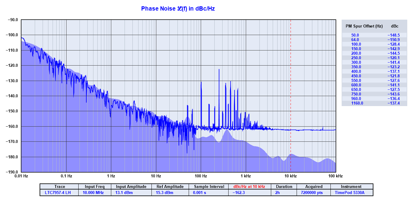

What regards the close-in phase noise contribution of the LTC6957, it had been measured here, and I hope it's ok if I repost here together with the link?
Phase Noise and other Measurements with a Timepod - KO4BB
Could it be called non-existent below 100 Hz, for our purposes?

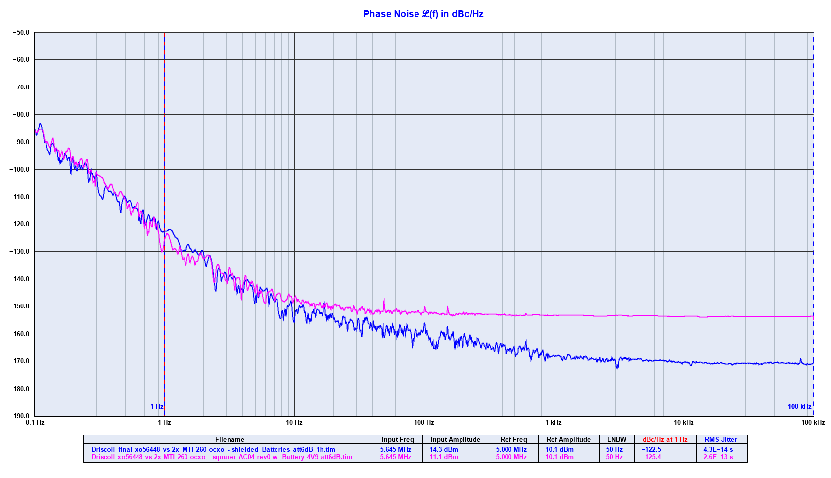

It's very curious that now you trust the reliability of the Timepod measurements. It looks like the gear was allergic only to the ultimate devices.
BTW, even the 74AC04 sine to square converter seems to be non-existent below 100 Hz, only a little higher noise floor, so sorry but I have no time to design one more squarer.
As I said we are already devoloping another sine to square wave converter for the top version of our system, but it's could be called "RF style" since it uses discrete devices only.
I see I had earned Your simpathy.. I hope it might change, still..

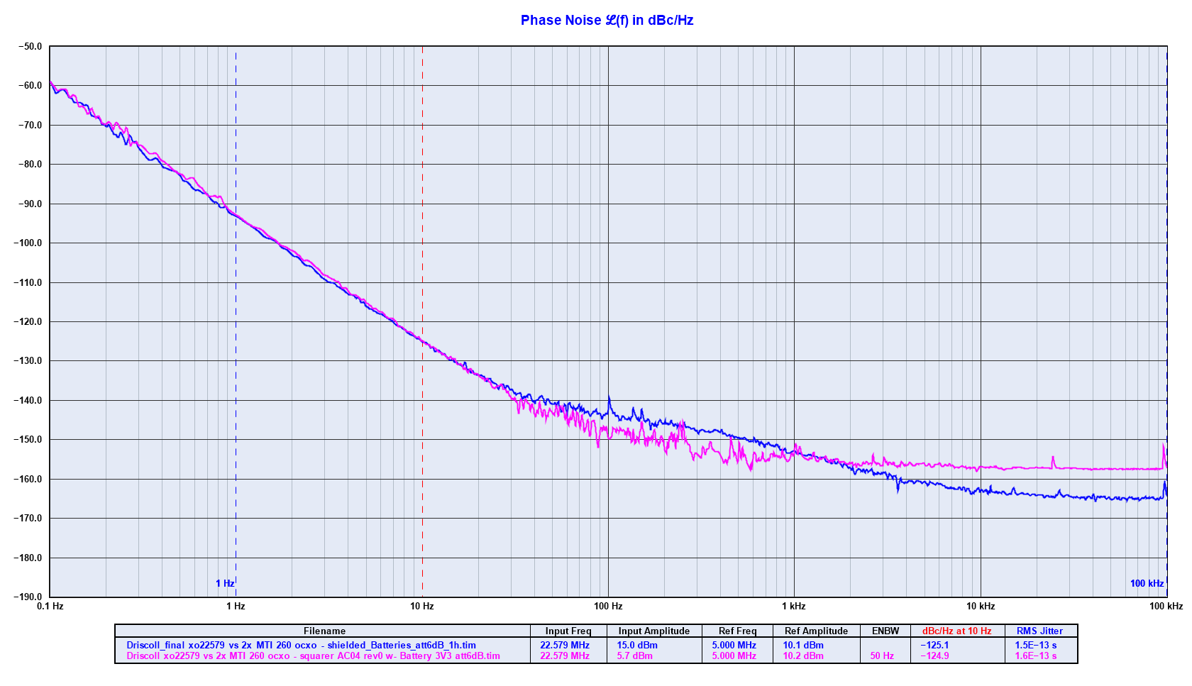

But look, there is a good 50; 30dB difference at 1Hz, 10Hz, between these two tests, so either the logic gate does something extra there or does have no contribution..
We do not know, at least from that graph.
The LTC6957 will not increase the floor even with Your best 5MHz Driscoll oscillator. According to Bruce's measurement, at least..
I believe you are wrong, the simple gate sine to square converter does not add anything to the close in phase noise of the oscillator as you can see in the attached plot, 1/F and 1/f3 noise are superimposable.
As I said it adds noise floor and it's obvious since the gate operates as a non linear amplifier.
Moreover when a gate swithes there is a time when the channel is open, this time depends on the gate speed.
In this time the noise could cross the gate and show up at the output.
This could explain the noise floor while the close in noise is kept at low level, the same of the oscillator.
Slow edges do not have the time to cross the channel because the channel closes before they can cross it, while faster edges might cross it.
This could happen inside the 74AC04.
Thta's the reason why we are developing one more converter to achieve the better performance as possible along all the noise spectrum.

Your graph is much more convincing than the previous one, thanks!
I have difficulties to follow your explanation, though..
Your graph is showing PM, slight variations in the switching time, and that decision is made in function of the input signal with respect to a threshold. The input signal sees the cmos gate input impedance, which is a high, ~constant value?
It is the impedance in the output stage which can have a dynamic impedance variation, while the output signal is 'slewing'..
I don't see how that could influence the decision time for switching. If not dragging the power supplies, and the gate has 6dB PSRR.. So a moving power supply does get translated to phasemodulation.. And the cmos gate input referred noise as well..

The output impedance of the oscillator is 50 ohm and it's terminated to the 50 ohm input of the sine to square converter.
It's not a problem of impedance fluctuaction, at one side the noise floor comes from the CMOS gate that works in saturation generating a lot of harmonics that can modulate the phase noise with reflections to the input. From the other side the CMOS gate has poor PSSR so any noise coming from the power supply are reflected to the output.
When the channel of the CMOS is open all the crap flows in both directions and modulates the phase noise.
However if you liked my sympathy I could say that I have never named this little device the ultimate way to convert sine wave to square, it's simply a little board designed to fit the ultimate FIFO buffer.
Jokes aside it does its job properly since it does not add close in noise, allowing you to take advantage of the most performer oscillators with a little size board.
And lastly it's inexpensive.
