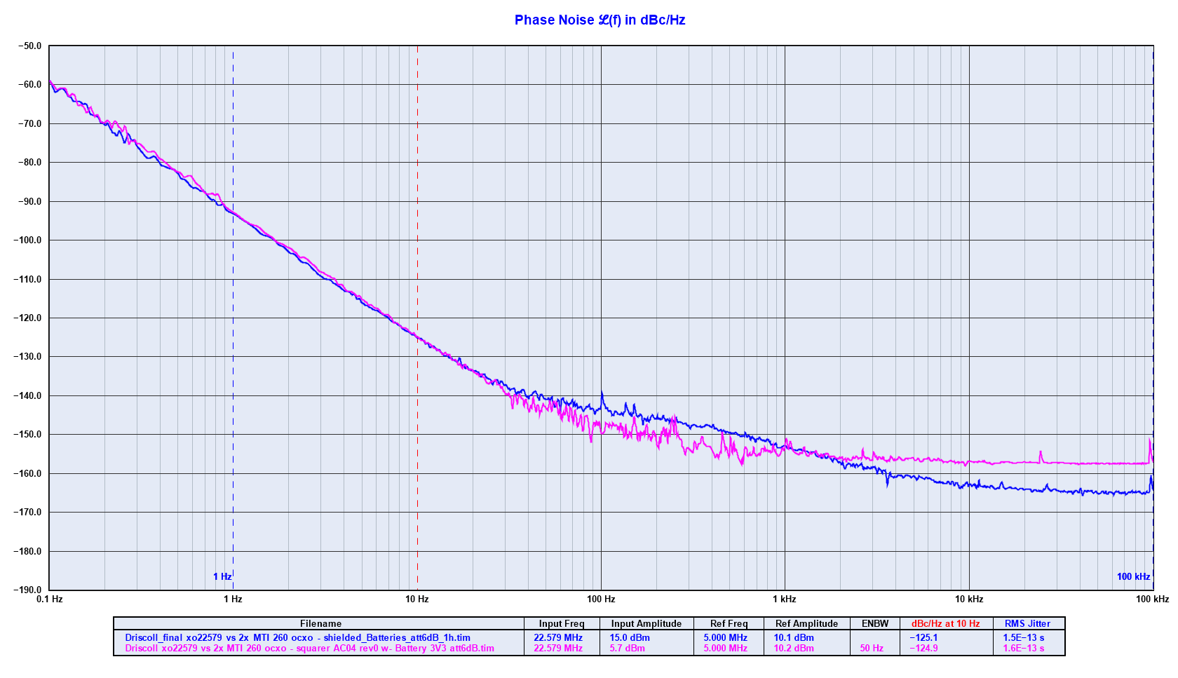

The LTC6957 seems to be a good device but the published phase noise measurement plot starts at 100 Hz that's a little far from the carrier.
In digitale audio the close in phase noise is muchh more important, 10 Hz from the carrier and below.
So the only chance to understand the close in phase noise performance is to measure it in circuit.
The TWTMC-STS is a little board that uses the 74AC04 as the squarer. It has been measured several times, you can find phase noise plots on the web, and it was claimed as one of the best sine to square converter (the plot I have published confirms that), better than using a comparator and almost equal or even better than using a ECL device.
