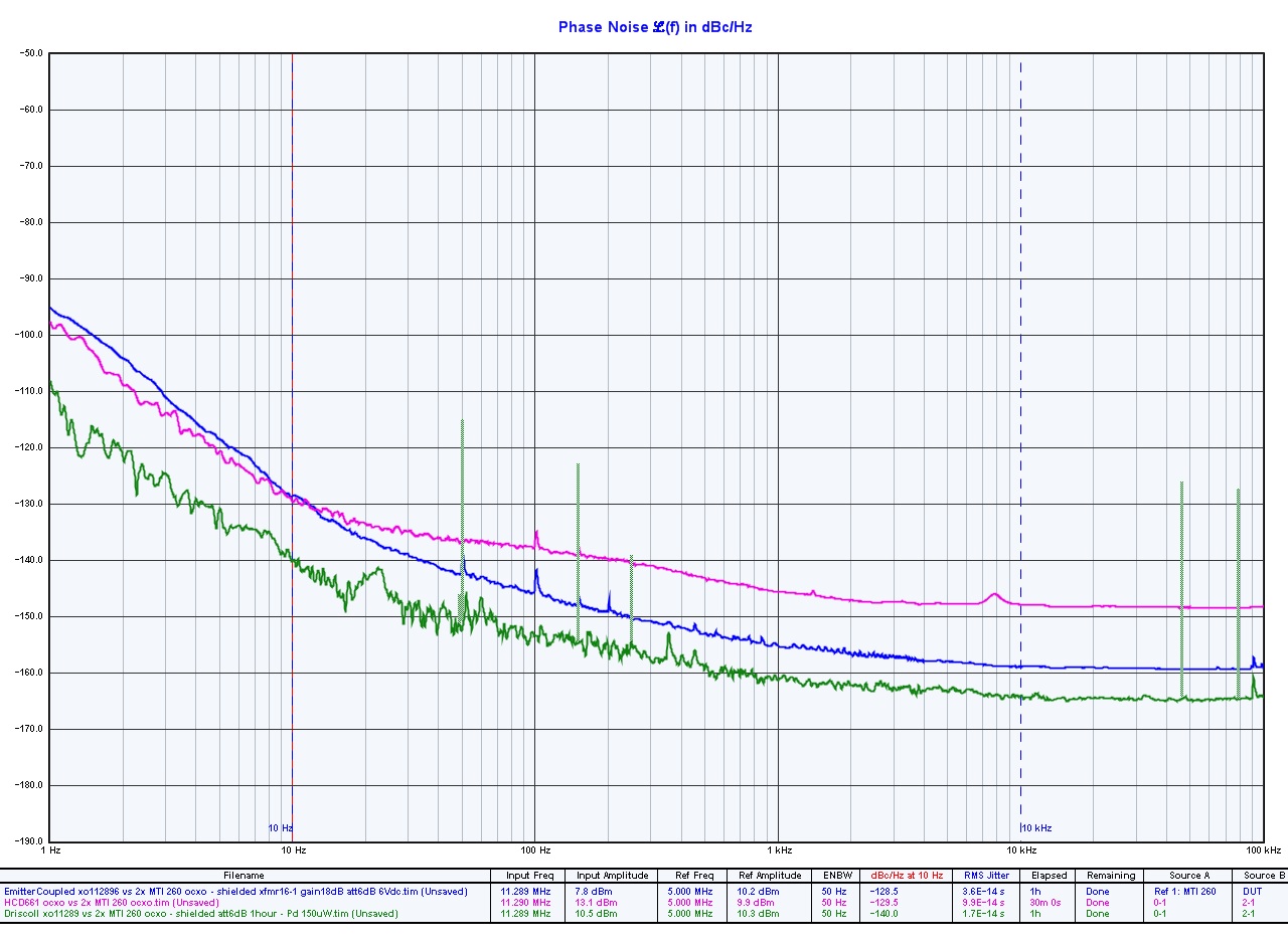

I believe that I have said several times that the measuremts of the Timepod have been compared with the ones obtained with the Aeroflex and the E5052.
The result is that the plots are almost identical when measuring the same oscillators, maybe the Timepod is a little pessimistic against the other two gears.
Therefore, again you are free to trust or not the measurements we have done for the community, spending a lot of time.
Moreover you can repeat all the measurements by yourself, I look forward.
But please, keep in mind that me and my co-developer we are not enjoying with LEGO toys, we are trying to develop the best audio system as possible for a hobbyist, without compromises.
So don't be surprised if our oscillators perform at least or maybe better than a 19000 USD device.

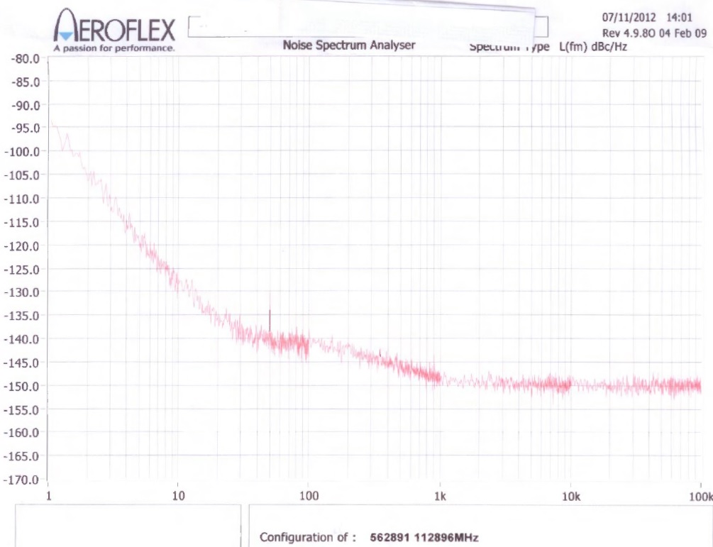

I attach the phase noise plots of the HCD661 OCXO at 11.2896 MHz measured with the Timepod (pink line) and by the manufacturer with the Aeroflex PN9000.
As you can see the plots are almost superimposable, just in case the Timepod is a little pessimistic.
As soon as I find the plot I will also publish the measurement of the same oscillator with the E5052B.
I wonder why you keep questioning the reliability of the measurements of the Timepod.
Just a curiosity.

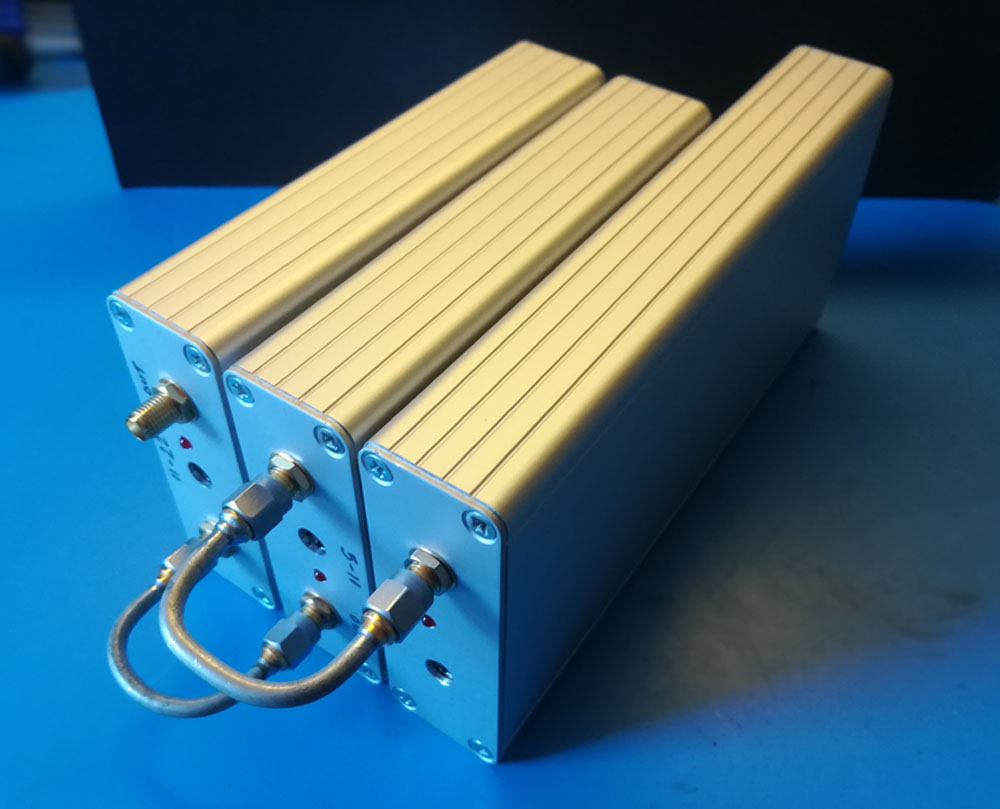

Do the OCXOs and the frequency doublers need to be shielded from each other? Can I just put 2 OCXOs and 2 frequency doublers into one, single 1U chassis?
The best way is using a separate box for each device, one for the oscillator and one for each frequency doubler.
In any case don't mix devices operating at different frequencies.

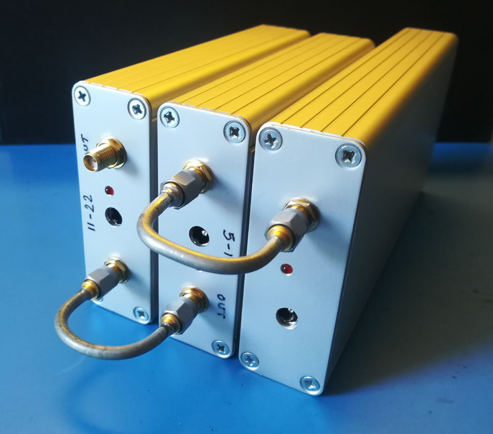

Some pictures about the best way to shield and connect oscillator and frequency doublers.
The longer box is the oscillator, the shorter boxes are the frequency doublers.
Semi-rigid 50 ohm RF cables SMA terminated have been used to connect the devices.
