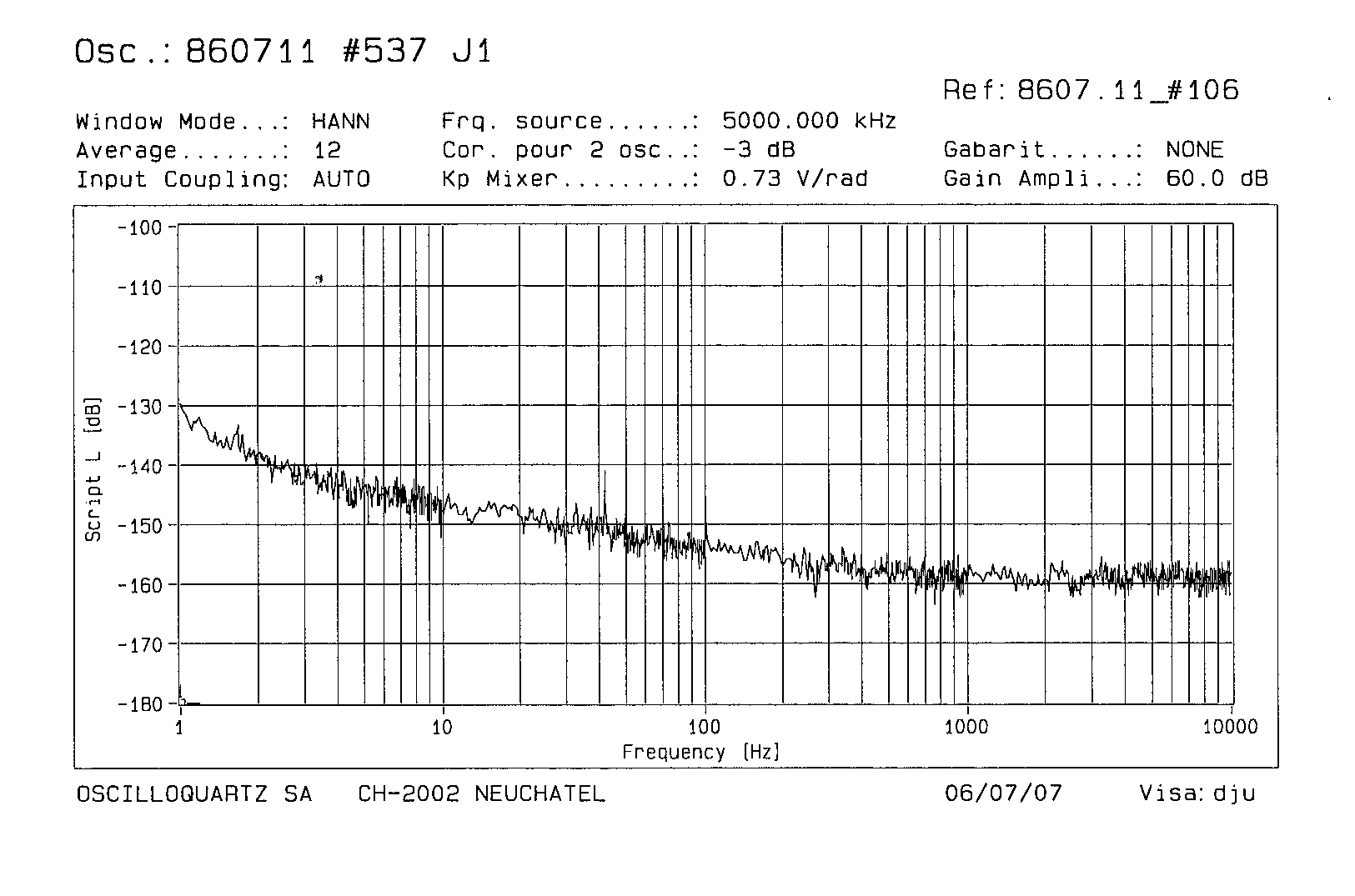

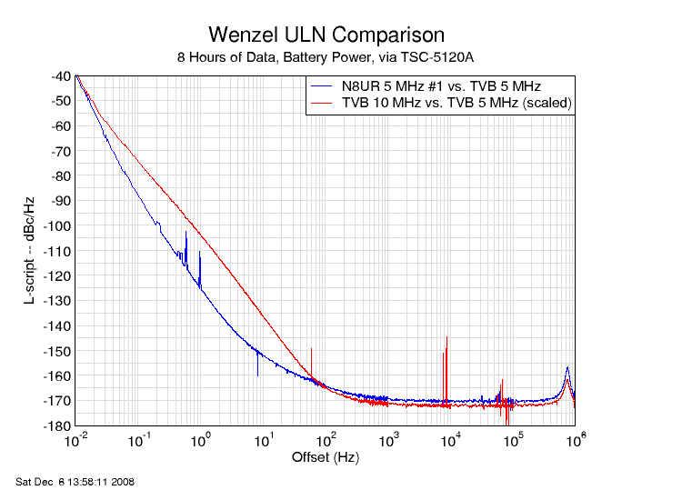

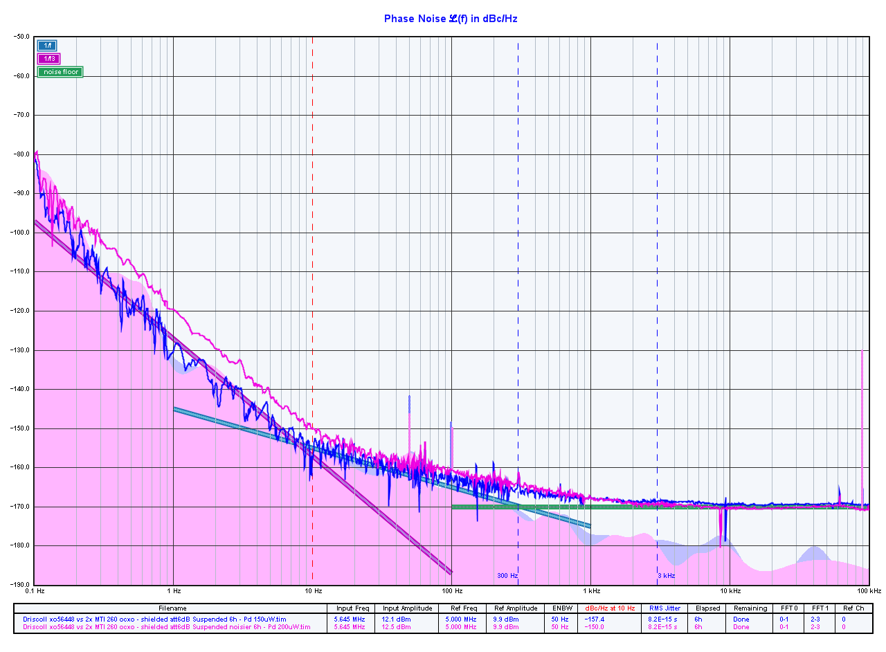

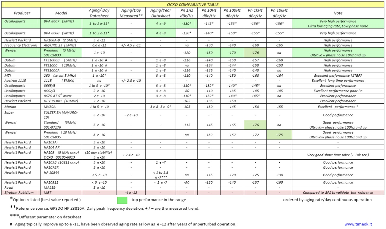

You can evaluate yourself the performance of the new oscillator with a simple comparison.
from left to right:
- SOTA oscillators on the market comparative table
- Oscilloquartz BVA 8607 phase noise plot
- Wenzel ULN phase noise plot
- New Driscoll design phase noise plot (as you can see the noise floor of the measurement instrument overcomes the close-in phase noise of the DUT, 0.1 Hz to 1 Hz)
Take a look at: -130dBc@1Hz and -157.4dBc@10Hz from the carrier, I believe that the plot clearly tells "how effective the circuit might be".

Andrea, you are to be commended on this effort, amazing results.
You've managed to extract not only extremely low phase noise close to carrier but also a very low phase noise floor. WRT the latter, this may not
seem that important but once we start multiplying to get 22 or even 45 M, on traditional designs that have sacrificed noise floor to obtain extremely low
close in phase noise then the NF will rise considerably after multiplying.
Recently I have become aware of a new super low phase noise 10 MHz Ref OCXO design by some people at the University of York. This design achieves
the following phase noise specs:
1Hz, -123dBc, 10Hz, -148dBc, 100Hz, -157dBc, 1k, -161dBc etc.
The Allan Dev is <2x10^-13 / 1 sec
Given that for the lowest possible phase noise, especially close to carrier, 5MHz is optimum, then the 'York' OCXO design is *possibly slightly better
but it's a very close call and we must also consider that this design is a collaborative effort by experts in the field. Link to white paper and
full schematic below.
http://eprints.whiterose.ac.uk/141563/1/08540461.pdf
Of interest to note, the 'York' uses a unique transformer coupled, differential OP design with the active device being an SSM2212 low noise 'audio type'
transistor as opposed to the usual RF BJT. One characteristic the SSM device does have is among the lowest 1/f noise for any device I'm aware of being
sub 1Hz. Most RF designers probably wouldn't consider using such a device however the Ft is 300MHz with enough current the high Cob is not such a
problem at 5 to 10MHz and low circuit impedances. Exactly how much the active device 1/f noise translates to close in phase noise, I'm not sure,
hopefully others here can clarify but the white paper alludes to some importance.
