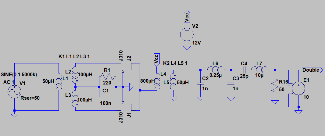

Some more context to the NIST doubler
The NIST doubler is quite simple construction ... if you supplement with proper filtering on output.
