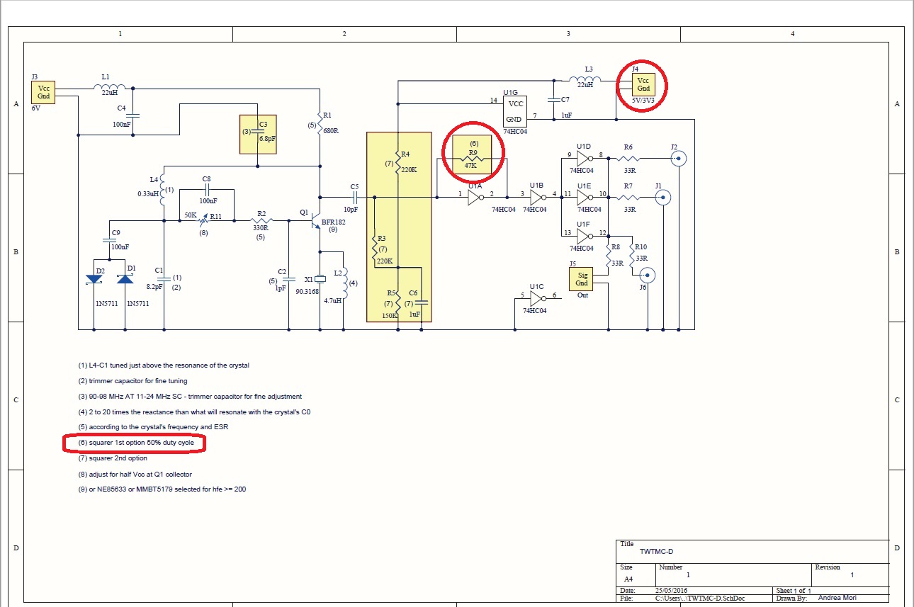

Can I use yours 45/49 MHz oscillators togheter the Chronus?

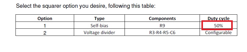

Are 3.3V CMOS type clocks with ~50% duty cycle as twisted pear Chronus needs?
The only working oscillator with Sc-cut 3rd overtone 45/49 MHz crystals is the TWTMC-D.
It supports 3V3 CMOS output with 50% duty cycle, as specified in the assembly manual.

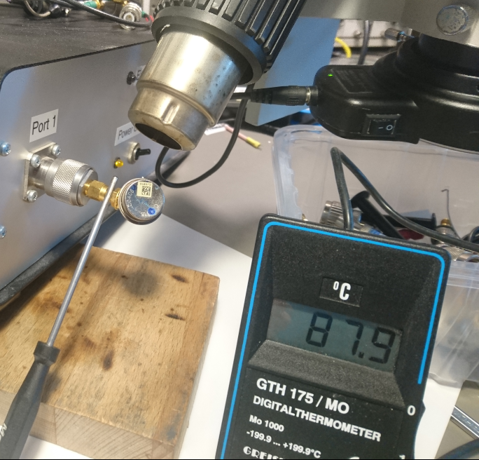

I have measured the SC cut crystal I took from the defective Morion MV89A crystal oven.
Pics are some pages earlier. I have checked the crystal parameters at room temperature
and at it's intended temperature.
nominal at room temp.

Nominal frequency at 87.8°C
F = 4999977.73472294
Q = 2210624.24356611
L = 5.31056260615351
C = 1.90793506338953E-16
R = 75.4698598161708
C0= 2.67067707950378E-12

88°C was produced with a Steinelt heat gun that was sitting on the
boom of the microscope. I wonder why my low cost DG8SAQ VNWA can
measure this and my R&S ZVB cannot. The reference frequency of the
VNWA was locked to my LUCENT GPS source.

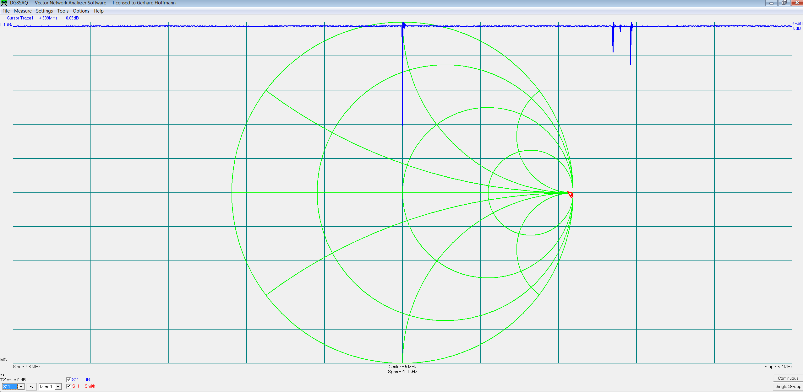

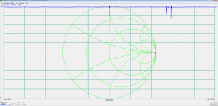

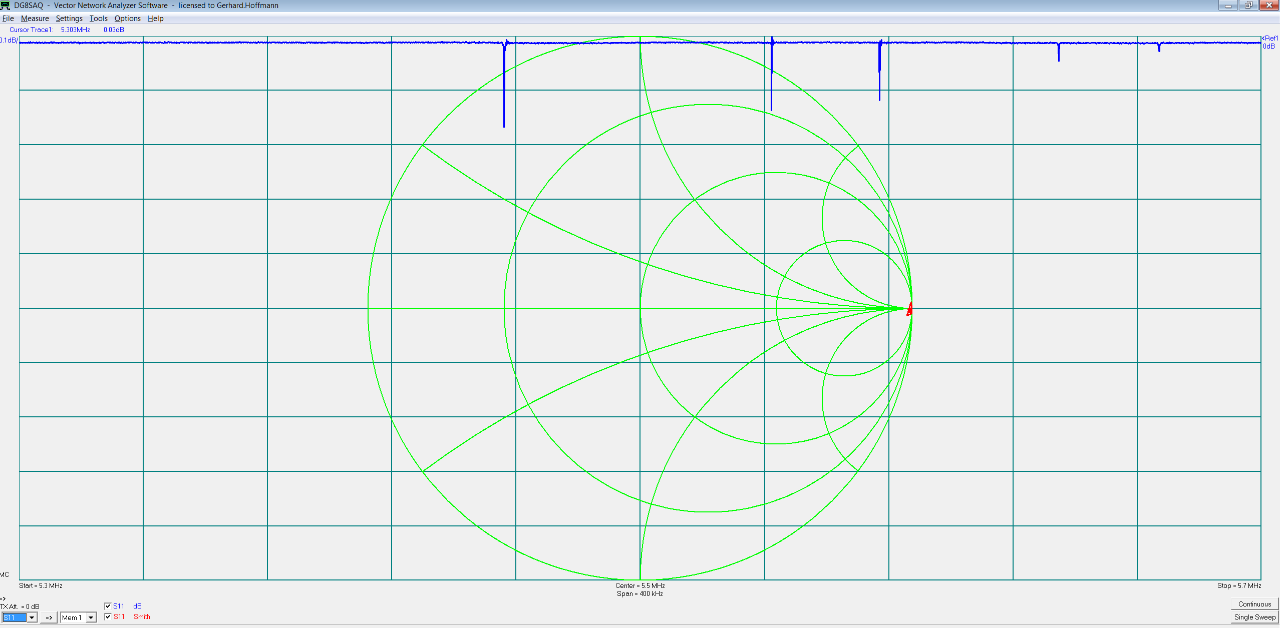

There are some spurii above the nominal frequency and above the b-mode.
I did not check them in detail. The time for a sweep is half an hour because
of the required settling time and the huge number of measurement points.
I you zoom in, they look worse. The 2 attached plots show some ringing after
excitation of the resonance, they are too fast. They create nonphysical results
because it seems that more energy comes back than is sent by the VNA.
That does not matter here because I used these plots only for locating the
resonances and not for using them for the crystal estimator.
Gerhard
