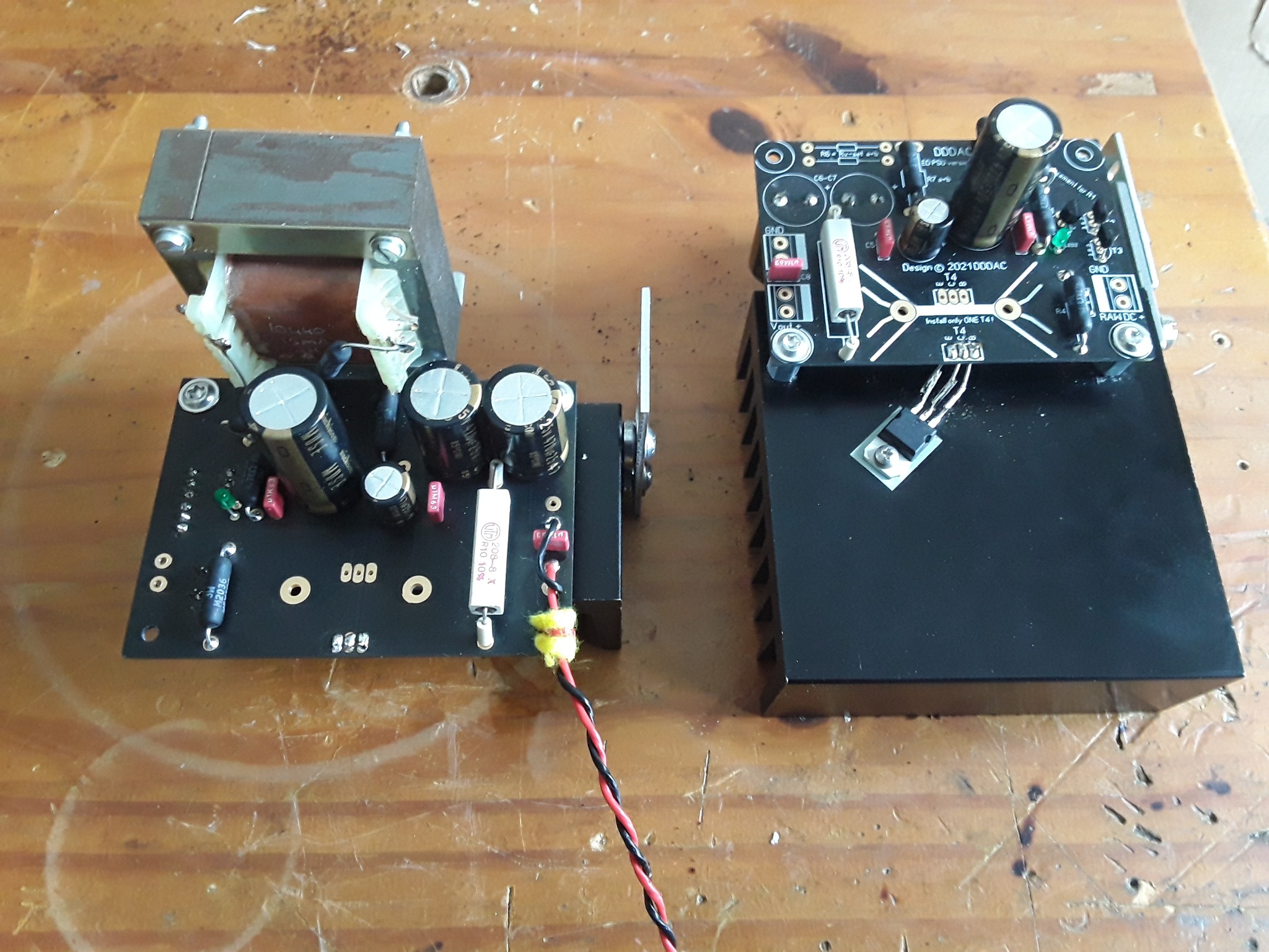

I asked Doede to make a reduced dimensions model of his regulated power supply because i wont use the rectifier and caps ( pre regulator part) . It allows me to fit the circuit board a lot more easily closer to the load.
With a separate heatsink you can use it for a Roon nucleus or other items that require more current.

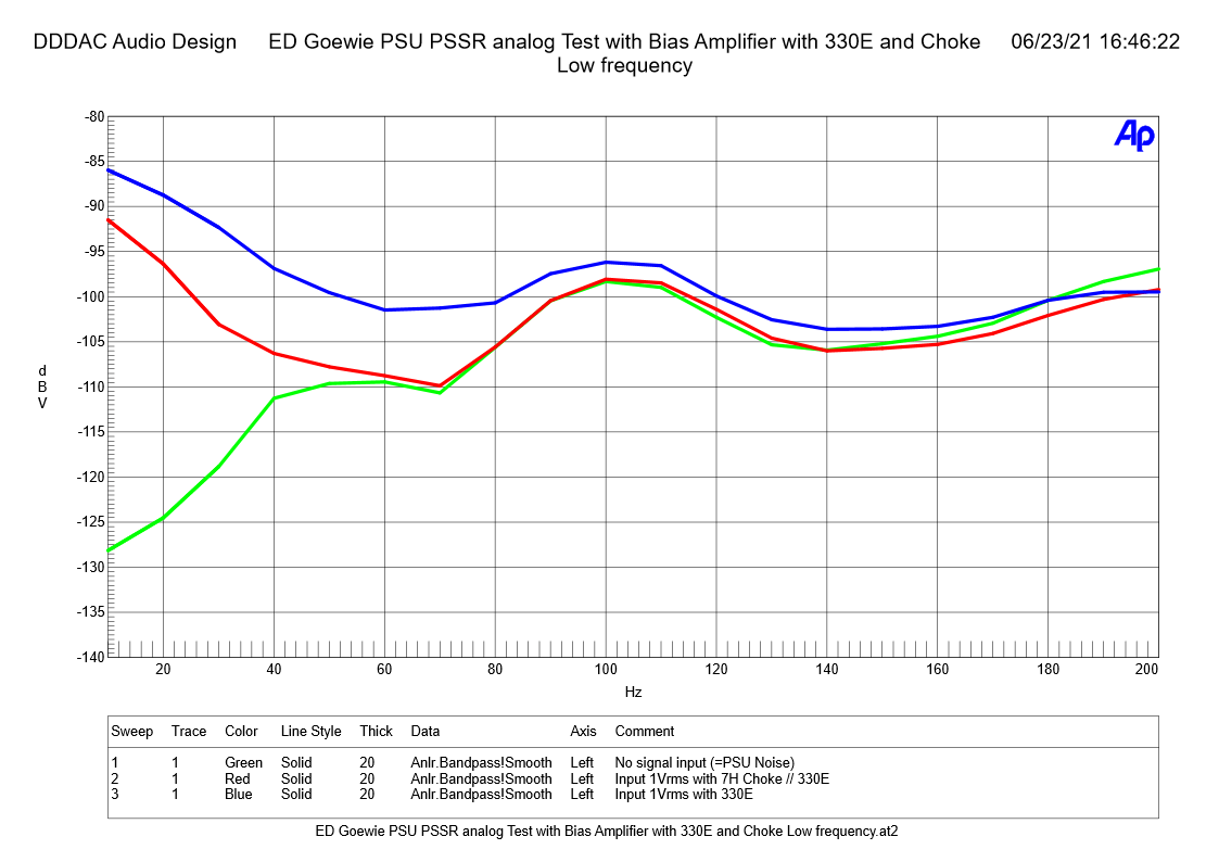

In the last attachment you can see the benefit of using a choke instead of the 330E resistor ( this was described in Doede's blog )

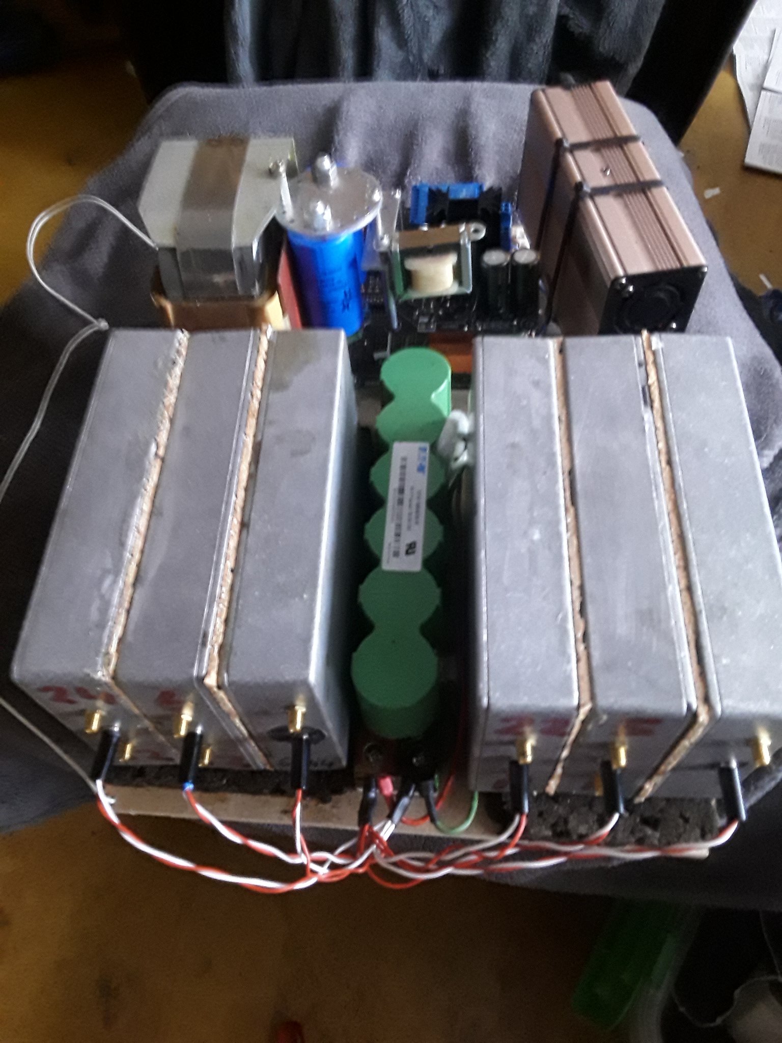

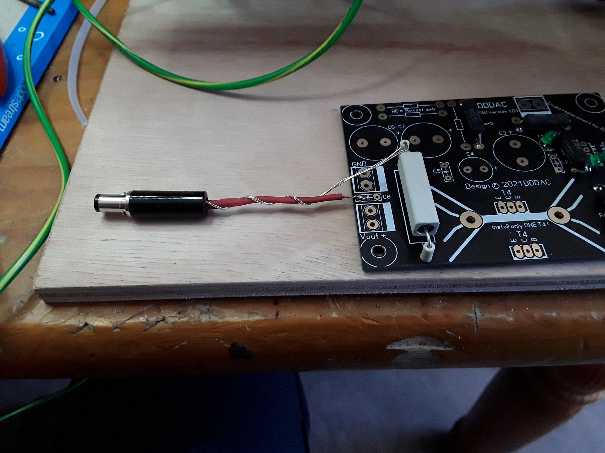

In the third attachment you can see the circuitboard and its power output cable as used for the Roon nucleus.

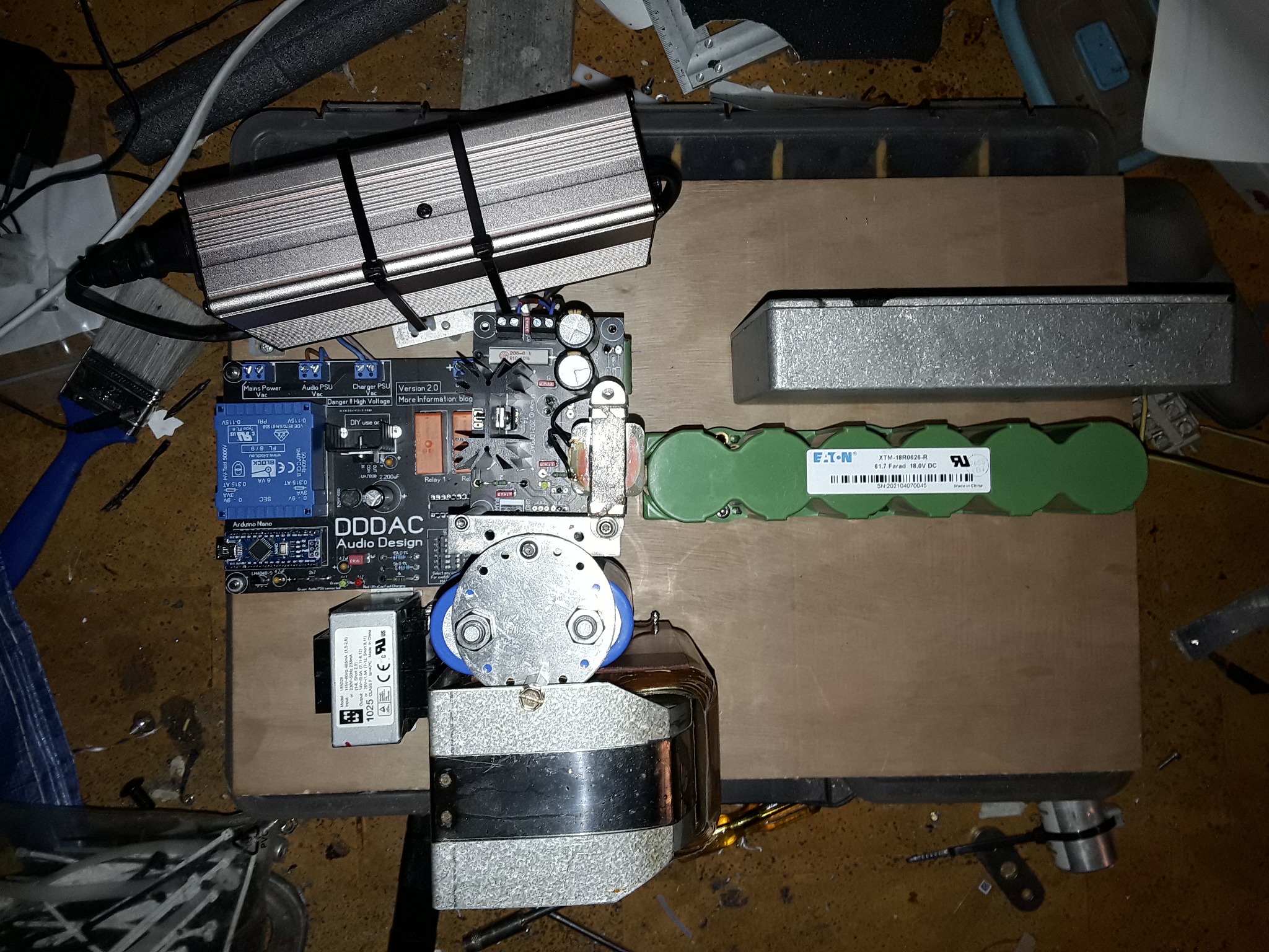

The second photo shows Doede's board to take care of the switching between the Asian charger and Doede's regulator with LC preregulation. Doede explained somewhere on this site or his own site how the big board is working. IF the batterie or batterie/supercap combo drops below a certain voltage it needs to be recharged and this can only be done by something like the Asian unit.

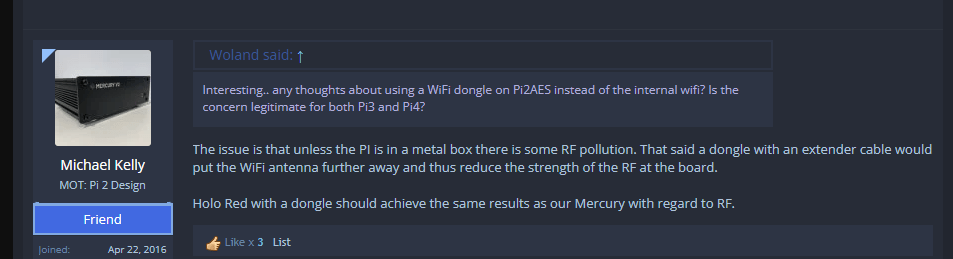

Hello everyone. I was reluctant to post anything because I felt I wasn't ready, but I have a bit more meat on my bones and wish to share. I was initially very confused about the noise which Andrea as well as @Blitz was talking about, but my mind is clearer on the matter now.
Andrea talked about the RPI platform being noisy and should be keep far away from the DAC. I think I know why. The RPI has RF noise due to being WiFi capable ... if this had only been mentioned earlier the confusion would have been far less.
This will probably mess with the clocks so yes. An RPI with WiFi onboard is a bad idea. Basically, the Pi unit MUST be RF shielded. As long as there is no RF transmitted or received in close proximity to the DAC/Clocks - outside or inside a project box - a PI streamer can live very close to the DAC/Clocks. If there is RF noise, be that from a WiFi source or a PSU itself, then yes, there are issues. So obviously this needs to be taken care of.
I know Blitz have a thread called Path to noiseless Linux streamer... which I will go over - his findings might mean a world of difference, or not, that is what I will find out by reading, but in the meantime there is something.
Assume we have taken care of the RF issues, if we then look at the noise levels from the Pi2AES and the Holo Audio Red, they are really good, meaning low and shouldn't pose much issues for the FiFo or DAC. These are "dum boxes" meaning the OS and media player is a sub topic of which is better, but the hardware is not the issue here, at least in my opinion.
https://goldensound.audio/2023/02/09/holo-red-streamer-ddc-measurements/
https://goldensound.audio/2021/07/22/pi2aes-streamer-measurements-and-5v-psu-mod-instructions/
Link to a HOLO Audio Red review and mentioning of the RF issue: https://www.superbestaudiofriends.org/index.php?threads/holo-audio-red.13128/#post-401522
