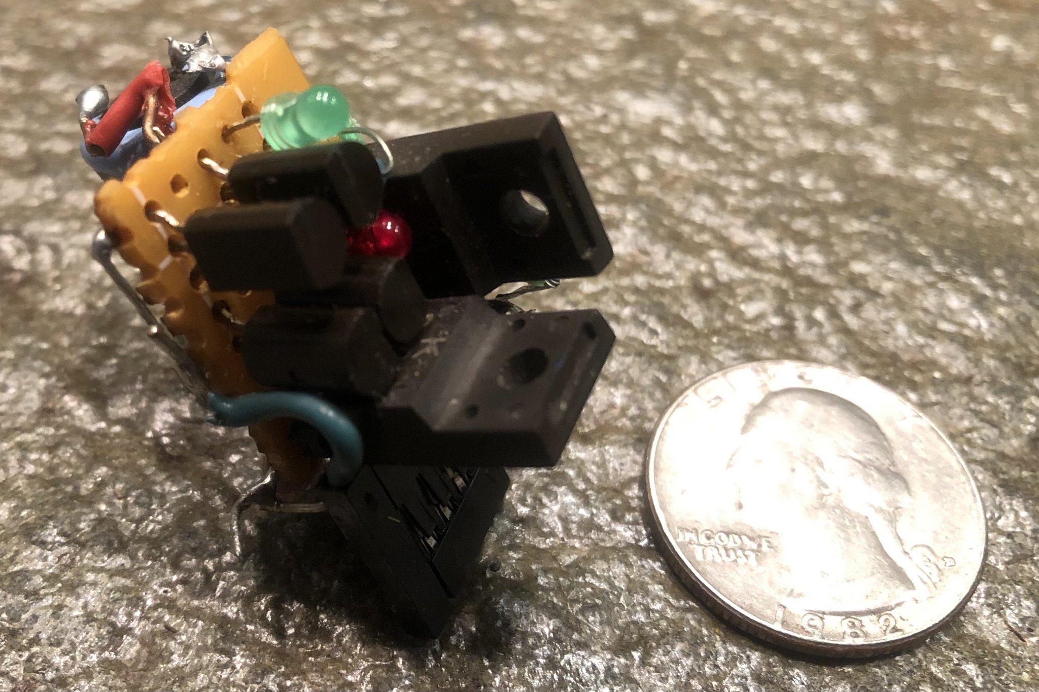

Sure is, I missed that one. Both quiet and interesting. I use the LTC6655, the LTC6658's single output predecessor as a voltage reference. Apparently the 6655 doesn't stay precise enough over time for the nuts and volts guys, (and bless them, my HP3456A has been spot on for longer than I've been alive) but it is a seriously low noise reference and we don't care so much about absolute voltage but rather 1/f low noise, no? My clock reads the same on the counter whether fed 3.6V or 3.0V, the working range of a lot of batteries. The LT6655 got the Jim Williams treatment, the app note on how he measured 775nv noise is an incredible read and a mountain to climb, in an of itself.

The LTC6655 and a LT3042 yields the lowest 1/f noise PSU I've ever seen, for feeding a clock. It's a lot of IC in some tiny little packages, though, conceptually a far cry of a hefty choke or two. I feed mine from 15 year old, 2000ma, 1.2V, NiCd cells (how quaint!).
Oh, and if you want to go purist, all you need is a 3.6V NiCd charger; 3x 2000mah 1.2V cells charged to 3.6V (not standard) downrated to 1500mah, with a 30ma draw nets you 50 hours of runtime with, with an eight hour cell optimal recharge. Two strings gives constant operation, all about the size of a small choke.
https://tf.nist.gov/general/pdf/1133.pdf
I wouldn't use this for a full range audio-spectrum supply, but it works a treat for clocks. Zero junctions/actives in the supply path.
No kidding? I thought the ultraBIB bottomed out at 5V, with a 20-something volt input. I still use Salas’ “Reflektor” core for a 150ma 3.3V super-shunt from a ~5V supply…
