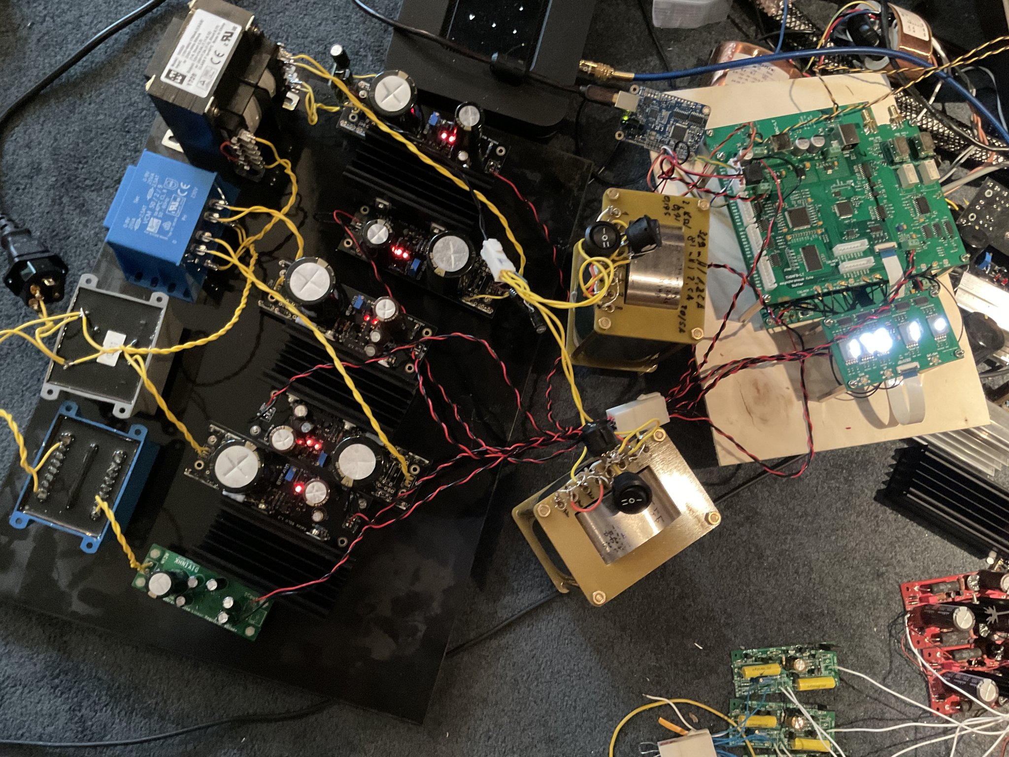

Quick interim update: The fifo/dac plays 24h each day...so now 5days...bass becomes fuller, overall nice, natural, warm tone...upper mids like in female voice best I ever heard so far...no nasal coloration at all (a good recording to check this is Macy Gray Stripped from Chesky...if the voice is more a torture than a pleasure you know you have work in front of you...but with Andreas Combo its very free, natural and a pleasure to listen to). Same with Jose Carreras "Misa". No nasal coloration at all, never been so good before.
Room for improvement ? Yes, More air and deeper room is needed...so i let it burn in further and start experimeting with lower Vdd and Vref...Mouser just delivered the need parts to be changed for the Ultrabib to get down to 3.3V...but I suspect the air comes with another week of burn in anyhow...right now it reminds me a bit on how british speakers in the 90s like to play...warm, lively, wonderful in mids...a bit shy in the trebles...or a bit to grainy Iso200 vs. Iso64...Ektachrome vs. Kodachrome (in the trebles).
So, its still a stalemate, but Andrea's DAC/Fifo took the lead as most natural already nice improvement in bass/natural tone...while the Soekris delivers a bit more Hifi-Show-Effect (meant in a positive way)...or deeper room and more air at the moment...i have to admitt that I really like this and dont want to trade in...have to stay patient...

I am a bit scratching my head...my hypothesis at the moment:
To illustrate it feels like you go from a very good kitchen knife which was an allround tool, good sharp steel, well maintained [Soekris) to a brand new japanese ultrasharp knife...which has strengths but...
- The DAC is ultratransparent and shows you anything what is going on in your PSU...you hear the PSU
- Effects on changing PSU stuff like diodes, LC filtering etc still need to be figured out therefore...it needs much more care and will hopefully give you unbelieveable transparency with tone and muscality, but its not a plug and play.
- Will try Different, lower voltages and lt3045 regs/ reflektor regs, but as well nice pure passive supplies
- I will bring a Drixo-Clock now into the game as it is built and ready and see what this does before riding with the crytek clock a dead horse potentially (well, this would be a surprise if this changes tonal balance)
- I will play with IO Cards like waveio vs. usb2i2s
- More burn in...

Today I spend some time to give the Vref supply the option to become LC input...and as Mark suspected earlier, this DAC reacts quiet a bit on the sound of the PSU. The issue with treble run in front and lack of tone /body/lack of bass are much better now...much better integrated now...I will now play with choke quality, going from LL1694 to some amorphous etc., different inductance/resistance etc... Lets see how sensitive this is...fortunately i have a stock of chokes...
I have read as well some articles from Ti and Analog about Vref quality and noise to be as low as possible (besides many other parameters)...so I can see that a better raw supply for the regulator makes a difference. Lt4320 with Choke-input is a good starting point (especially with a shunt reg behind...).
Update:
Changed LL1694 to amorphous core custom made from Alexander (50AE)...from 160mH and 1,7R (LL1694) to 80mH and 0,7R...yes, now we are talking...speed and tone...will later try nano chokes from Alexander...but this PSU is as sensitive as tuning a tube amplifier PSU...and that is great news !!! So much potential !!!!
...and all of that still with bloody cryteks...
ps...lets be clear...this is by far not the final non plus utra PSU solution for this DAC. its just the beginning to understand its sensitivity. Which is high. I love it. So much fun. I love Soekris DAC as well, but he never gave us this level of control on the PSU side. And they sound still like sisters...but Andrea is the bigger sister...and i will start soldering the Battery supply now and compare...

Hi Blitz, I'd been wondering if the ideal diode bridges worked with LC-filters...
So your circuit is: Mains power --->Tx --->LTC4320 --->LC filter ---> Shunt --->DCV/load?
I've been using: Mains power --->Tx ---> diode bridge --->LC filter ---> Shunt --->DCV/load
Do you have any waveforms of the above, at the capacitor to ground with a load attached?
I'm guessing the LTC4320 won't work with a center tapped Tx and choke for a bipolar supply, have you tried this?

I tried a lot with the Lt4320...i think even CT worked (documented somewhere in the dev. forums)...but not worth it. It is made for a full bridge. Choke input works nicely, but the small C for the board (10-50uF) is needed. Dont confuse lt4320 with lt4320-1 ...sounds bad.
My circuit is Tx--lt4320--L--c---shuntreg(ultrabib)---load.
I feel the R1/Choke of 1.7 ohm/ 160mH already has too high R...we talk the same language...narrow river is the right term...got a lot of experience on that when playing with Tube filament settings...actually the effects are similar, but with the DAC like magnified
I ask my self what happens if i go completly passive with high quality components LCLC....without regs for Vref...ripple will be nowhere...no precise Voltage...but really a problem ? it does not fluctate wildly when only 30 mA is what is needed...but sofar each time a passive soltiouns always killed a regged solution...be it shunt. tube shunted, transistor shunted...let alone serial regged...
I just reduced the L from 80mH /0.7R to 20 mH /0.175R...and i like it a lot better...this is on an amorphous core...i will now use this as the orientation to go to nano...but low R and high quality cores...wow...this DAC is a killer...frightening...tone and transparency come together
