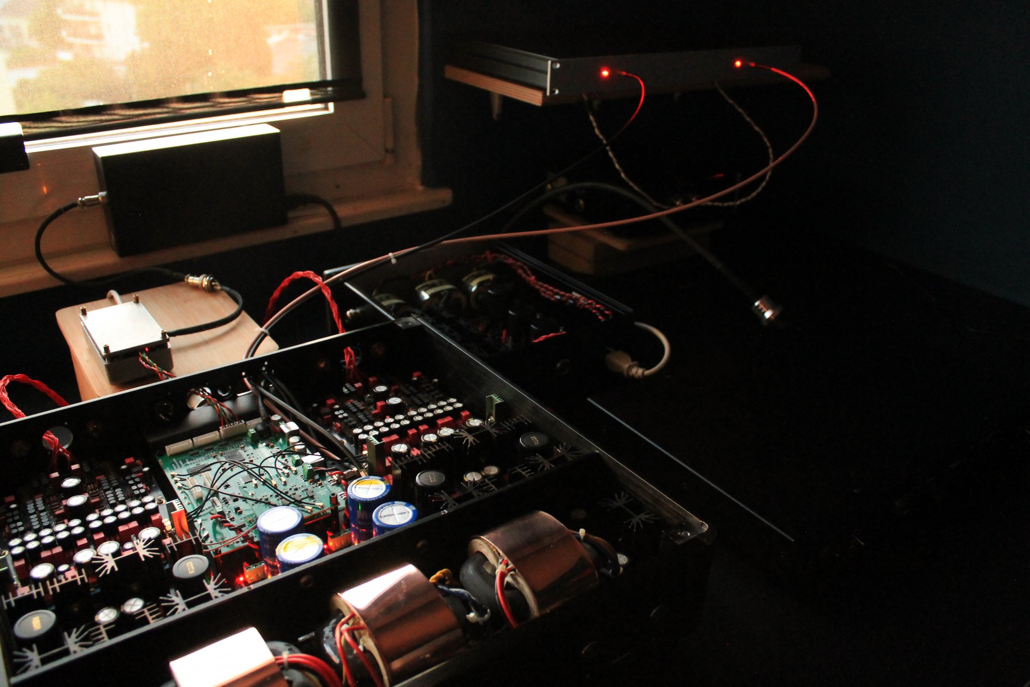

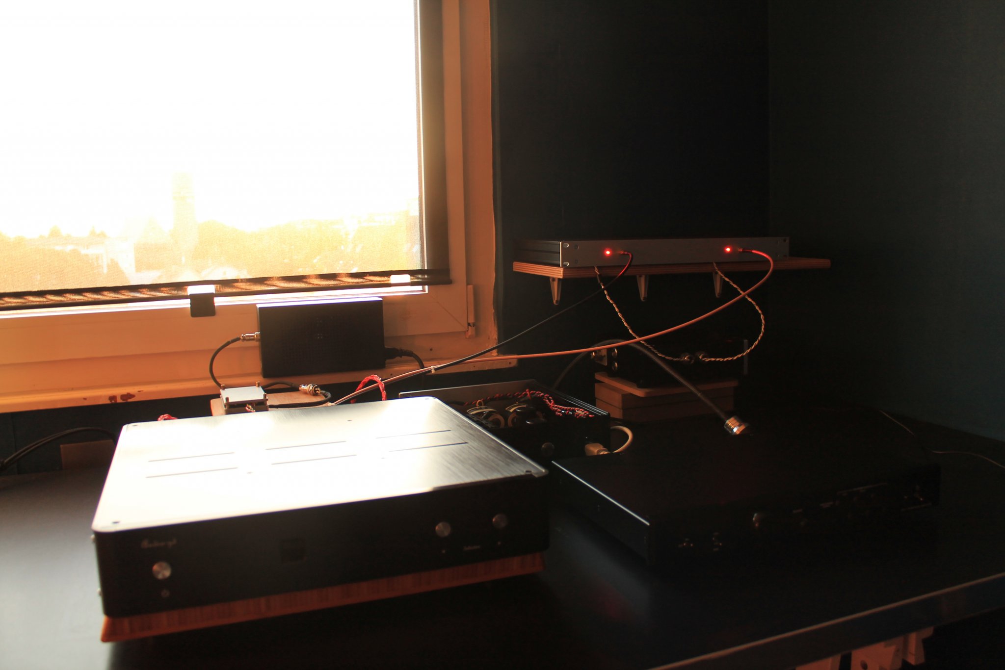

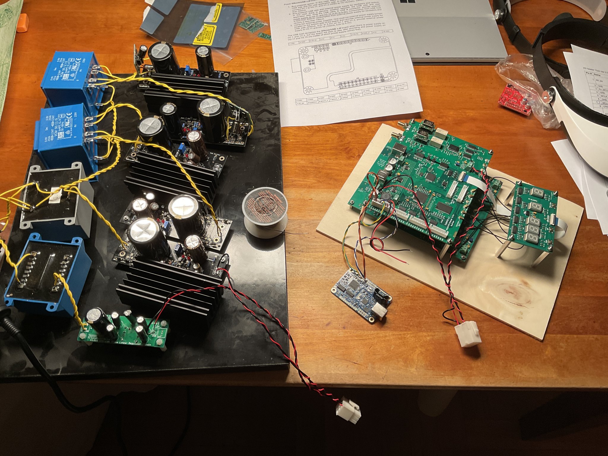

I am in the process to finish my Andrea Mori - Setup and compare it with my Soekris Dam1941 setup...so, it will consist of fifo, dac-lite, exo and driscoll at 5.x crystal and later battery supply.
I wanted it as a learning experience, so starting with
I will start even intentially with crystek clocks 957 and than move to andreas exo and than to driscoll just to see what does what and report. once i see if driscoll or exo sound different, i will order the next batch of boards and give the 6.x crystal to the winner.
i will in parallel upgrade the power supply, so any thoughts on

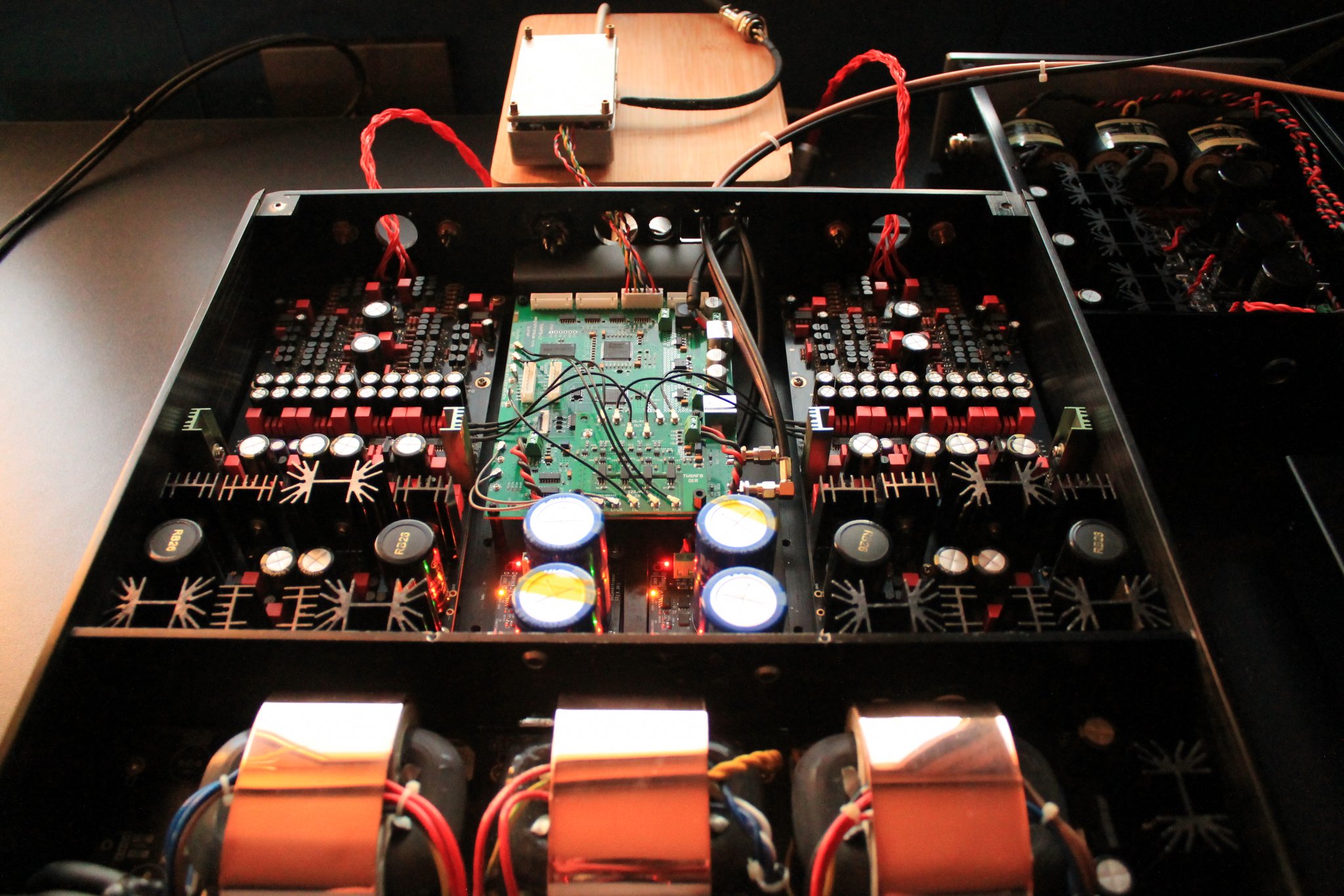

- 5V and 7V powered by Ultrabib
- 3.3V and 15V powered by DiyinHk lownoise modules
- xformer all potted el two chamber types
- powering of the usb board ? From the fifo power out or separate ?
- two chamber el types vs. r-core are appreciate
- ultrabib vs. r-reflektor or other regs
- ian's oven kit for Andreas clocks ?

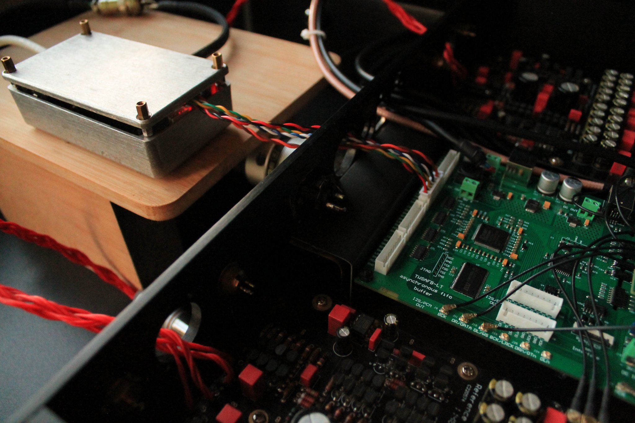

Some delicate soldering 😉 just to get me up and running quickly rather than using the supplied connector, will use a more robust setup later before I move it to a case. Great to hear another pleased customer discovering the fruits of Andreas work 👍 👍Sligolad,
How did you connect the UFL cable at the Fifo input🙂

Thank you. I was talking about the uf.l sockets on top of the is2 input pins of the fifo. Hand soldered...a steady hand! I've chopped off the ends of Uf.l leads when I had a waveio card and soldered the cables to the pins. They always broke in the end but I might try again with thicker uf.l cables. Might have to ask Andrea to provide alternative input socketry if his board ever gets revised.

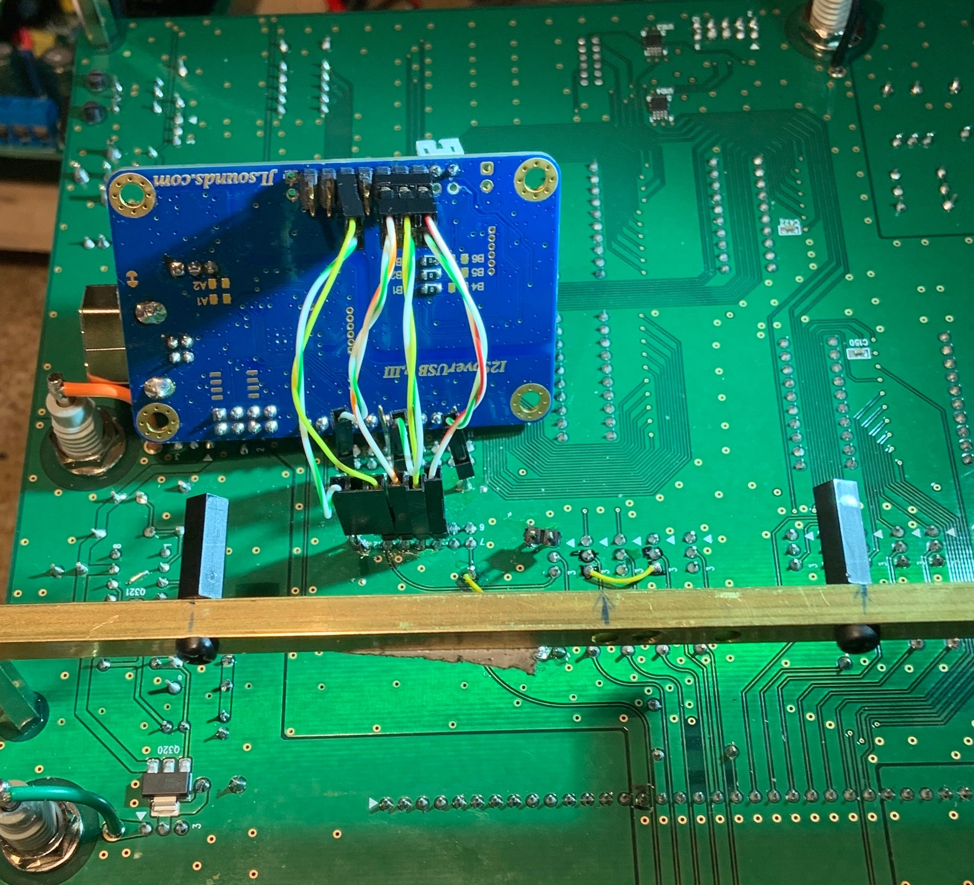

I am in the process to integrate the i2soverusb with Andrea's fifo...I am a bit new to i2soverusb board, let me see if I got it right from here:
http://jlsounds.com/uploads/I2SoverUSB v.III.pdf
So, if I got it right the configuration is:
"I2S like protocols on board oscillators
AK4490, AK4493, AK4495, AK4497 and all DACs in I2S like protocols.
On MCLK_out_1 (H3.7) pin, one will have 22.5792MHz/ 24.576MHz MCLK."
...which leads to...fundamental I2S-Config is basicall Jumper B1 and Jumper B3, thats it. Powering of the clean side separately over H3.17 and H3.19. OK.
Connection scheme I2S (I2SOVERUSB-FIFO):
H3.11(BCLK_I2S) - BCK
H3.13(DATA_I2S) - DATA
H3.15(LR_CLK_I2S ) - LRCK

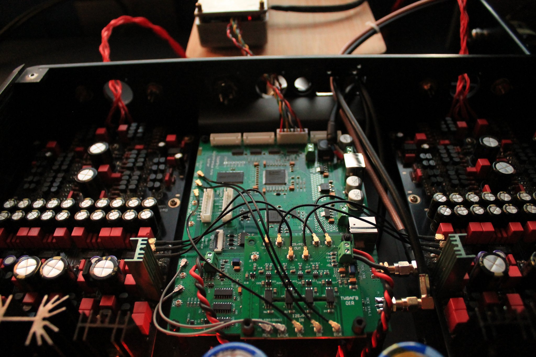

The FIFO does not need or use the USB board MCLK.
Also, I2S signals are RF. Each signal line should be paired with its own ground wire. One example of a reasonably good approach to wiring is attached below.
Mark, thanks a lot...that helps...surprised about the grounding logic, i am always a bit scared for ground loops, but now I will try as you suggested.
Crom, At some point I might try as I am using currently the same crystek 22.x/24.x im the fifo...my approach is always to start with the most standard setup and than start to improve...but as I use im the end 5/6 mhz clocks, this is not a lomg term option really...

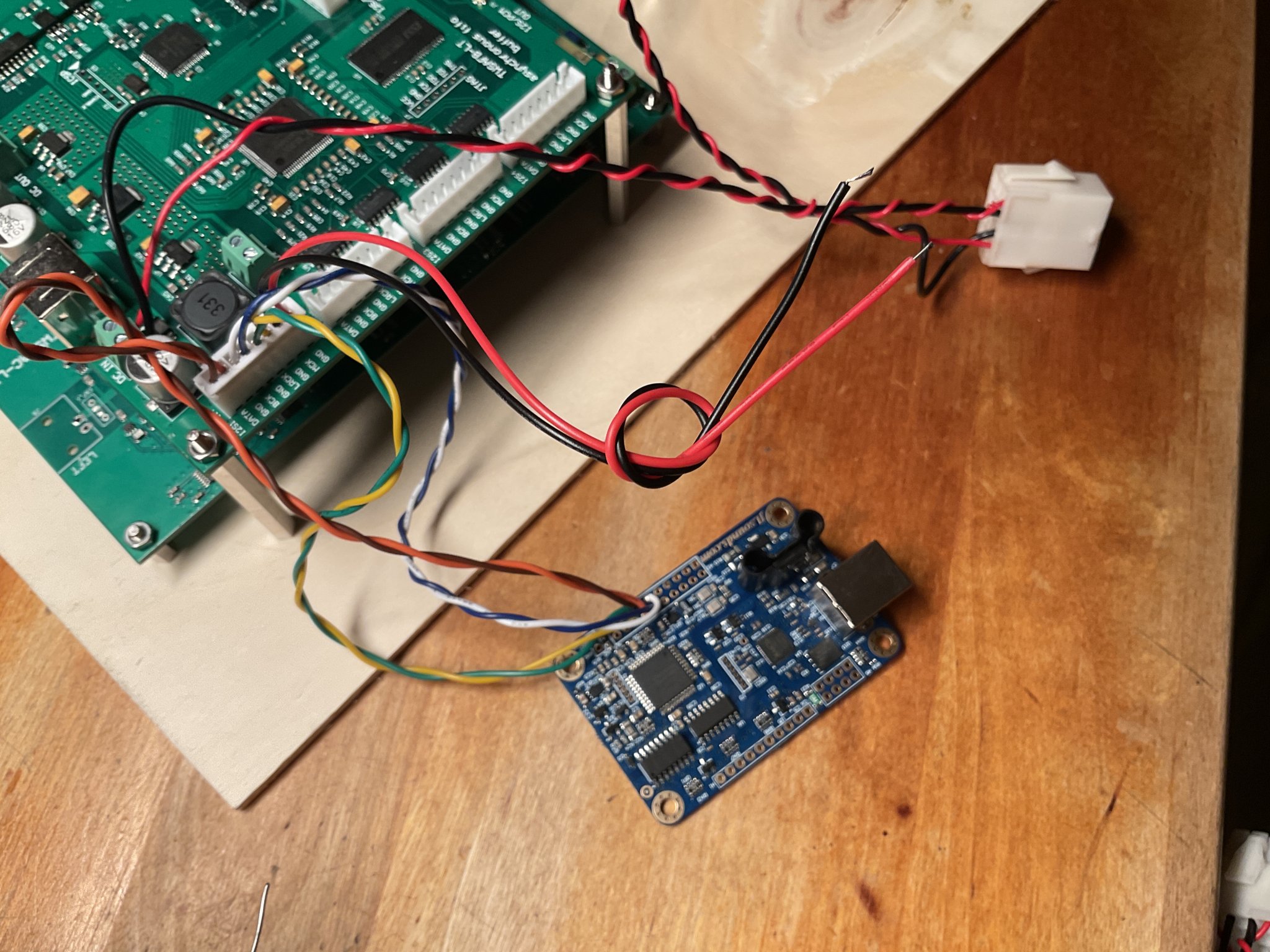

update...applied as suggested by Mark..no MCK connection to fifo and twisted pairs for the rest...
That, and we are typically trying to keep such wiring very short length....and twisted pairs for the rest...

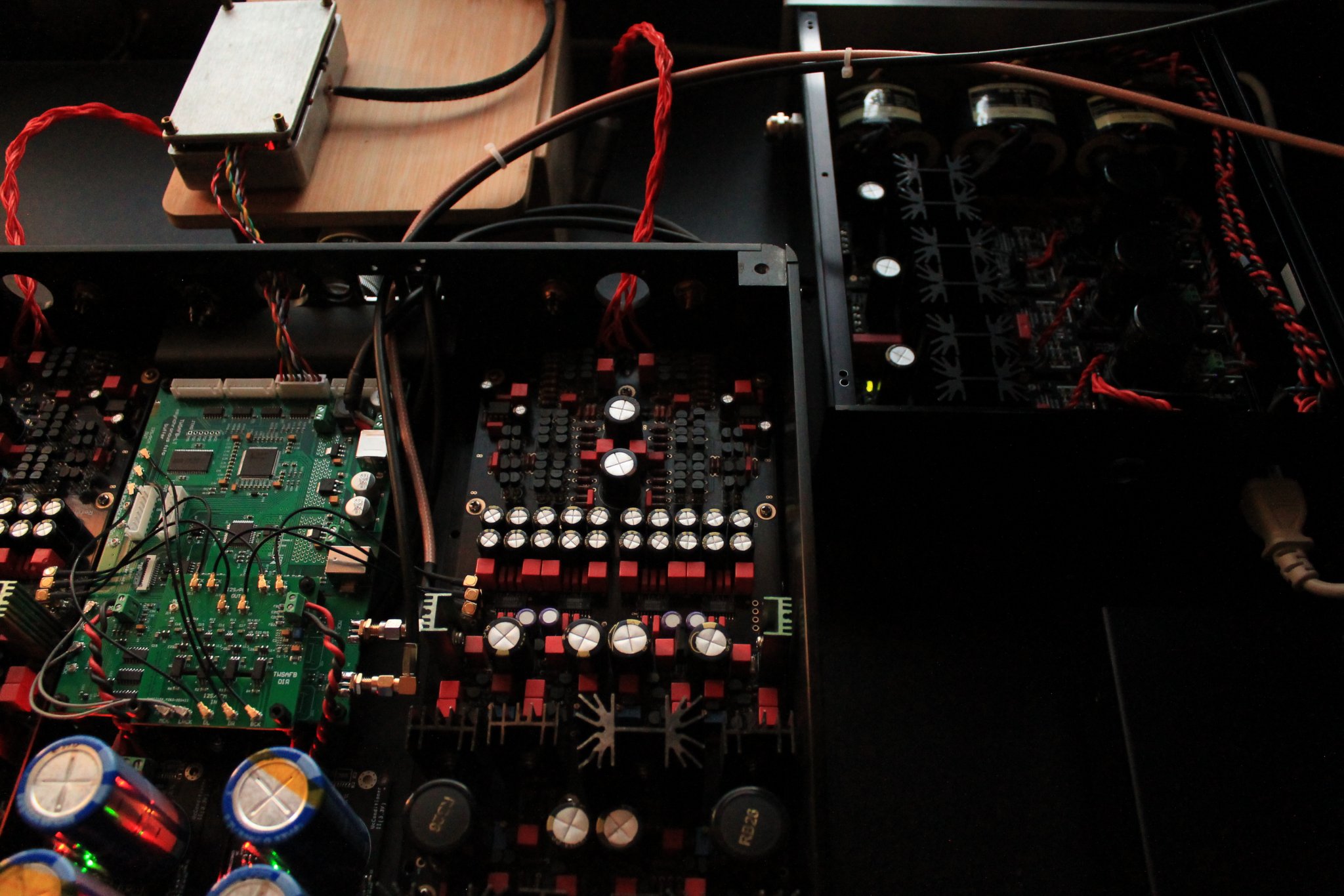

OK, mine is up and running...I will let it burn in now for at least 24h...and than start to do listen more seriously...intentionally I start small with Crystek clocks and than improve the setup step by step. But the first 5 min from the cold start sounded already very promising...very analog, soft and high resolution...more on the warmer side but with hig resolution...very natural...but its too early to really judge...nothing is burned in.
I am as well curious if the magnitude of the Vref voltage level will make a difference in sound...right now I am at 5V to get the max amplitude out...might go down to 4V and see how that sounds (besides not as loud...). But if the hypothesis is true that the sound is highly dependant on the qualtiy of Vref...nice area to do experiments with...different regs...or even maybe pure passive LCLC ?

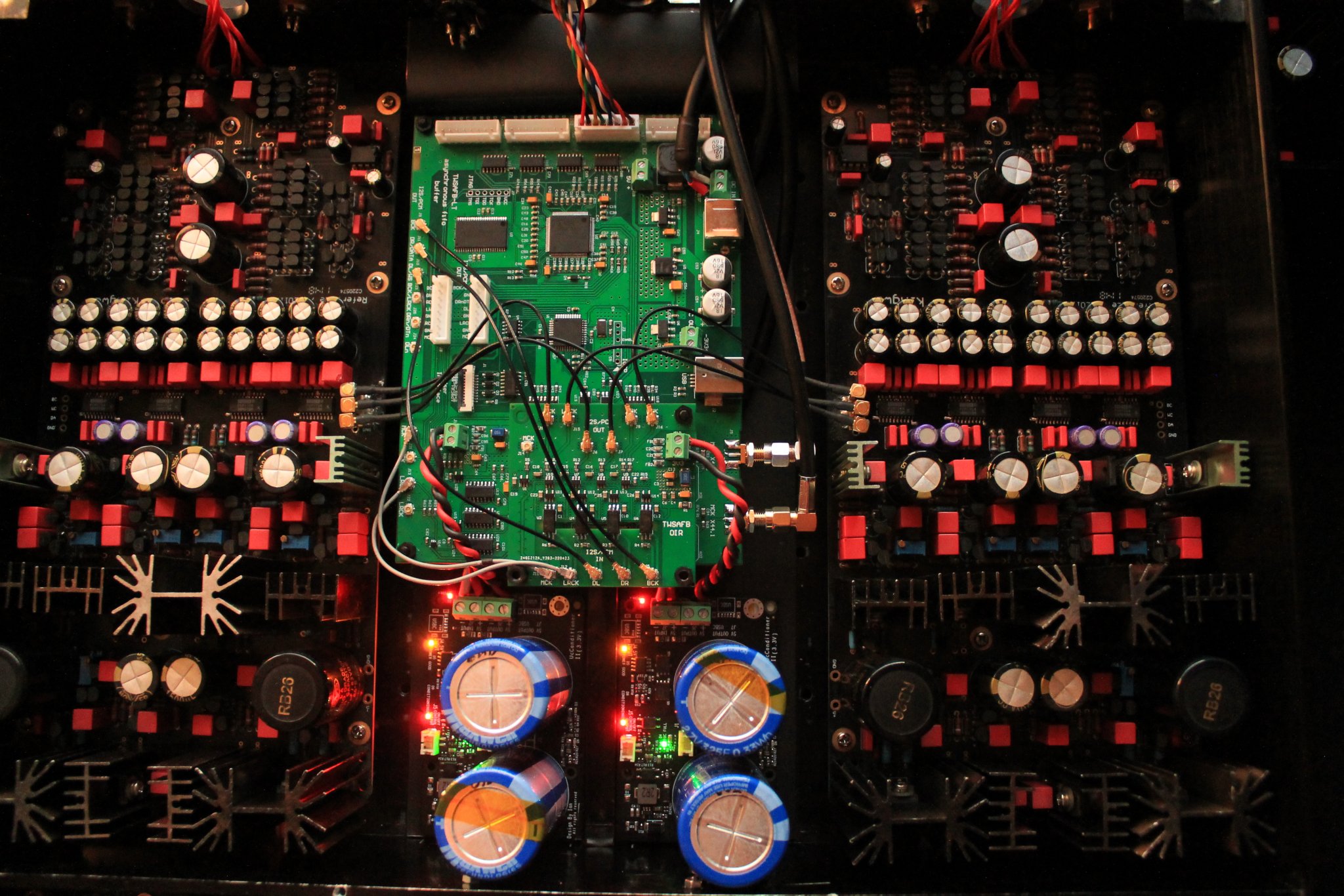

The FIFO Lite is installed in the DAC (Audio GD-PCM 1704K), The source is a Odroid C2/Volumio,the Fifo is powered by 1 Reflektor-D for the 7V and 2 Reflektor/ UcConditioner for the 3,3V, Modulus 386 Amplifier - Bryston BHA 1 Preamp, F.H Speaker, Sennheiser HD 800.
The Fifo exploit all the potential of the clock board TWTMC-DRIXO-11/12 MHz, I now have a quality source,
I was surprised by the quality of the Andrea Fifo, I did not expect such an improvement,I rediscover discs that I have known for dozens of years,The cymbals are super well defined,The medium is ample never aggressive,The bass is like on a master's band,super dynamic.
Andrea you succeeded in your bet with FIFO LITE,thank you.

That looks like a very nice, clean build...congratulations...! Mine is still on a breadboard and burning in...one question: I used ultrabib nearly everywhere as I had them on hand...Reflektor vs ultrabib in this application...any opinions /advises ?
it is interesting to see how Andrea's Fifo/Dac will compare once its burned in to the Soekris dam1941 (no, it did not surpassed Soekriś DAC yet...lack of bass and some rough edges in the trebles, but very nice transparency in a natural way, deep room and lots microdetails)...For sure its a bit like two sisters of the same family, not saying they sound the same at all, but they have a similar character in reproduction of dynamics and I am pretty sure that Andreas version is very sensitive to the power supply you give it as no regs on board...which is great in my view as this gives us a playground to learn.
I will for sure give it in the end a LC raw supply at least, maybe even try pasive lclc...Lt4320 and germanium diodes like with the Soekris and see how transparent Andreas DAC reacts to it...
...and I might order the dam1021 kit from Andrea and a latest version dam1021 from soekris as I suspect it might be that I do like the flexibilty of the Soekris filter banks and TNTs filter work...in the beginning i asked myself why anyone would order this as the DAC board of Andrea is not that prohibitive expensive and you could go straight from the Dam1021 to Andreas DAC, but i think now it could be very interesting.
