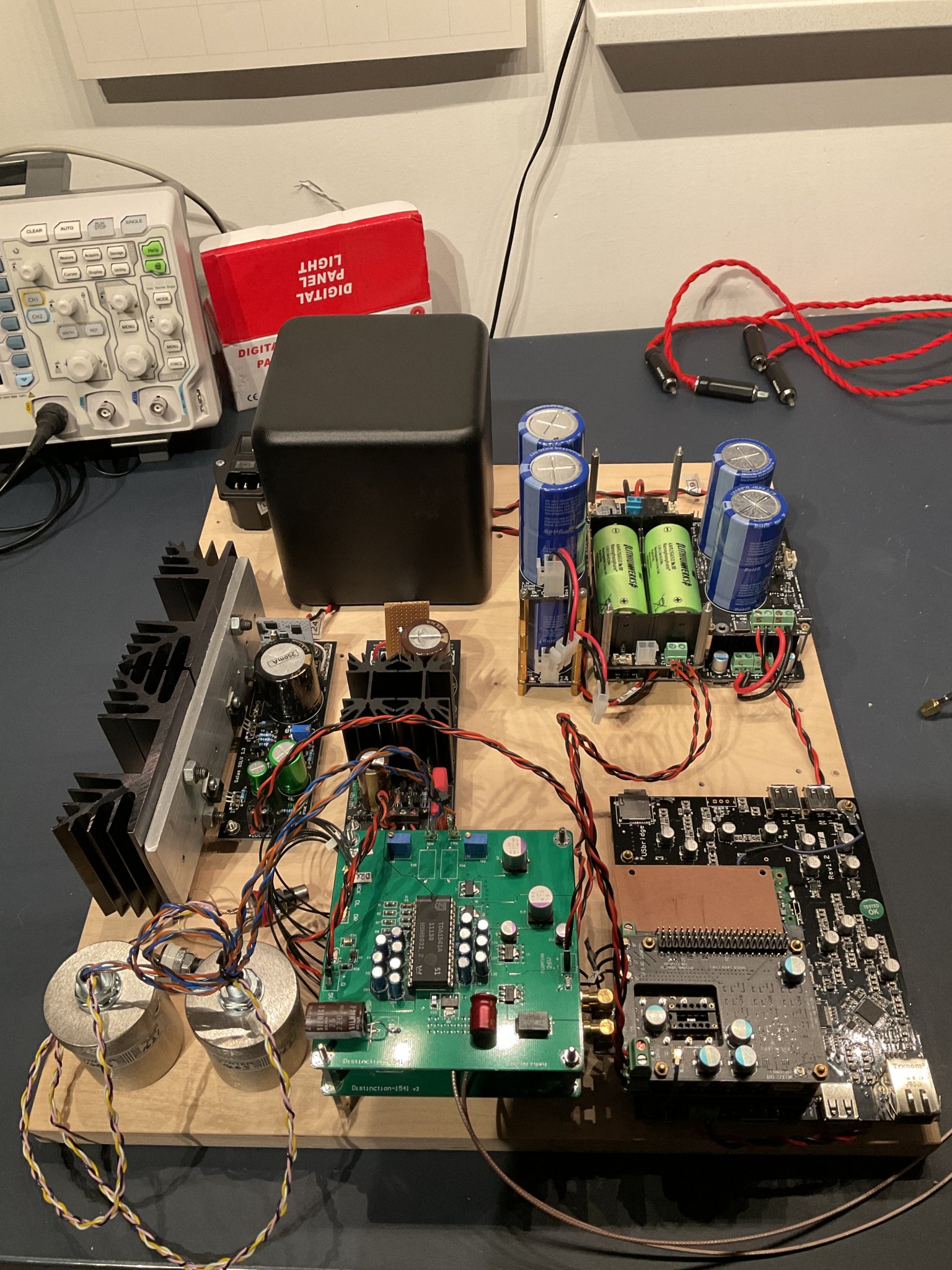

I do beleive the parts selection and layout on the tda1541 square board is far to be optimum due to too much inductance due to the far caps. Also the simultaneous board is making too far added wires length after the fifo. I had the same issue with Ian I2S to Pcm board...it ads length and the mastering clocking slaving saves not all. Chance is these old pcm chip and speed are less sensitive to the jitter than nowadays delta sygmas.
Also I find all thes uka nichicon blue caps to be terrible sounding, despite in the audio range of Nichicons this is really one of the last part you want to see in your dac. Also some caps parts you do not want to see around the tda1541. I never liked personnaly the low DEM frequency with big capacitance values of the 14 DEM caps. It is liked by some because of the bad power supply of the three voltages and some things they didn't understand about its grounding with the chip due to the three voltage rails.
The last Aya5 despite I have not I know it is sim mode on the same board than the dac and has two ufl pads for clock injection (I asked it to Pedja Rogic...wanted vias for Andrea squarer but Pedja couldn't but offered gently the possibility of ufl pads to overpass the onboard Crysteq. All of this imo will drive your dac on the further level.
That said it is just constructive comment in order to push it even further. From what I see it is already a beautifull and awesome diy dac and work...congrats 🙂

The ufl is 100mm long, maybe I can buy shortly but I don't think 2-3cm is a huge change.....he had been blamed !
you said the uka is not good... which one you prefer?
The delta sigma is so far from tda1541a...
And I try 9038pro dual mono in thrue sync.
Next step is feed also tda with +5-5+15 inductive shunt psu...
The ryanj supply use lt431 and lm317... no bad... Good result, but for best result i need another stuff...
I really think the tda needs linear SERIE regs for its 3 rails. Try pan Fr and Fc for the digital. Read some Aya2 audial blogs...

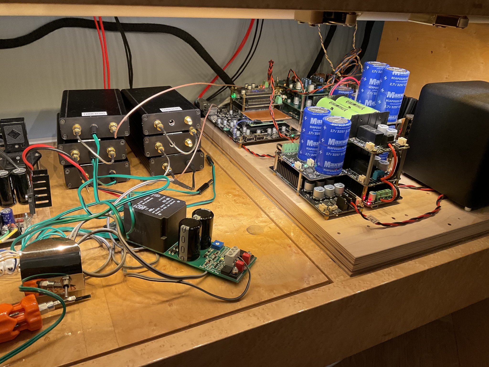

This looks very interesting @ilgavro!
I also use the boards from ryanj but in balanced PCM mode and with sowter opt.
it is fed with Ians fifopi q3 and the excellent 5 and 6 mhz clocks from Andrea (They are the best upgrade one can get for digital!)
I am very interested in his fifo board.
@diyiggy I am very fond of my current dac, you mentioned some flaws that I also though would be worth to change/improve but I started out with the standard build and it is so good that it is running 5months now without the urge to change it.

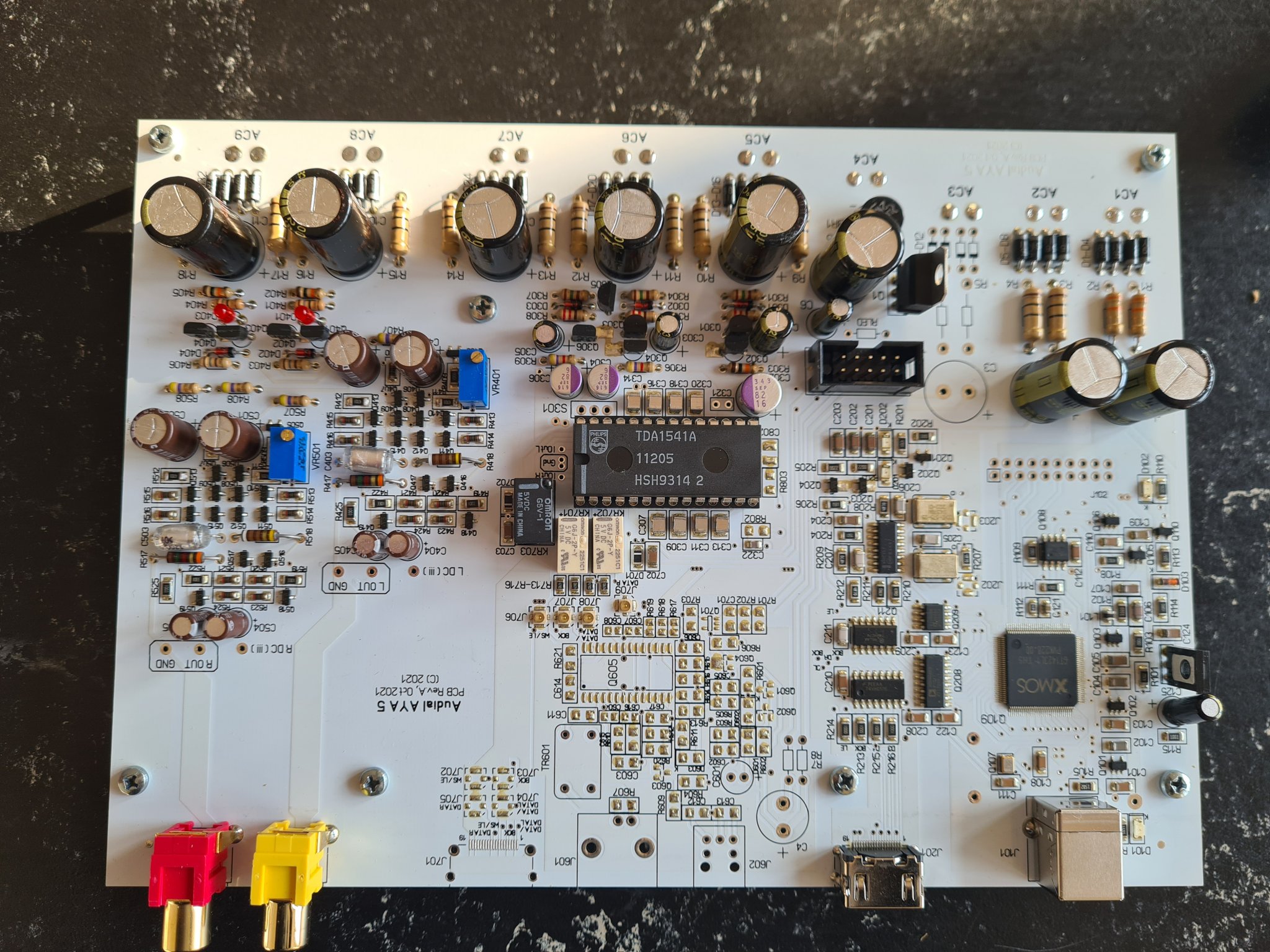

Last week my Aya5 board arrived, soon I will be comparing it with the @ryanj boards.

That is interesting Supersurfer. Have you the AT cut or the last big SC cut ? I'm looking forward to read your review with the Crystek VS the squarer injection frol the SC cut if you have those last design. I still have to finish my SC cut last version. 5 Mhz and have also 5 Mhz AT and 22/24 mhz.
Had you a chance to benchmark the discrete aya5 vs aya2 or 4 with the power suply mods on the -15V ?
I really have no clue of the Aya5 despite exchanging with Pedja before aand during the poll. The new power supply transistors and the renewed analog power supply seems different. Feel free to use my pm if you think it is too much off topic there 🙂
I am glad Pedja used the sep polymer instead the sepc as some did. But I really think it is better without andjust the smd on the -15V.
Saw the pictures...so last SC cut design 🙂....oups no room on the aya5 board for the big diamer excellent FC cap of the Aya2 threads...too bad !
Ilgavro thank for the photos and the report, it's fun
Coaxial cables welded on FIFO also a small loss😉

What is nice is they are individually grounded... 🙂...some says it matters, some others say it doesn't...
