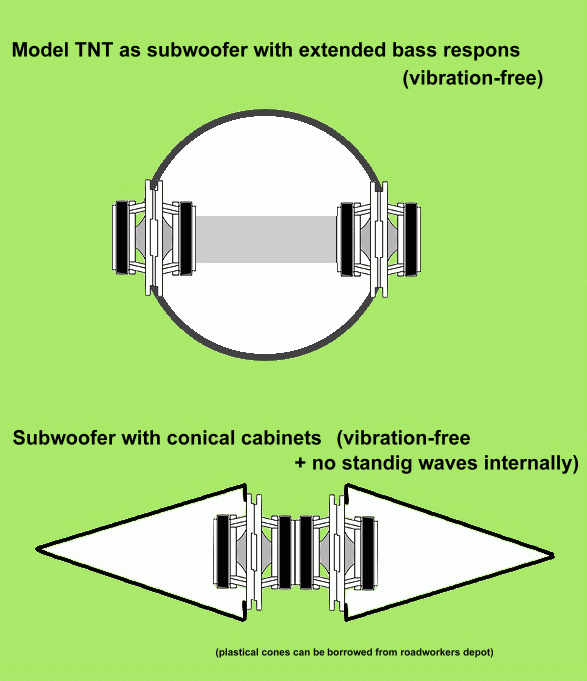

Brilliant, TNT! A technical perfect solution, in a way. To stop the vibrations from being created by using the two elements back to back simply IS the most elegant way to do it, and combining it with the stiffest of cabinet forms, not demanding thick walls etc, and also the use of inexpensive stuff from IKEA for construction... it is just so....bloody marvellous!
(if used purely as a subwoofer I suppose you could improve the deep bass performance with another pair of drive units mounted on the outside, “face to face” to the two units you already have. You would get a doubled total membrane weight (hence extended frequency range downwards) and double motor power to keep up the efficiency. But the good looks would be gone, needless to say…)

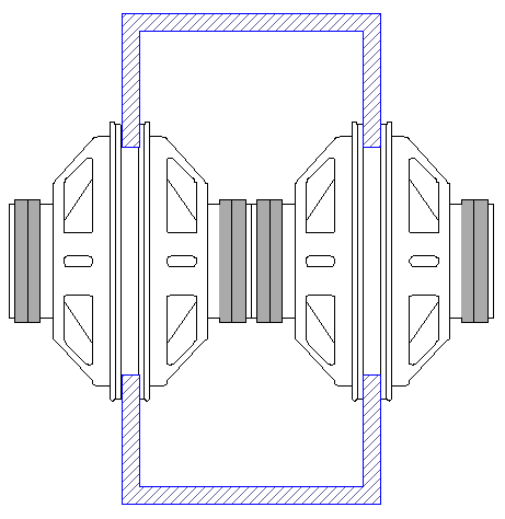

I remeber back when KEF 1st strated doing this. We found that cranking down on the screws to short-circuit the elastic mounting improved the speaker. Since then i have been ridgedly mounting the driver to the box -- and most often supporting/bracing the back of the driver to the back of the box (or closest panel). Better yet is to brace the driver to another driver moving in the opposite direction and actively cancelling most of the drivers motional energy (ie push-push)
Nice illustrations... there has been some discussion of this already -- the push-push, push-pull, isobarik woofer. One of these days i'll acually get around to building one (i certainly have enuff 12s to build a pair)
There is a certain appeal to putting 4 drivers into the volume you would use for just 1.
dave
