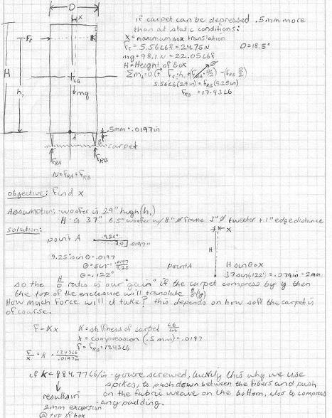

As to the math that pinkmouse and poobah did awhile back I, for some reason looked over this whole post again, noticed that I disagree with the methods used. Mainly conservation of momentum which I believe should only be used for unconstrained objects. Since the box is constrained by the floor I decided to try a force balance and determined that the base wont move(using your numbers guys) and tipping will have to occur, see attachment one, or with spikes on carpet I did a loose analysis of carpet compression that could result in angular rotation of the box about the base, see attachment 2 (next post).
Anyways, unless I missed something I believe these number to actually represent a real world scenario and feel free to question any part of it

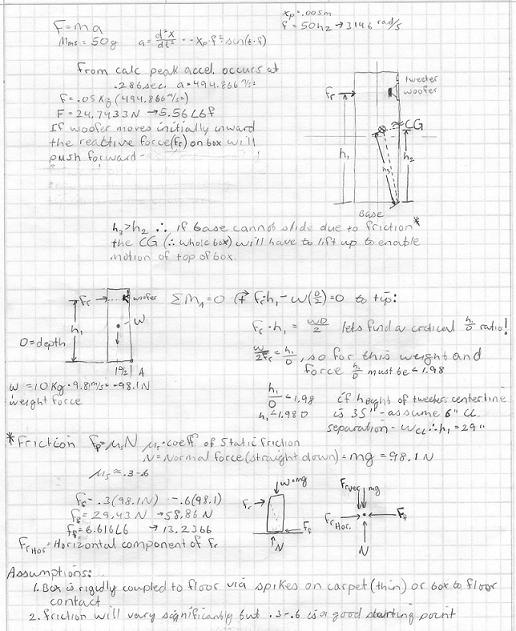

pinkmouse said:
Simple Newtonian physics.
Lets say a cone weighs 50 grammes, and the enclosure weighs 10 kilos, a not unreasonable assumption I feel. If the cone is moving, by Newton's conservation of momentum the forces must balance. The ratio of cone movement to to enclosure movement is therefore 50/10 000, which gives us a maximum possible movement in the box of 0.005% of the movement of the cone. And that's with a box that's not coupled to anything, and is completely free to move. I'm not that worried. 😉
Cal Weldon said:
I believe his arithmetic is correct. The mass in motion ratio is 50 to 10000 or .005. Where there might be concern is that is was listed as .005% rather than .005 to 1. It might read 0.5%
pinkmouse said:
Quite right Cal. I blame Bill Gates.
But as I say, that is for a box that is completely free to move, say, resting on a frictionless surface. Any kind of restraint will reduce that by a significant degree
.5% is equivalent to -23db.
Things get more interesting when you consider the swept volume of the vibrating enclosure compared to the diaphram. Since the front and back of the enclosure can easily be 10x the area of the diaphram, the volume would be 5%, or -13db. For low frequencies it doesn't matter, because the front and back are out of phase. For frequencies where the quarter wavelength is less than the enclosure depth it starts to matter.
Since the box is not completely rigid and free to move, the real effect is much lower. Now the question to ask yourself, is it less than -20db? -30db? When is it ok to start ignoring it? I don't have the answers, but I'm definately interested in further discussion on the subject.
