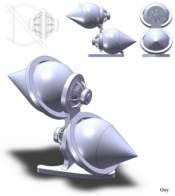

Hey guys,
Sorry to revive an old thread.
Been reading up on isobaric, push-pull and push-push configurations. Its confusing at times! I think it got confusing at times because most seemed to talk about the direction the speakers are facing and forgot to mention polarity...
Am i right in thinking:
That even order distortions will cancel for an infinite baffle or a dipole configuration when drivers are connected in a push-pull configuration. This will also work in an enclosure if the box is large enough or the excursion is small enough.
John K... was rather emphatic that cancellation is not guaranteed when push-pull is used in an enclosure. The enclosure introduces nonlinear air compliance and whilst the configuration reduces even order distortion, it is not eliminated.
And then there is the isobaric configuration which can be used to halve the required enclosure volume..... but not have any effect on the even order HD.
Anyway, that was what i gained from the forum. Is that understanding correct?
It got me thinking about some of the crazy designs posted, especially in this forum (TNT, Planet10, Sletol). I came up with this ridiculous and completely impractical creation. I thought it was worth sharing for the fun of it.
.... dunno how good it would sound...if at all... but i bet it would travel really fast :D
Guy
