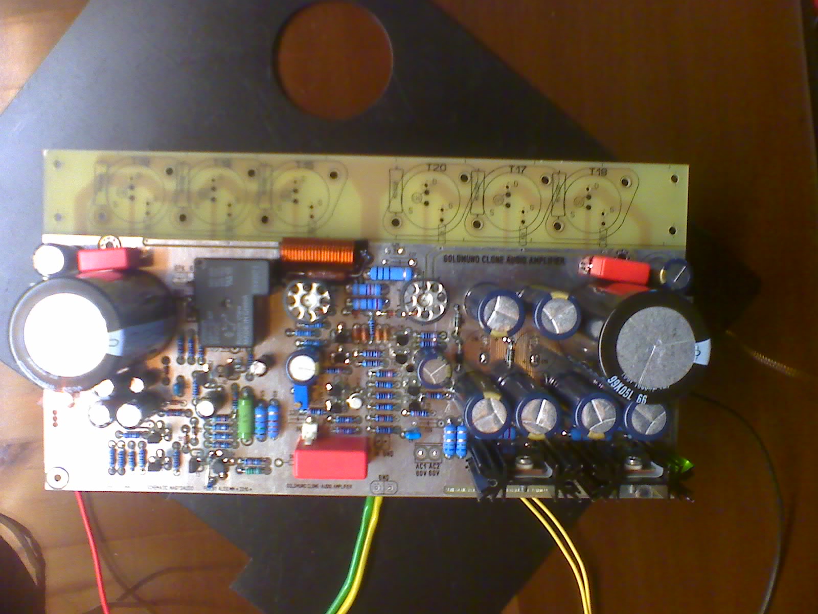

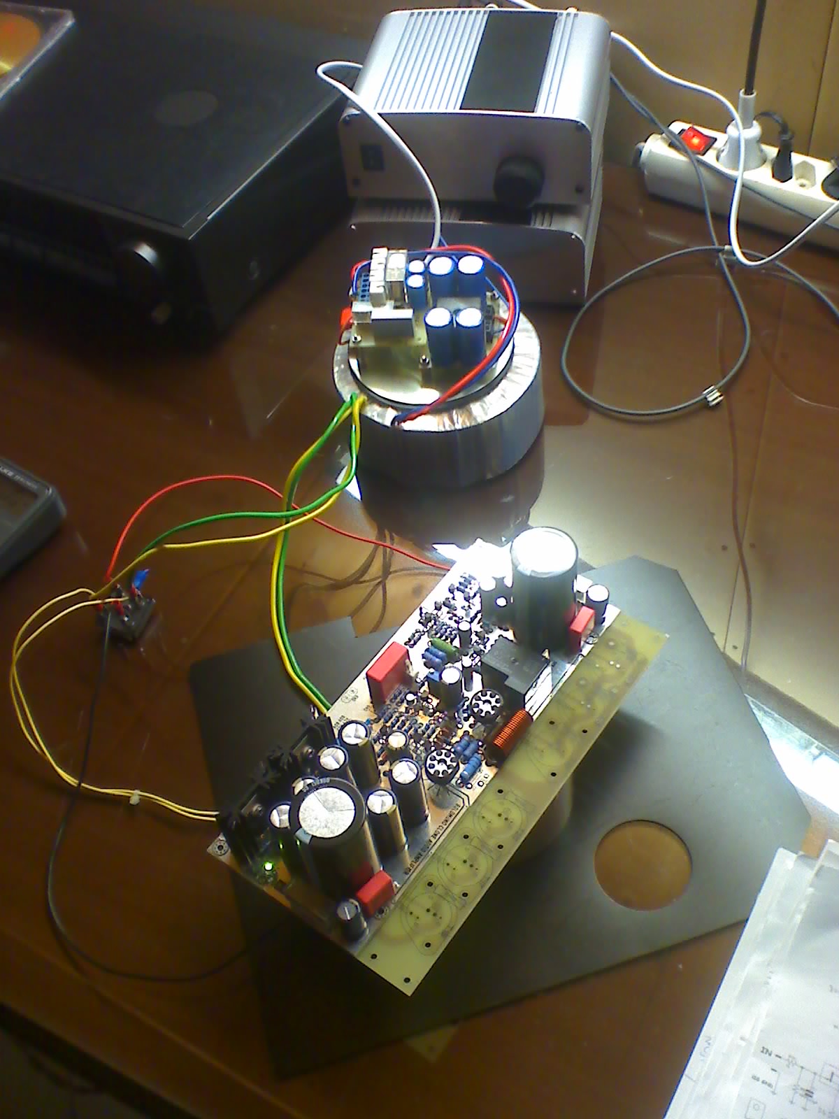

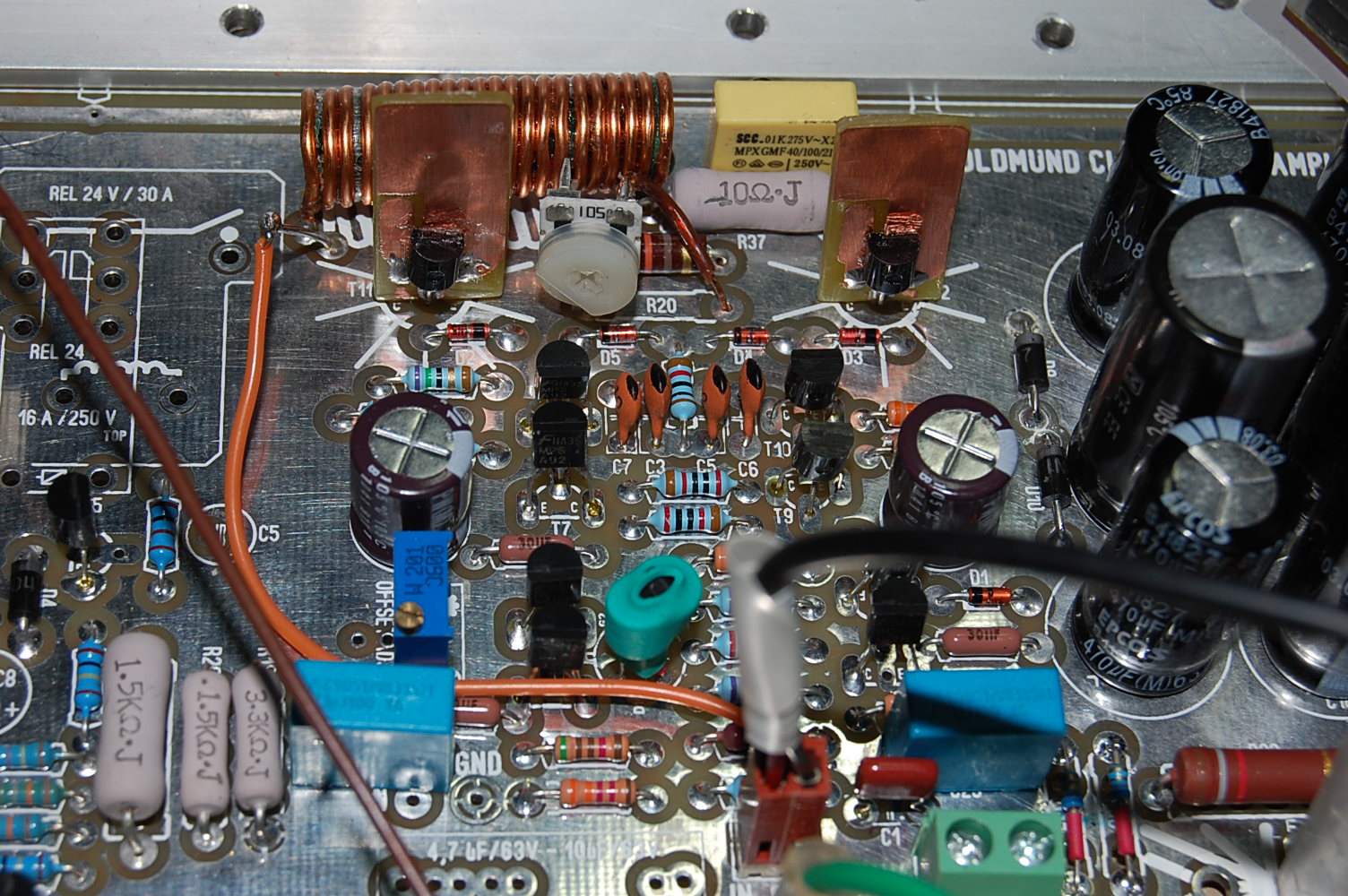

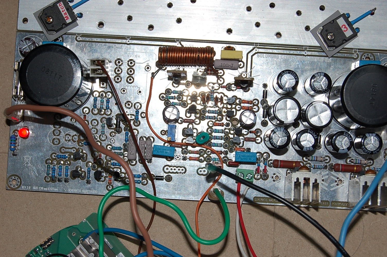

Yesterday I have (almost) completed one channel of the Mimesis 3 Build.
The transformer is rated as 160VA 40V AC.
I measured the Secondary AC voltage whilst playing music at normal listening level, it shows 43.5V AC.
Voltage for output MOSFET is 57.5V DC
Voltage for the frontend (Input & VAS) are +59.3V & -60.7V
For T1, I used a pair of 2SK170BL
T3 & T4: Fairchild BC546B
T5 & T6: Fairchild BC182B
T11: On-semi MPSA42
T12: On-semi MPSA92
T15 & T16: Reneses 2SK1058 (TO3p)
T17 & T18: Reneses 2SJ162 (TO3p)
The rest are just Fairchild MPSA42/92

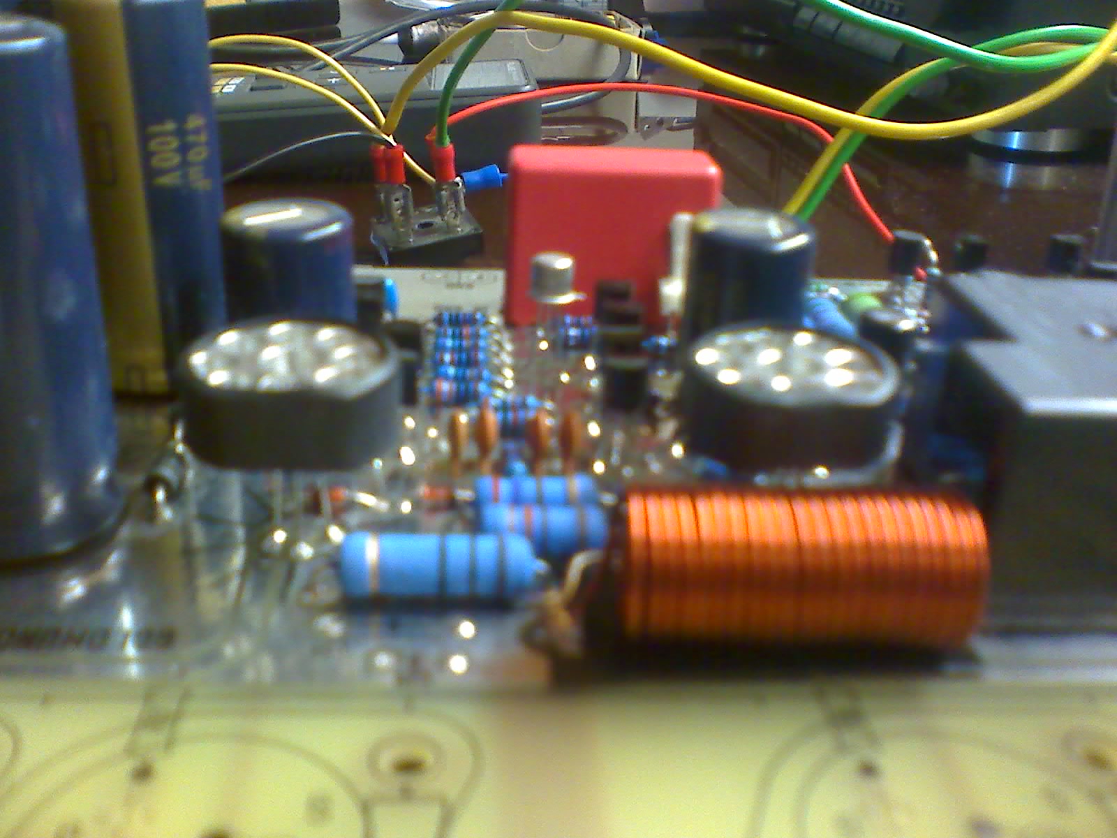

The T7, T8, T9 & T10 are running hot. I super-glued a small PCB to T11 & T12 so they are running cool.
I also experienced the same problem of drifting DC offset, it varies by as much 40 to 50mV. I used 10R as R36 & it made no difference.
I think that problem is with the front-end power supply and the voltage fluctuates a fair bit (by a couple of Volts) & that would affect the DC offset.

(3) Mimesis 3: I am only doing a bench test with one pair of L-MOSFET with one board at the moment. It sounds smooth & detailed, though the bass lacks some punch.
Alexmm has done a great job with the PCB layout, the spacing of components are just right & pads are generously sized.
Attached are some pictures:
Cheers, Stanley

((I think that problem is with the front-end power supply and the voltage fluctuates a fair bit (by a couple of Volts) & that would affect the DC offset))
I do not think this is the problem.
if you have matched transistors 2SK170BL and T3,T4 and you have full symmetry currents on R16, R17, R18. You have no problem.
R16 =1,960V --- 13,06 ma
R17= 2,100 ---6,36 ma
R18=2,200----6,6 ma
R18=2,200----6,6 ma

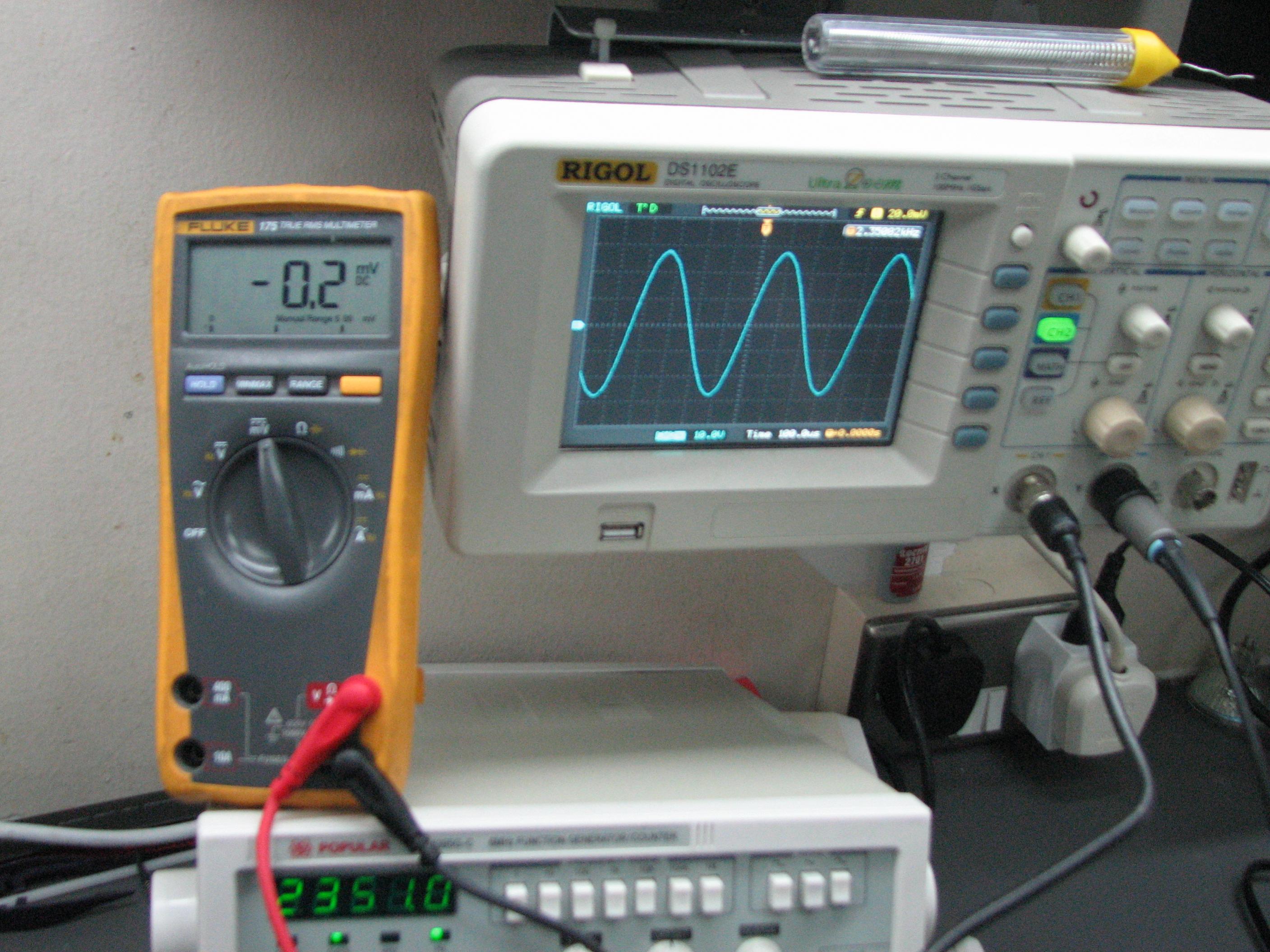

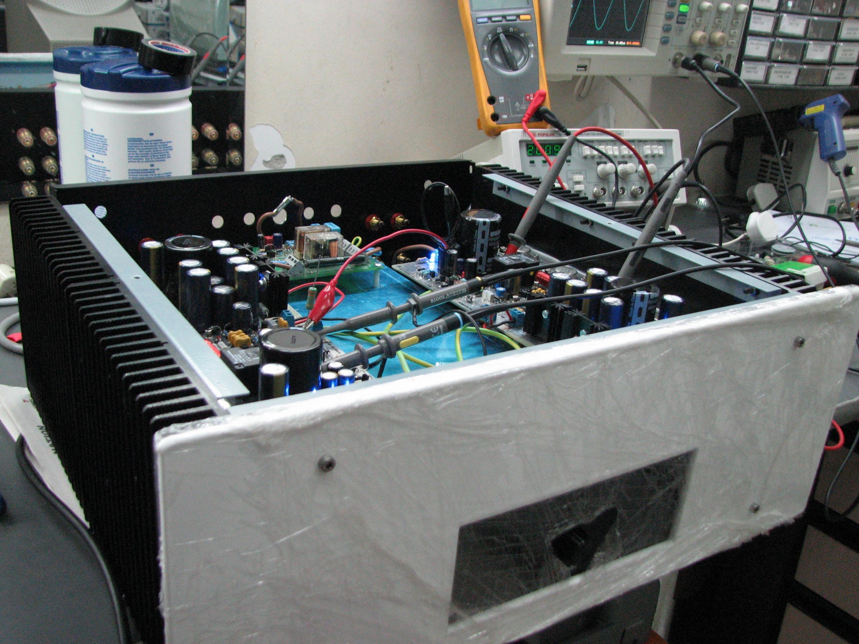

I did the voltage measurement:
R16= 1.969V --- 13.13 ma
R17= 2.132V --- 6.46 ma
R18= 2.200V --- 6.67 ma
The front-end power supply was measured to be +60.0 / -58.7 in the morning and it just measured to be +58.0 / -56.9 so it does fluctuate by 2V.
BTW, I have tried my best to match the Idss of the 2SK170BL and Hfe of T3 & T4.
The DC offset varies from -15mV to +24mV. To me it is still acceptable, it is just different from the other amp that I build.
I will build a better front power supply as the drop resistors (R29 & R34) are running too hot for long term reliability. BTW, AlexMM thought ahead & put some vent holes on the PCB.

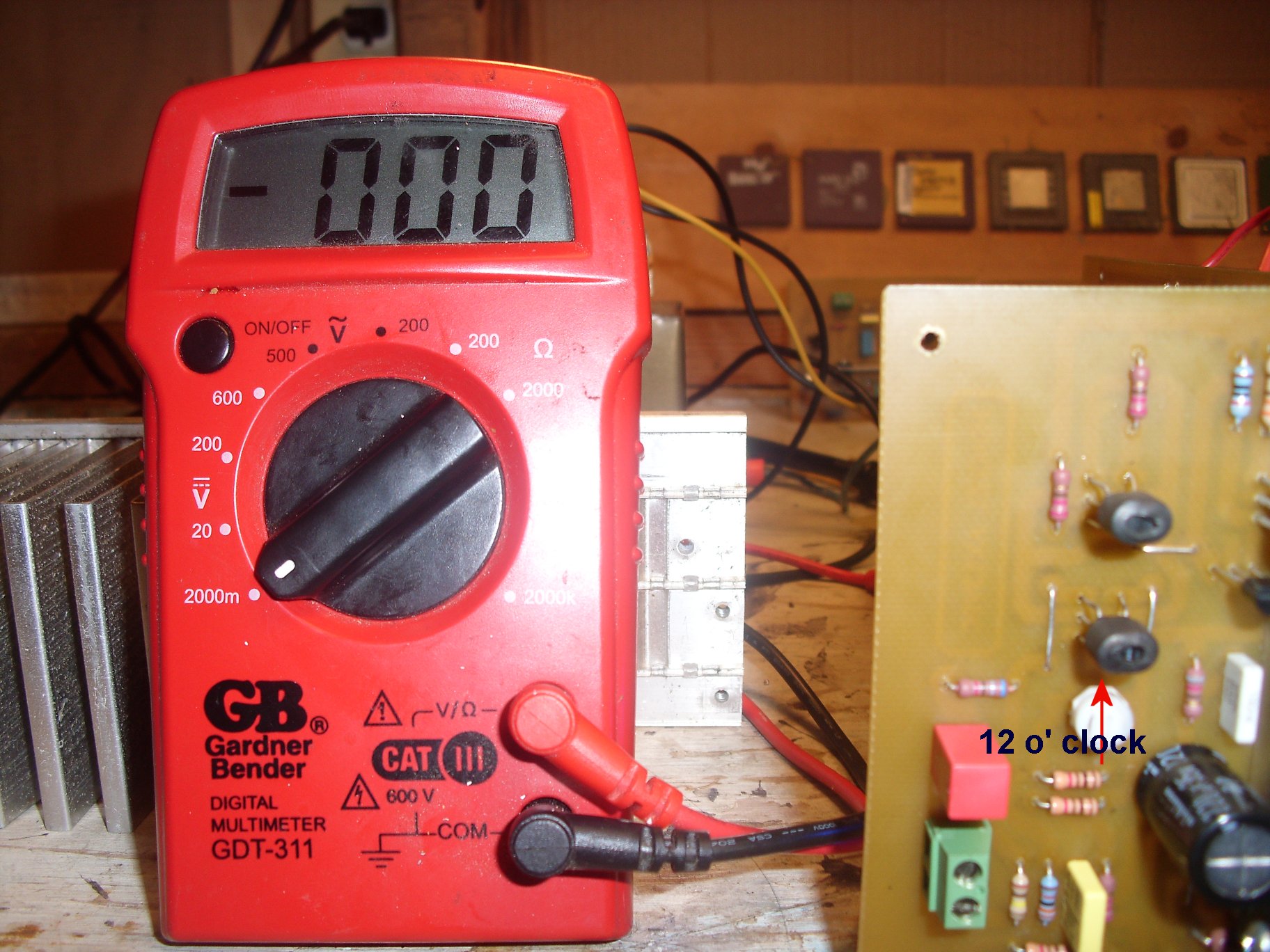

sng001
dc offset=0-3mV with 2n5565
Positive rail 84.05V 2X50 AC
Negative rail 82.03V
The negative side has a greater load at 1mA - 1,2 mA during ZD1-T6-R12
1mA - 1,2 mA X R32,or R33 2200 Ω /4w= 2,2V difference .
-15 ....+24mv acceptable but could do better if you buy 2N5565

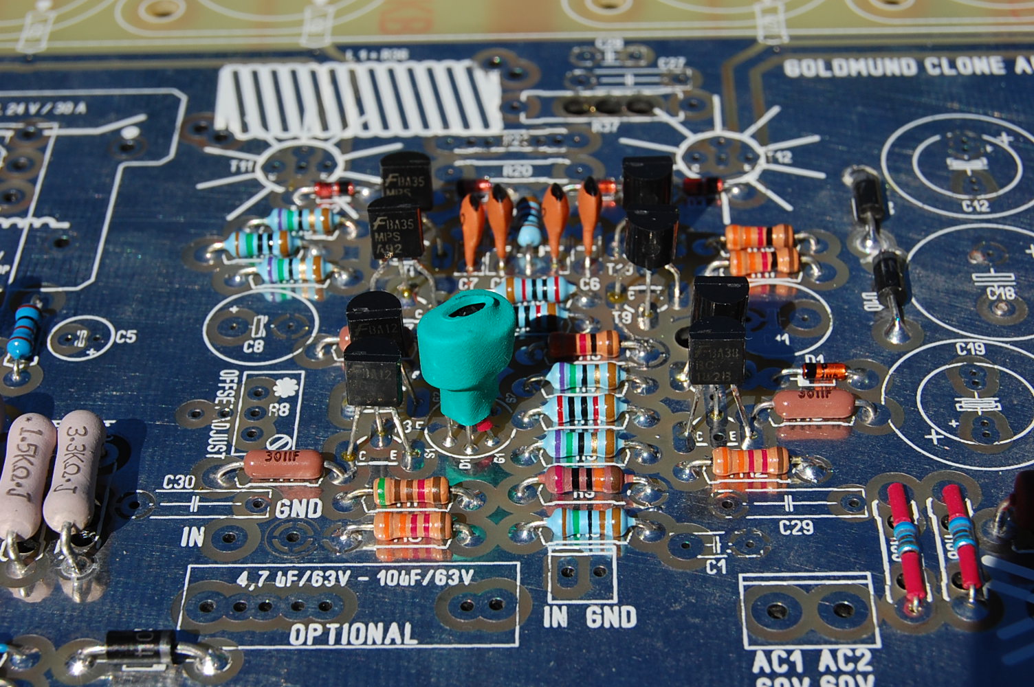

Some comments on a stable and low DC on the output witch I also have not managed to cure:.
As sng001, I tried to replace T3/T4 with matched BC 546B.No change.
I had hoped that by replacing the power supply to the front end with a separate and variable power unit,would remove the DC problem.
The effect of having the exact same voltage on each side of the front end (+-80v DC), was not as pronounced as I had hoped for. But of course a separate power have other advantages over the original voltage doubler.
I might also mention that T1 is 2N5564 (not 65) with me, since the use of 2SK170 BL have being mentioned as a possible explanation for the DC problem.
My conclusion is that the problem lies elsewhere, and I've not been able to locate it.
Someone on the forum here have pointed out that the low value of R25 (0.22 Ohm/ "short-circuiting" the coil) can influence on DC. I intend to try with 2.2 Ohm for R25 later on and see what happens.
sng001: Your listening tests indicate the same as what I have experienced (highly subjective): Goldmund play highly detailed, open and comfortable (not harsh) in the range from 600 Hz and upwards in my setup with electronic crossover. I have also listened to the "middle bass" on a full range speaker and find it very potent and satisfying. I have not had the opportunity to test out the lowest bass the same way.
Right,Anal matching of the cascode or input pairs will make no difference. Amp (below 1) will stay at +/- 1mV with 2 "mismatched" input transistors , ambient to hairdryer temperature swings , or mismatched supply rails. Matching is more important for final sound quality , so besides testing (playing).. match your IPS.
That is after NFB takeoff , it would have no effect on offset.Someone on the forum here have pointed out that the low value of R25 (0.22 Ohm/ "short-circuiting" the coil) can influence on DC. I intend to try with 2.2 Ohm for R25 later on and see what happens.
I know the goldmund is very fast , but if that speed compromises "basics" like the rock solid stability of the DC offset .... unacceptable. I tried my EX , which is just like the goldmund without a FET input. Same 1mV offset , even tried unbalanced rails , no more than 1-2mv offset change. I HAVE seen "jumpy" offsets and Unstable Vbe readings with one of my modules at or near oscillation. I did this purposely just to see what "errata" I might experience.
I would "slow the amp down" (use temporary 68-100pf Cdom's) just to see whether the "errata" disappears.
OS
