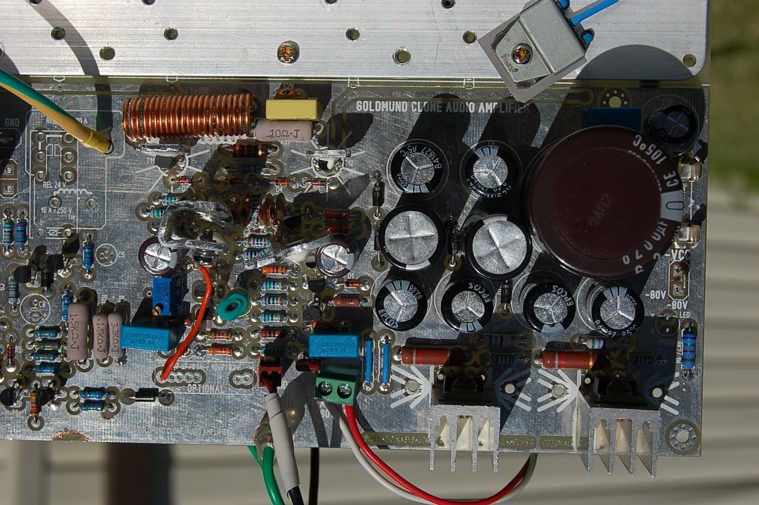

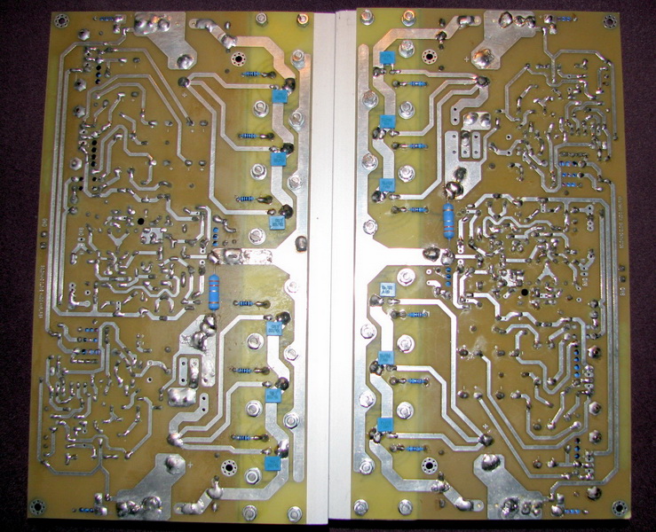

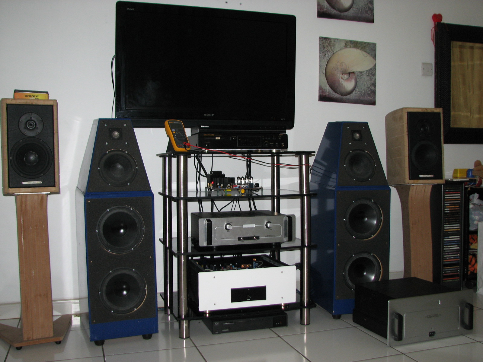

I have made the following PCB to fit the Yamaha case.
Attached is some pictures.

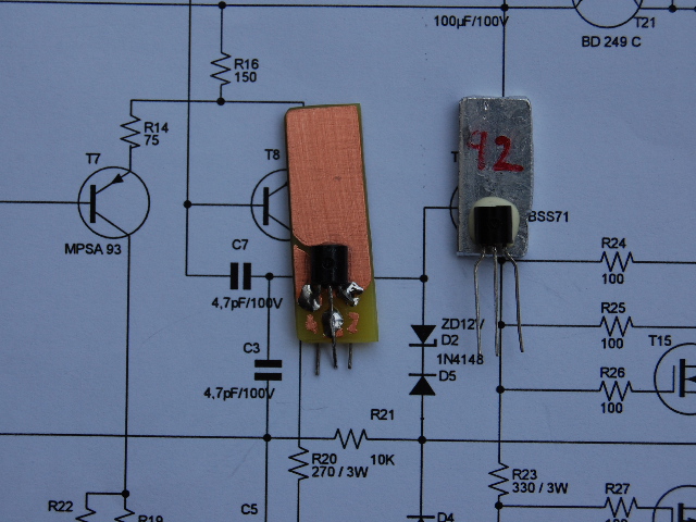

What are the standing PCB sticks attached to those TO-92s? Heatsink/miller compensation combined?
- keantoken
Hi KT,
The standing PCB stick are just heatsink as superglue sticks very well to polished copper & FR4 is much easier to work with. I imagine that a Miller capacitor can be added if one is needed. There is a flaw with this heatsink - the pins on the TO92 can break quite easily.
The VAS on the GM clone is running quite hot, I used a 60mm (W) x 50mm (H) x 3mm alu heatsink and it is running at 20C above the ambient.
Cheers, Stanley

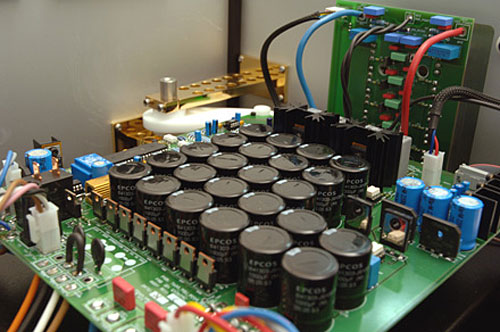

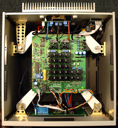

I also read the other thread, the VAS stage of the Telos 2500 is surprisingly similar to Mimesis 9. The FZT857/957 are SMT devices so that they can be potted together with the IPS to form a single thermal block - that would help to solve the drifting offset problem.
BTW, I found some internal pictures of the Telos 2500.
Cheers, Stanley

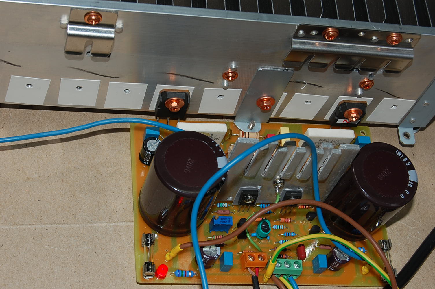

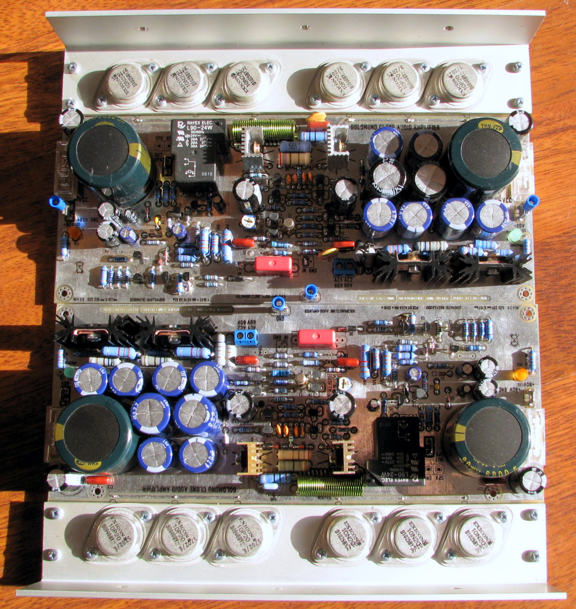

Second channel populated
Hi all ,
I managed to finish, and the second channel, I started one channel, and I can easily adjust the offset to 1 mV. There is a difference between voltages 2 -3 V at rail drivers . I'll stick it into the case then do all the tests with audio generator and oscilloscope. I like the sound, but I had no real speakers when testing from a friend of mine 🙂
Alex .
Hi all ,
Alex .

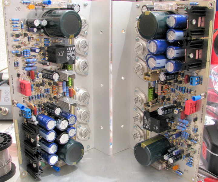

Farl
Congratulations with your Golmund clone.
What about some pictures, Farl?
Who is the next one out with their building results??

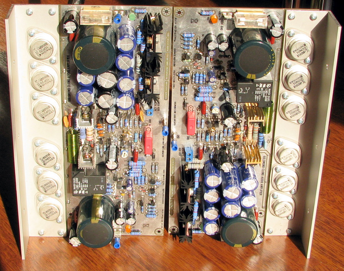

Eivind Stillingen
Some pictures....
