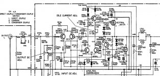

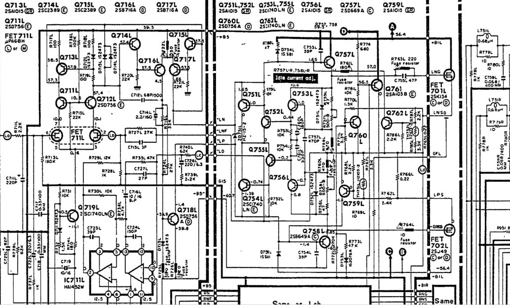

HMA 7500
HMA 7500 MK2
GM is blatant (simplified) copy of the second one....
....or is mimicry the fundamental purpose here?

There s 2 versions /
HMA 7500
HMA 7500 MK2

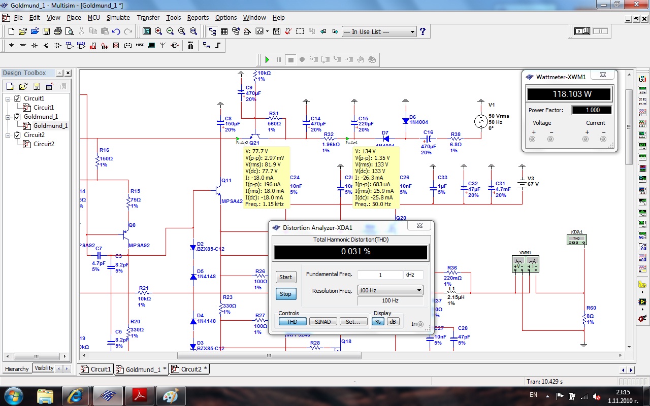

this is from the post #1010
Hello,
I am sorry for my Endlish!
I have made some simulations with NI Multisim software and because I have not valid spice model for BSS71/74 and 2SJ49/2sk134 i have made simulation with MPSA42/92 and 2sj162/2sk1058 exactly like Nagys suggest in its post 50 from "PCB order for Goldmun clone". OK here is what I found:
1. The Nagy's schematic of Goldmund amp is correct and work perfectly.
2. Lowering the +/-80V at output stage down to +/-50V will NOT LOWER the power of the amplifier and will not increase THD. I think that Goldmund's reason to use 80V is probably sonic performance not measurable. At the some time with +/-80V at high power and 4 Ohm load the output mosfets will go out of power range easily. Probably that's why they use not oversized transformers and only 4700uF capacitors because this will give around 73V at high power and low load. This will be a little bit safer for output mosfets.
3. Lowering 60V AC at input stage will highly increase THD.
Can you please someone check this with simulation again?
Best regards
And this is from post #1089 & #1090
Hi Liliya,
As I already say If lowering the DC supply at output stage will not lower the power of the amplifier.
If you have 2x50VAC transformer don't worry the solution is very simple: change the drop resistors R32 and R33 with value between 1.9k-2.0k (3W is fine) and input tage will go to around 80VDC.
I am not recommend to remove a pair of MOSFET's. By the way the current through T21 and T22 is around 26mA and there are not needed any heatsink.
Best regards
Here is simulation with 50VAC transformer...
