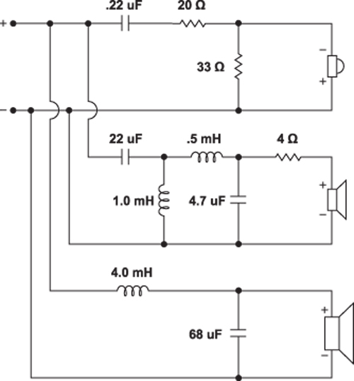

Regarding R36 and the Thiele network.
As I see this you have two option here. 1. Stay with the original design.
2. Modify it so it will work with your speaker cable and speaker crossover filter. I have seen crossover filters that have 68uF across the woofer.
I do not think that the GM will work with such crossover filter.
If you go for nr. 2 you need to read this:
The inductor is pretty standard fare at the output of amplifiers. Its usually a very small value (2-6uH is typical) and its function is to prevent the amplifier breaking into RF oscillation due to stray capacitance on the output (due to cables, and the speaker/the speaker crossover). Simply put, at very high frequencies (well above audio) the inductor presents a small impedance which stops the amp seeing a 'pure' capacitative load.
Connecting a resistor in parallel with this inductor then damps the tendency of the inductor to ring with this stray capacitance on the output, so as to make things behave better.
You can test the amp with a scope over its full power and input signal range into the precise load it's driving to make shure it behaves stable.

the R of the R//L of the Thiele Network is likely to be from 1r0 to 10r.
Yes it could be outside that range but would be very unusual.
Buying the two extremes of 0r22 and 22r will leave you with no workable solutions.
Hi Andrew,
I agreed that 22R is a bit too high for this application.
I have build Dr. Bora's Sigma which use a similar L-FET topology, I used 2R7. I also build a LMe49830 with L-FETs, again I used the same value for the Thiele Network.
I agreed with Tommy, it may be a matter of trial & error to match the speaker.
Cheers, Stanley
