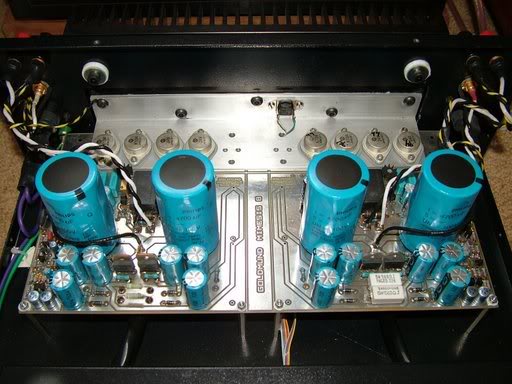

It means, the Memisis was indeed a complete modular design (or should i say JOBby) ; universal gain stage module, exact same board for all of the larger models.
For a different model number : just pick a couple of different value resistors, number of power MOSFETs and the max Vds type, change of transformer and lytic caps.
Rest is standard.
Haute couture prices, with a prêt-à-porter production setup.
As the Memisis 8 demonstrates (even standard L-angles).

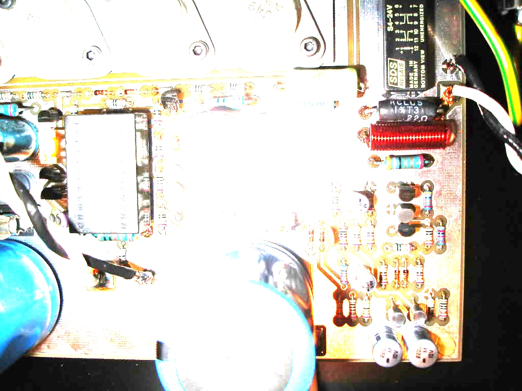

I found the following photos on the web, I guessed that this was from a Mimesis 1.Some filter caps had been removed.
Goldmund used Thick-Film resisters similar to PWR221T-30-1000J Bourns Thick Film Resistors - Through Hole as gate-stoppers for the L-FETs.
Can someone tell me:
What is the type of resistor (Green 10R 5W) next to the relay?
What is the type of capacitors on the bottom side of the PCB?
Cheers, Stanley

The standard L-angles makes storage easy.

It looks like it has been repaired.
Have the repairs been done competently?
Why were the repairs necessary?

What I meant was that the green 10 ohm resistor is a metal oxide type made by Roederstein. It is no loger in production. A replacement may be Vishay WK/WR.

The blue caps are styroflex HF blockers, and the green res. are tubed metalloxide Withrom induct. free HiWatt 5% resistors.

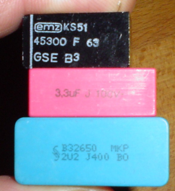

TO-3 mounting hole distance is 30mm, heart to heart.
The body of the bypass caps under the board is less than half that.
Not 15mm is 11mm, 11mm means low cap value (70Vdc rails)
See : www.komponenten.es.aau.dk/fileadmin/komponenten/Data_Sheet/Generelle/KS429.pdf
For a size reference : 45300pF/63V Polystyrene EMZ - 3.3uF/100V MKC Roederstein - 2.2uF/400V MKP Siemens
