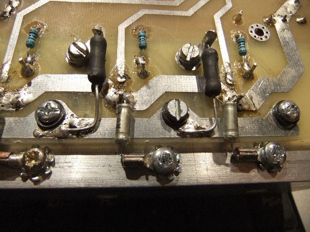

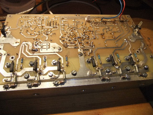

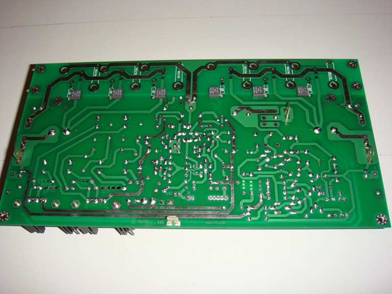

To tell the truth, just the view of the bottom of your boards makes my toes curl.
The Memisis is like an F1 racing car :very fast and no ABS, ESC, ESP, TCS, no Airbags, no crumple zones.
Such a car needs an F1 mechanic to assemble it.
Someone with two weeks experience at a tire-center can ask directions at any stage beyond a wheel exchange.
But without books/nightschool classes, any response leads to more confusion, more questions, and fewer answers.
Example is switching the BSS71/74 drivers for MJE340/350.
An MJE350 does an fT of 4 Mhz, 8 if you're lucky, measured at an Ic of 50-100mA
fT is : current gain-bandwidth product.
Basically means they measure what frequency a transistor is able to do at each collector current, and how high Hfe is.
fT is the product of : gain times frequency.
The Goldmund has a risetime in the order of 0.5 µs , with a bandwidth of well over 100KHz at -0.1dB and close to 1MHz at -3dB.
If you looked at the numbers (aka graphs in the datasheets) , the BSS71 and BSS74 ARE able to deliver that.
At less than 2mA driver current, the MJE350 NOT by a long shot.

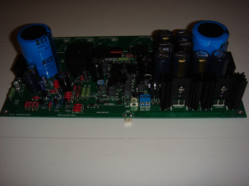

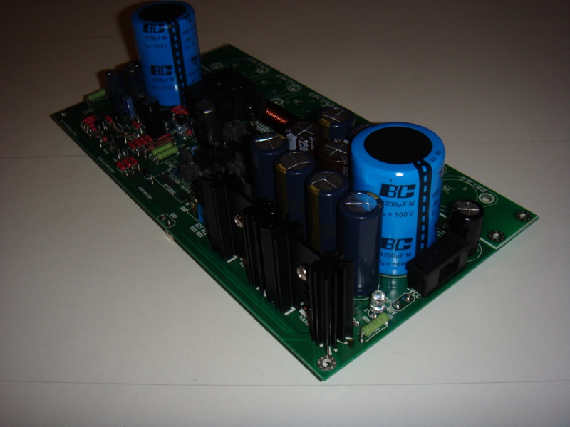

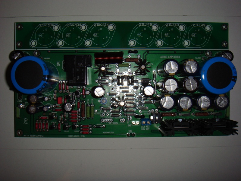

I'm close to finish! I have to solder a few components, followed by the mounting of lateral mosfets. I have great emotions and I'm eager to listen to this amplifier!
See you soon
See you soon
Looks good.
Where do you have the board with soldermask from?
Say, you didn't want the shabby and overpriced boards from bigpanda? 😉

I find it fascinating that hotzman has soldermask covered boards and I'm curious what he paid for them. I find they look much better than the tinned ones.
