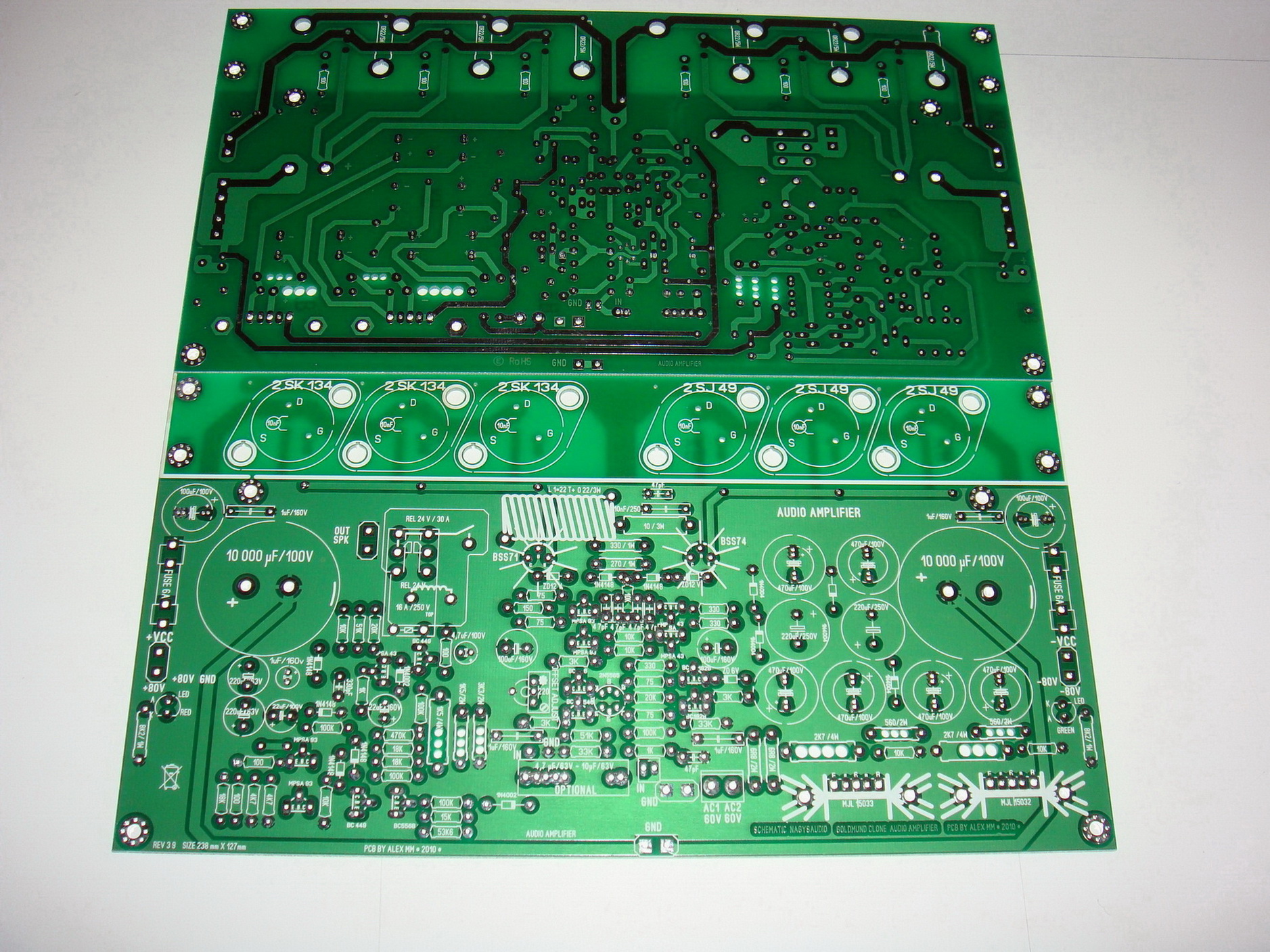

Some announcement about boards here :
http://www.diyaudio.com/forums/group-buys/175296-pcb-order-goldmun-clone-32.html#post2486406
please take a look. thank you for you attention.

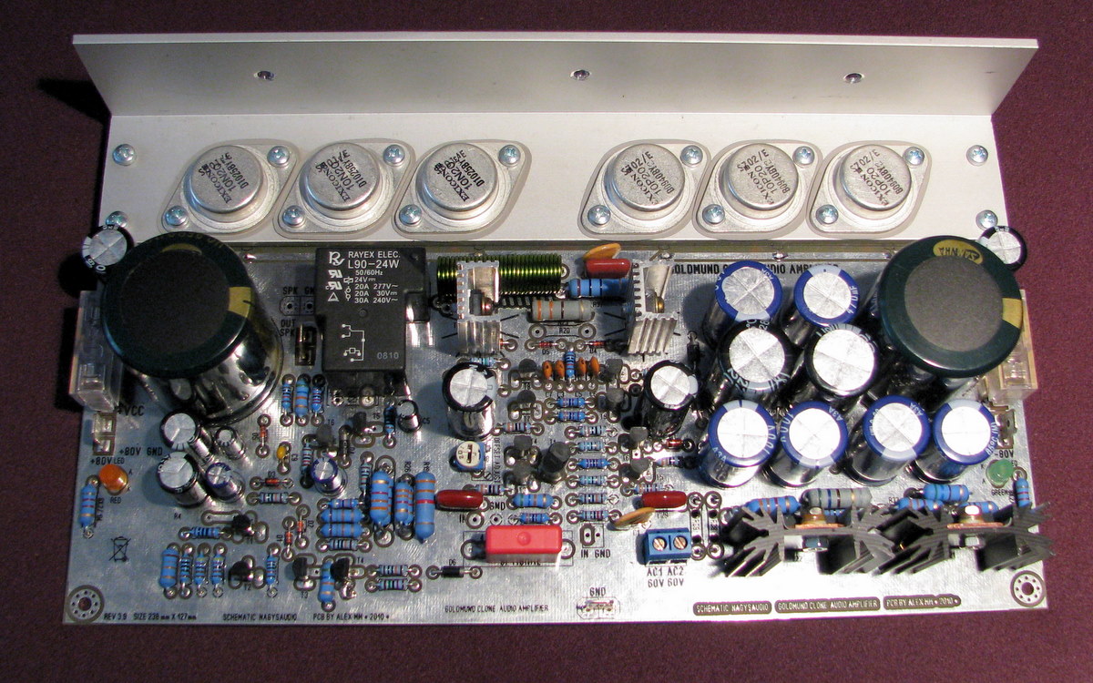

Drivers: I use MJE 340/350 (300 V) mostly because they were easy to get.
Alex: The devices you use for drivers are 150V transes. Have you read
"warnings" in #1318 and1321 about not use less than 180-200V types.
(This also depends on your power voltage).
Your PCB seems to be complited. Have you listen or done any measuring?
I am curious about others exsperience with the clone.

Yeh alex, everyone is waiting for your home brew 2N5565 to perform. Did you use alternatives for T21, T22 (same Q to Liliya).
Tks for the information Liliya.
BP
BP
If you can source them, BF469/BF470 or BF869/BF870 are a less evil replacement for the BSS parts than MJE3's.
At the driver quiescent current level of the GM design, MJE340/350 will be like mounting bricks on a Formula1 instead of slicks.
.....🙂 my drivers are 2SC3423 and 2SA1360 with heatsink .
Alex.

I just got my PCB from Bigpanda,and sorting of component is on the way.
As for the input fets, instead of 2N5565 I have 2N5452, and would like to know is there any compatible issue?
Much lower transconductance, you'll loose a chunk of OL gain.
To check how much you'd have to look at the Yfs(Gfs)-Id curves.
