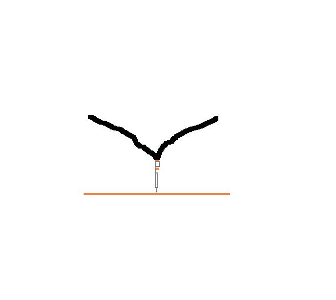

Thank you for posting that picture Alex. As far as I'm concerned, this board is finished. It's easy to build and because of the ground plane, gives tons of options for grounding schemes. For those who don't want large currents on the ground plane near the input stage, just solder everything (speaker ground, transformer ground, etc.) on the ground plane all close to each other at the bottom of the board. Just bellow the 60VAC input. Done and done.
Its a pity that those who have criticized the grounding and have pointed out alternatives don’t see any reason to contribute any longer about that question.
well, I suggested the best place to connect speaker minus/ground, right where supply ground is connected to board
in a direct comparison you may hear only a very small difference, and maybe even close to imaginary
so it might not matter that much
maybe all that makes a difference is a few solder joints more, or less
as it is now, you can try both 😉
but I think there have been a lot of confusion about small matters like component polarity, orientation, etc
even the function of plated through holes seemed a new thing, and obviously caused some confusion about how to solder
small matters, but still enough to give the feeling of uncertainty
from that perspecive its not right to say that a few critical members caused any confusion
on the contrary
that ongoing debate gave the time to correct errors
and there have been lots of corrections
even after it was announced to be ready and done
I cant count the number of times it has been ready to go
and there could still be some small silly mistake
until its been tested in real life, its a kind of gambling
if you want the boards, fine
personally, I actually do have a small collection of various boards too
but as suggested early on, please wait with buying all the parts, and mounting, until its been tested
Yes, the ground plane gives many options. Different builders can solder their ground points to different places on the board. If you want to keep high current away from the input stage, solder everything on the bottom of the board next to the power supply. This is all the more important not to have a solder mask. It makes it significantly easier to try a few different options while building.

The devil's in the details...
The PCB's not laid out the way I would have done it, but it does have one very nice feature:
There's a wide copper track (shown in red below) connecting the input ground to the ground of the feedback network, providing a nice low-impedance path between those two points. It's also almost completely surrounded by holes in the earth plane, so very little of the high current muck will find it's way to and through that track. This means very little hum and distortion will be injected into the input stage.
Isolation could be further improved by adding another little cut in the ground plane as shown in green below.
edit: OK, do I get shot now for finding something nice to say about the layout? 😀
