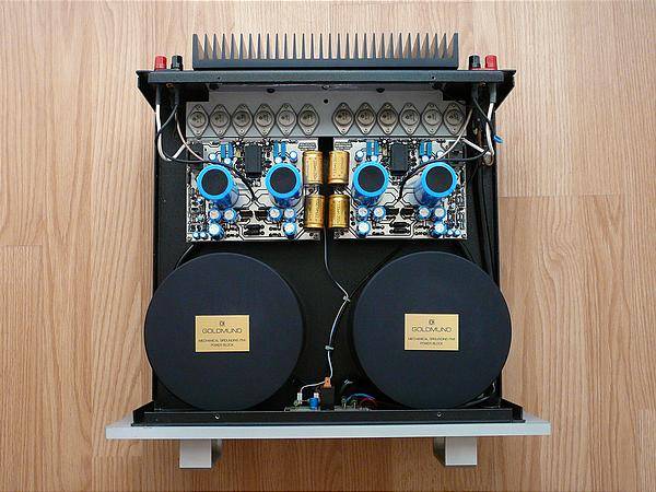

Hi Alex. Would it be possible to post a .pdf, or picture of the top of the board, the ground plane? Thank you so much!
For those that want to modify the Goldmund schematics or post quotes from amplifier design books there is plenty of other threads for that. This one is about cloning the Goldmund as close to spec as possible.
This is a very good question Nagys. Is there any chance of getting some high rez close up shots of the Mimesis 9.2 PCB ?
That pic that has been posted is of a Mimesis 6 stereo amp I think.
Ah, you can't see the star ground, or would you like to read the output device number ?
any more pics? BTW,It's a little different from the one in the post #140.
Thanks for the pic Jacco. One thing that I do see clearly is the separate A1 module and how close it is to the outputs. But I'm just being silly again.

The Telos monaurals and up are modular, see Telos 400 pic in post 902 ;
- Front end stage on a separate board right behind the inputs.
- Zoby coil soldered at the output terminals.
- AC carrying stuff as far away from the input as possible.
- Powersupply + protection circuitry on a separate board.
- Foil nF caps at the source of each output device.
(plus usual stuff as inrush limiter for the transformer, no rail fuses, other usual "audiophile" crapp)
