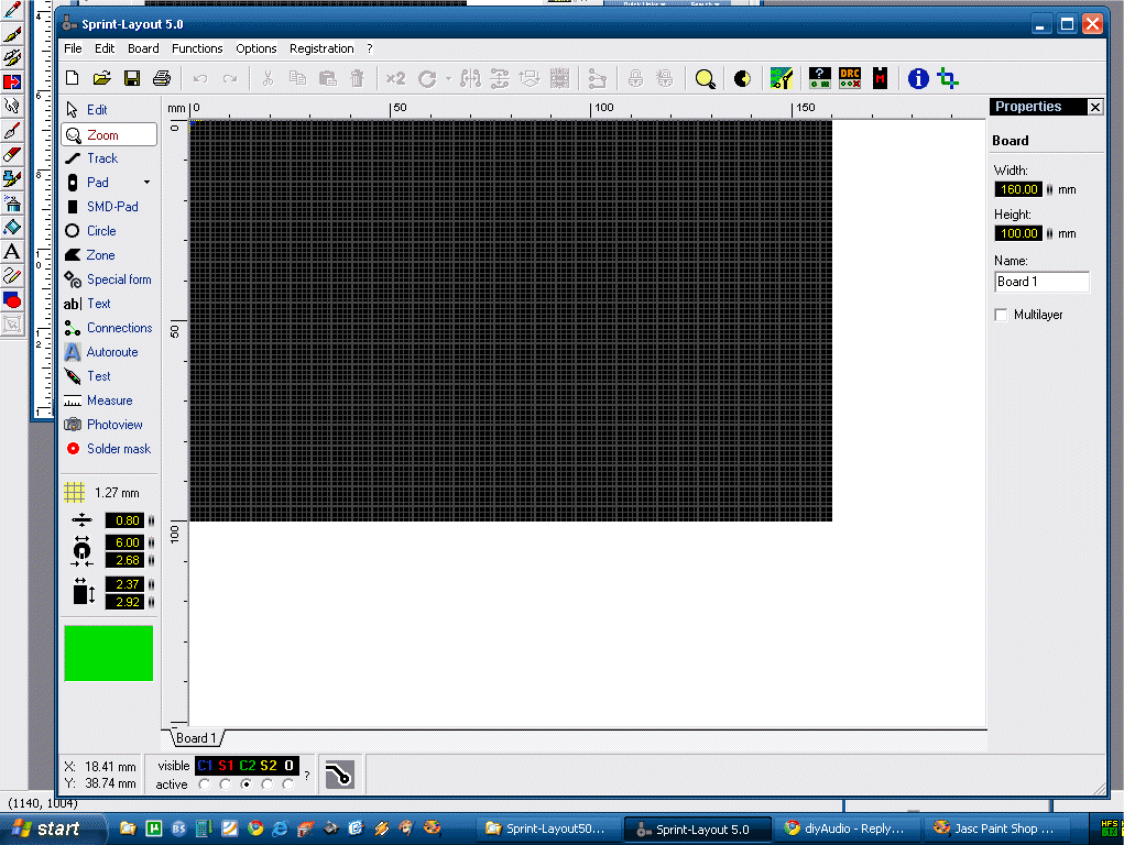

You do not happen to know which program Alex uses??
Sprint Layout 5.0
