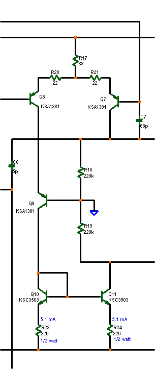

Let's see , pix 1 is just about the most common cascoded JFET input stage of the 80's (pioneer , luxman , sansui , many others). A very good setup for a differential ... reliable. Pix 1 has a overly crude CCS 🙁 . I use a slightly more advanced version of it in 2 of my amps,(attachment 1) the CX and GX.

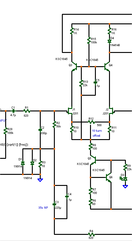

PIX 2 is a VERY crude symasym type balanced VAS , infact ... trying EVERY variant of this particular circuit , I know why Wahib's simulation shows lousy performance. The symasym's VAS or my CX (attachment 2) would be many times more linear in the worst case.

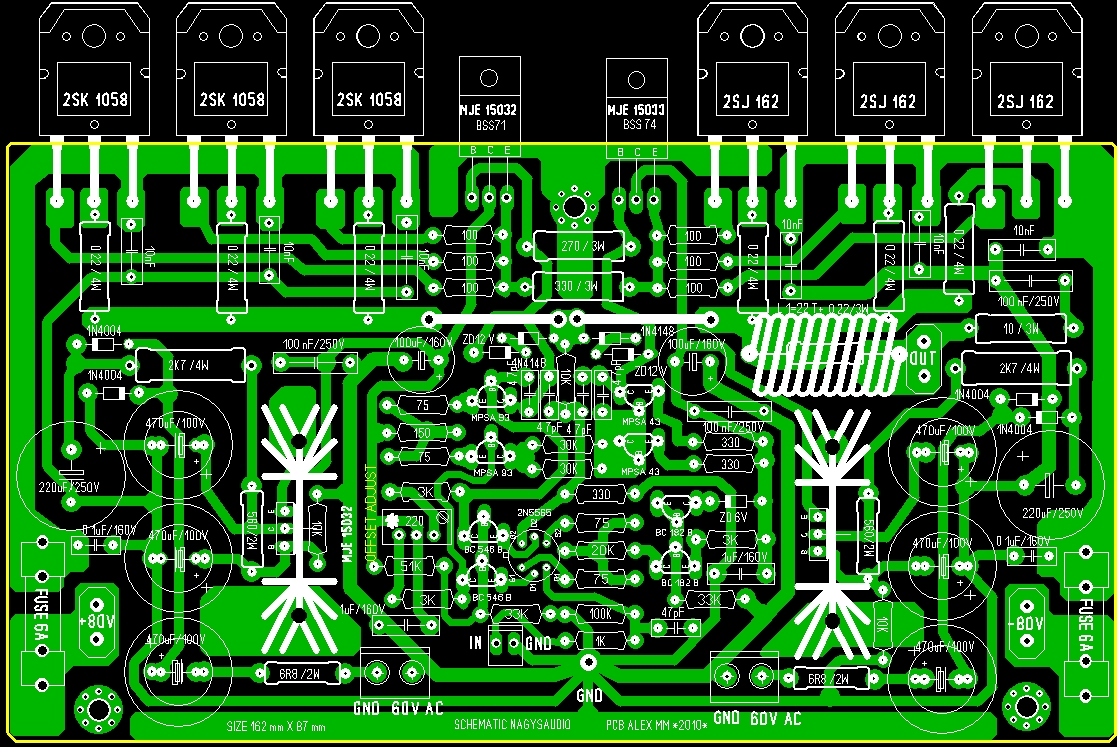

Pix 3 ...I really cannot understand WHY... if they went to the trouble of running a totally separate supply for the input/VAS , did they not design a truely regulated one instead of that "cheesy" half wave rectifier/capacitance multiplier "trainwreck". It would work , but I have the taps on my rig to feed my better capacitance multiplier with a REAL regulated supply if I wanted to. I bet the 60V AC came off the same trafo as the main rails. 😕
And last , why would one design a board or even consider a group buy without simulating and/or prototyping the circuit first. I would , but am too poor to afford the laterals. I am almost "over-familiar"

I aggree with ostripper.
Nobody has done a simualtion.
I think there would be some diy'er, who are willing to buy the pcb, but have no scope at home.
The design and the board have to be check first.
