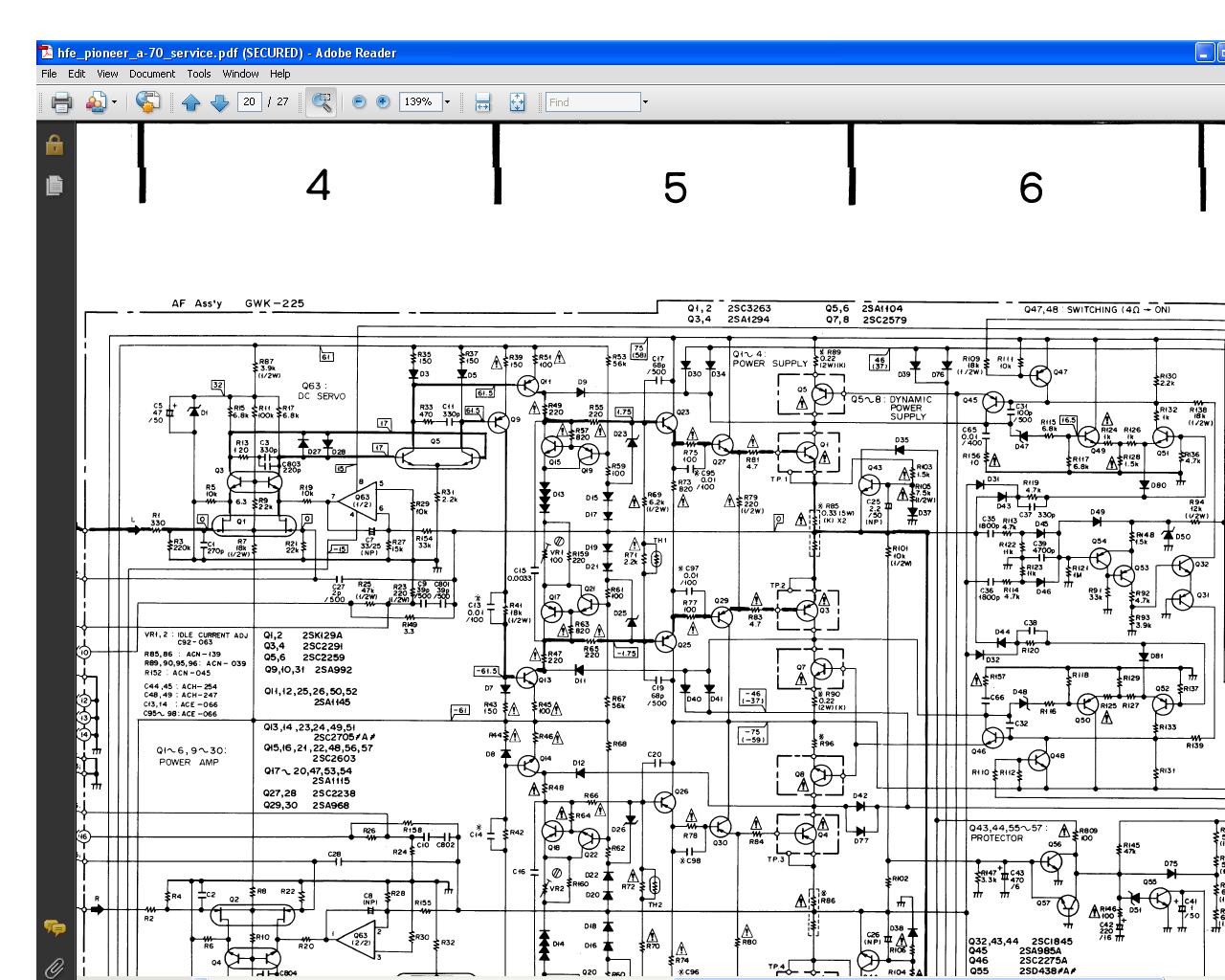

I'll do better than try... It's mostly done. My pioneer M-90 based "PX" is VERY close to that A-70 (thanx for that). I see a few more "tricks" in the A-70. 🙂
OS
Also separated and regulated power suply for VAS... many diyers just ignore 'tricks' from commercial amplifiers, and say 'this is not audiophile amp', but diy amplifier based on this amps can be 'the very best', you are on right way,
