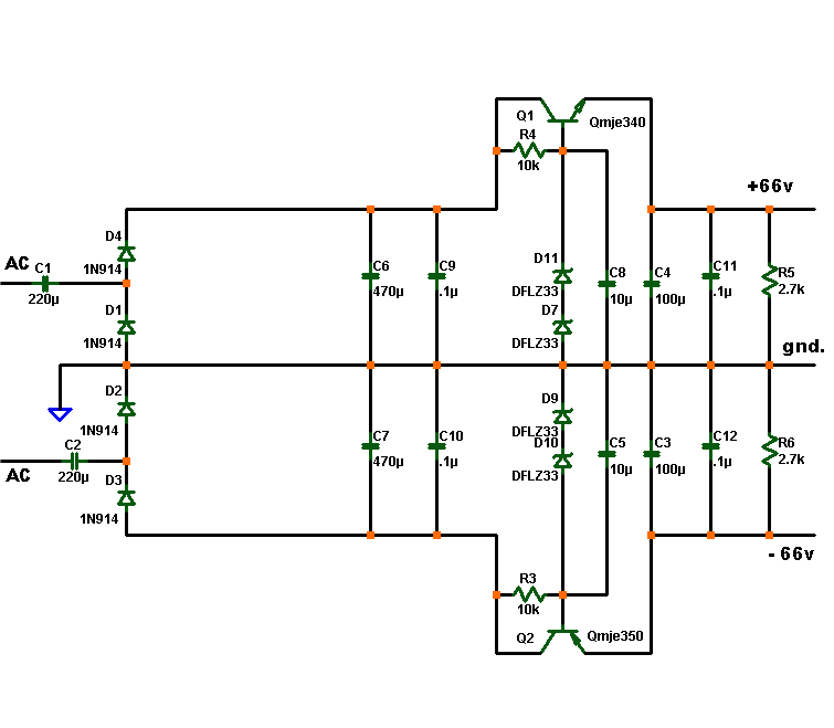

Yes , discuss the design. It (the design) was made with profit in mind. It can be much better. Take , for instance, the voltage stage power supply. (pix 1) is the one I will be feeding my capacitance multipliers. It uses a common 48v CT -20VA PCB mounted trafo which you can either double or triple in the circuit below. This voltage stage on this amp or mine (which are similar) ,will use no more than 20 mA per rail so both channels can be powered at once by the circuit.
This amp can be better than the original ... this is DIY , we can go "anal" with it. 😀

I've been going through my papers and double, triple, and quadruple checking everything to do with the schematic. The way it's posted it's virtually 100% correct. However, I forgot to include the Zobel filter on the output. This is extremely important for the correct operation of the amplifier. I have modified the picture below and included the Zobel in red. Alex, can you please add this to the PCB? I apologize for the original omission, but it's absolutely necessary. The Zobel consists of 10R/3W resistor and 10nF (in parallel to) 47pF capacitors. Thanks for all of your great work.
EDIT: I just took a look at Alex's PCB again and saw that he is one step ahead and has already included the Zobel. Alex, can you please add a place for a second capacitor in parallel? This is a very wide bandwidth amplifier, it should have a 47pF capacitor in there 🙂
