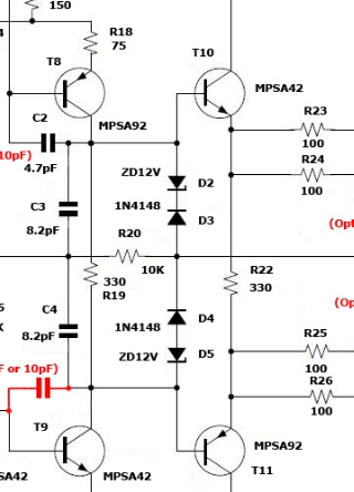

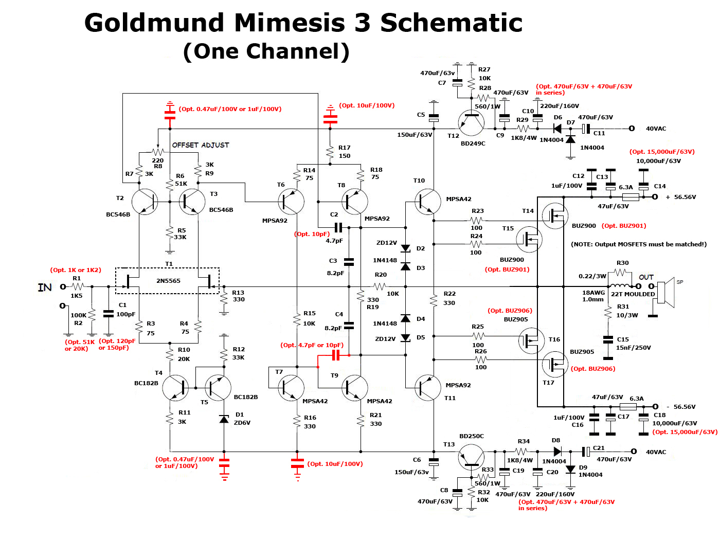

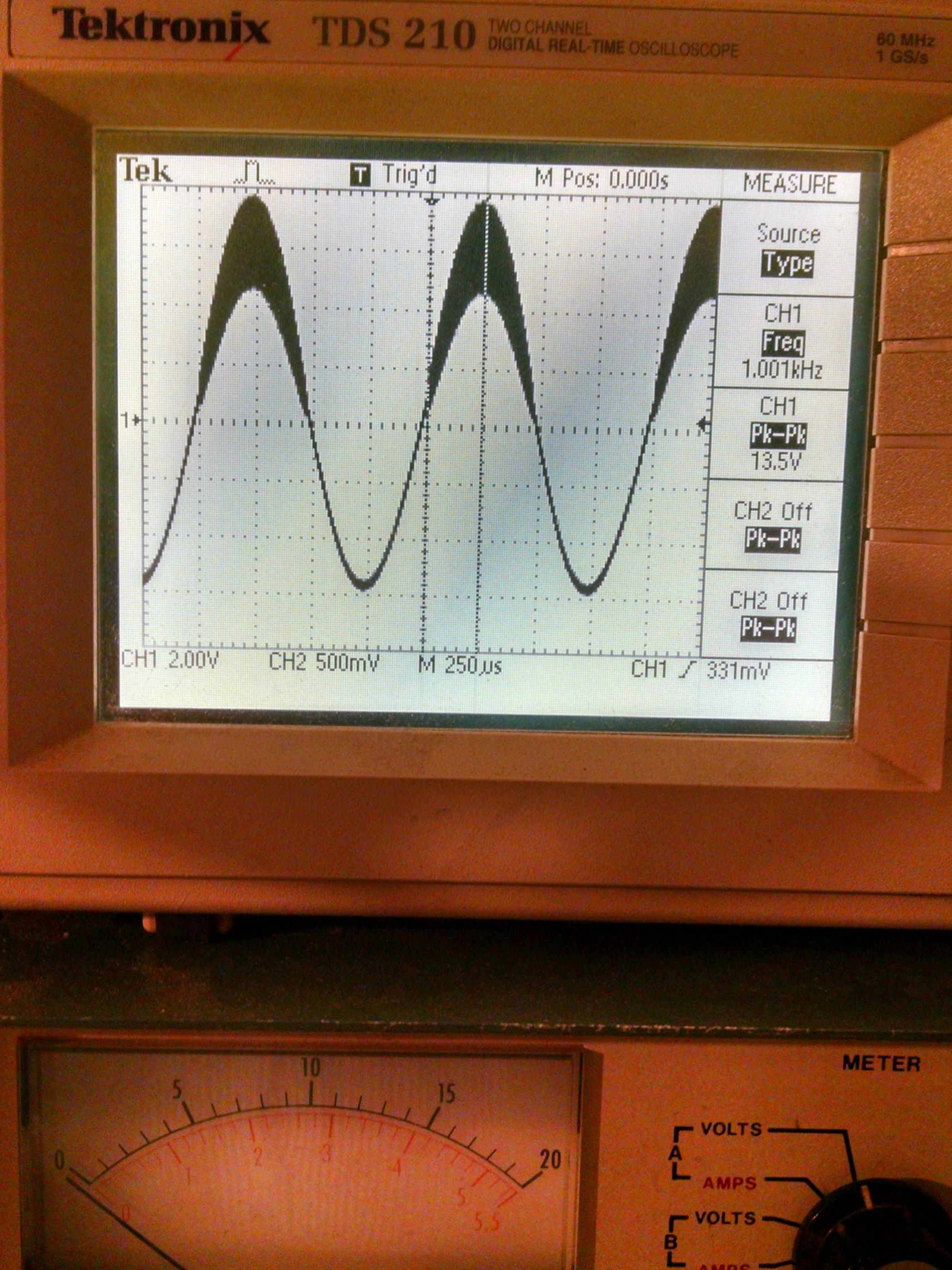

Hi ! In this amplifier I built I am having some trouble.
1. parasitic oscillation at middle level input signal ( 400 mV ) measured at the output with 8 Ohms resistive load. No oscillation at maximum power before clipping nor minimum power. It tends to improve when increasing gate resistors to aprox 820 Ohms, but output power is reduced also.
2. inverted T5 ?
3. low quiescent current. Measured placing a 0.1 Ohm resistor in place of one of the fuses, showed 20 mA. I increased the current by placing a trimpot at 435 Ohms instead of R19. I adjusted current to 340 mA total. Is this correct ?
4. output inductor made over specified 0.22 Ohms resistor. Most amplifiers use 10 Ohms for that resistor. Is this OK ?
5. changed C2 to 47 pF and its symmetrical on T8 and T9 , the oscillation is better but raise time is worse now from 1us to 2.5us - How to eliminate this oscillation ? I am trying not to add extra capacitors to de input stage ...
Help and advice much appreciated.
2. inverted T5 ?
without simulating your circuit I would suggest omitting both Miller capacitors (the 4.7pF you have suggested might be increased to 10pF) but add a 100pF+100 ohm series pair between the collector of T8 and ground. I would also add a 10nF across R22.
However I wonder if the VAS currents will be high enough. What is the voltage across R17?
What is the frequency of the oscillation?
Hello john_ellis, thank you for your reply. Problem solved, please check this link

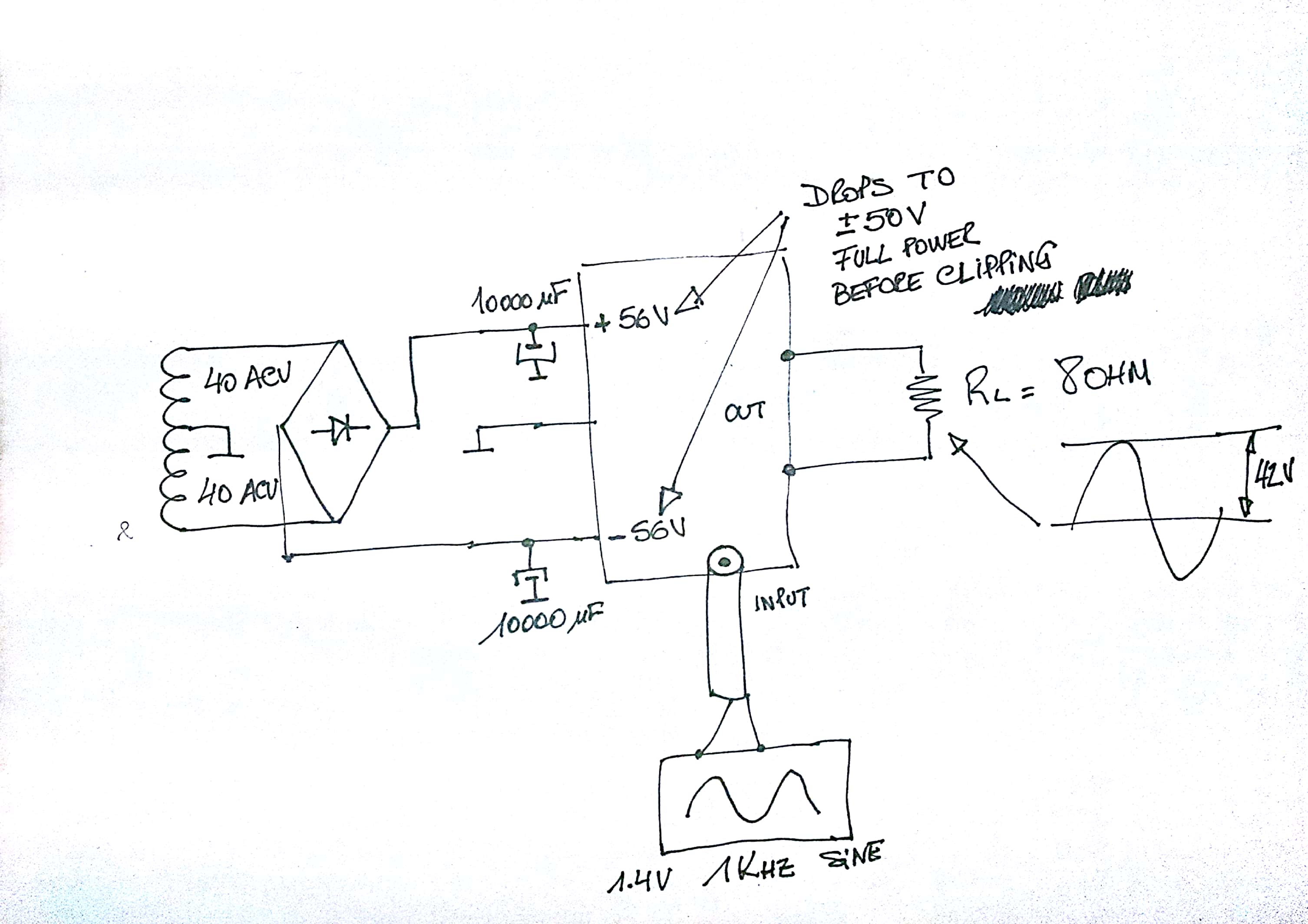

POWER SUPPLY VOLTAGE DROP & NOISE AT THE OUTPUT
My Goldmund clone (4 output MOSFET version) is working. Except for 2 issues:
Issue #1: the power supply shows a huge drop from +/- 56V rails (no input signal) to +/-50V when full power before clipping. Measured at the speaker output, clipping appears at 42V amplitude over 8 Ohm resistive load.
The transformer is rated 330 VA and was custom ordered, it shows the specified 40 VAC + 40 VAC even at full power. Measured with a True RMS multimeter. Please see the attached picture with the complicated wave shape as input to the rectifier bridge, 20V/division scope scale.

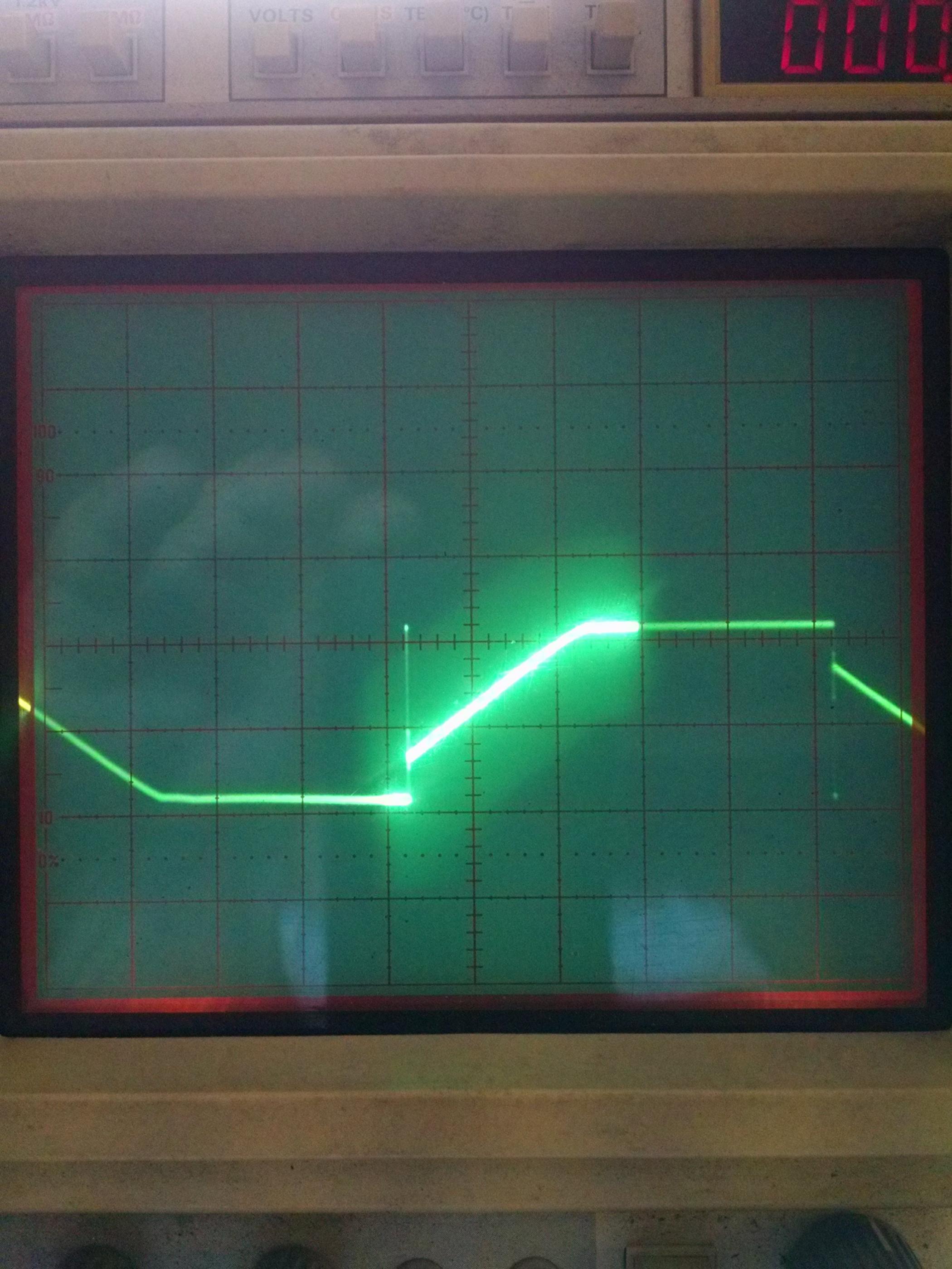

Issue #2: with the input shorted, the second attached waveform appears at the speaker output, with resistive 8 Ohm load. The amplitude is about 10 mV peak to peak, 5 mV/division scope.
There is no significant votage drop in the cables. I don't think that the rectifier bridge can produce such a voltage drop. This is a KBPC5010 ( 1000V - 50A) (click for PDF)
This board has 2 x 10000 uF Panasonic good quality electrolytic capacitors, one on each 56V DC rail.
What about the rails voltage drop ? Is this noise normal ? How can I fix both issues ?

Drop on the bridge is about 1V per rail, rest is drop in transformer, more capacitance can help also.
You measure 40Vac but thats not sinusoidal voltage, it is like clipped sinus. Put scope on rail (AC) and see what is there, you can also measure transformer secondary.
Issue #2, spikes coming from rectifier, it is EMI coupling to input wires.
You can damp that spike with snubber on trafo secondary.

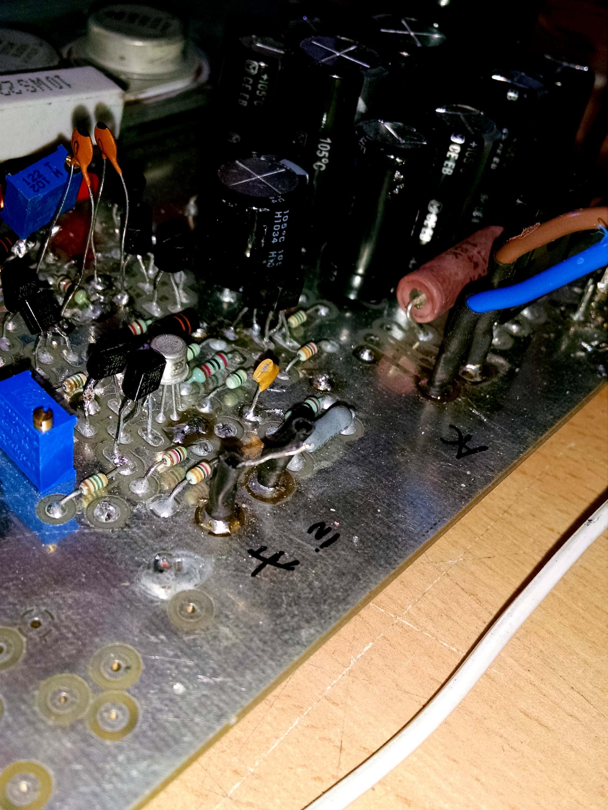

Dear sajti, thank you.
Here are the pictures, this is the well known 4 MOSFET original version with the Nagys boards I bought from him.
Please notice that this noise appears with the input shorted, and 8 Ohm resistive load. There is no cable attached to the input. Just the shorted terminals. It has 20 mV and it is measured at the speaker output. Matches the picture from my previous posts.
I would like to eliminate it.

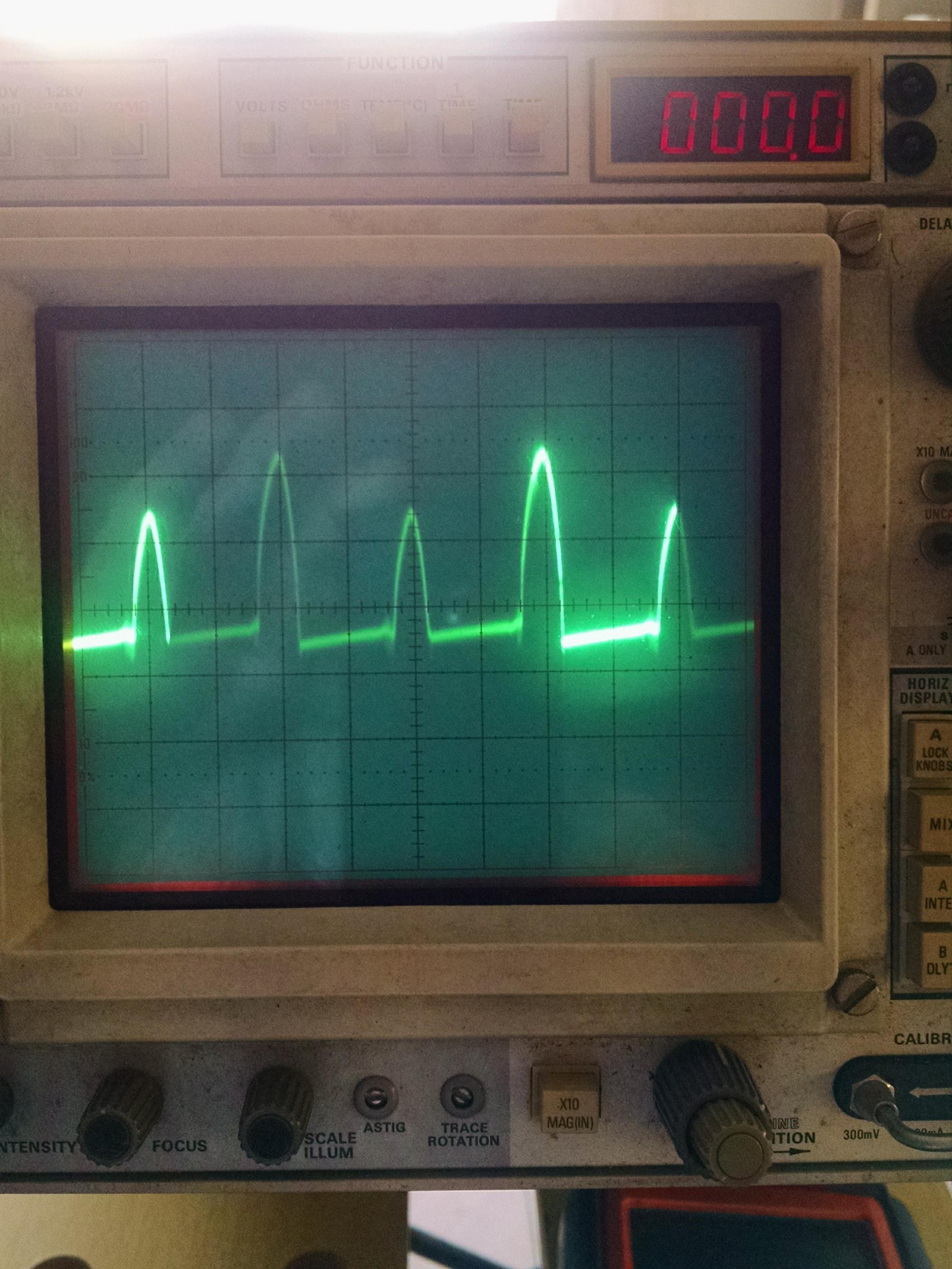

Issue #2: the input is shorted. How is it possible for EMI coming from the power supply transformer to produce this output noise. I can also see that is located in the positive region. No negative excursion of the signal (below ground). Any ideas about this filter you propose ? How would you do it ?
Huh,.....
my coment was related to issue number and picture number, but now I think
that you swapped pictures.
Is this pictures attached below, what you measured on amplifier output?
If it is, then forget about my coment on EMI coupling.
That on the picture is charging pulses of main electrolitic capacitors.
If you really have that on the output, you will hear buz and hum, but you already mention that amp is silent.
So it could be measuring error, gnd probe of the scope attached on the high current path, or ground loop....
No radule, there is no picture swapping. If you read my first original question on this subject I am showing the speaker output. I am measuring with a good old Tektronix 465 because mi other digital Tektronix is useless for this low level signals. The power supply drop issue I figured out myself and it is no longer a problem.
The noise seen at the output ...mmm...this worries me. The scope is placed with ground lead at the very point where all grounds (single point) are connected, meaning the 0V from the power supply and ALSO the speaker ground. The scope's ground cable doesn't seem to be picking up noise, I shrinked it with my hand and the signal remains the same. The probe is a brand new B&K Precision 100MHz.
Any ideas ?
