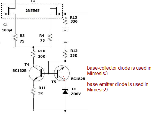

Is T6 connected the wrong way around in that? I seem to recall having seen it connected the other way in other schematics.sure!!

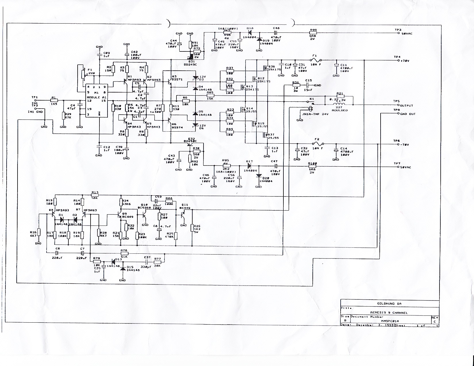

What is in the 'module'? Same as your redrawn schematic of the input stage? But what about T6?my amplifier was based on this plan
Did you use the same early stage power supply rail regulation as the schematics?
If you talking about BC182B T6 works fine in both cases ...
If you talking about front end supply i use my own.

AFAIK the use of uncommon base-collector diode (with emitter tied to base) happened only with Mimesis3. In later models such as the Mimesis9, the common base-emitter diode was used instead.
I simulated both ways in LTSpice to find out if this was accidental or intentional, and I think I found that the uncommon connection (Mimesis original) performs better (very very microscopical tho), may be as a result of different capacitance between b-e and b-c...
But then I didn't like the idea of using noisy 6V zener, so I used different current source (using two-transistor ccs) for the input LTP.

Jay , this design is most primitive .
The 2Q (or even a red led) is better (noise vs. PSRR).
I have my design's cascode (symasui) ground referenced off a zener.
It is noisier than a non ground referenced resistive .
Another design uses a LED + a zener , with the led at the cascode bases and
not referenced to ground.
The mirrors higher Z might offset the zener noise ... but this is just a
"quick fix" with many better options. You could get higher CCS Z with
just a resistor ???
The best variant of this input stage is the 3 stage sansui .... with FET's in
the first stage. Vzaichenko uses it in his valve IPS .... I use it in
the Kypton V. Both these beat this design by huge margins.
The distortion (and H2/3/5) is shifted/changed by the LTP Z.
PS- H2/3/5 also changes with amplitude when you tamper with CCS Z.
I wonder why they potted this IPS , to hide it's weaknesses. 😛
Edit - the 20K at the tail shows they were trying to manipulate Z.

The Telos basically same as Mimesis, except some points:
- LTP Iq is higher, same 4.3mA. The 6V zener of Mimesis instead by LM329 precision low noise 6.9V zener.
- VAS Iq a bit smaller, same 7.8mA for both sides. VAS devices are Zetex transistors, FZT957/FZT857 SOT 223 SMD.
- Individual driver (MJE340/MJE350, but they're KSC2690A/KSA1220A for Telos 5000) for each MOSFET output pair(Exicon ECX10N20/10P20). There are six pairs output per channel.
Based on this info, you can transform Mimesis to Telos.
