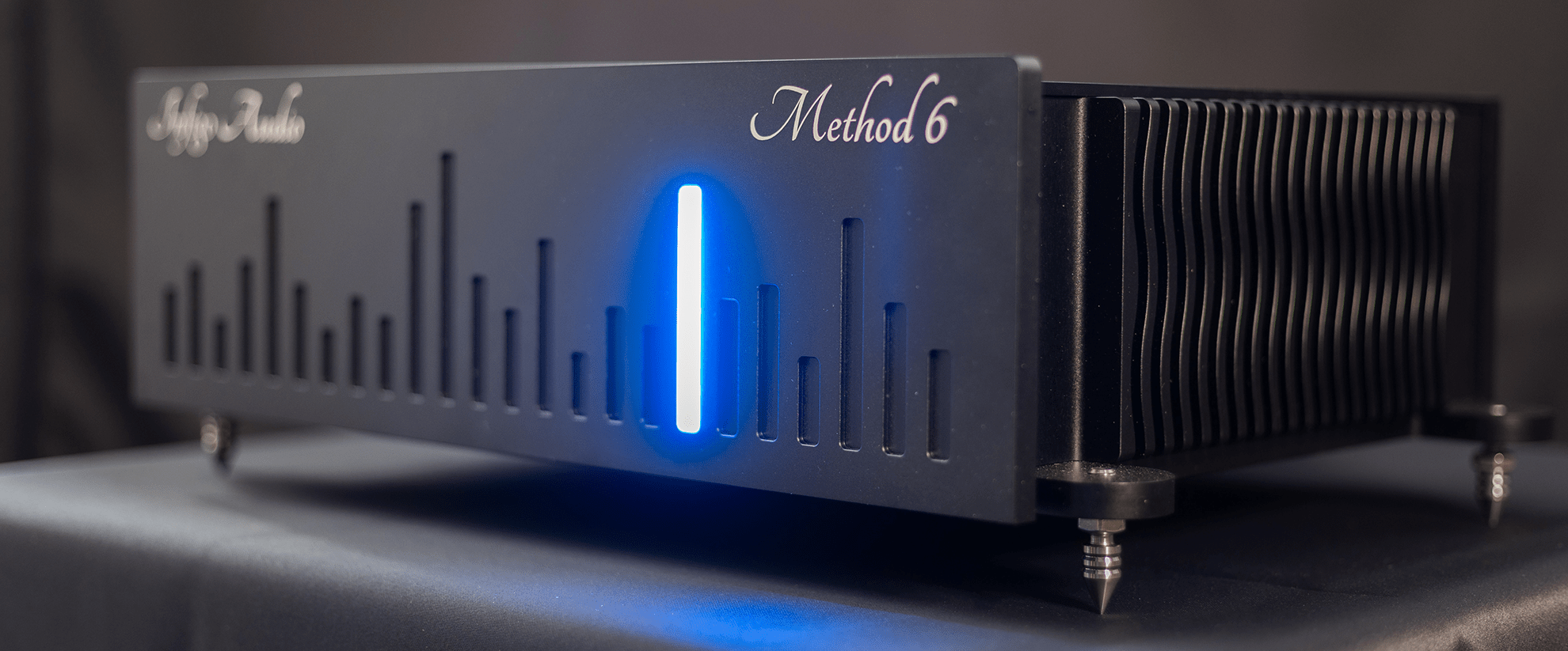

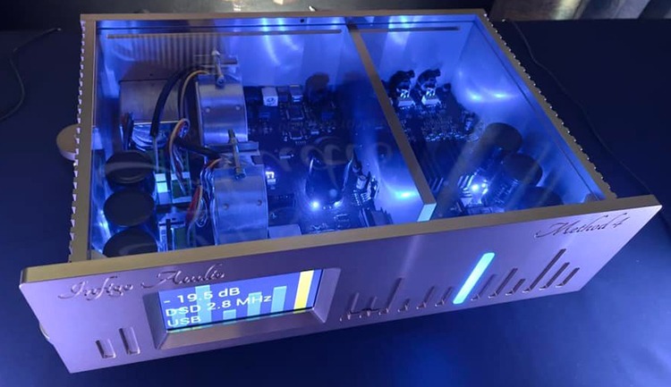

the mute for anti-thump is the manual switch on the front panel? so we engage it both when turning the amp on and off to prevent pop/thump? instead of VU meters have you considered a huge colored LED? LOL I know it's probably TOO LATE in the design process. I just think this infigo amp has a cool LED on the faceplate. also he has some cool internal leds so that you can take the top off and it looks like a high end gaming pc. It's definitely an alternate aesthetic from the usual high end amps. but people love colored LEDs now, have you seen how many smart led rope lights and things you can find on amazon now? also if you pick a color and stick with it with all your products, it can be good branding so people associate a look with the brand "oh vera fi amps are black with an evil red looking bar". I know you have a preamp design coming out, but have you considered your industrial design language and what it says about your brand?
