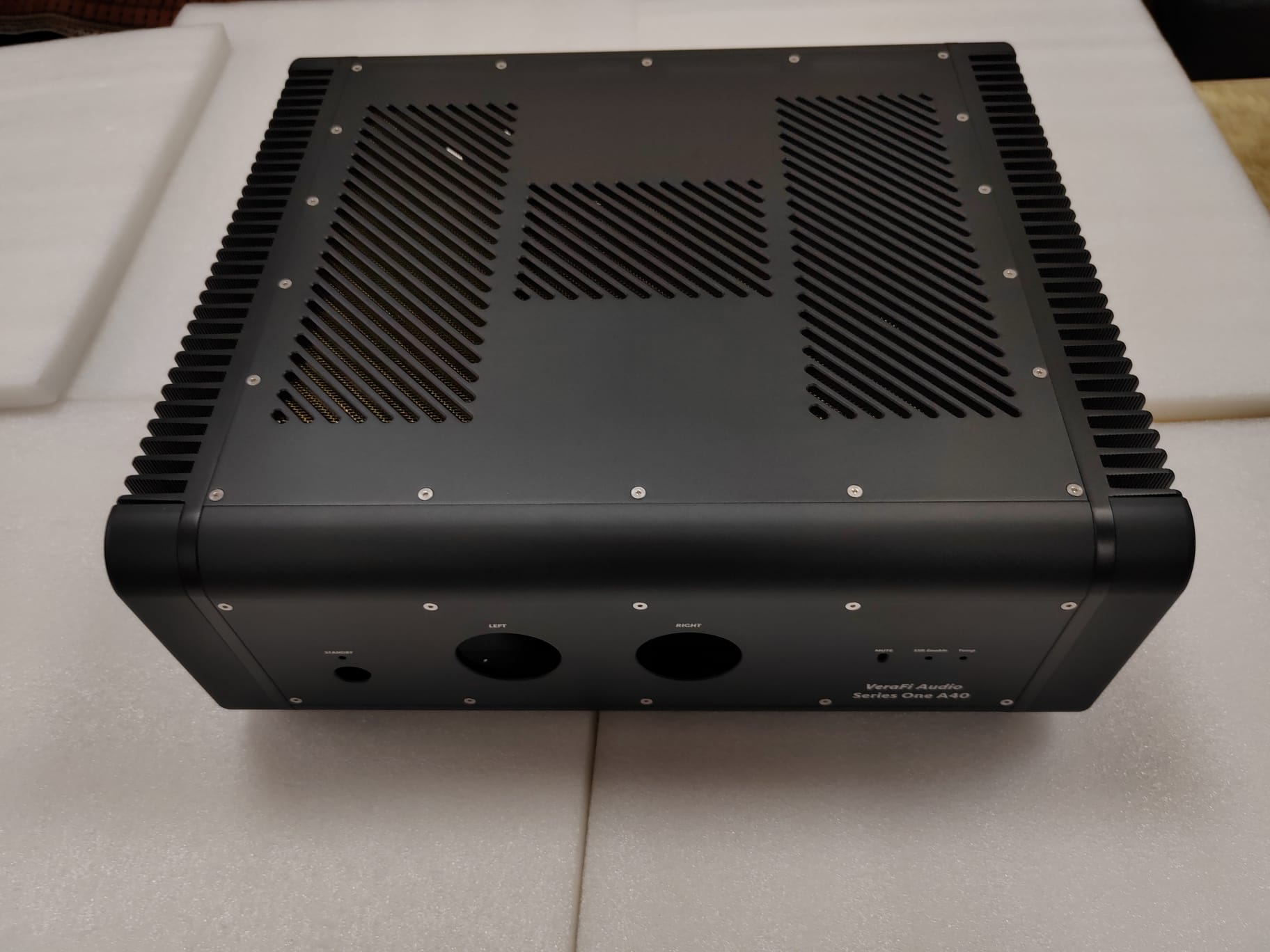

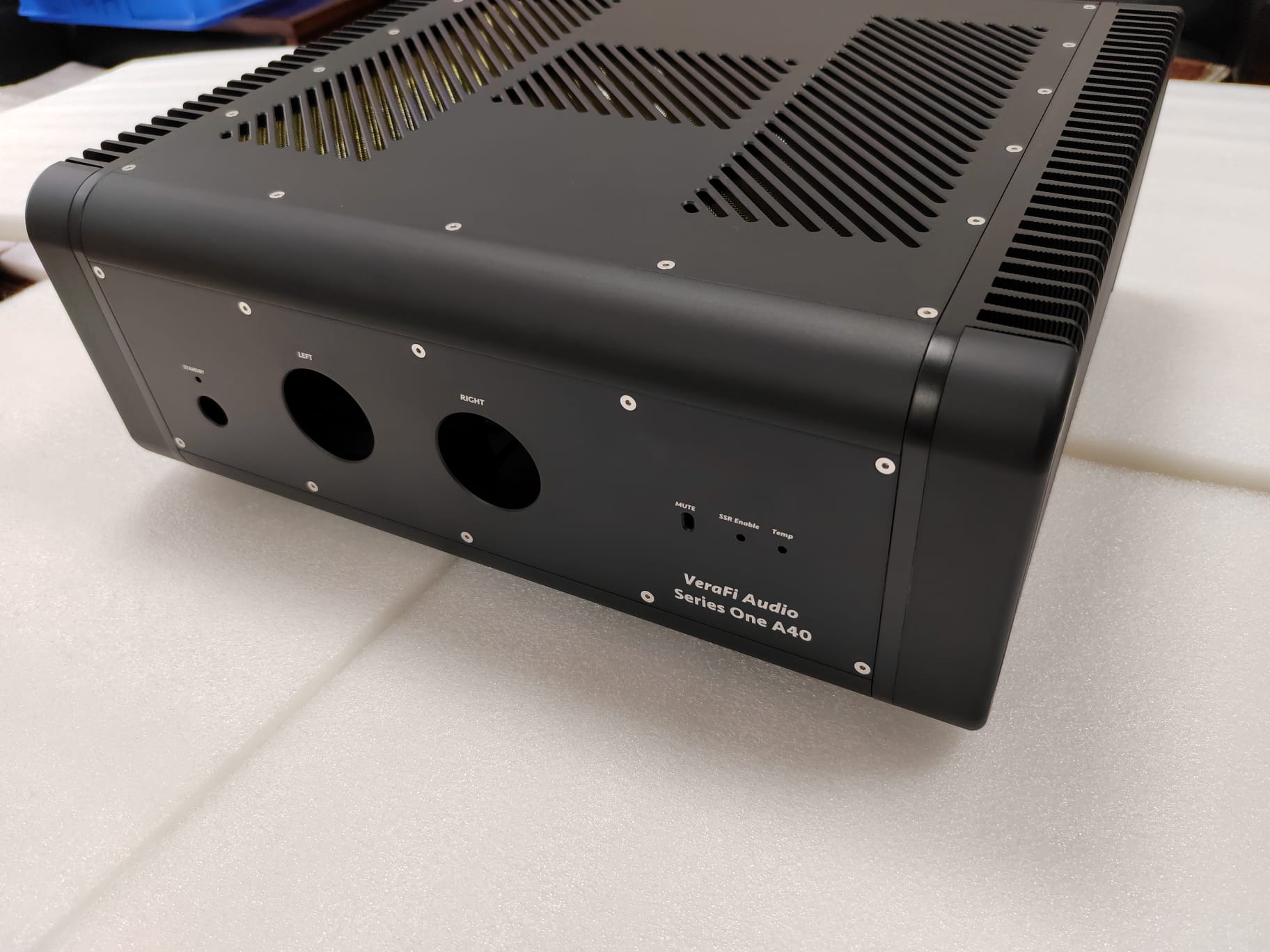

The new A40 chassis (350mm deep) just got completed and is being shipped to me. It’s looking really nice.
Looks great! I’d encourage lower contrast (darker) screws for the final product, but that would just be my preference.
Agreed, I’d go for a ‘stealth’ look.Looks great! I’d encourage lower contrast (darker) screws for the final product, but that would just be my preference.

I should have mentioned that the silver screws were what the shop had on hand for test fit. Production will use all black of course.

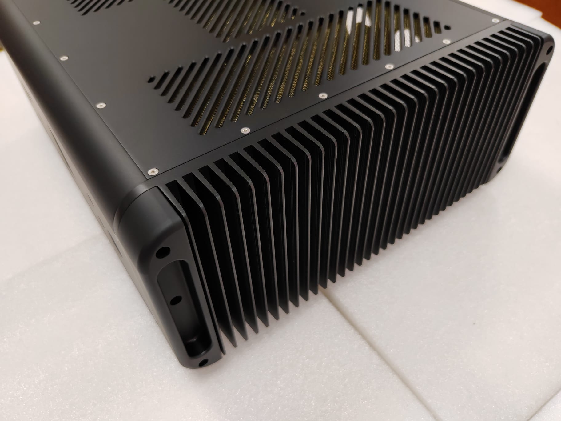

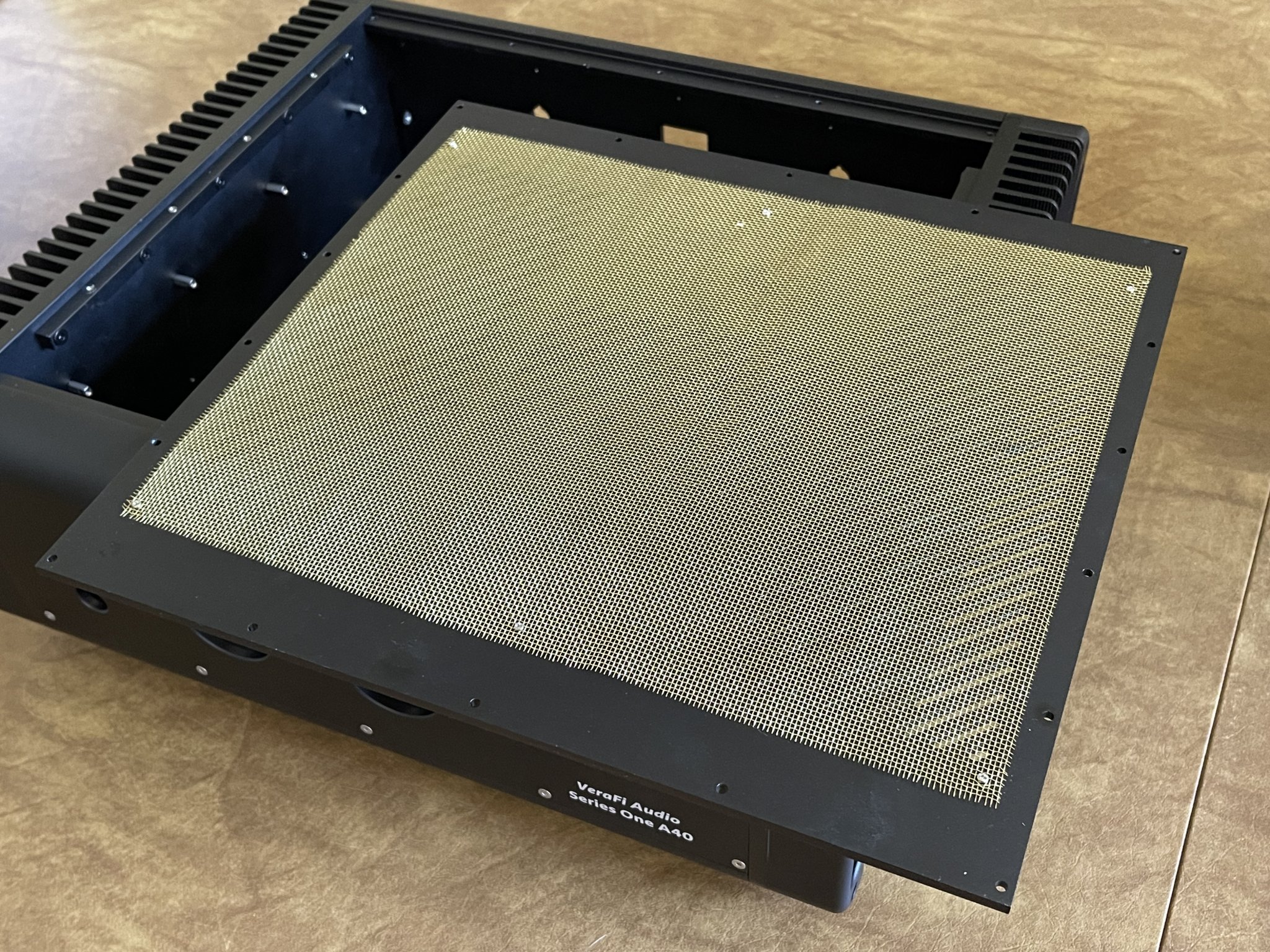

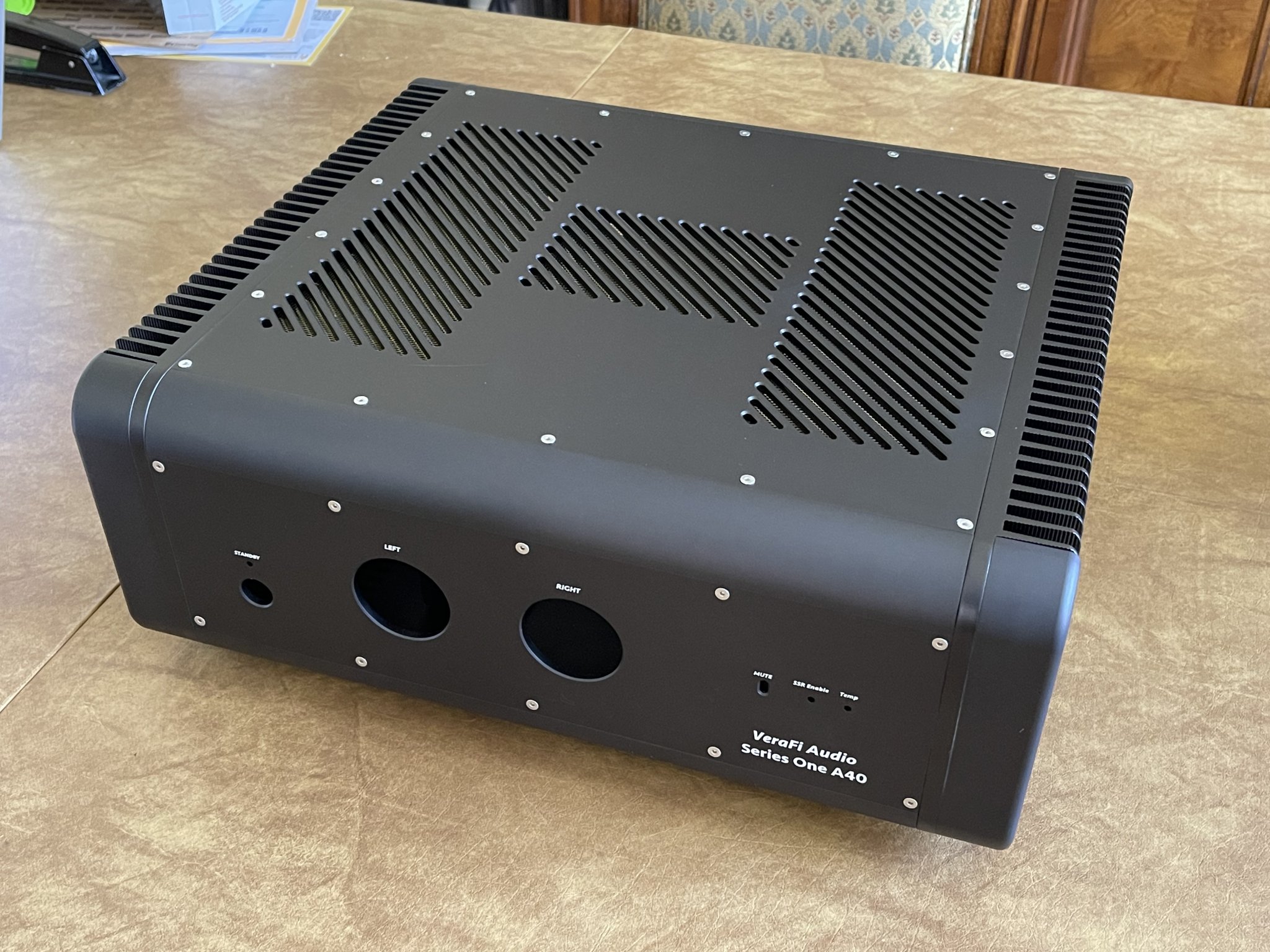

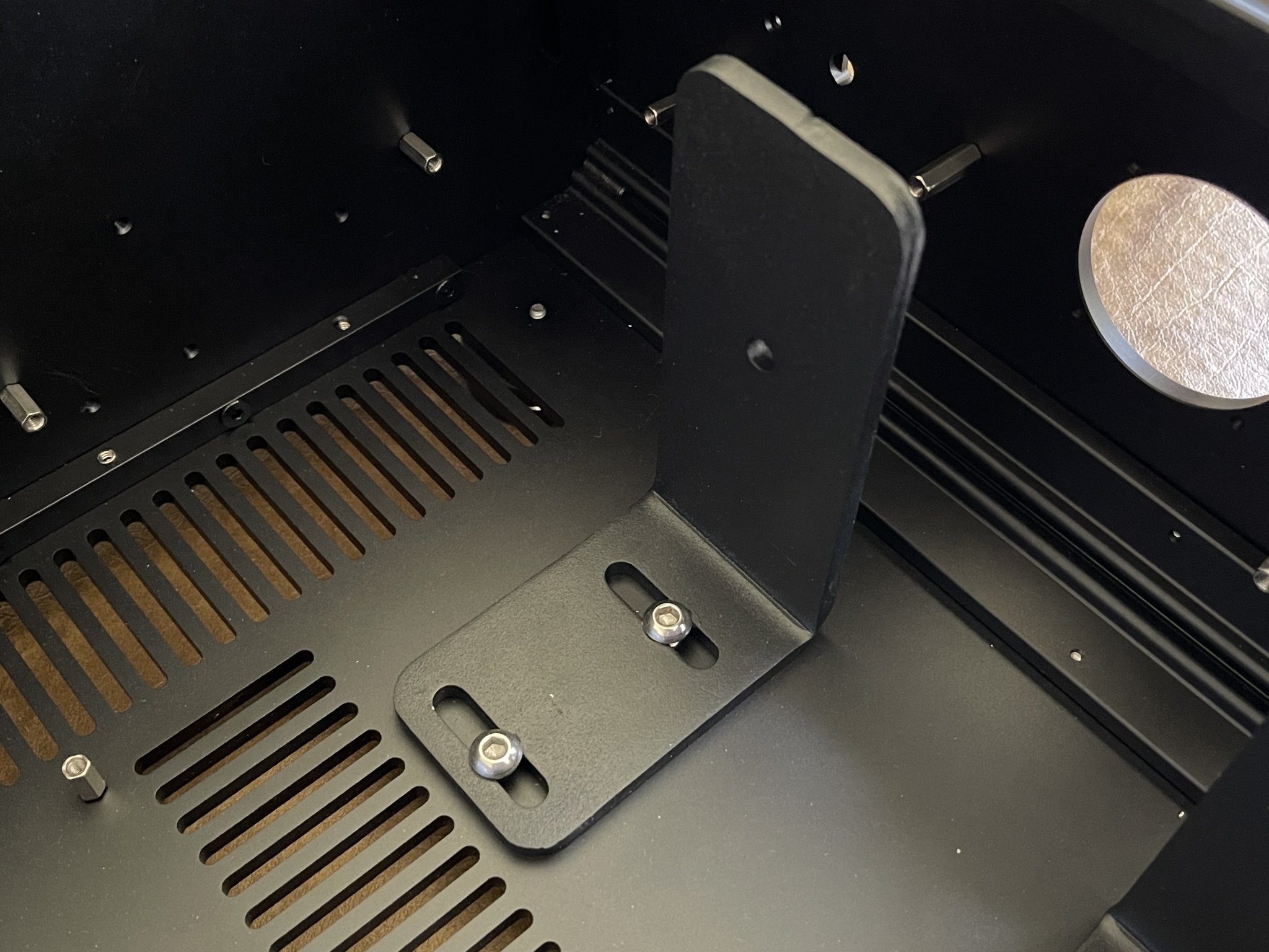

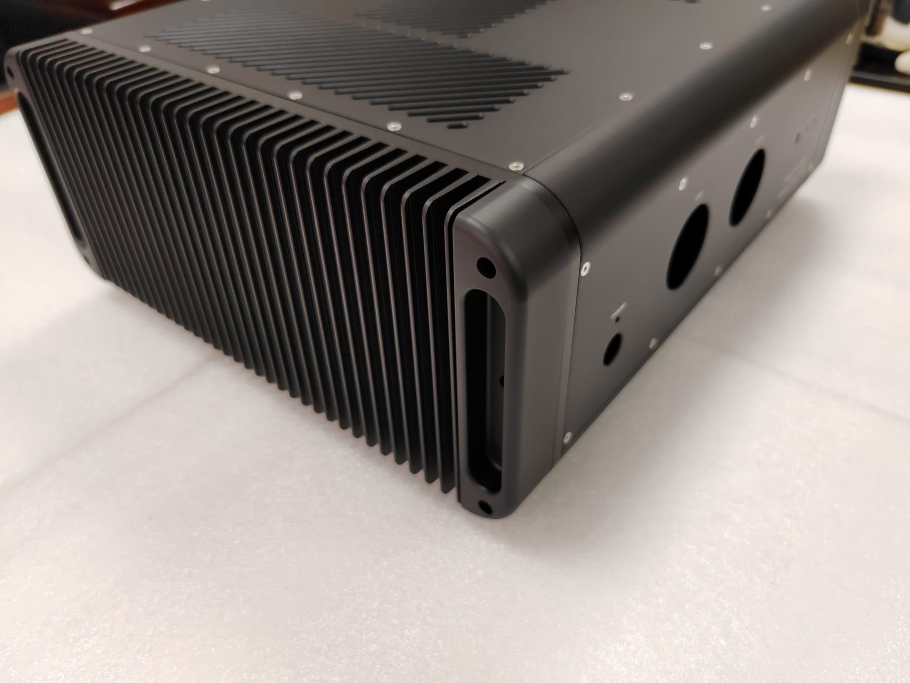

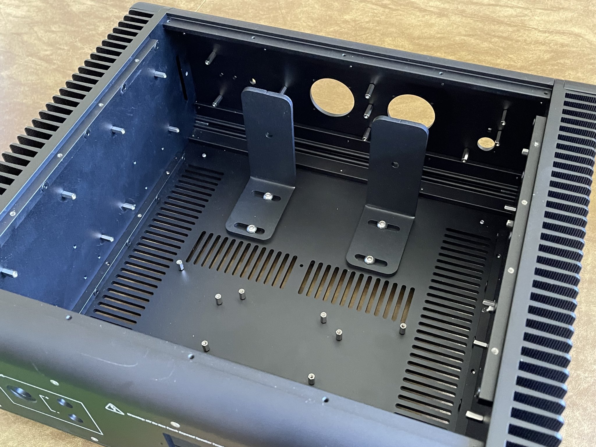

The new chassis arrived. 350mm deep heatsink. It is massive and heavy (29lbs of anodized aluminum). All walls are at least 5mm aluminum. I like the custom trafo L brackets. All hard mounting points for standoffs and MOSFETs etc are in place. All the crew holes align and fit perfectly. The lid fits perfectly with no gap and is square. Wonderful CNC machine work quality.
We have a Schaffner EMI filter between the IEC mains and PSU board. Internally, the amp is all linear so the main noise we deal with is 60Hz mains hum radiated from toroidal trafos. Setting them vertically and keeping distances and playing with alignment and orientation while observing B field with a magnetometer helps. Final proof is uV rms measurement of amp output noise.

I designed the chassis and Darko M., a super talented mechanical engineer put it into CAD. We have an excellent CNC fab house. I am lucky to be able to think up these things and have them become reality.

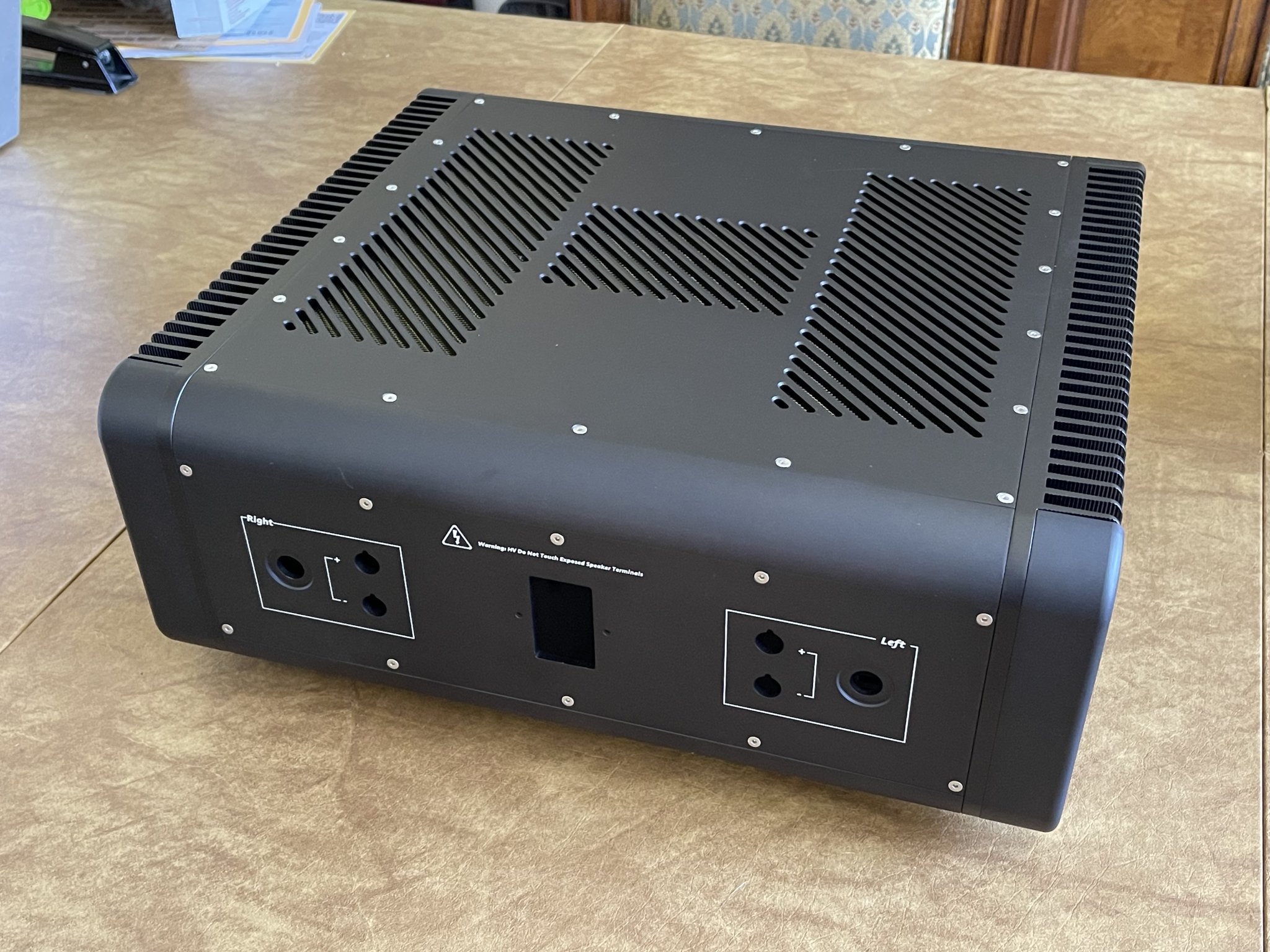

The enclosure looks even better in the deep size! just emailed you and asked to be put on an email list so I don't miss out on the first batch.

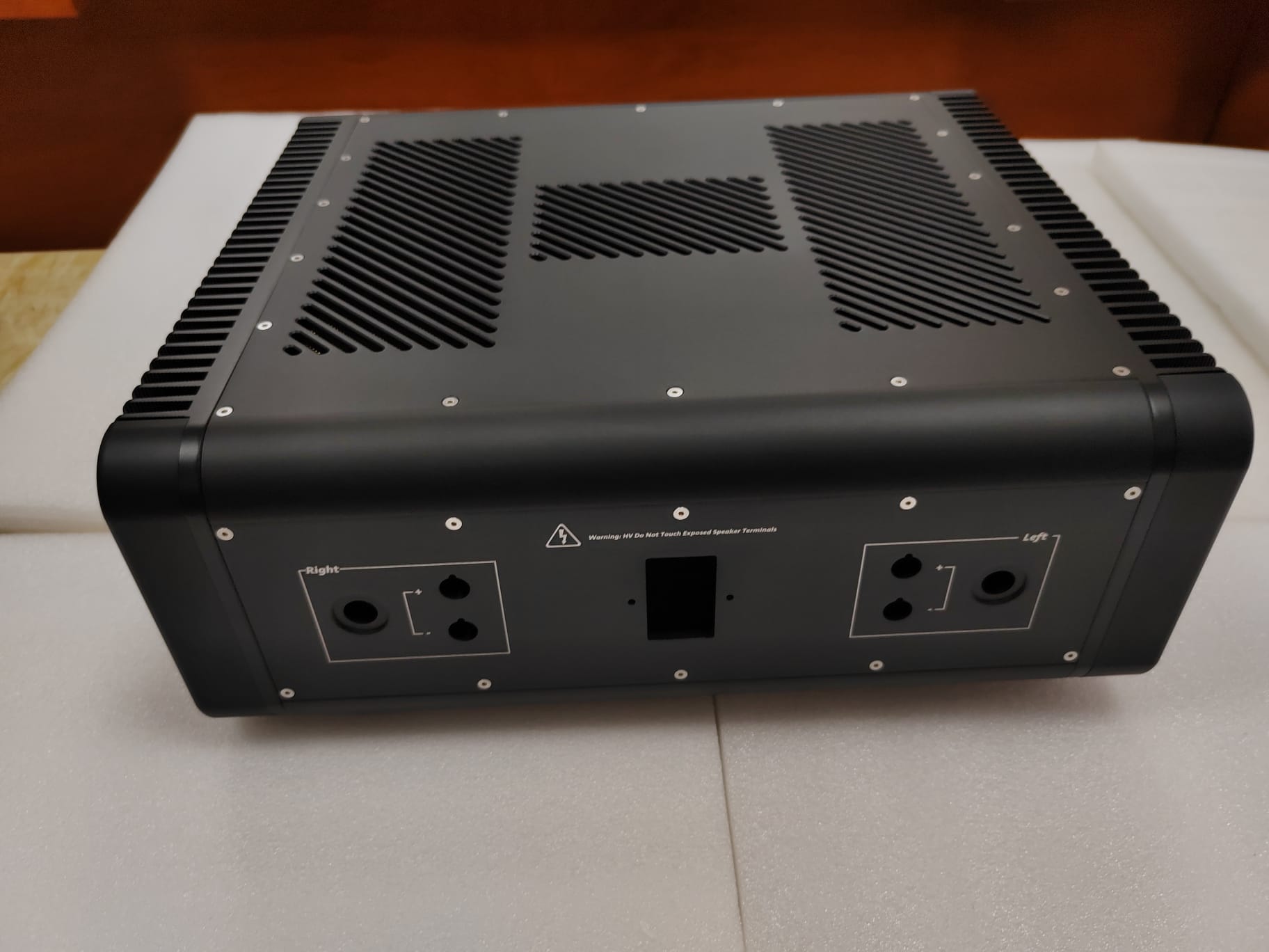

It may just be me, but the outputs appear to be reversed. The left one is labelled right & the right is labelled left.
