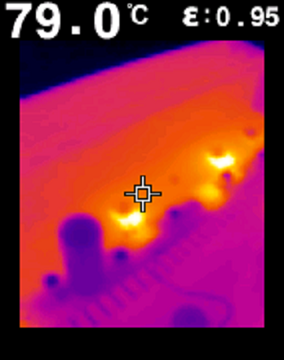

Let’s plug in a few guesstimated values and see what we get:
Let’s assume:
Power Dissipated = 80 W
Ambient Temp = 25 C
Theta(Heatsink-To-Air) = .3
Theta(Bracket-To-Heatsink) = .1
Theta(Case-To-Bracket) = .3 (Kapton & Grease)
Theta(Junction-To-Case) = .7 (Guess For Super TO-3)
That would give us a chip temp of:
TA+PD*(THA+TBH+TCB+TJC)
=25+80*(.3+.1+.3+.7)
=25+80*(1.4)
=137 C

And you can guestimate the temperature of everything else from there:
Heatsink will be (roughly) at 49C, Bracket will be at 57C, and case will be at 81C
See where you're off and you know where to start improving. 🙂

It's normal for the case of the transistor to feel much hotter than the heatsink, one will be touchable, the other will not. It's possible your thermal interfaces are fine, but you can't know for sure until you measure. The temperature probes that come with inexpensive DMM's would be adequate, maybe even a cooking thermometer if you have one of those around. Have fun 🙂
Some images: on the VFET, on the T bracket close to VFET and on the heatsink close to T bracket (at 1.5A bias)
I combined two mica of TO-247 size for insulator. Unfortunately, the new material insulator from Panasonic (graphite) is so thin (the thickness is 0.5mm = 0.01mm graphite + 0.506mm adhesive) => easy to short circuit and thermal conductivity is hard to transfer through thick adhesive layer. I bought a new graphite (0.1mm) without adhesive and test later.

@Mike: you was right, the temp on VFET never the same the temp on heatsink😛
