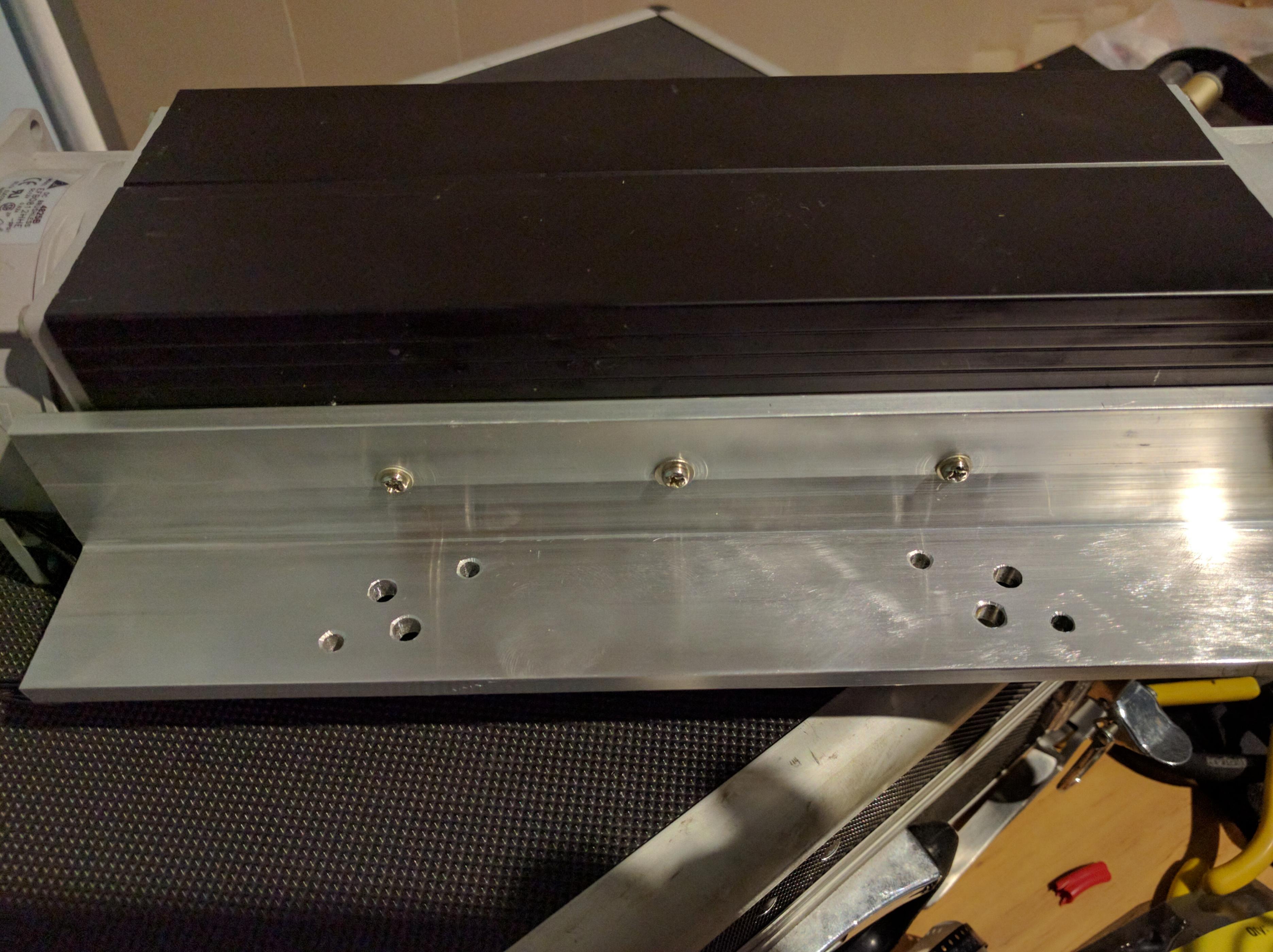

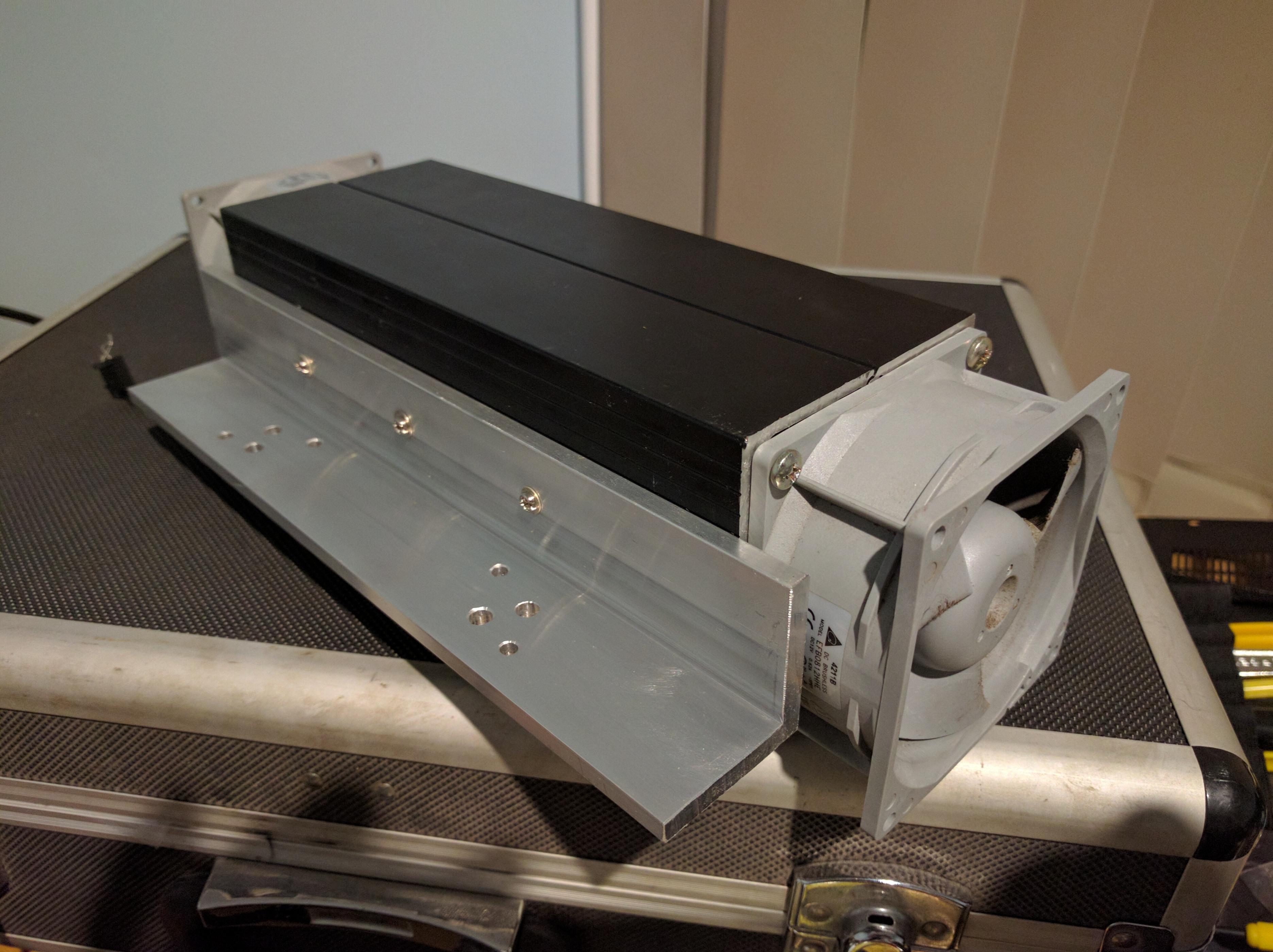

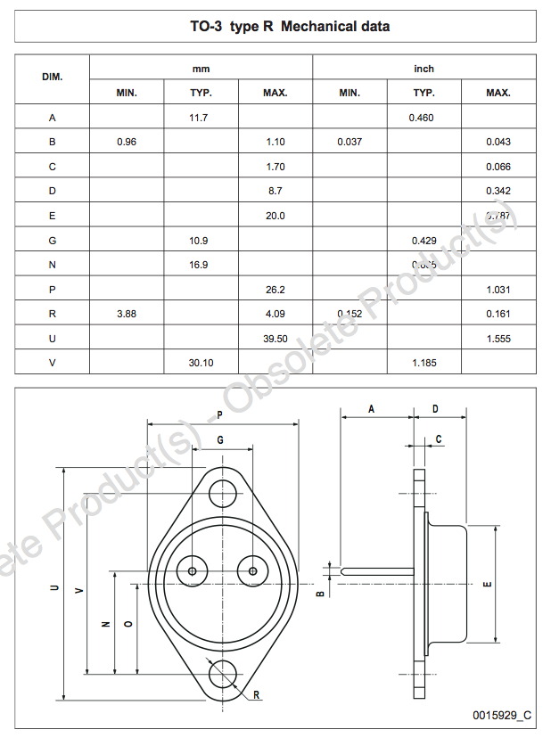

.....so, silly question potentially, but where can I get a drilling template for to-3 transistors? Google is surprisingly unforthcoming!
... there are no silly questions, only silly answers...
do you have something like this in mind ?
progress
Thanks for that. 🙂
I ended up printing out a PCB that had a bunch of to-3 transistors on it and used that as a layout template for drilling. End result came out ok I think.

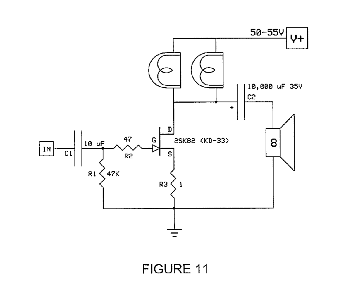

I'm looking at constructing something painfully simple based on one Sony 2SJ28 per channel. Would the diagram posted as the first post in this thread do the trick, or alternatively, something like in the attached diagram? - from Audiohobby.com.
I understand that the 2SJ28 needs negative voltages (whereas the now unobtainable 2SK82 used positive voltages). I think I may need it explained to me how this would work in practice, ie: how to wire up these devices.

Hi there! 🙂 You should be all good to invert the voltages (including the bias voltage) and away you go. You might find it informative to read This as a rather more advanced example of what you're trying to achieve. 🙂
Edit: That said, I think there's a warning in the document about which grade part works in that schematic. I'm not familiar enough with what the various grades actually mean to make an intelligent suggestion about whether the part you have is suitable
Edit Edit: part 2 of the l'amp articles, Figure #1 shows an adjustable bias version using an inductor as the load for the V-Fet. Keep your lightbulbs instead of the inductor, but build the bias circuit shown in Fig #5. With all the voltages inverted...

Lightbulbs may not be the ideal... they're non-linear resistors.
But might sound interesting...
Consider Current Mirrors, chokes and even a resistor instead?
Lots of schematics for SE output stages.
Probably needs a fair amount of drive...
_-_-
Last time I looked, circuitdiy.com still had the 2SK82's. It's the 2SJ28's
that are harder to get. Of course you can make that circuit with the 2SJ28's
by simply reversing all the polarities.
The circuit presented above is likely to have some issues. First off, the
Vgs of the part is usually in the range of -5 to -10 volts for 1 amp @ 20V Vds.
This puts you into several ohms value for the Source resistor, and will
seriously cut into the gain.
You can attach the negative side of the loudspeaker to the Source pin of
the VFET, and that will at least give you the gain back, if that's what you need.
I usually used a 300W light bulb for the load, which was about 22 ohms
in this kind of circuit, and it worked pretty well. Look at the Zen Lite for that.
I didn't find the non-linearity of the light bulb to be a significant issue. The warm
glow of the bulb more than made up for it.
