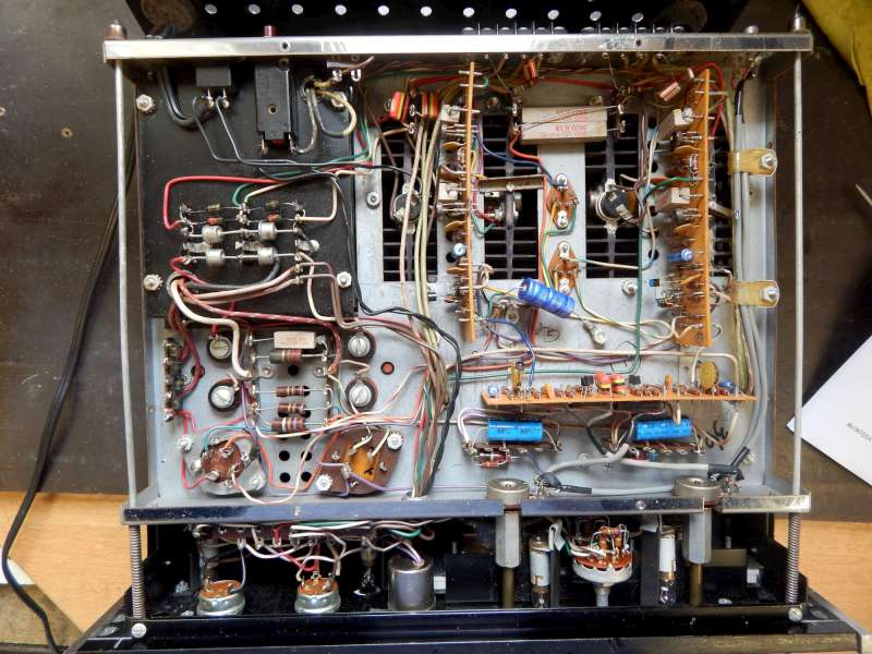

P.s just did buy a mcintosh
Hi eduard!
Love to see you, my friend! I love the sound of Mcintosh, I see your amp is a old model but I think the sound still good!
