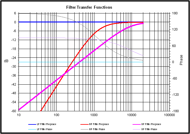

I think this is going to be pretty easy in that respect. When you look at the compression driver response graph, you see that it "tops out" at around 1,2k, which looking at the directivity maps is quite a nice place to cross over from the woofers. An electrically first order filter around 8-10kHz should do the trick. Now, the woofer might need a little more work to get the slopes to agree, but I'm not really intimidated by that.
I've tried 1st order on coax horns but never liked them much. 2nd or 3rd always sounded cleaner to me, even when FR is similar. 1st order is worth a try, but don't neglect the steeper filters as they can sound much better. Not sure I understand the 8-10K part. Do you mean a shelf?
No, I mean the cutoff frequency. The response of the compressor falls ~6dB/octave with rising frequency, so a first order high pass centered this time at around 8-10kHz will tilt that response back to something resembling straight. Not always sufficient, but sometimes all that's needed. So the electric "crossover point" is totally different from the acoustic one. So when calculating the cap, it would be something like 1/(2*pi*8kHz*8ohm), roughly, and that combined with the real response of the driver gives a natural crossover point somewhere around 1,2kHz looking at the datasheet.
Why I use 8-10kHz? A rough guesstimation looking at the datasheet, that this is the point where the response stops rolling off. This will of course have to be implemented, measured and iterated.
Oh, OK. Gotcha. Didn't understand what you meant. Yes I can see how that would work well. I've done tricks like that with tweeters. CLS has a point about protection, but with a 1st order that high, there shouldn't be much left down low to hurt the CD. Easy to simulate, I suppose.
9Khz 1st order vs L-R 2nd order at 1.2KHz.
