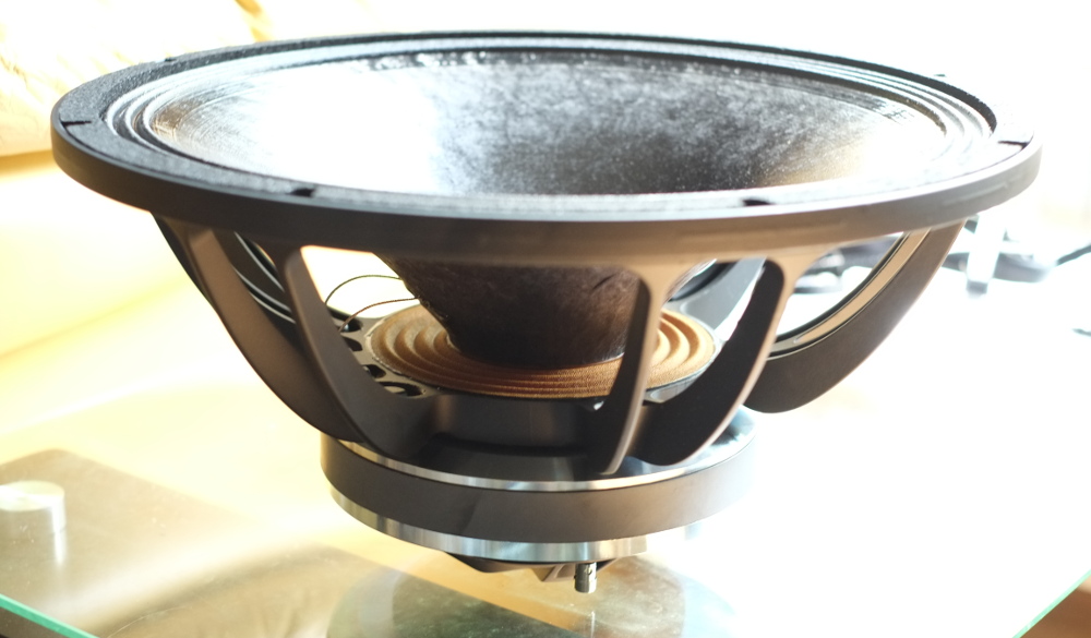

It seems those Reaction Audio things use Radian drivers. Surprisingly expensive driver for the retail price.
And yeah, I already have the 15FCX76 on order. Can't wait to get my filthy hands on them. I was surprised though about how hard it was to get these. Usually this "give money, receive stuff"-affair goes at least a slight bit easier. This time it was e-mail, wait, e-mail, wait, and so forth.
So, finally this morning the mailman ringed the doorbell, and brought in the new cardboard box for our cat. It had a couple of these round things in it that I had to remove.

Ok, we have some initial measurements. Can't post any graphs right now (still stuck at work), but they look very, very promising, even with a quick'n'dirty crossover with just a handful of components. Easily within 5dB between 200Hz and 18kHz with just a narrow peak at 15kHz.
If all goes well, we'll have the first prototype pair running on tuesday so we can sit and have a listen.

Well, it's still a lot cheaper option than for example the 18sound 15NCX750, which here in Finland from a local dealer costs 560€ a piece. And at least the initial measurements look a lot better for the B&C! The 18sound had a wide trough centered around a kilohertz or so, 5 or 6dB deep. The B&C unit on the other hand looks maybe even smoother through the upper midrange and crossover region than my current BMS 12" affair.
And another thing. These things are quite handsom indeed. Kind of sad that the beautifully built chassis will end up inside a box and out of sight. Build quality seems at least on par with BMS.
