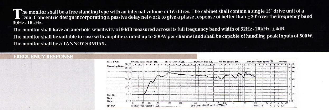

Once in a while people end up praising Tannoy coaxials, but looking at the measured response curves I don't know where is the merit ?
Maybe of interest for example Tannoy Super Red Monitor 15" SRM15X, manufacturer's specification response.
It is hardy 'smooth' above 2 kHz, and certainly not 'flat'. Response includes the effect of the cross over and response shaping networks.
Maybe not better overall than the currently available other brand drivers, after proper cross over and correction network ?

And even though that response curve you show has some quite obvious wiggles, it is still quite smooth for a coaxial. Take a look at e.g. Beyma's 15XA38Nd's FR plot.

Tannoy published curve has no sharp edges because of heavy smoothing due to it being marketing material. It looks smooth for that reason.
Some PA coaxials have intentional difraction throath (like Beyma) in order to achieve wider polar response. Wide polar response can be important in their intended application.
Elias, +/- 2dB is pretty good, not many modern speakers can do this without DSP correction. It speaks for the company that they show the results on a 5dB grid, usually it is 10dB, which obviously makes things look much better.
Well, that Tannoy plot has major grid of 10 dB. "potentiometer range 50 dB" as written in the plot.

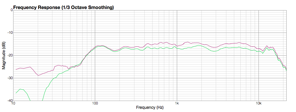

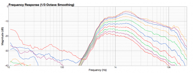

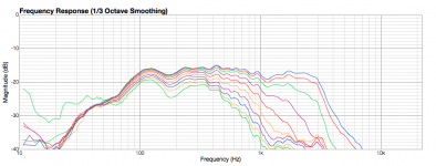

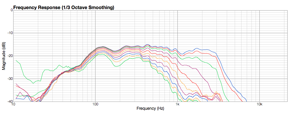

Here are some measurements (1/3th octave smoothing). High frequency raw responces, low frequency raw responces (0, 10, 20...90 degrees) and responce with two crossover versions. Btw. Don't look the graphs under, say, 300Hz. The "measuring ladder" is not high enough to give accurate data in bass frequencies.
15-incher is a big loudspeaker and that means there is also plenty of directivity. If you make a flat responce in anechoic enviroment, the product will sound very heavy and slow in normal room. Why? Because mid and high frequency are directional i.e. the room does not affect them too much. But bass is still omnidirectional and the room boost it a lot. Therefore the bass in anechoic measurement must be a bit lower than mid and highs to compensate room boost and also floor boost.

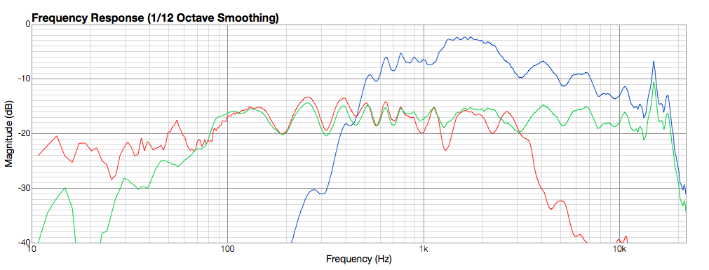

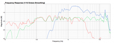

The 1/3th octave measurements do look very nice but when I change to 1/12th octave smoothing the problem is easily visible. The ups and downs below 1kHz are the mud reflection (the not high enough measuring stool) and to me it is easier to look through it than shorten the window and loose all the info of the bass.
But with typical quality horn + compression driver the high frequencies are smooth and that is not the case here. How much is the raggedness of 1.5k->10k and how much is the spike in about 15k...
Nice to see a full set of polars! It looks like 10deg steps. Could you post that set of polar data in 1/12 or 1/24 octave smoothing? I think the higher resolution graph you show might explain the harshness you're hearing. Also, even though the pattern is pretty narrow (around 70deg at 10khz?) in my experience the top octaves can sound a bit bright with a cd-like speaker and need minus a couple dB slope towards hf.
How do you determine that - I have always wondered, is there a standard? Looks like -12dB is the limit?
yes, the filter has some problems.
You are "playing to the average" - where the "average" results in broad peaks of 5 db or more. Don't do this.
Fix the high-pass so that you don't have that "bump" from 1.4 to 2.6 kHz.
After that's done.
"Shelve" the response from 3.3 to 6.3 kHz. Don't worry that you have depressions beyond the resulting average - they aren't as easy to hear.
Finally, consider a very narrow-band "notch" for the 15 kHz spike.

..If you make a flat responce in anechoic enviroment, the product will sound very heavy and slow in normal room. Why? Because mid and high frequency are directional i.e. the room does not affect them too much. But bass is still omnidirectional and the room boost it a lot. Therefore the bass in anechoic measurement must be a bit lower than mid and highs to compensate room boost and also floor boost.
-6dB is the standard when looking at the half angle. It looks like he's at about 35deg -6dB (if those are in fact 10deg increments) at 10khz which would be 70deg.

The "high end peak" is almost 10dB louder than it's neighborhood, and it's very high Q spike, that will sound ackward. I'd propably, without hearing the speaker, revisit the overall balance by tapering off the hf ~2-3dBs, CD-ish type of speakers sound somewhat bright if anechoic 0deg response is flat. By doing this the hf spike might also reduce from ackward to acceptable "house sound" and one could leave it alone (a tad of wishful thinking).
