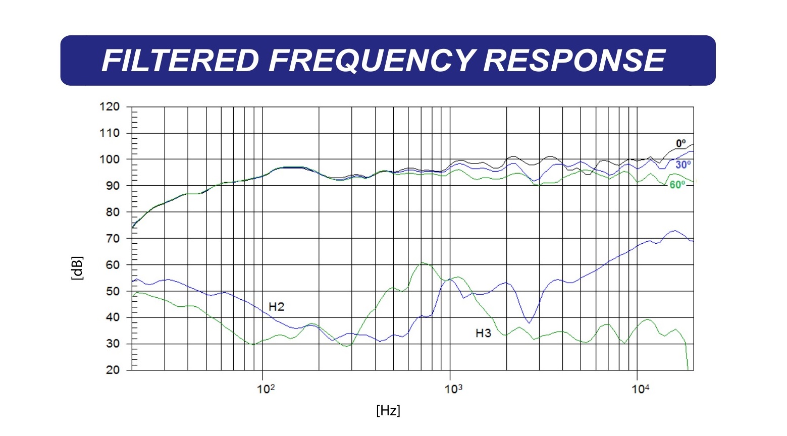

You are right, is very nice, even taking care of the 5.5K dip of the CD tweeter (HIGH FREQUENCY RESPONSE). Very smooth frequency response. OP has said he wanted only a one cone diaphragm based coax.

Beyma 15CXA400Fe vs. B&C 15FCX76 - Very similar response mounted in enclosure (LF), freq. response wise with extension a little superior for the B&C (1-2dB's@30Hz). Also the 400W of Power, in enclosure /300W it all depends of Vb and tunning and sensitivity are similar. The B&C of the OP is also a great driver for a quarter wave or TL meriting a nice future project by bjorno (diyAudio Member)...

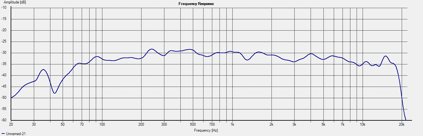

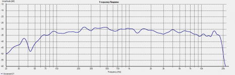

Okay, small update. I spent a couple of evenings fiddling about with the crossover and this is where I ended up. The notch on the response at ~1,3kHz might be fixable, but I'm working in an iterative way, fiddling, measuring and then listening. The measurement is a close miked one, taken at ~50cm from the cone, so port response is absent - hence the bass looks weaker than it is.
Now, sound wise this is starting to be interesting. It still a little on the polite/soft side of things, but that might even be a good thing. The weird thing is that now that I got the midrange working, the bass sort of just popped into focus with the rest of the range just by itself. Previously it sounded a bit separate from the rest, now it's a solid part of the whole.
I quite like these now.
