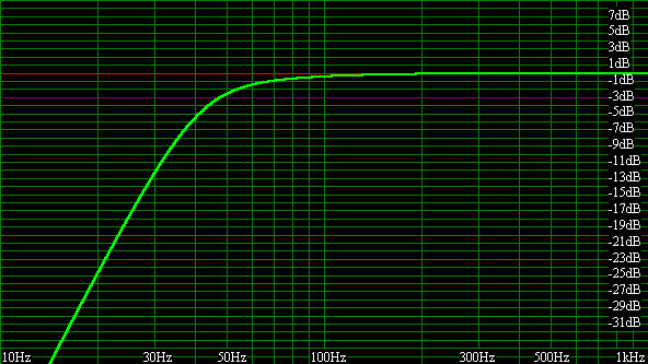

In WinISD it will only take 3w to excede xmax at 10hz, 25w at 30hz. That is if im able to use the correct numbers etc.

90 litres tuned to 40Hz looks like a promising starting point with the Oberton 15CX. Any experience, anyone? Are their compression drivers any good? At least this would make a really compact loudspeaker for the driver size (I call those 12-inch BMS based speakers of mine "mini monitors").

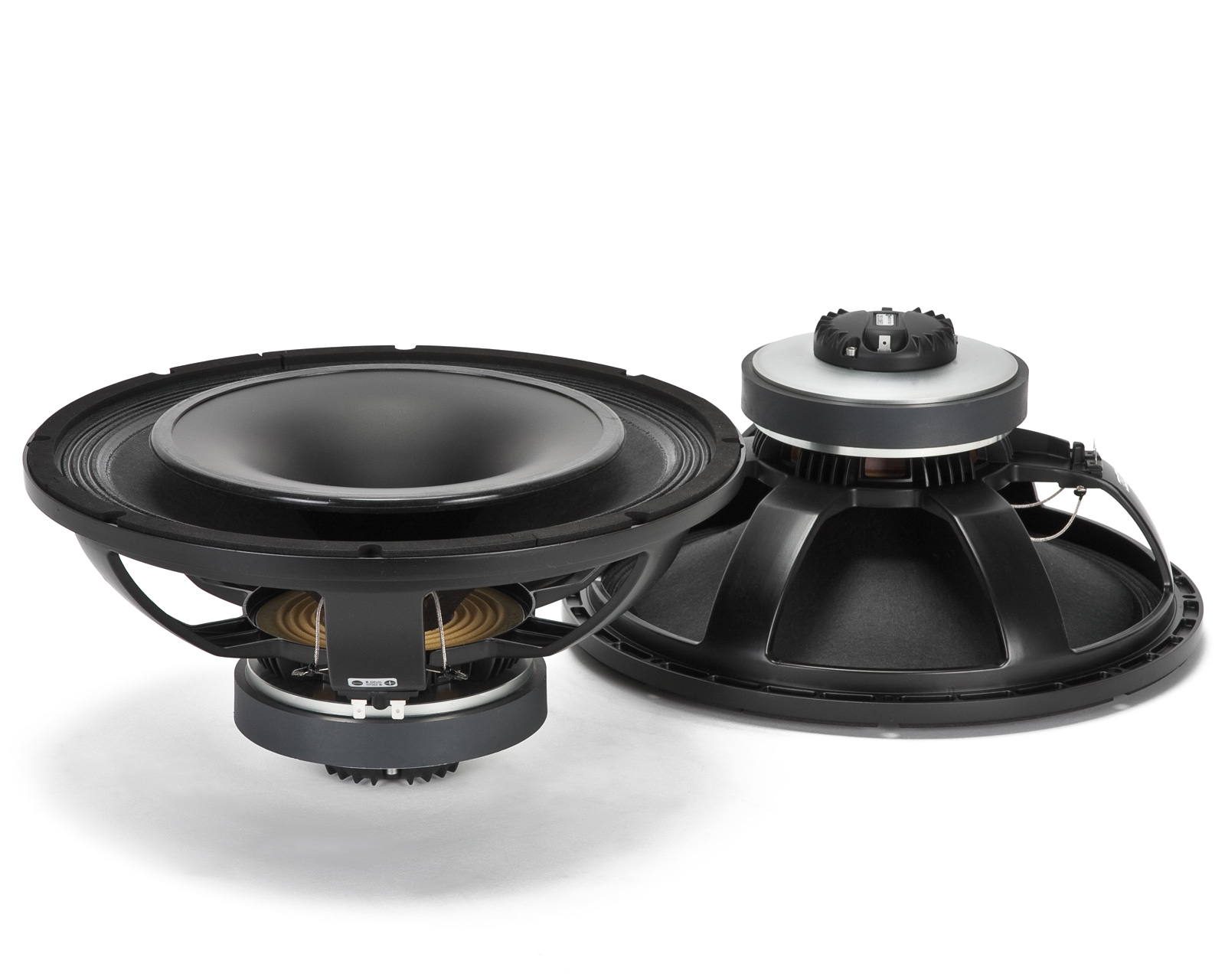

I know you don't like horns as you stated, but best in the LF department is RCF - CX15G251, followed by drivers Beyma and BMS (Beyma 15CXA400Nd/BMS 15CN682CXNd), for this 3 drivers and enclosure size (BR).
I'm not counting with GPA here I'm sure is one of the best. It's a decision between having a sub or not. Usually they don't go very low.
RCF - CX15G251
Beyma 15CXA400Nd (8+16Ohm)
BMS15CN682L BMS 15 CN 682 - 15" Coaxial Neodymium Speaker 500 W + 80 W 8 Ohm

Actually the Oberton 15CX is starting to look more and more attractive. Of course, simulation isn't data, but at WinISD gives an F3 of ~45Hz for the Oberton in a 100L enclosure tuned at 40Hz. That might be enough when placed in a room, since my design criterion for the bass was to reach the low E of a bass guitar, around 35Hz IIRC. This might just do it.

Excellent price when considering the 1.4" exit driver.. BUT,
The high freq. linearity is pretty cr@ppy. 😱
That's something you kind of expect with coaxes. Some of them are better, some worse. And usually just tilting them 5-10 degrees off axis takes care of that raggedy response. Varies, though.

Admittedly, that HF response doesn't look too flattering. But maybe I'll measure myself before condemning it as utter manure. We'll see. Might still be, that I'll decide to get the Beymas, but at least the low end response of those Obertons look more promising. And I don't trust datasheets...
