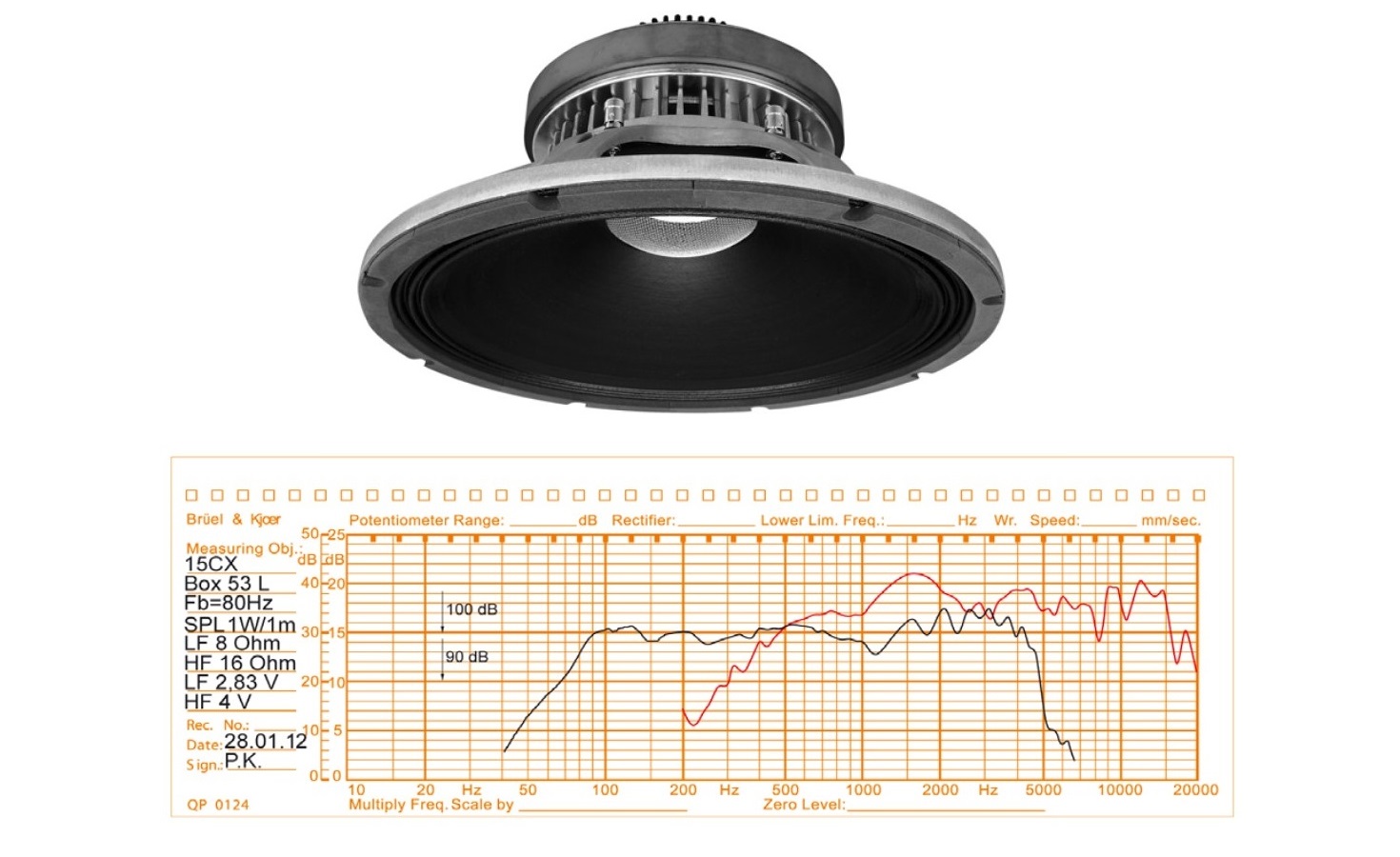

I´m giving below some different alignments for OBERTON 15CX (including the one in specs for tests), the first with accent on the response to ~30Hz (-6dB) and the second with a smaller cabinet, +/- the same rambling sound (LF) but smoother roll off.
1. VB = 150.0 L, FB = 33.0 Hz, ports 1x15.0 cmx21 cm (nxDxL), F3dB@39Hz/F6dB@31Hz/F12dB@25Hz.
2. VB = 105 L, FB = 33 Hz, ports 1x15.0 cmx35 cm (nxDxL), F3dB@48Hz/F6dB@36Hz/F12dB@26Hz.
What do you plan to do with BSC(?), because of that I would probably go with a different alignment with higher tunning, others can tell about BSC (I don't have that much experience). Also what amps you will be testing (W/power)? Check here:
3. VB = 110 L, FB = 39 Hz, ports 2x12 cmx29.3 cm (nxDxL), F3dB@42.5Hz/F6dB@36Hz/F12dB@28.5Hz.
For specs tests were made in a ""120 L box enclosure tuned 56 Hz using a 40-400 Hz band limited pink noise test signal...""
4. VB = 120.0 L, FB = 56.0 Hz, ports 3x15 cmx26.3 cm (nxDxL), F3dB@48Hz/F6dB@44Hz/F12dB@37Hz, w/ BSC@+4dB. (spec test sheet) 😀

Yeah, they are all pretty bad.. (might be why I never recommend them), but most aren't as bad as the Oberton. (..and the woofer, while not good with that substantial dip at 1.3 kHz, isn't really that bad, kind of a shame really.)
Maybe it's more of a question of whether you're ready to forgive the shortcomings of the concept to enjoy it's strengths.
And if you look closely, the Oberton treble doesn't look that much worse than the Beyma's. Pay attention to the scales of the graphs. And that dip over 1 kHz is something that probably can be worked around in crossover, partially at least. The treble seems to be willing to cross over around that point, so should be doable.
As to Inductor's question about BSC, I haven't thought about it yet. First have to see how it behaves in a real world situation. With some luck it could be baked in as a part of the woofer low pass. Remains to be seen.

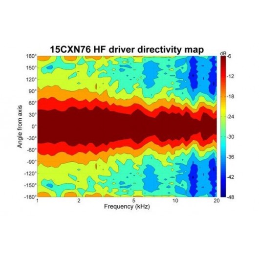

Excluding VAT this is a MUCH better driver/deal:
B&C Speakers 15CXN76 8/ohm | Reproduktory - Koaxiální reproduktory - Koaxiální 15" | PRODANCE
Mmmhhh... Don't know. Very low Qts, and the HF doesn't actually look much cleaner than that of the Oberton unit's.
If only I had the dough to try several units, but sadly that's not possible. At least from other peoples experience I can rule out a couple of them, but seems that either no-one in the whole depths of the internets has found out the holy grail of 15-inch coaxes, or they're just keeping the info to themselves.
B&C 15CX40 could work, based on my sims, but someone somewhere claimed it shouty. Is it? Dunno. Plus so much can be fixed with the right crossover, though I prefer drivers that can make do with the bare minimum of components.
Are you sure you are looking correctly at the scale for each driver?
http://www.lautsprechershop.de/pdf/oberton/oberton_15cx.pdf
The Oberton is all over the place on a 10+ db scale.
The B & C however is showing a pretty linear "downward" tilt due to the angle of the woofer cone. Correct for that and then "shelve" the response between 3.5 and 7.5 kHz + high-pass and impedance correction.
The woofer is also quite a bit more linear near a typical crossover freq. between 1 & 2 kHz.
B&C shows a typical result without the shelving filter I mentioned, here (first graph showing on-axis response 2nd page):
https://www.parts-express.com/pedocs/specs/294-578-parts-express-15cxn76-specifications-46964.pdf

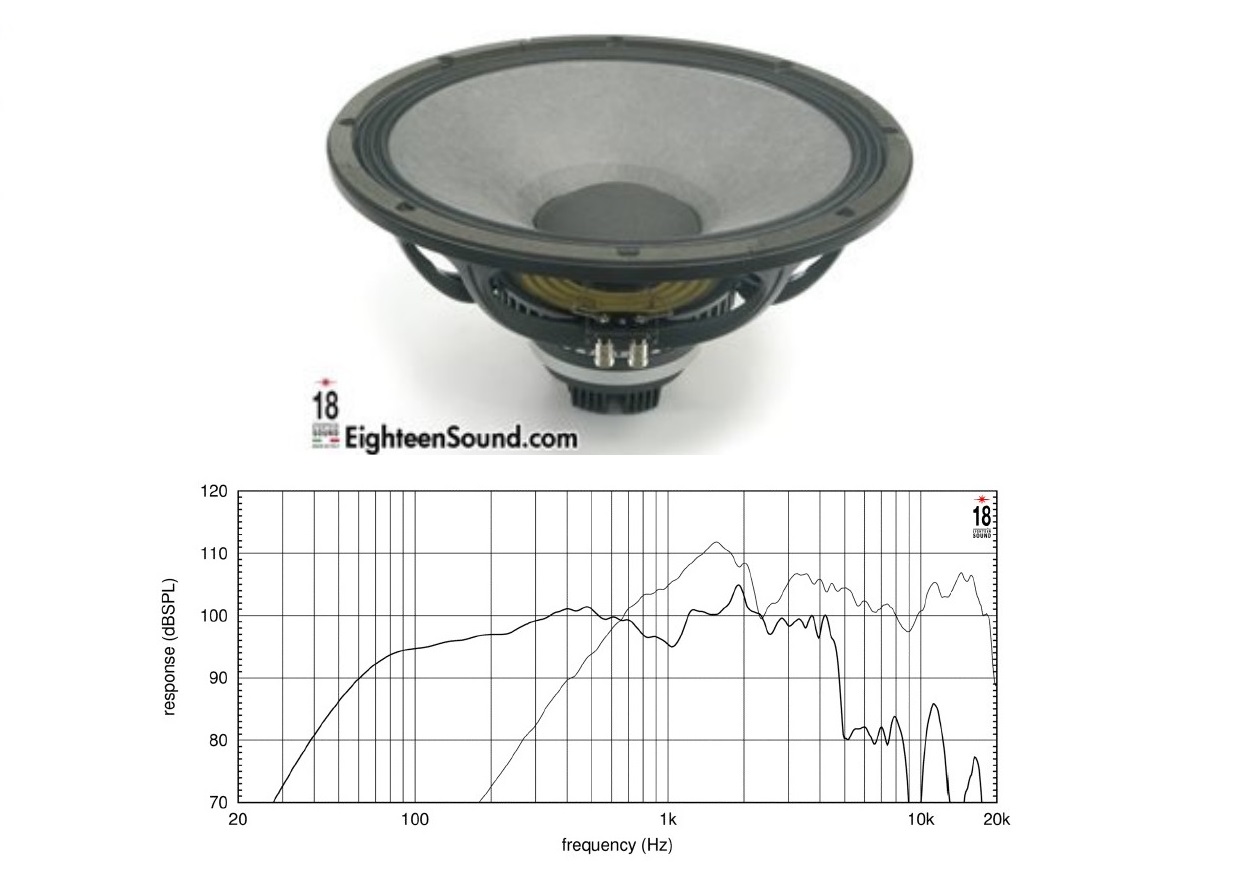

Obertonoberton 15CX vs. 18Sound 15NCX750
OP, check how the picture from the 18SCOAX doesn't have a horn?! (note)
15CX
0040 15NCX750 - Coaxials 15NCX750 : Eighteen Sound - professional loudspeakers
18Sound 15NCX750
18Sound 15NCX750H w/ horn 😀
In that respect those range outputs are very similar indeed. They look like a facsimile almost.The Oberton is all over the place on a 10+ db scale.
