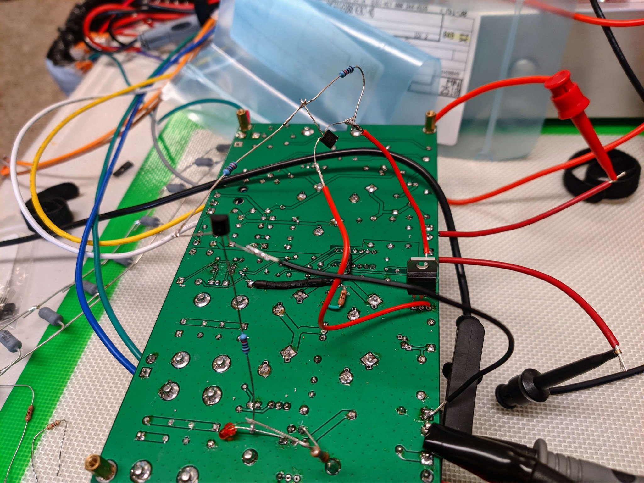

This board accepts multiple models of low voltage regulators, of these models there are two base variants. MIC29XX2 models where pin 1 is a simple enable pin, and MIC29XX3 models where pin 1 is an error flag used to sense error conditions on the output. We've been tweaking the schematic and board to incorporate usage of the error flag while maintaining functionality of the MIC29XX2 models. Selection of models will be controlled by a few different jumpers.
In the image below is some testing where I've hacked some transistors in as a high side switch after the 7805 regulator for the high voltage delay circuit. When using an MIC29XX3 model, if the MIC enters an error condition (we have been testing by overcurrenting the chip), the red LED will turn on, and cut 5V output to the high voltage delay circuit, which will turn off high voltage output. Only a few inexpensive components to add extra protection is worth it in my mind.

The extra protection when using an MIC29XX3 model regulator mentioned in post #81 did not have consistent behavior, and the only way we could figure incorporating it would be to have it's own dedicated power supply, and given the scope of the project that seems a bit much, so we've canned that extra protection and reverted back to the original idea of just a jumper to select which model low voltage regulator.

I've just updated the main post with the finalized v1.2 based on the LM317 regulators, the BOM, and gerbers with and without via's have been attached.
