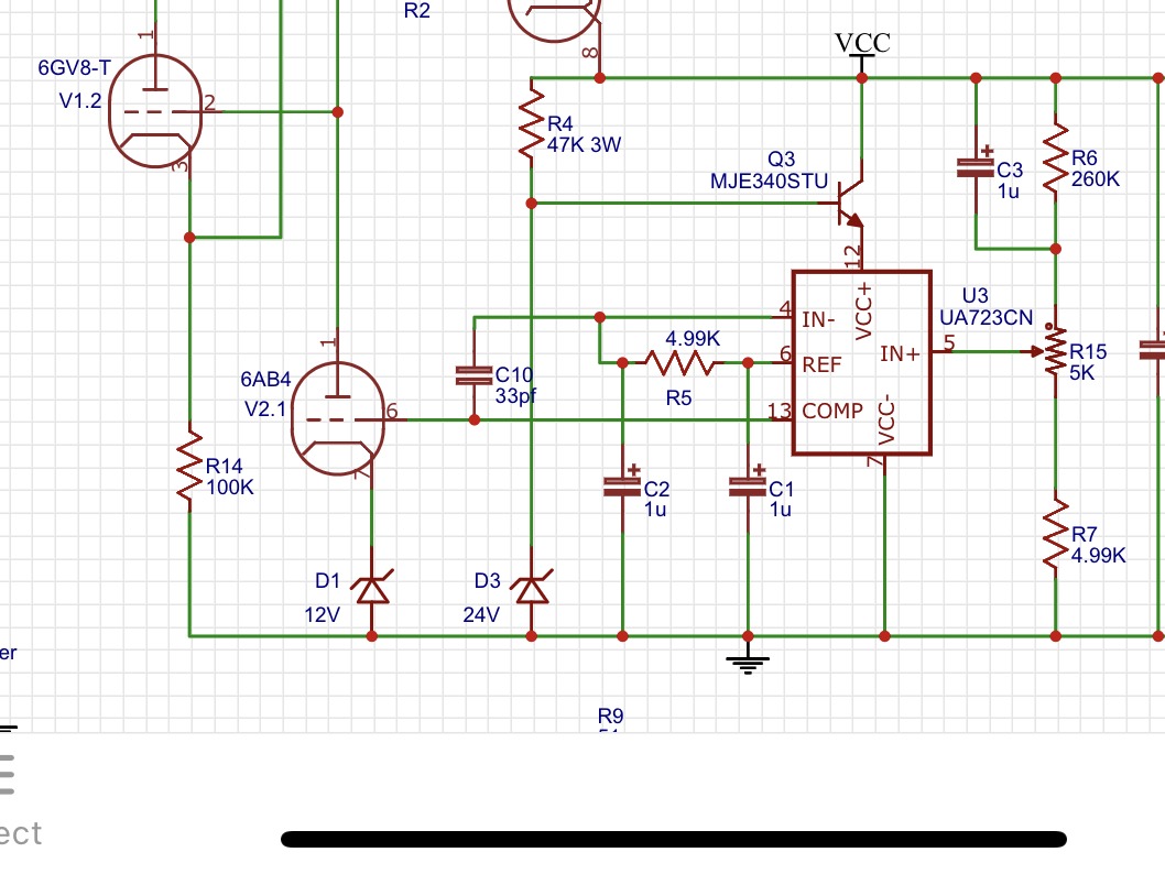

I would simply float a UA723, add a zener follower to power the chip, and You will have a cleaner B+ and better regulation for about the same price. expect at least 2uV noise level.
I really like the sound of that excessively low noise level. But here the novice in me screams. Do you have any example schematics I can look at to get some ideas and understanding? I'm a learn by example type.
This is'nt a floating design but here is one Ive worked up in both Spice and breadboarded, it works great under no load and 10mA load. it may need some refinement, but not much I would think.I really like the sound of that excessively low noise level. But here the novice in me screams. Do you have any example schematics I can look at to get some ideas and understanding? I'm a learn by example type.
I can give you a better schematic as well. Let Me know. ThanksThis is'nt a floating design but here is one Ive worked up in both Spice and breadboarded, it works great under no load and 10mA load. it may need some refinement, but not much I would think.
