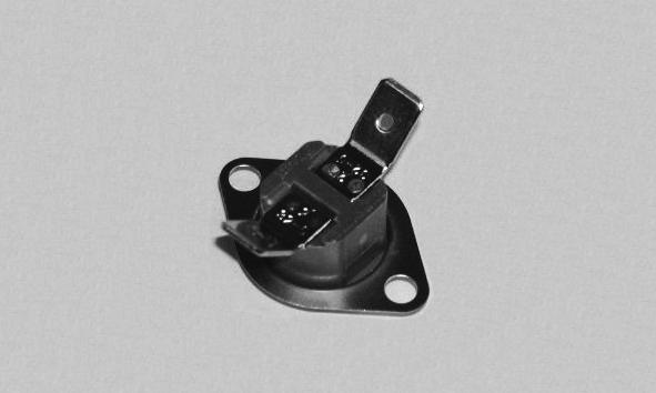

If you substitute your 100 Ohm 5 Watt resistor through a TO220/247 version from Caddock (together with a heatsink and a overheat switch), then I get more familiar with this topology
An additional step to enhance the reliability could be the mechanical relais contacts through a solid state switch solution. But therefore I need triacs or alternistors appropriate to switch on/off large toroidal transformers. Who knows types that match this requirement?
