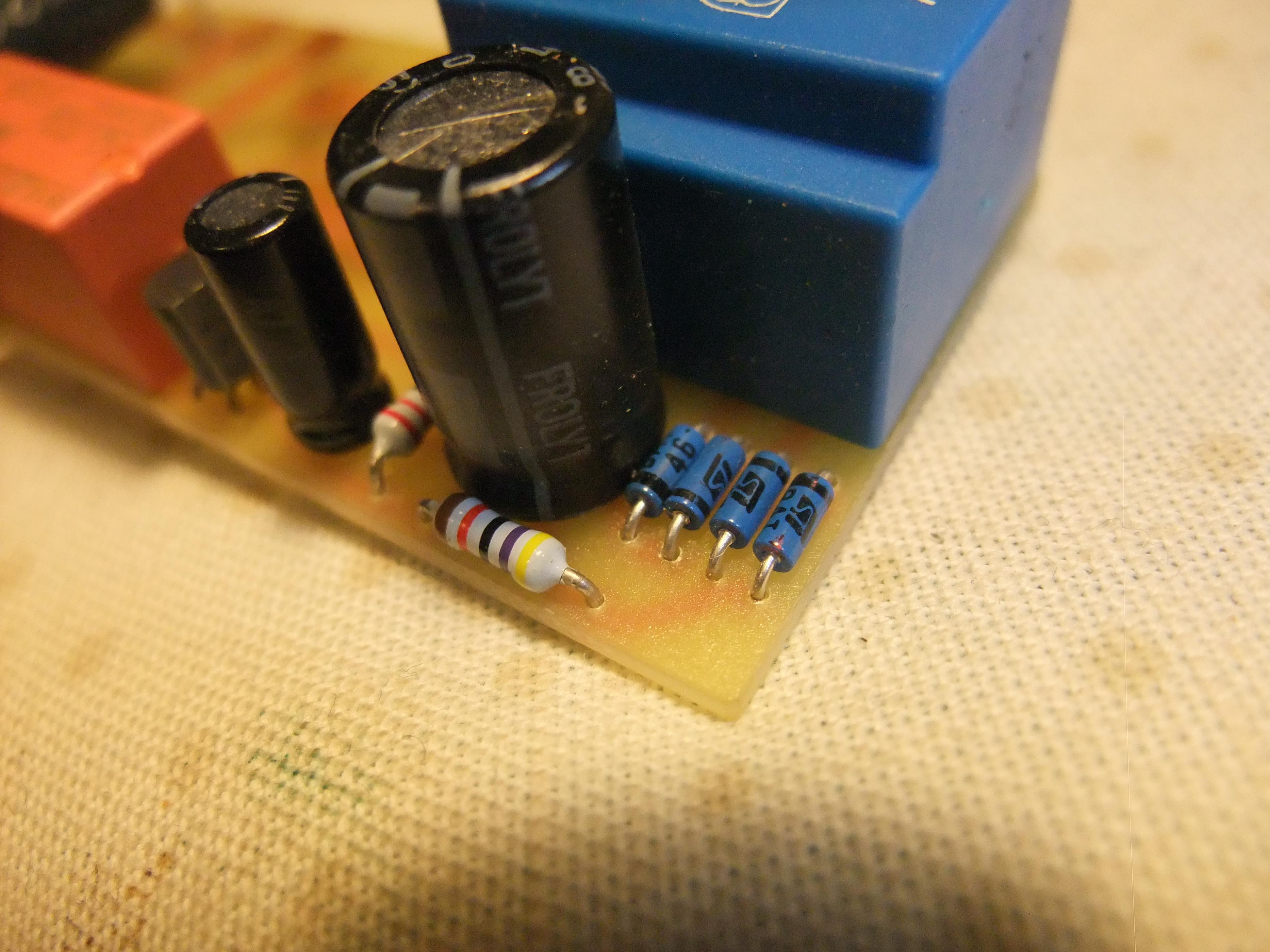

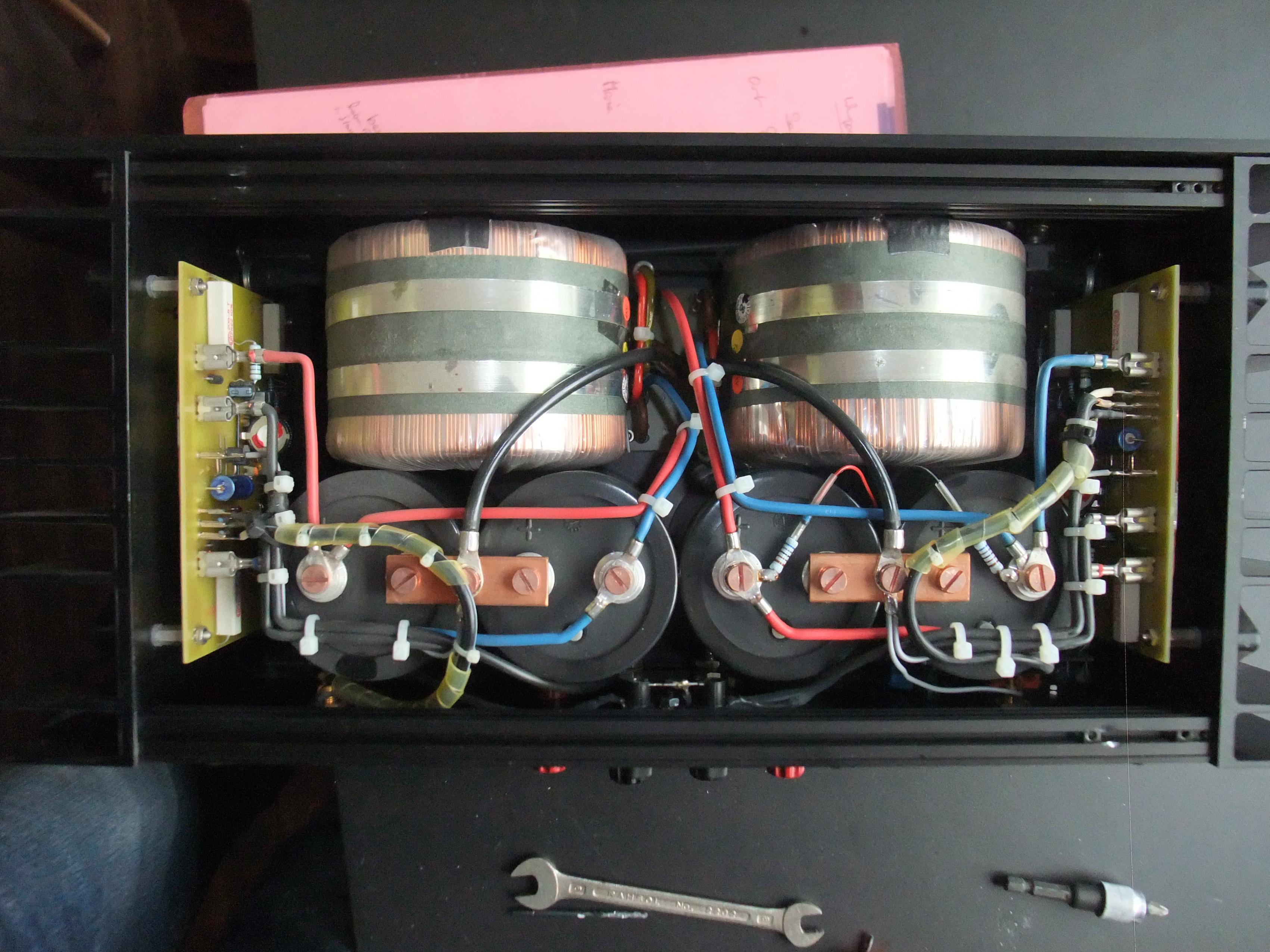

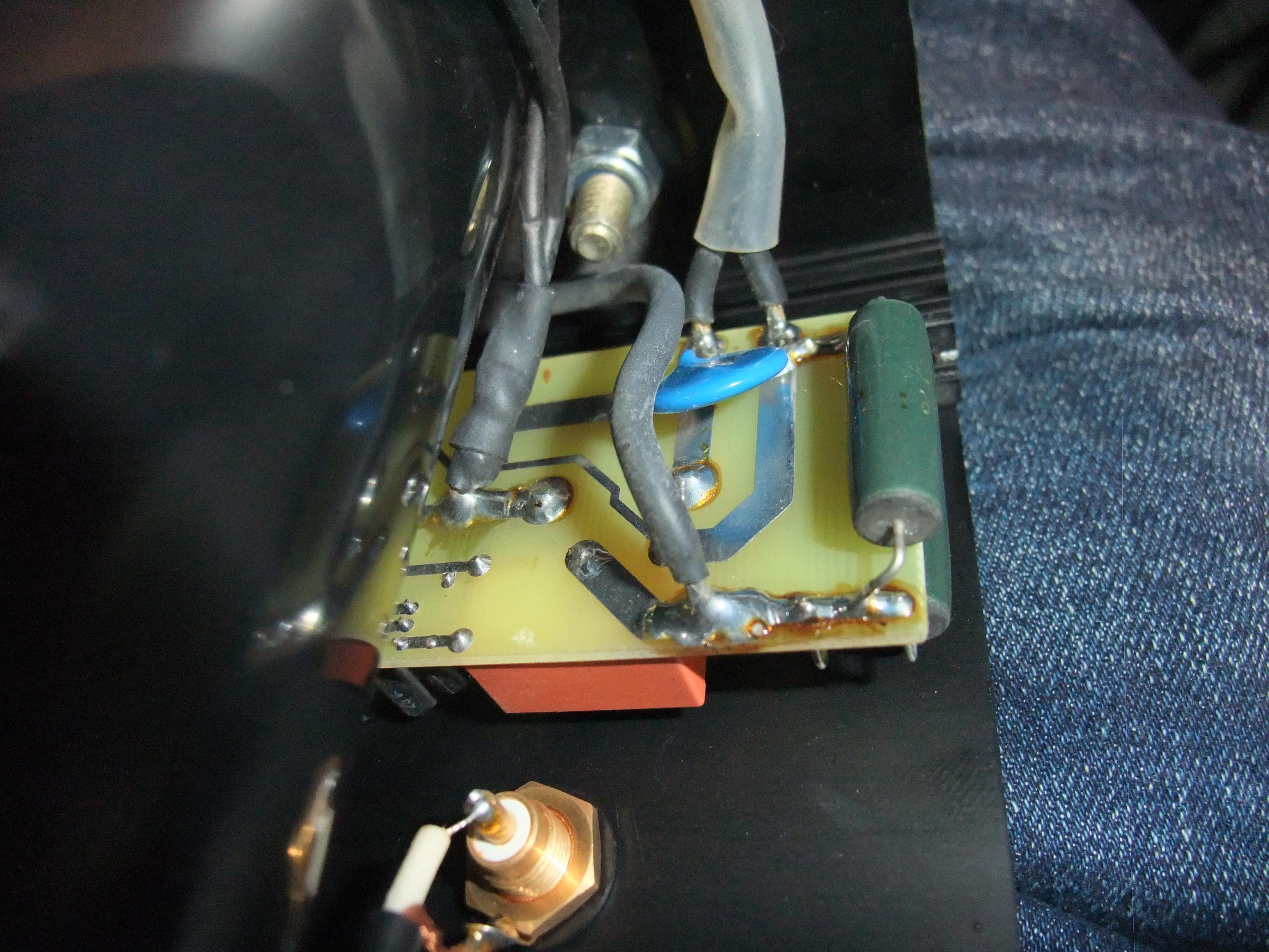

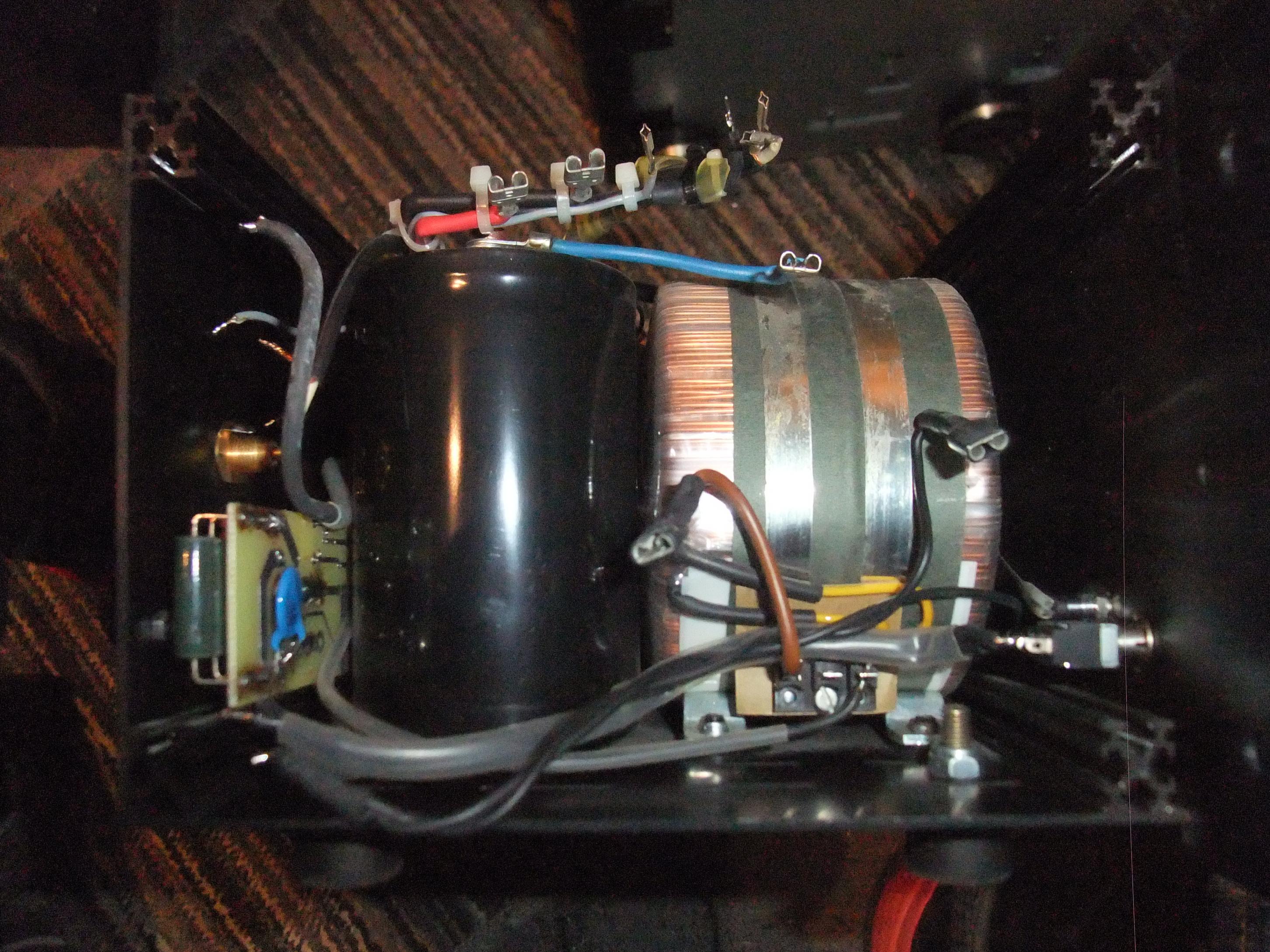

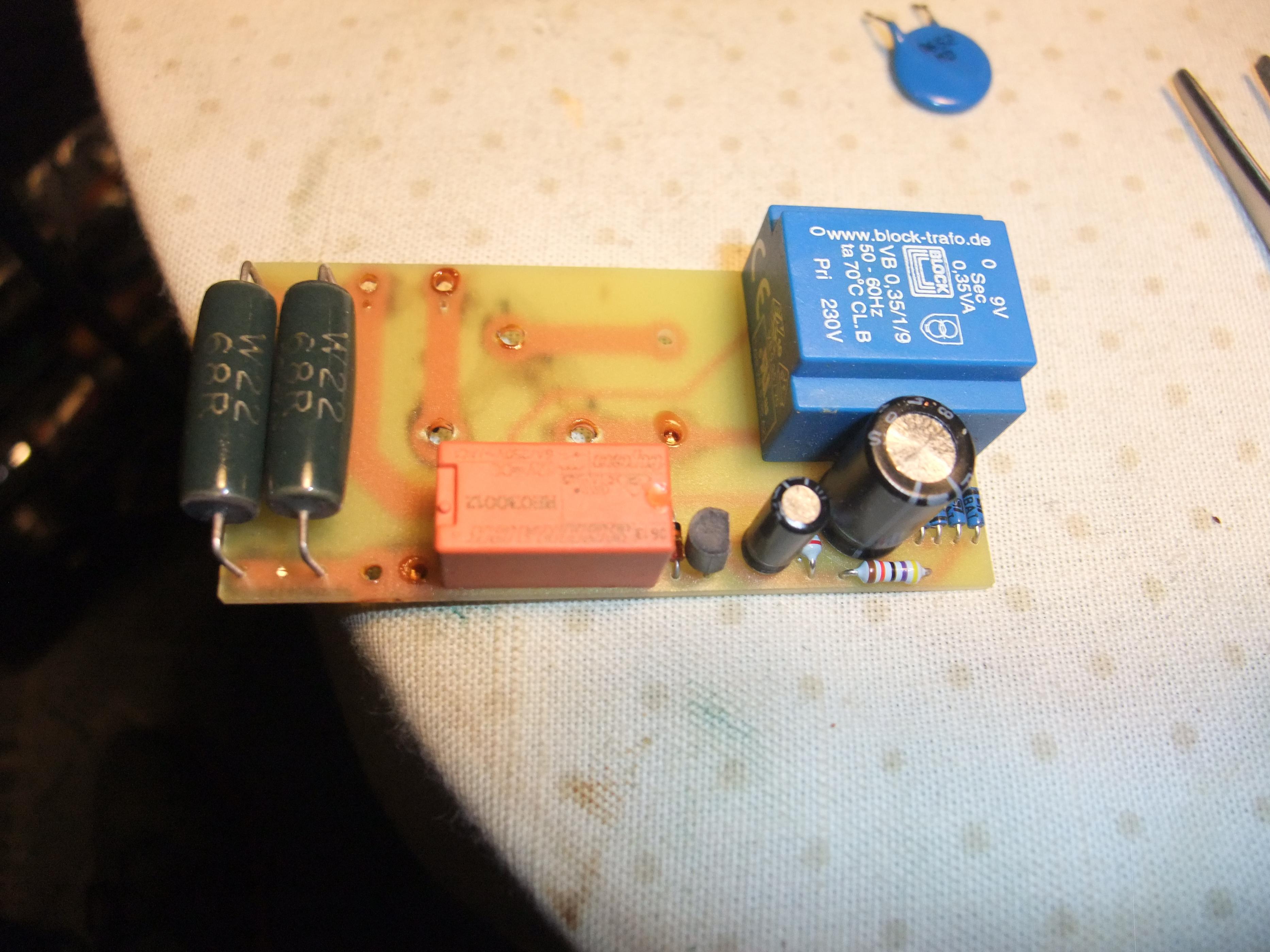

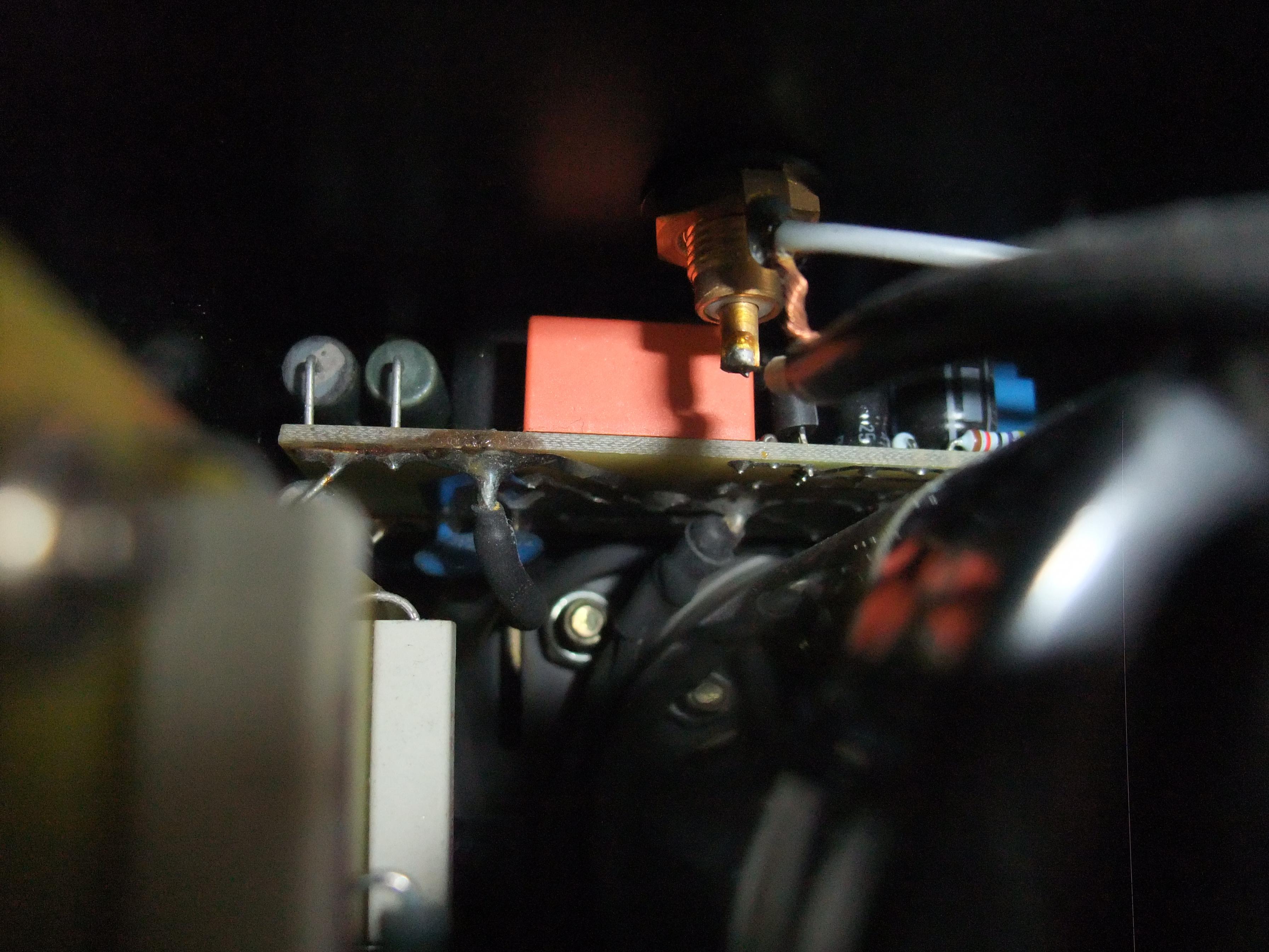

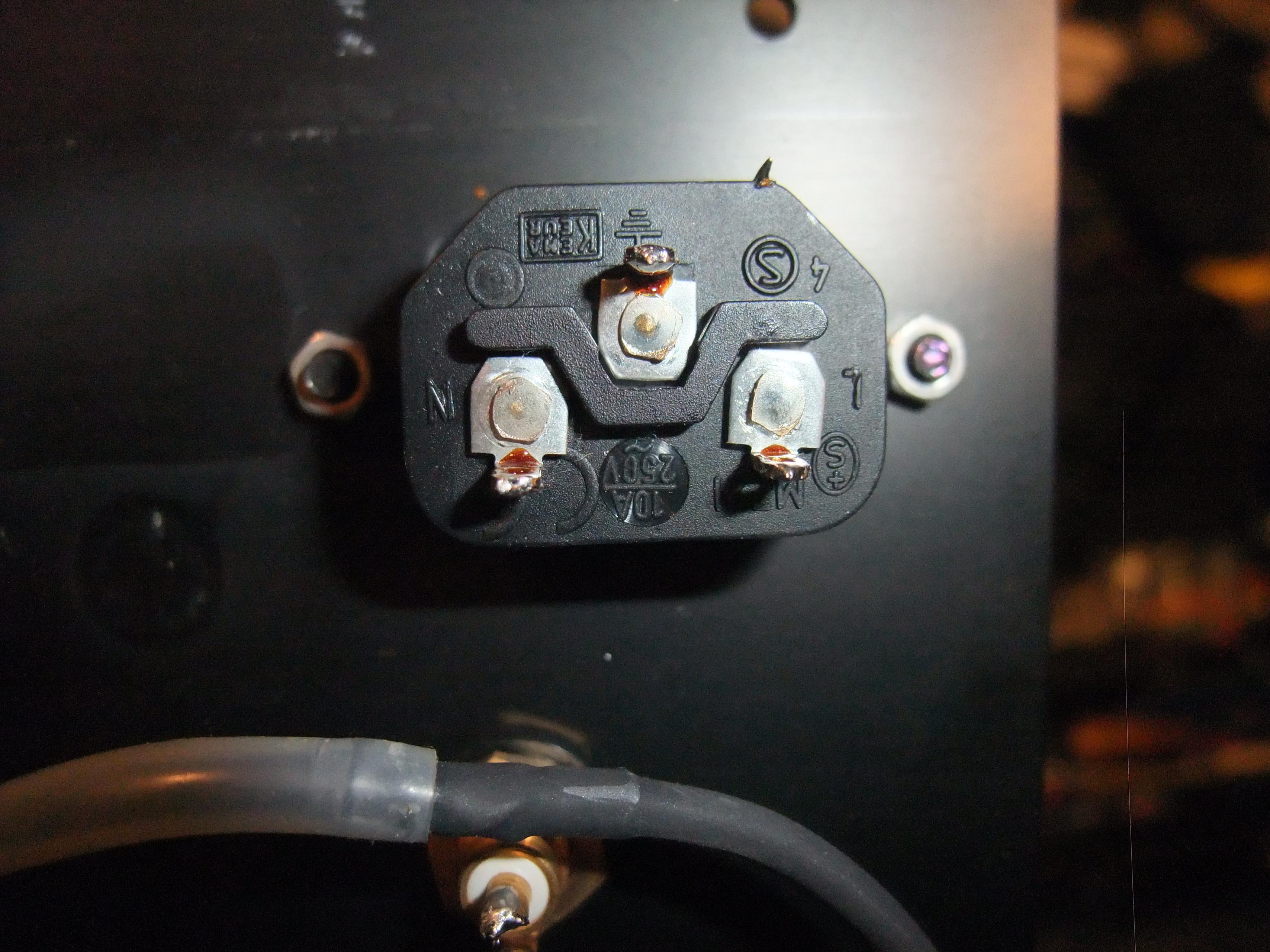

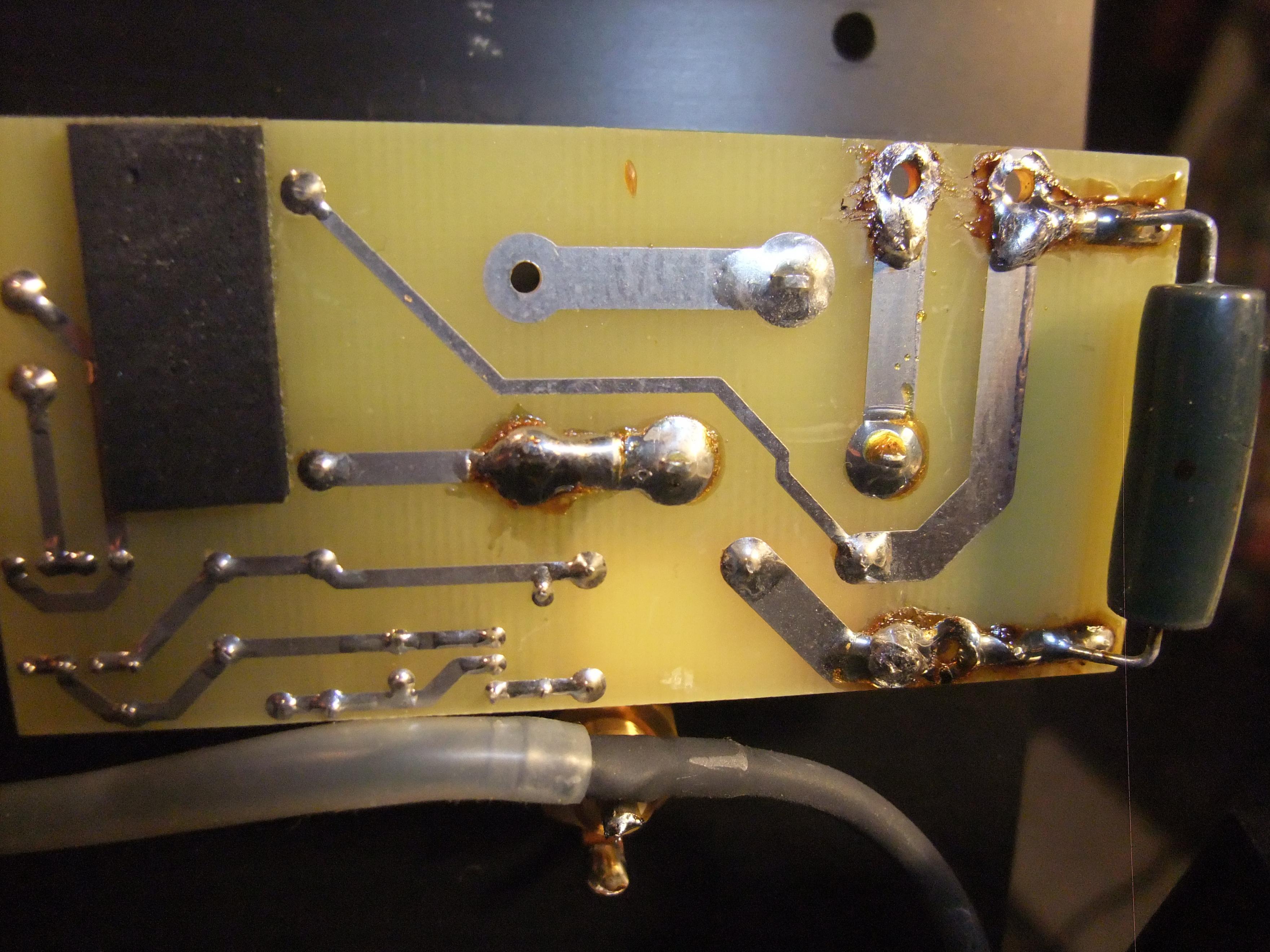

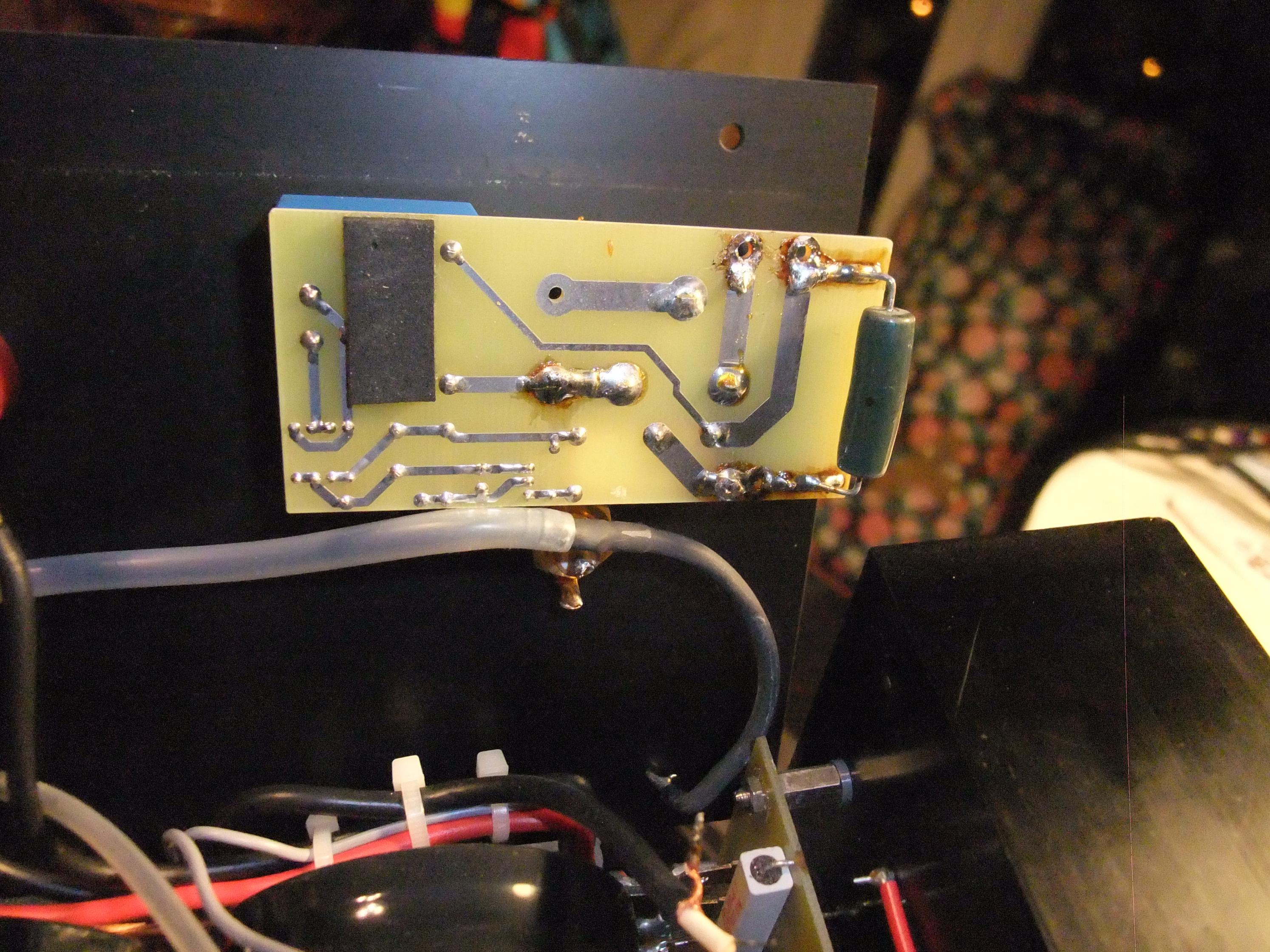

Now I have a power amp from Germans brand Horch model 3.0s on the desk with several age-related deficiencies, among other things with 3 interrupted high-load resistors connected in parallel mode on the sub board for inrush current limiter.
I want to replace the 3 pcs resistors 68R/5W by 2 pcs Caddock 50R/30W as mentioned in post #9, go to
Security Check
http://www.caddock.com/Online_catalog/Mrktg_Lit/MP9000_Series.pdf
additional I want to know for replace the relais the best contact material for this application - go to
https://www.te.com/usa-en/products/...section/relay-contact-life.html?tab=pgp-story
Thank you very much for an advice.

typical mistake when making inrush limiter - connecting resistors in parallel
with time, even just slightly lower one in resistance is going to be stressed more and more than other ones
they need to be connected in series
use 3 NTC's , CL60 range, in series and use relay which can endure amp power consumption, simple as that

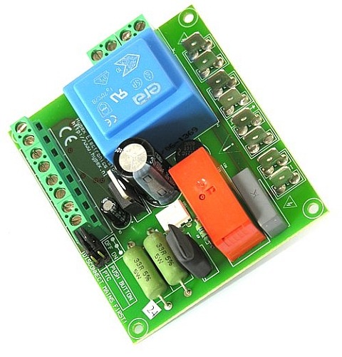

If doubting the reliability of a relay, why not installing an off-(on)-on switch, the first -on opening the circuit through the inrush limiter, and then locking into the second -on switch which would short the inrush-limiter-circuit?
This is actually an old design, replaced 10 year ago with SST03.
Sjostrom Audio - SST03 Softstart for toroidal transformers

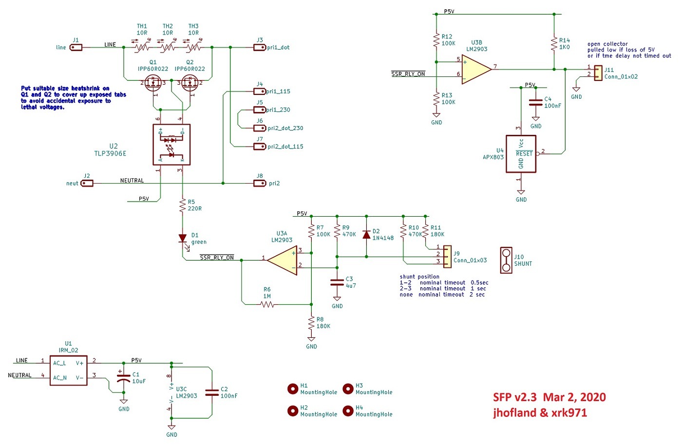

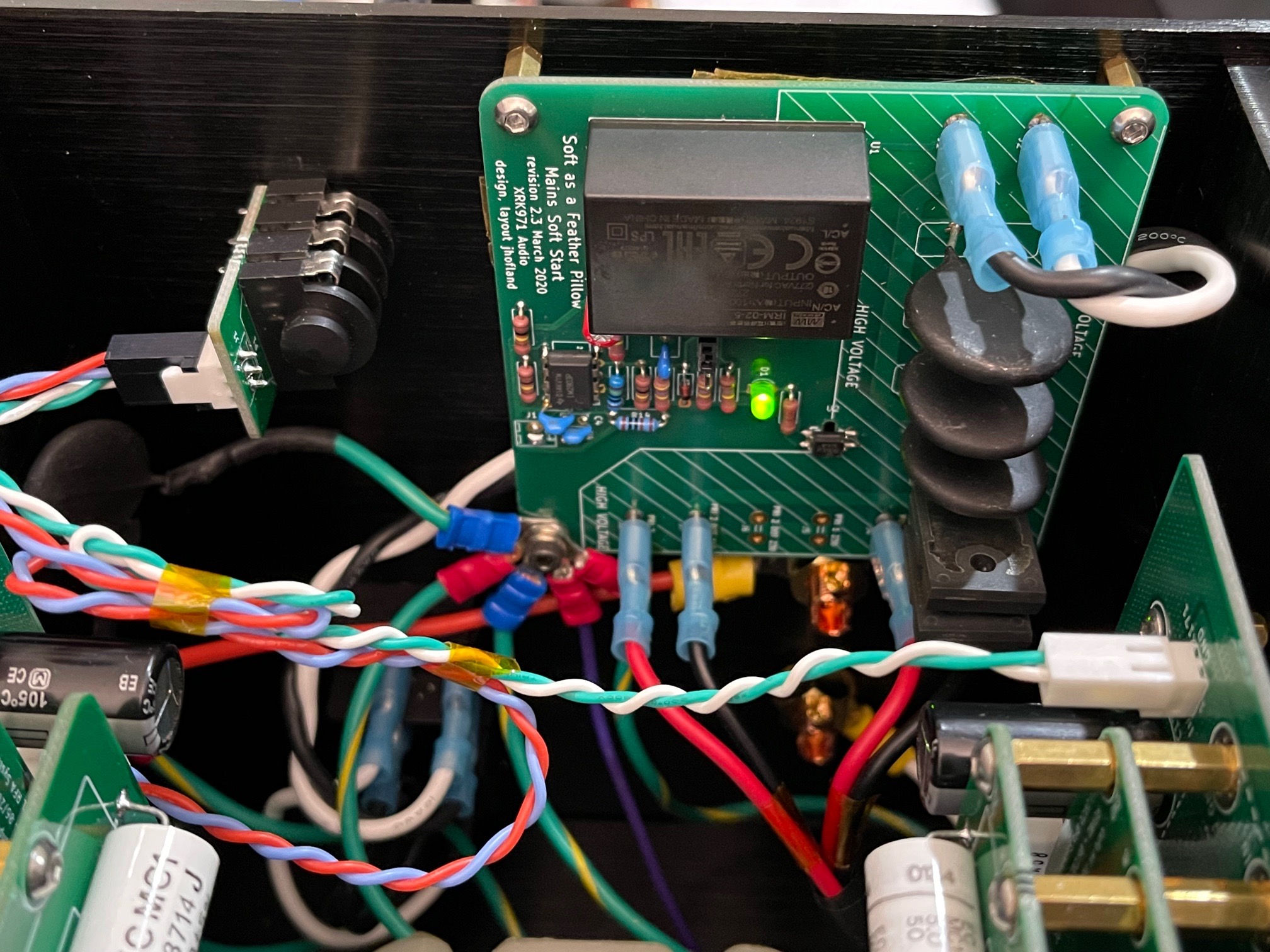

This was designed by Jhofland and I have been using this for a couple years now.
This is mine as used in SuSyLu amp:
I use a SSR so that it never wears out.

I tried using 4 power resistors (4x 5W units) and the problem is a safety one. In the event that the relay fails to bypass the resistors after a few seconds, under a Class A load, the resistors will overheat and melt and burn the board. This happened to me and I had to switch to NTCs, which, although have a memory effect until they cool down, at least do not pose a fire hazard.
The legs of the resistor got so hot it melted to solder and the resistor fell off the board after burning it where it touched. It was a good thing I was there to catch it and shut it off manually as it happened during testing.
I promptly replaced the resistors with a couple of NTCs in series on a new PCB.
Assume your Class A amp draws 3A current and you have circa 30ohm resistors, power is (3A)^2 x 30ohm = 270W. You would need a resistor capable of dissipating 300w continuously. That’s a very impractical, large and expensive resistor.

Hi Chinoy,
Here is the circuit I used, it was designed by Jhofland.
I suspect you may say it is too complex for such a simple job. But the job of having a relay that has essentially no on resistance and never wears out from arcing and has a reliable 2 second delay can’t be done for much less. The big bonus is that the NTCs don’t get hot for more than a second. So they can return to their high resistance state sooner and the whole thing is cool running.
But if simplicity is what you want - an always on and connected in m-series NTC like CL-60 or 8D-20 capable of handling the full current can work as a soft start - like so often used in many of the PSU’s shown on this forum (and I myself use this much of the time for development).
It has a small AC/DC that provides the always on logic controller voltage and power to effect the SSR. You have your choice of selectable delays 0.5, 1, and 2 seconds to allow the inrush to settle. Many people have used this with good success. The TLP3906 gate driver is sometimes hard to get and an easy SMT part to solder with exposed legs. U4 is optional and only needed if you want the soft start to trigger an external logic circuit or LED indicator with open collector.
