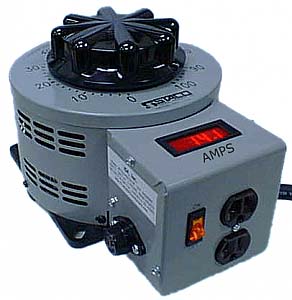

You can find some very reasonable commercial carbon rheostats that will perform the same function. You just turn your amp on manually and the toroid charges at a steady pace. Just like a variac. Mount to the faceplate and you never know it is there.
When you consider the alternative is a pcb, soldering, parts selection, auxiliary voltage source for relay and space to mount in the chassis it looks better. You also do not have that extremely hot thermistor in the system.
I have used this setup for my amps when testing and it works really good. I have not fried any bridge rectifiers since. In the past it was always the rectifiers that failed when trying to charge the huge power supplies DIY projects use. When you can continue to hear music from the speakers when the power is off for over one minute that is a major source of energy stored in the caps. And you want to charge it in one phase cycle!!!

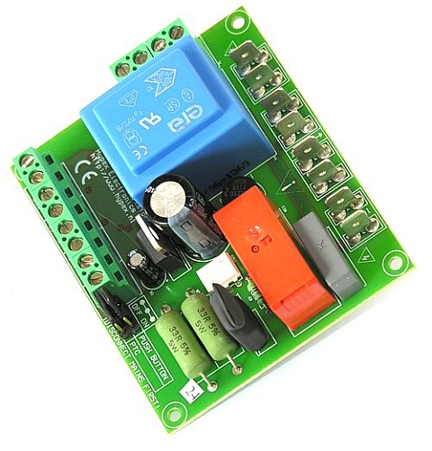

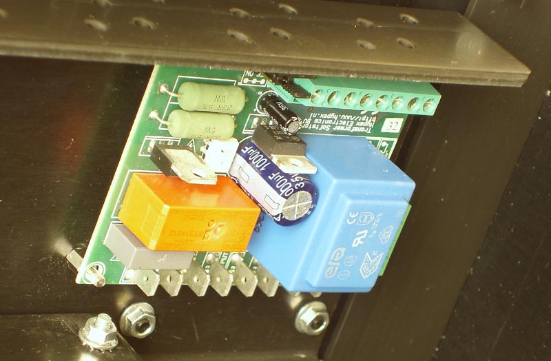

and two additional URLs with applications for Hypex softstart
Module Hypex Softstart pour amplificateurs
http://nodecorporation.co.uk/hyp0020.htm
