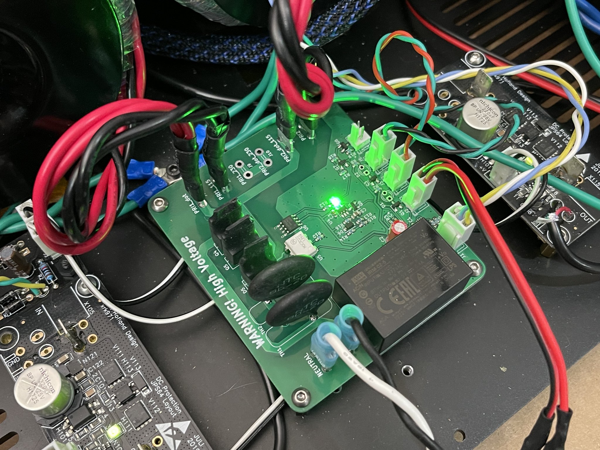

I realy like the Hypex softstart. Modified with NTC's instead of resistors. It has all you need (standby LED, On LED, pushbutten or latched button, thermal switch if needed). And it can handle 1500VA and a hole lot of cap bank.

If you want low voltage drop and in rush limit on low quiescent current class AB amp, a solid state relay that bypasses the NTC is best bet. They are not that complicated. Just buy a proven circuit or ready made solution.
I have one that was designed for me by Jhofland with remote turn on/off triac and two NTCs for soft start. A SSR that bypasses the NTC after about 3 seconds.
