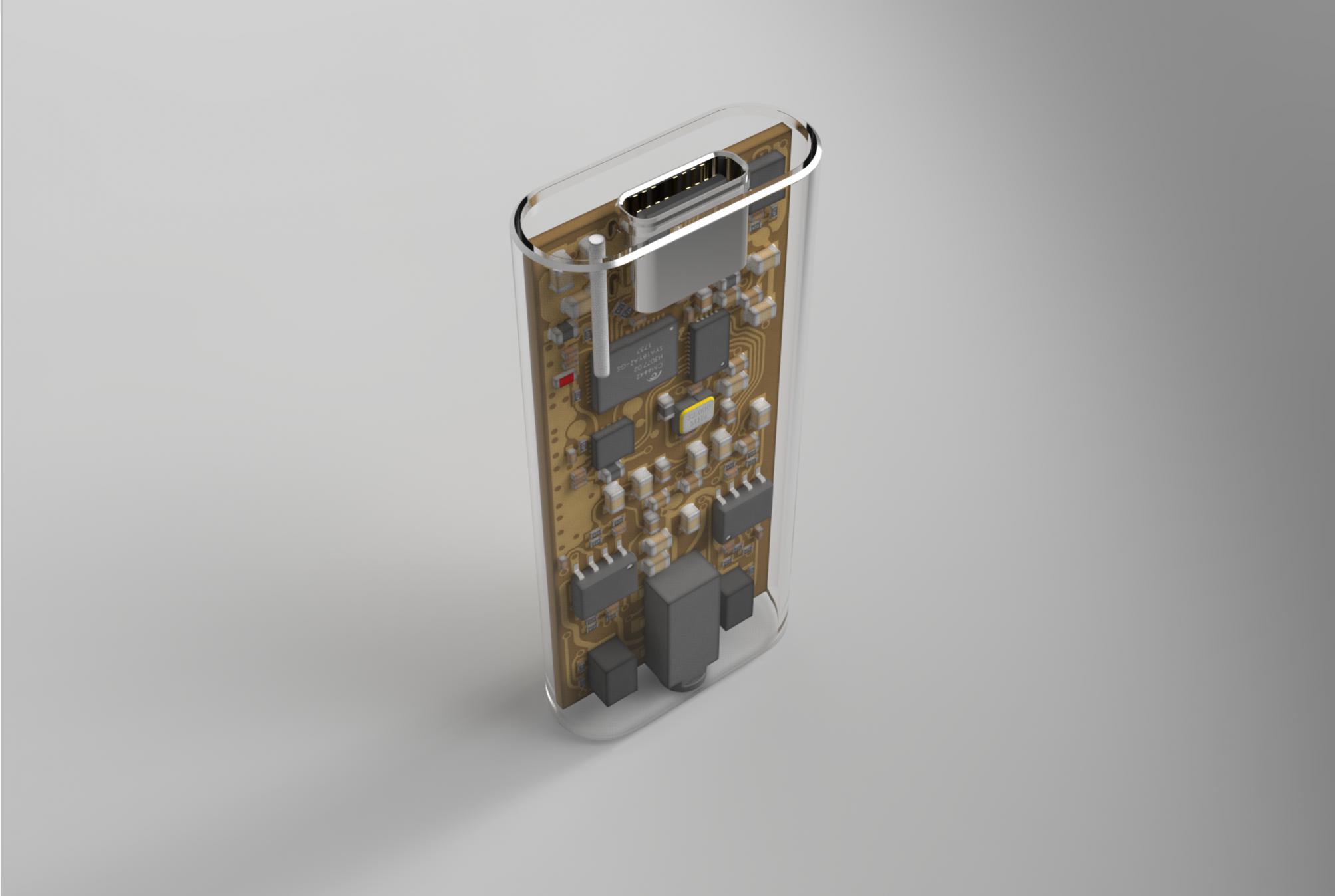

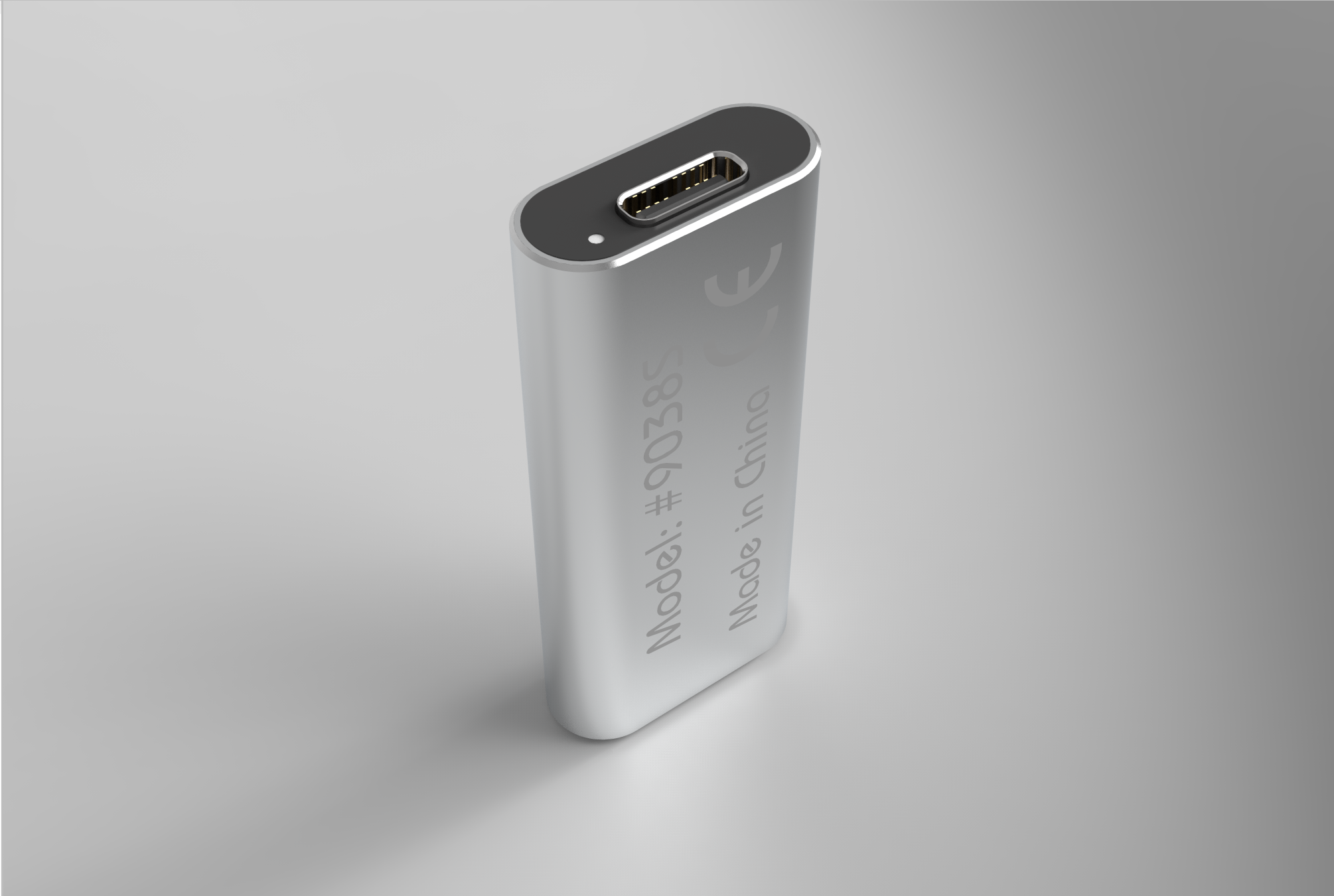

MrSlim, actually, PowerDAC isn't dongle DAC/AMP. I've checked your diyaudio.com activity, and I guess you interested in ES9038Q2M based model(I named that #9038S), right?
Well, currently #9038S housing isn't finished yet, I got 50m extruded aluminum profile, and gonna send that to CNC/sand_blast/white_anodize/gray_silk. Next, I'll arrange punch tooling for caps + black anodize, and I'll be ready to assemble few samples for youtube review. I hope all those steps will be done for 1 month, however, my timelines are always delayed because I'm just a single engineer, not a factory, not salesman, not a manager, and not a writer as you noticed.
Today I going to rent AP SYS2702(APx555 didn't found yet) to get more officially looking measurements of #9038S. To be honest, I bit afraid to run this model because it is not cheap enough to offer as E1DA no name. I could keep the retail price low if my PO would be 5-10KU but I don't think if it is a realistic prospect. BTW, I've some XL version of ES9038Q2M+HPA proto, so #9038X with XMOS USB bridge 32/384 and DSD 11MHz, with more optimal DAC's power quality etc. The PCBA could be fitted into the PowerDAC case(72x46x17mm) but in the USB dongle(48x21x9mm) no way, and too expensive for noname, IMO.

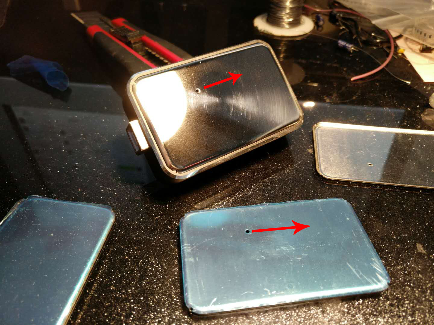

MrSlim, sure, I have few samples but still waiting for correct housing parts. Last week I got steel caps but with the wrongly positioned hole for the LED(BTW, nice one, exactly like tube's cathode 1100K see attached). I over 12 years here and quickly gotcha the top mainland-chinese secret - they almost never do anything in time and correct, whatever it is punch tooling or car driving. So, PowerDAC V2 sample for youtube reviewer is delayed and I look stupid together with my little friends from the punch factory. BTW, they agree that it is their mistake, and ready to redo tooling "for free" but.. they anyway asked to pay me extra, kinda my order is too complex ))

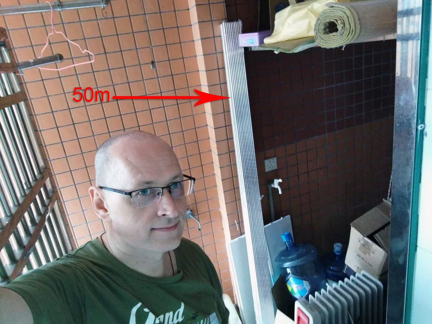

Just back from extrusion factory with 50m of #9038S profile. It looks damn compact and fit my balcony no problem, #9038S PCBA also very well fits into the aluminum case 😉

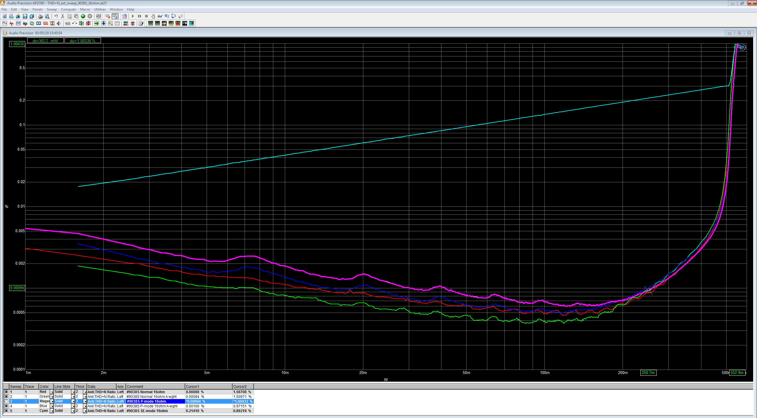

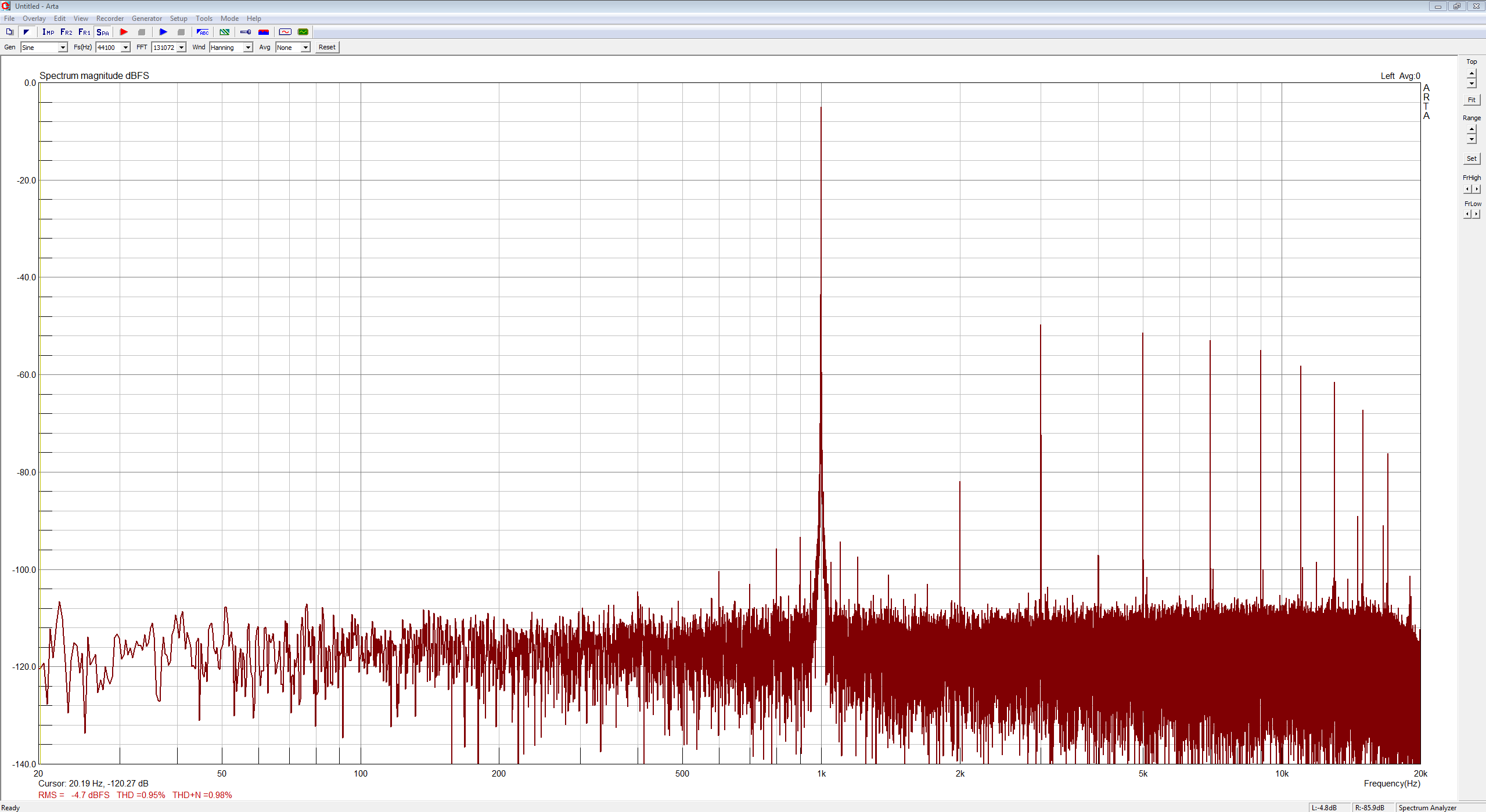

In post #73 the 3rd harmonic is only 75 dB down. Are you satisfied with this number?
And https://www.diyaudio.com/forums/att...92d1555763390-true-digital-3-32vrms_16ohm-png
show high numers... these are not commented really - why did you show these?
this is max rated power measurement which has to be at THD+N =1%, as you can see THD+M there .98%, 3.32VRMS at 16ohm(the picture name contains that info) i.e. 0.6889W per channel. Maybe 1W is better but to me even 300mW ok 😉In post #73 the 3rd harmonic is only 75 dB down. Are you satisfied with this number?
Aha - OK!

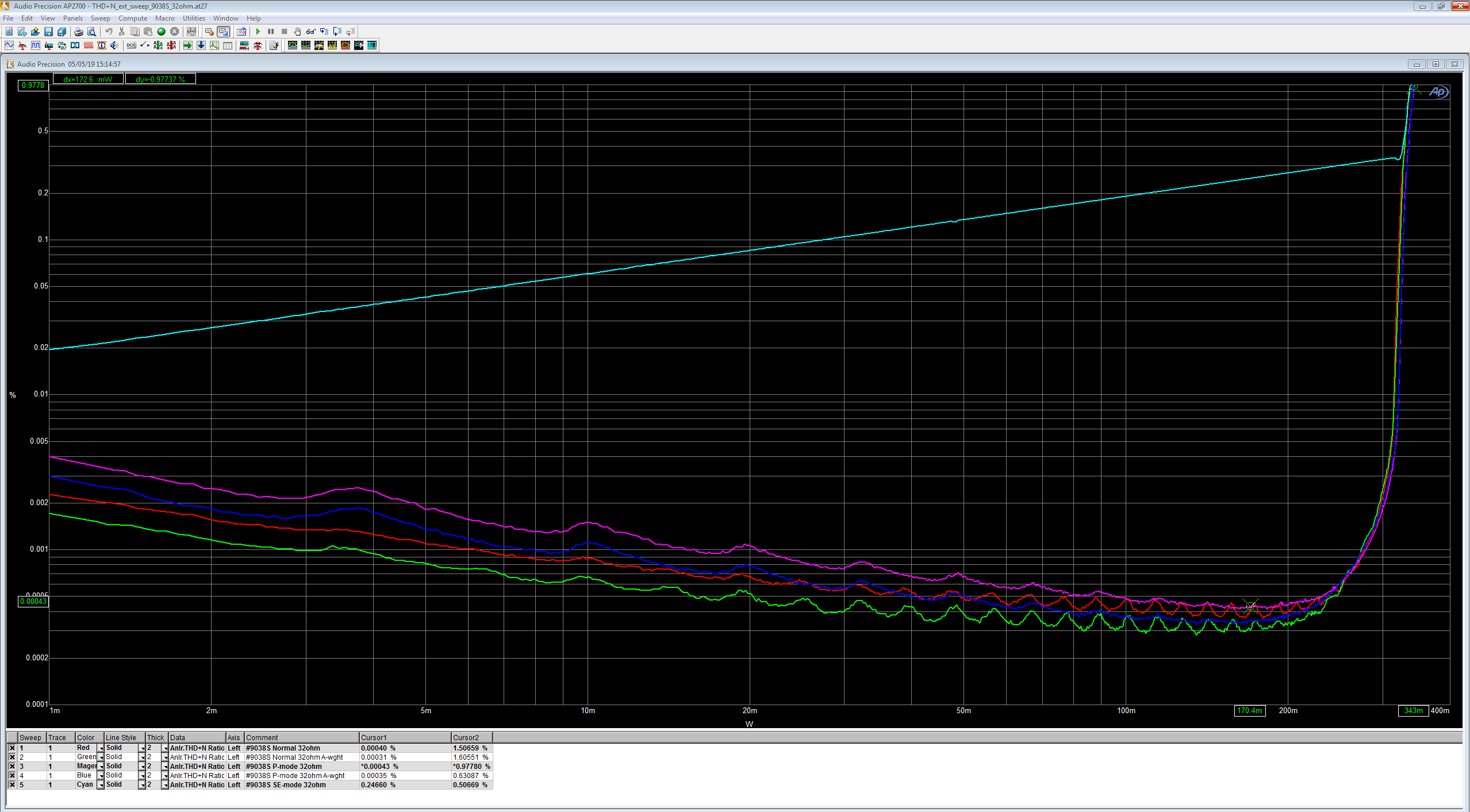

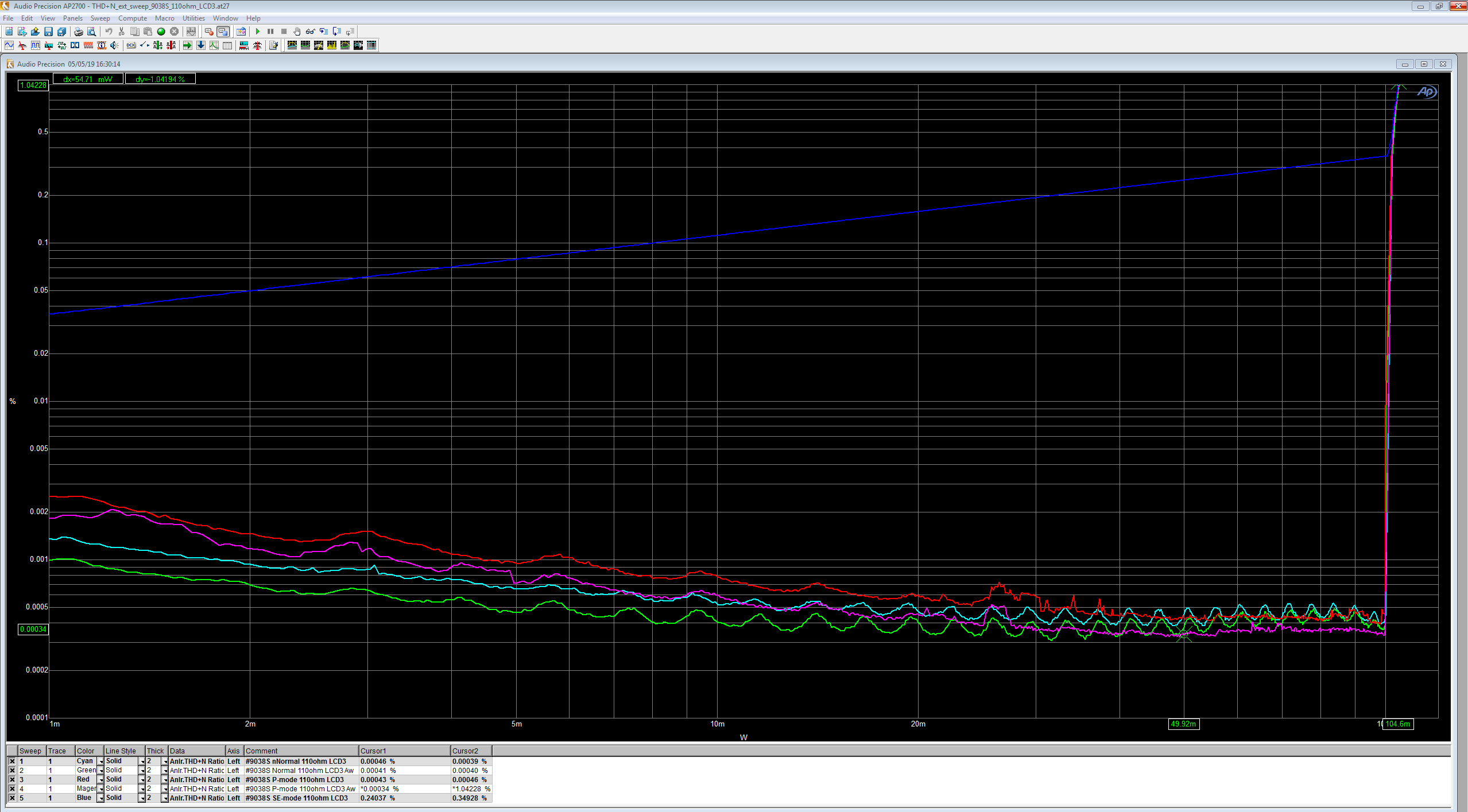

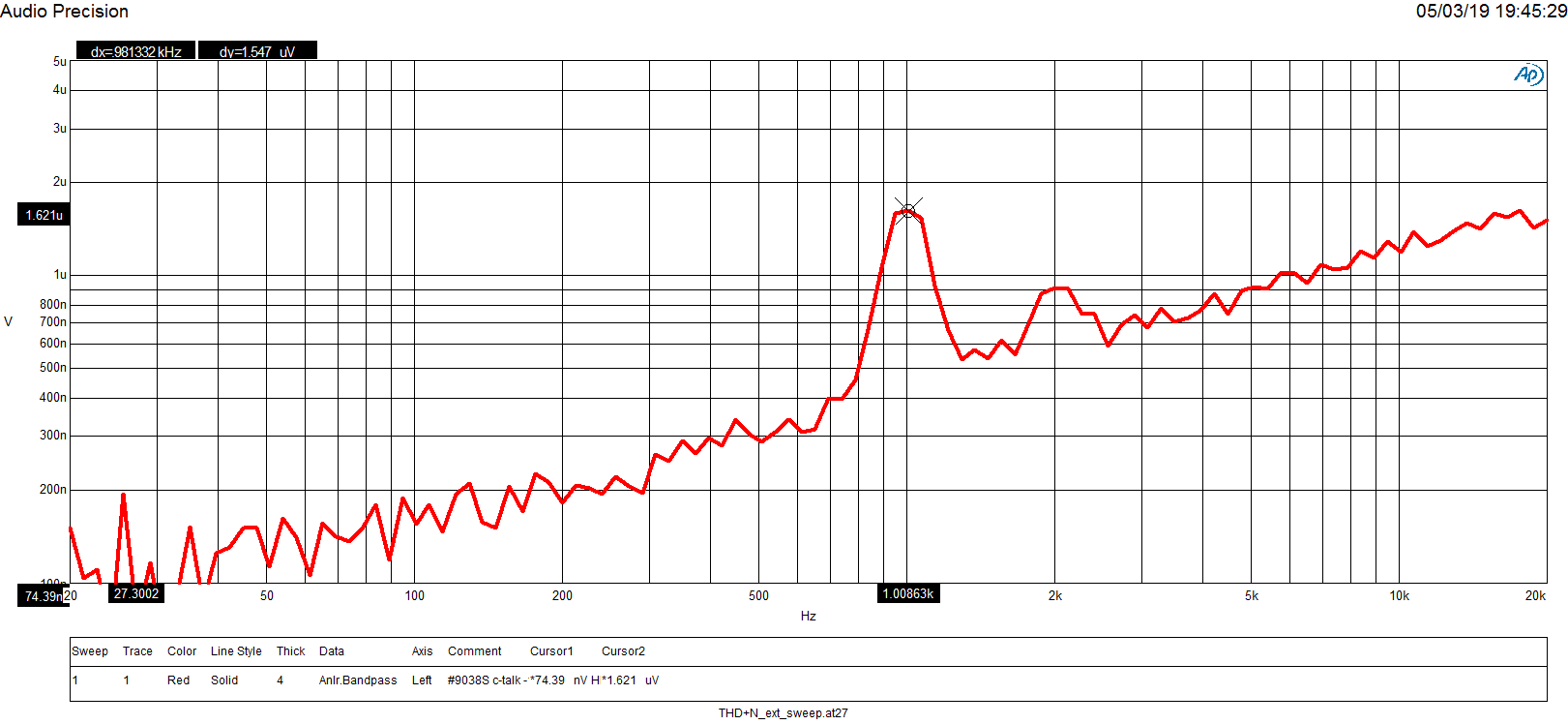

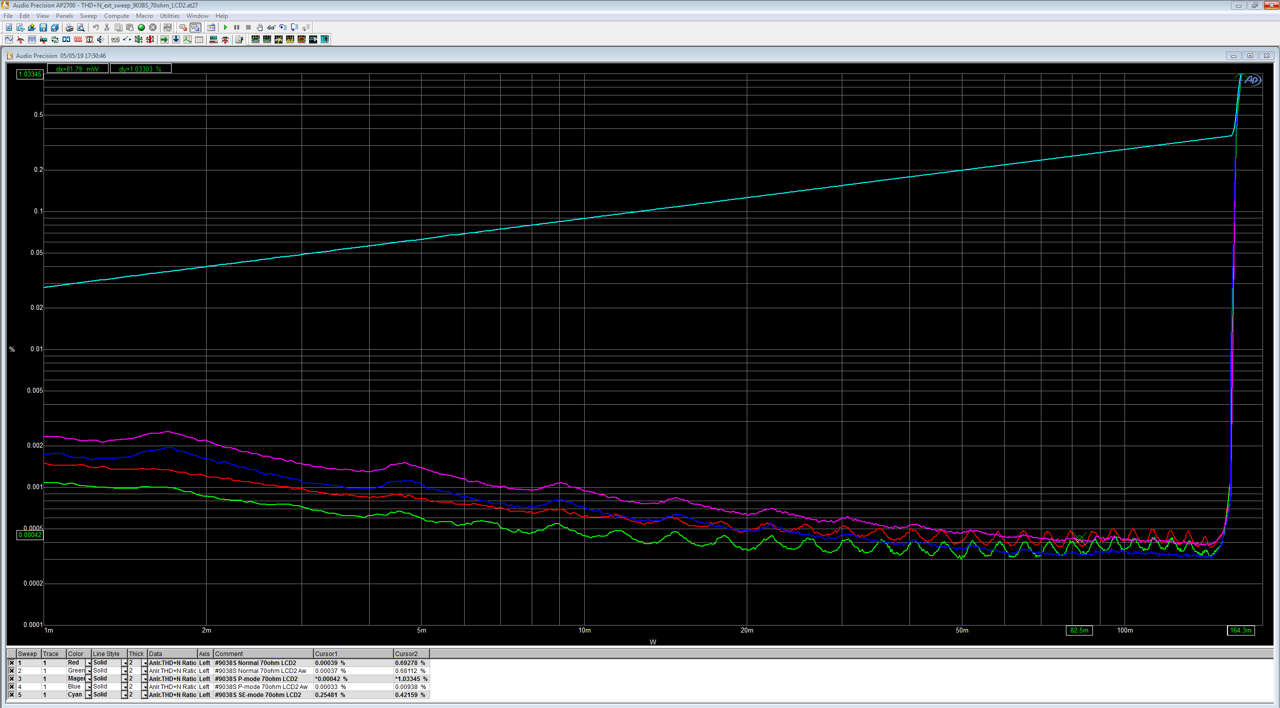

#9038S log: formal specs measurement with Audio Precision SYS2702 analyzer(residual THD+N about .00015-.00018% in 10-22000Hz BW) which surely has not enough resolution to measure #9038S distortions. I want to show here THD vs power plots for different resistors load(as I remember I already showed that plot for actual HFM HE400i load), and ask you guys, if anyone saw before comparable product on the market? I quite new in that area, and #9038S is the second my model for HP world, so I'm not 100.00% sure about the specs is unique, rather 99% 😀
1) 110ohm load i.e. LCD3 equivalent, 1kHz max power@THD+N=1% 104.6mW i.e. LCD3 with sensitivity 102db/mW will produce >122db SPL with #9038S output THD+N .00033% A-weighted or .0004% unweighted. The blue one curve is SE-mode with lonely 2nd harmonic. NSR -122dbA with PC USB or -123dbA with OTG USB Android/iPhone
2) 70ohm load i.e. LCD2 equivalent, 1kHz max power@THD+N=1% 164.3mW i.e. LCD2 with sensitivity 101db/mW will produce >123db SPL with #9038S output THD+N the same as LCD3

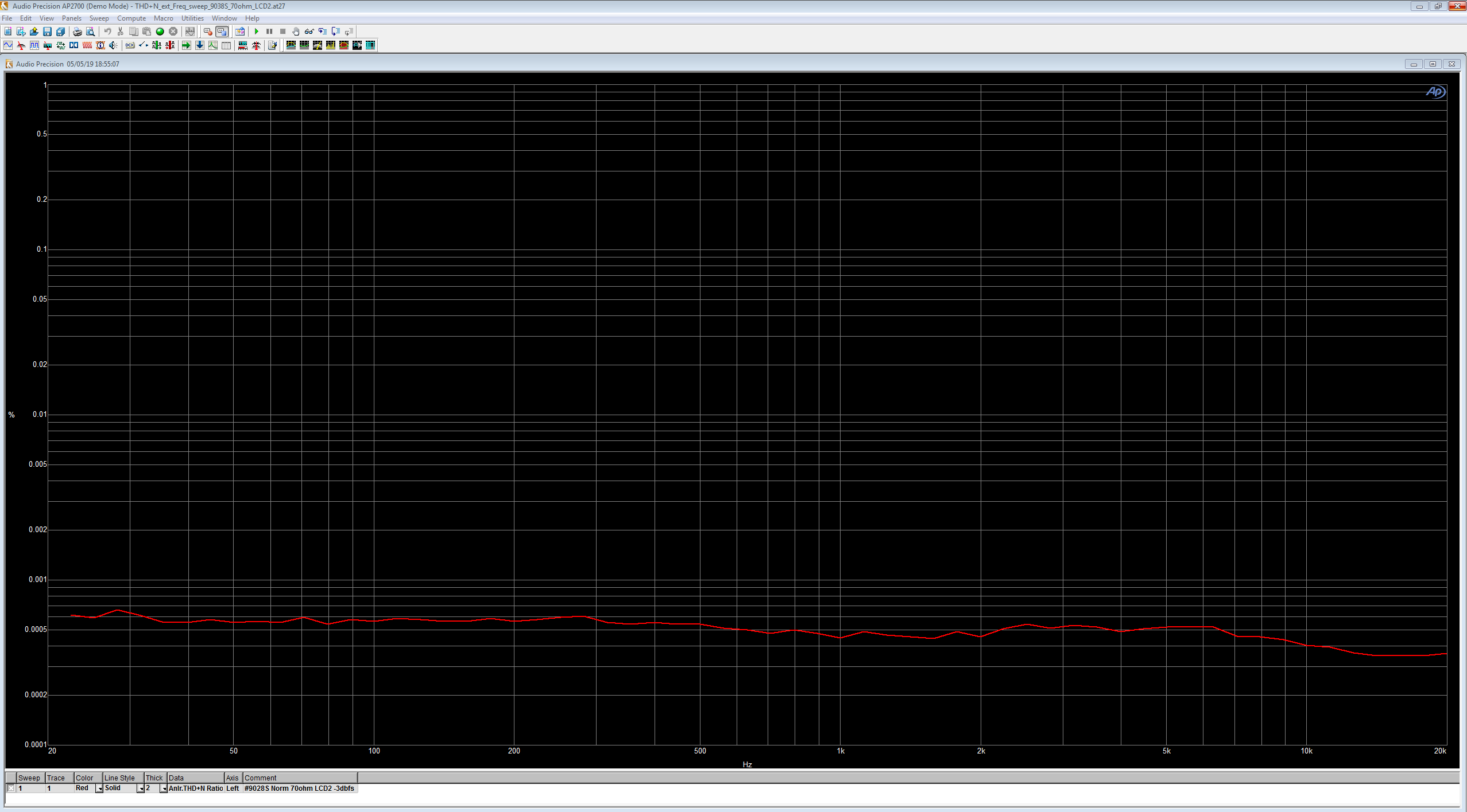

3) THD+N vs frequency plot is pretty much redundant because distortions are the same across the audio-band, but anyway, check this out the rare picture for that market
4) 32ohm load i.e. close to my HFM HE400i, 1kHz max power@THD+N=1% 343mW i.e. HFM HE400i with sensitivity 93db/mW will produce >118db SPL with #9038S output THD+N@half of max power again about same
5) 16ohm load, not sure which HP is close to 16ohm yet, let's take LCDX 20ohm as a close example, 1kHz max power@THD+N=1% 552.9mW i.e. LCDX(if accidentally it was -20% less impedance) with sensitivity 103db/mW will produce >130db SPL(DANGEROUS LOUD!!!) with #9038S output THD+N at 1/2 of max power .0009%

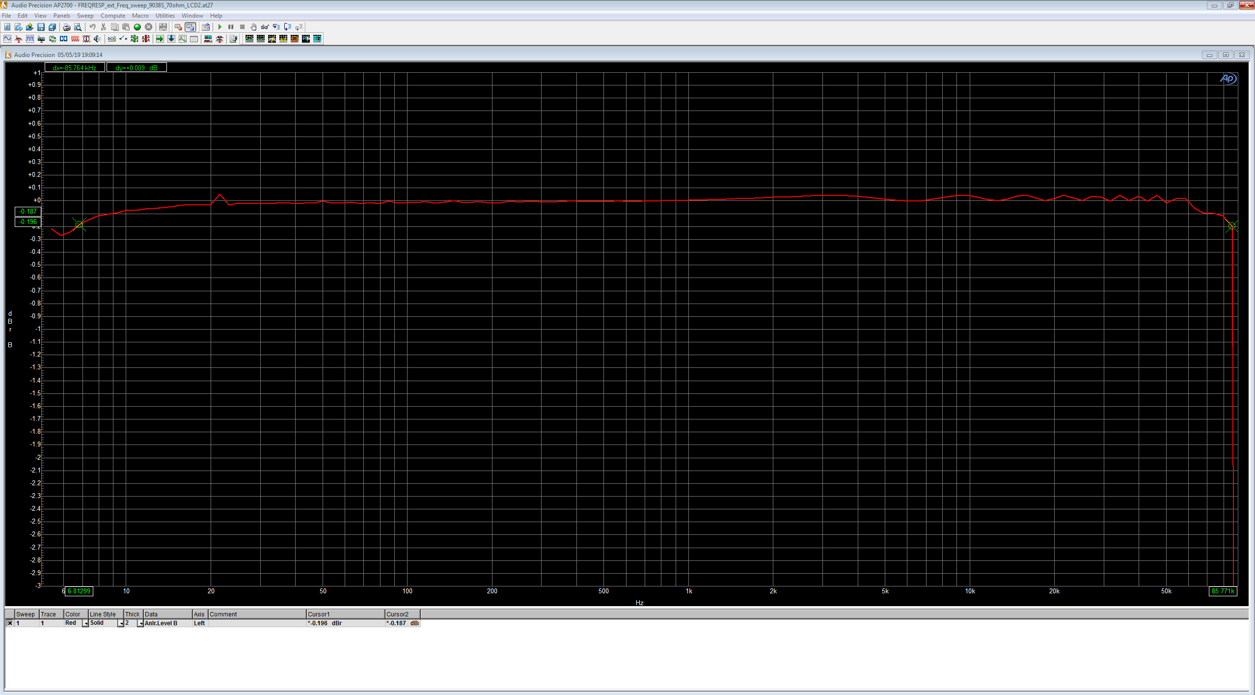

And another quite formal plot the frequency response, 7Hz-85kHz at -.2db or 8Hz-75kHz at -.1db

But you know, I can see harmonics below -120db level with my handcrafted ADC+notch filter, I tested that with AP 2702 generator which is way more precise than its analyzer, and AP guaranteed <-130db harmonics of the generator. I can see them as -125-127db, so I believe, I equipped enough to turn over the market 😉 Actually, even Amir's APx555 read the THD+N =.00013% when SNR =-131dbA and THD .00003% of that toy Okto Research Actually, after -90dbA SNR and 50mW(THD+N isn't specified at all) for competitors USB->DAC->HPA dongle, #9038S could be 10x times worse than now to be comparable ))

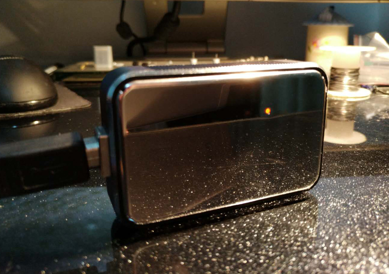

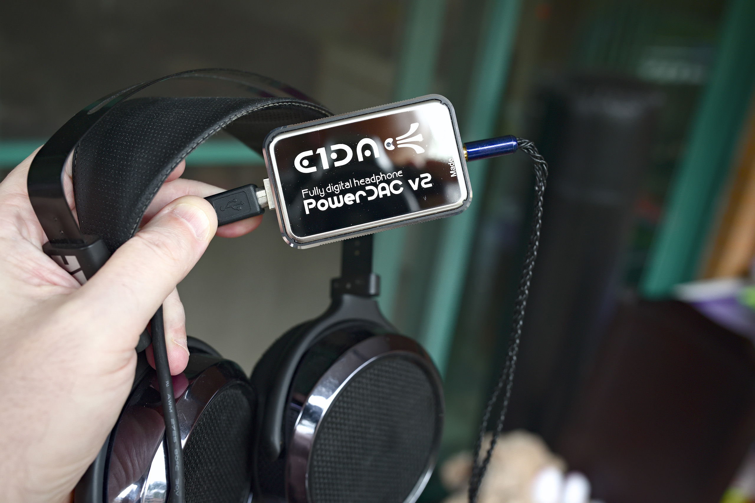

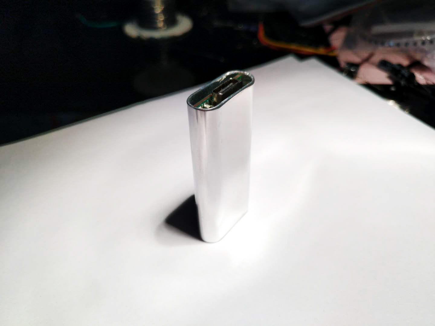

The very first sample of PowerDAC V2 has fully assembled
laser print on polished stainless steel looks fantastic, like extraterrestrial tech on my hand!
However, it is expensive and still made not flawless, and I consider a fine-mate sandblast(like iphone's back) variant further. Tomorrow I'll send it to the USA for review.
