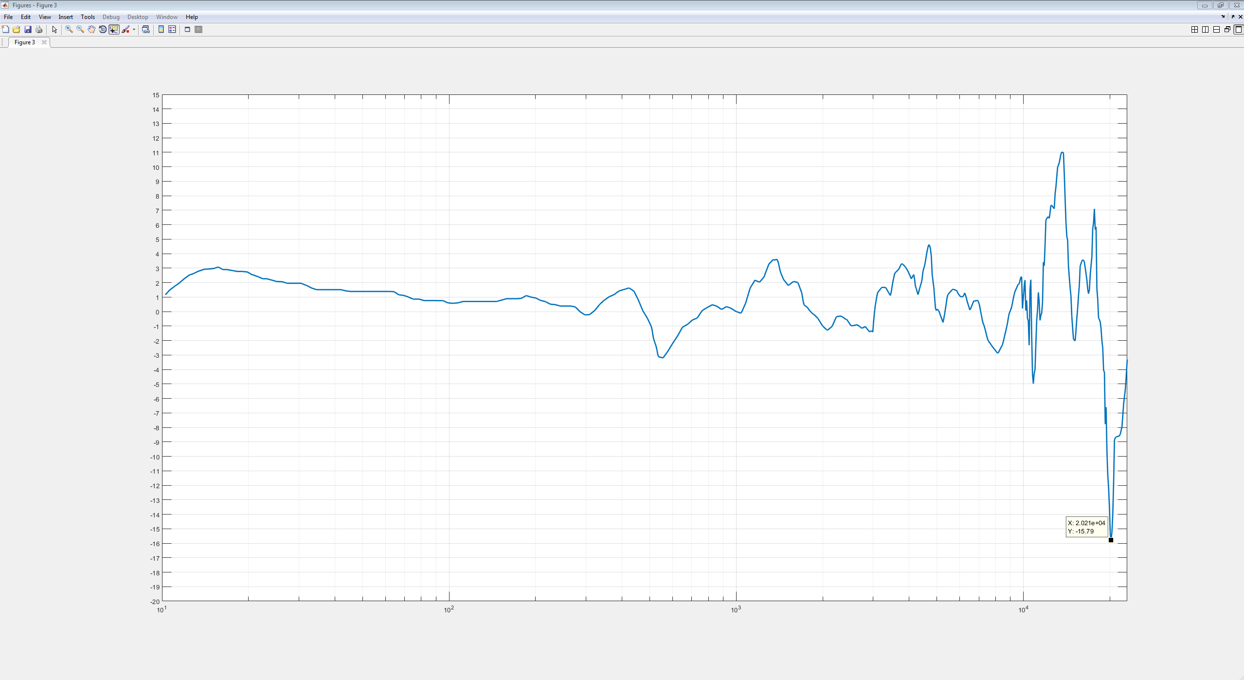

I've found freq.responses for he400i and he560(innerfidelity), and I see just +3db bump on 400i vs 560. See attached 400i vs 560 difference plot. Actually, it is pretty easy to adjust 7pcs parametric EQs of TAS5558 IC to fit one headphone freq.responce to another one. I trying to write Matlab code for automatical biquads setup for such compensation 😉 Apparently, 400i to 560 compensation would not be too interesting because the difference is not as big as vs HD800S or LCD2.

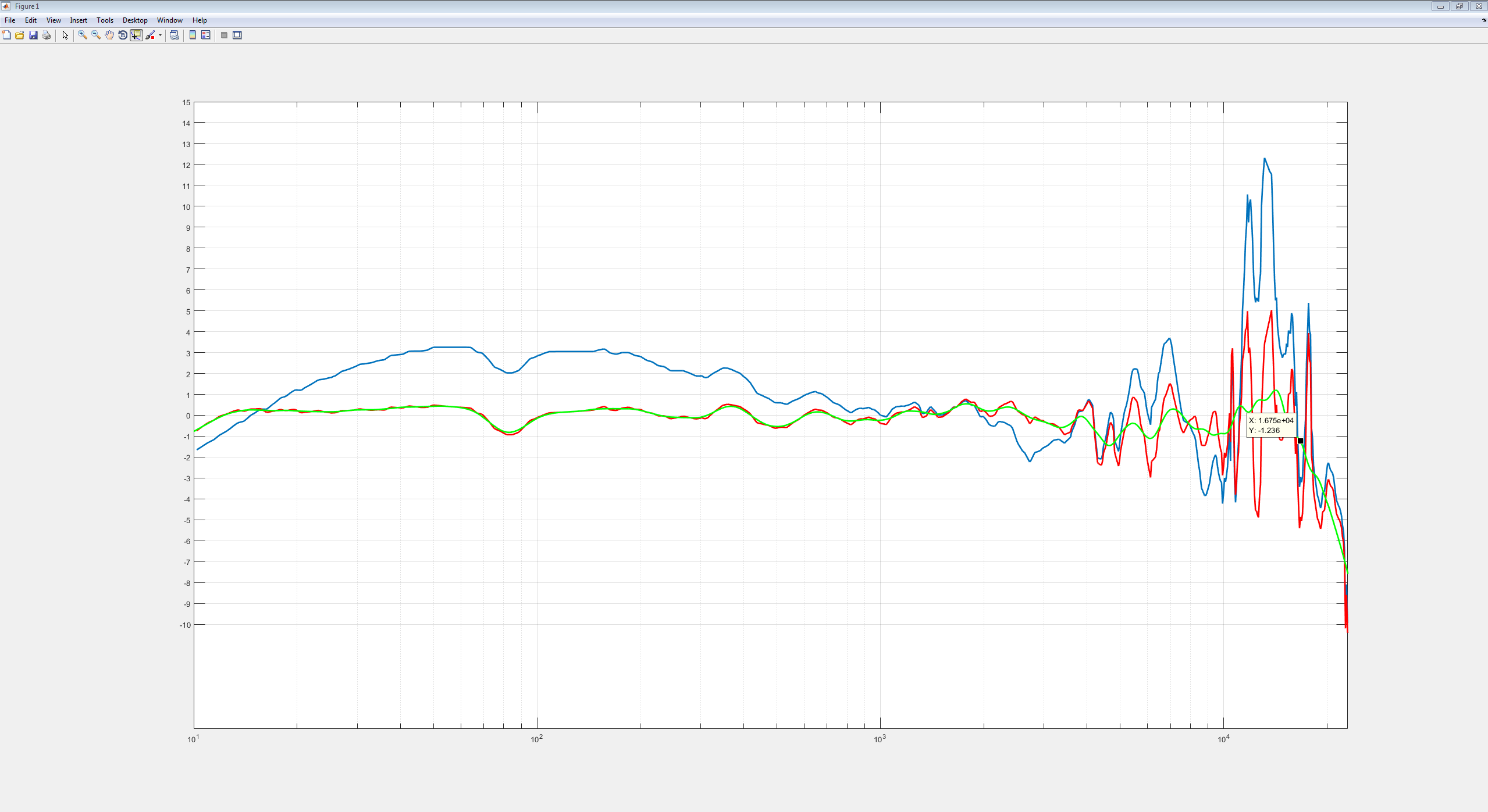

and the result is here 😉 Actually, it is pretty much manual adjustment with Matlab visualization. Blue - difference he400i vs hd800s, red - residual difference he400i vs hd800s after 7 pEQ compensation, green - smoothed residual difference he400i vs hd800s after 7 pEQ compensation.

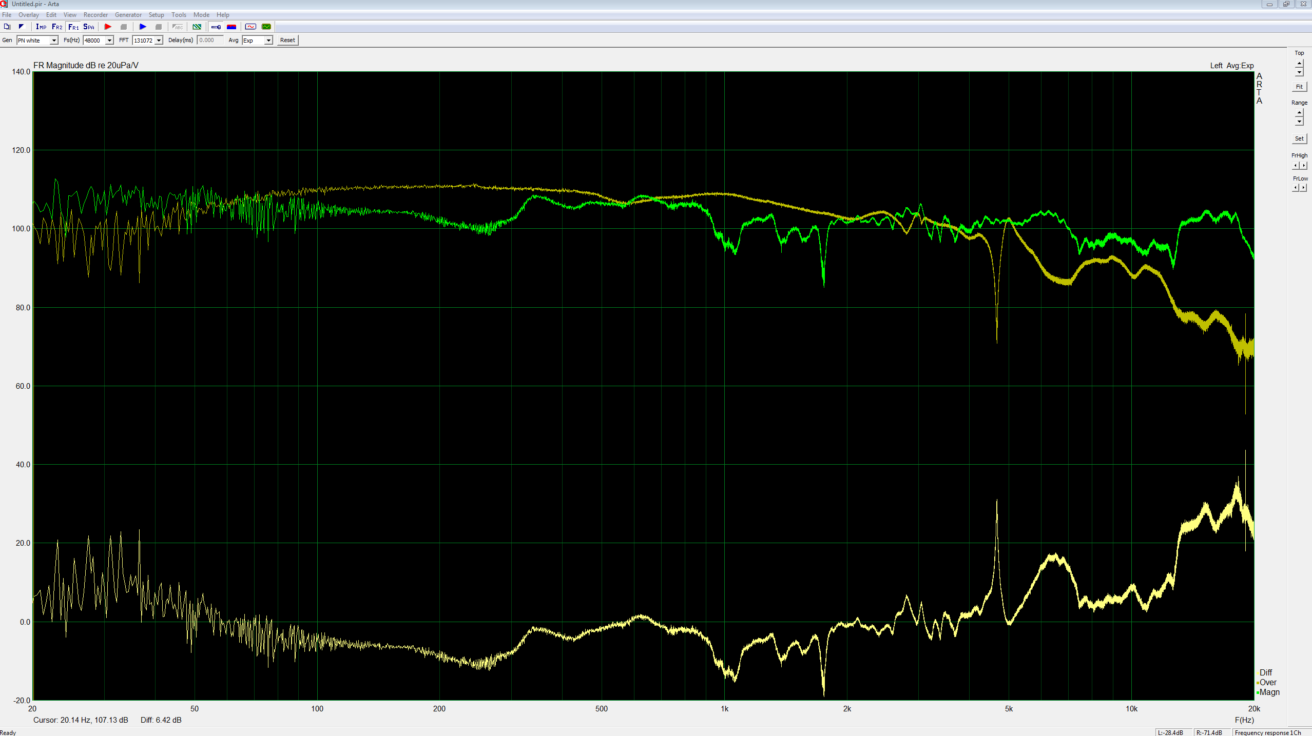

badboygolf16v, I checked out the Kamelion link HE 400i | DIY-Audio-Heaven and found that his measurement very far from mine. He said "measurements are made with a good seal on a flatbed measurement rig", and I did the same measurement, however, my plot has no any 8kHz peak. Please see attached. the green plot is he400i(yellow is my old Sennh, I even don't remember the model #). BTW, that measurement method is too rough to consider it seriously, innerfidelity's plots mad with artificial ear-head and results more practical to me. Yesterday I tried to equalize the green plot into yellow one with 7 parametric EQs and Matlab, the result was sounding really awful on my 400i, and not similar to my old Sennh at all.

From what I've read, headphone measurement can be an interesting task due to physiological differences. Tyll who used to run Innerfidelity wrote about it on occasion, it's an art and a science, that requires a good understanding of the measurement setup in order to properly interpret the results. I have zero experience in the area, I'm just an interested hobbyist.
