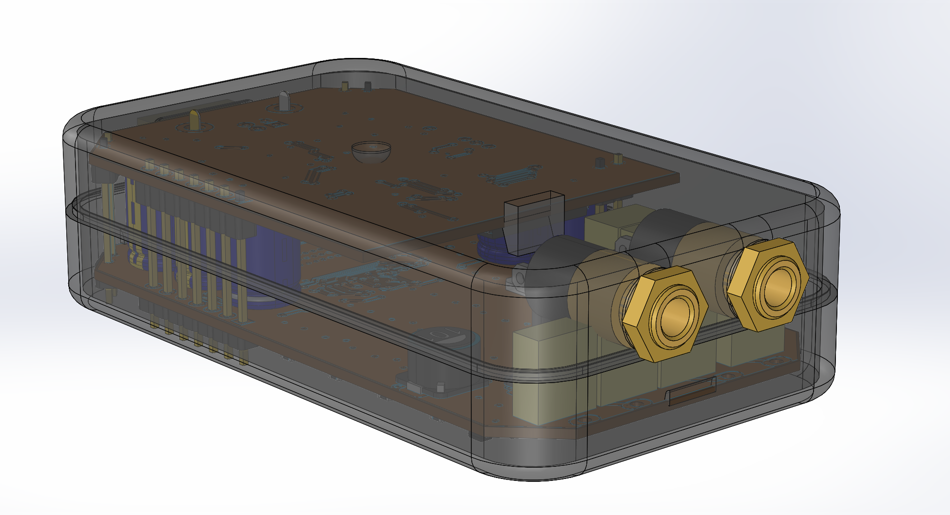

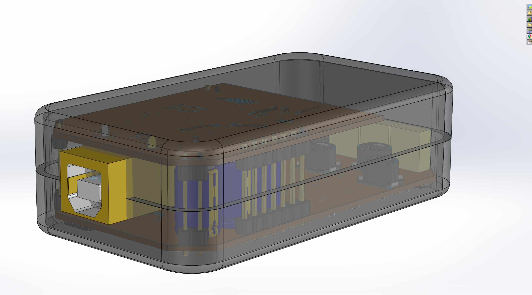

I made some case raw drawing for 3D print(1.5mm plastic thickness). The dimensions are 77x44x23mm or 3"x1.73"x.9". A bit bigger than I want but I guess still ok 😉

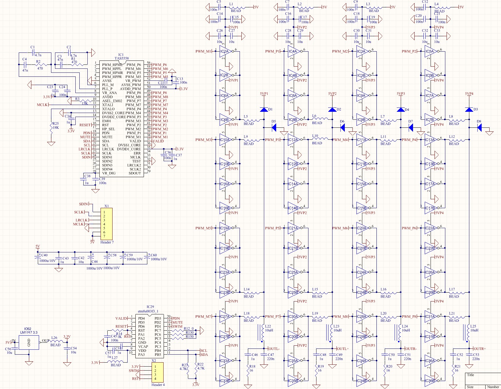

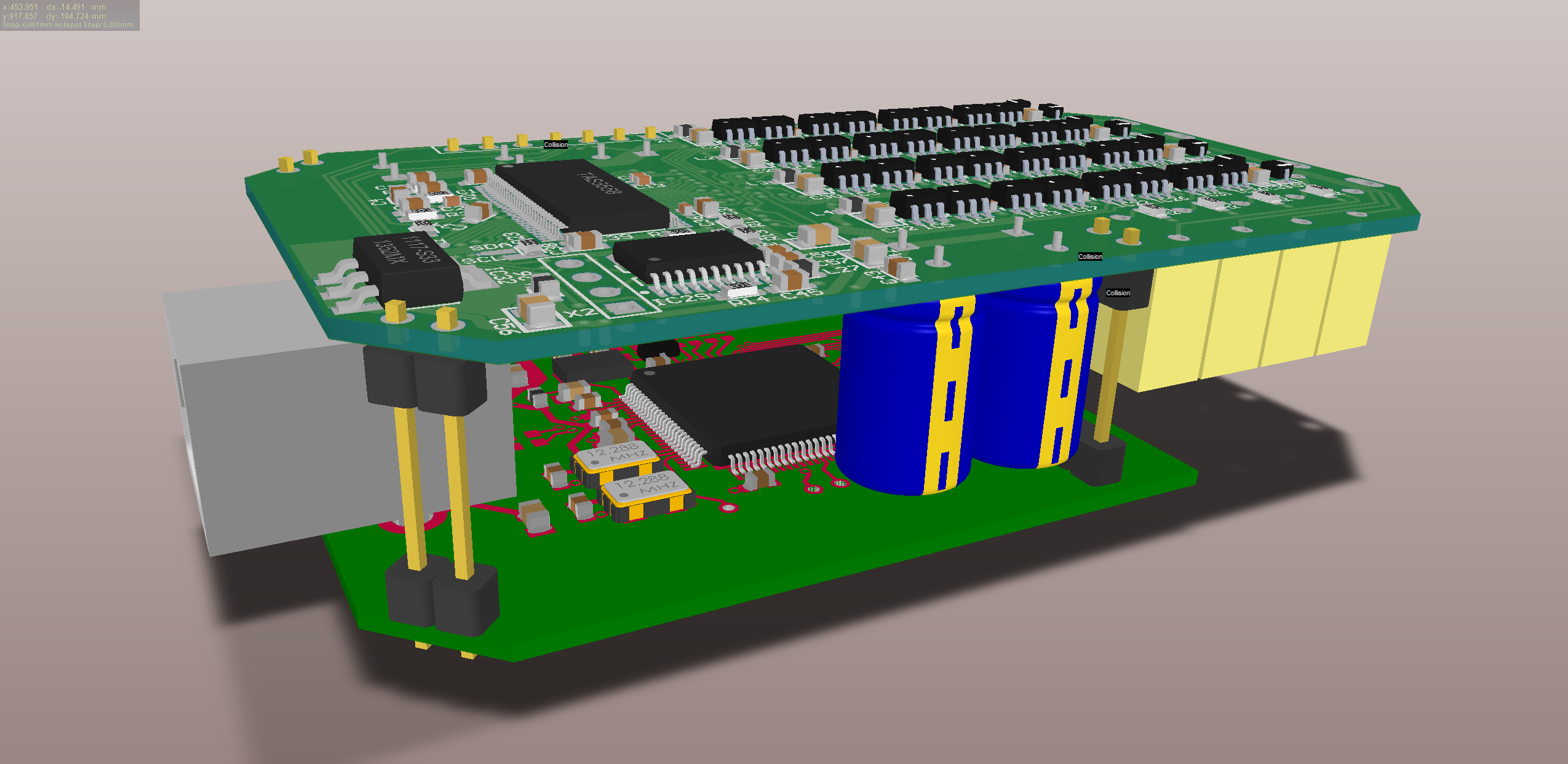

About schematics, I already shared USB high-res PCB design here CM6631 usb audio interface .... any good ? Power DAC schematic see attached:
Dimensions are reduced to 77.2x44.2x20mm 😉 Ok, I going to order 10pcs PSB sets and assemble 10 samples next 1-2 weeks. Anyone interested to try the Power DAC, you are welcome(only BOM+delivery cost compensation required).
Deal! And I have a question about the output arrangement, is it good/bad idea to add there some 3.5 connectors yet? I found some jack but it seemed too thick, see attached. I can try to put jacks to the left and right walls as well if it's not too ugly. In another hand, fewer connectors = more sound purity, and we may simply solder outputs wires into the PCB without any jacks?

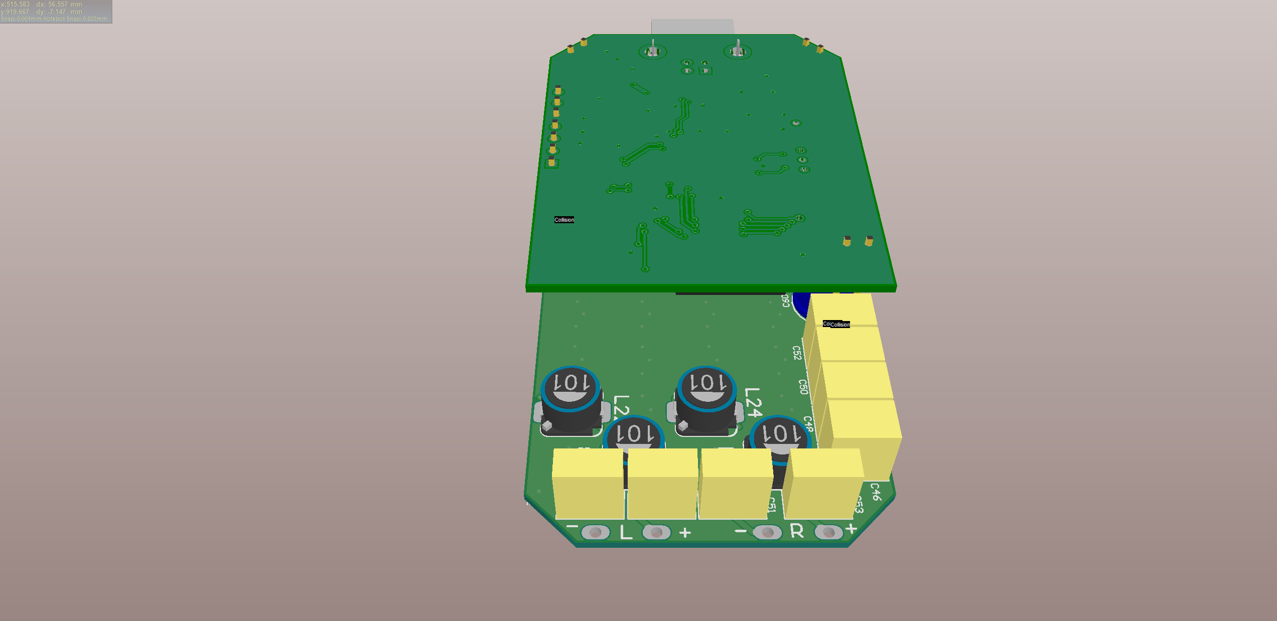

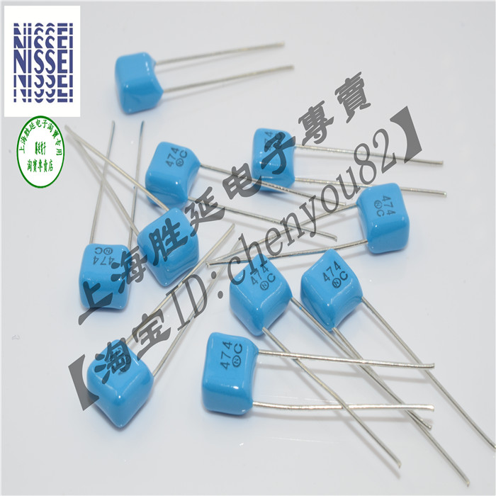

badboygolf16v, do you have a 3D printer? The problem is I have no that instrument so far 😉 So I do not promise to send the printed case with PCBA(PCBs assembly), only the 3D model. As I said, I didn't found 3.5 jack suitable for 20mm toy's case hight(actually, even for 23mm 8mm jack's diameter is too big). In the same time, I 100% disagree increase the toy's size because it has to be extremely compact, ideally like a continuation of cable. I can replace a big film caps(yellow stacked type bricks, you can see my latest pic, they overlaying with jacks) with small SMD types, however, It will affect the sound, no doubt. Hence, again no. I've tried to put jacks to the left and right walls - no way, jacks are too large. If you can offer me some bright idea about jacks placement, you are welcome. Otherwise, let's forget about jacks. God bless a purity! I'll leave two 4mm holes for two cables(Left/Right), which should be soldered to PowerDAC PCB 😉
PS: 2.5mm jack(the female one) is a too rare beast, I tell you.. I trying to find some stacked type film caps with less hight to fit 20mm case. Probably Nissei has something..

Somebody asking me in Private_Messages about the BOM cost(parts+PCB1+PCB2, assembling is free), I didn't calculate it exactly but roughly it is $25-30 + delivering I guess $2-20. So I think the total should be within $50. And guys, I really not sure if my PowerDAC would be good for your DYNAMIC type headphones(*), hence, I could not recommend you spend your money and my time for that 😉
* The PowerDAC is open-loop system(means no feedback at all), hence an output impedance not as low as typical headphones class A/AB amps has with tons of feedback. An input impedance of dynamic headphones isn't flat vs frequency, unlike planar one, so an open-loop output may sound tonally unneutral, colored(I can expect some bumpy, not well-controlled bass etc). Maybe not, but an ideal load is a planar headphone with differential(balanced, 4 wires) inputs, that's it.
I did a little math on what the output impedance might be, based on a guess at what LVC output buffer you're using. I went for Nexperia 74LVC2G34 dual buffer. Its worst case Zout at 4.5V is 22ohm in high state, 17ohm in low state. I'd expect typically it would be under half the worst case but let's go worst-case.
With 16 buffers in parallel that's about 1.4ohm per side of the H, so totally 2.8ohm. I have not included the impedance of the FBs nor that of the 10uH output inductors.
My conclusion is - I suspect in regards to output impedance there will be no problem driving dynamic over-the-ears headphones. IEMs with multiple armatures would be problematic but they're likely unsuitable for other reasons like noise.

abraxalito, maybe you are right and dynamic type is ok too, but I saw HFiMan HE400i at taobao for 900RMB/$143, I guess it is cheapest planar on the market to try my PowerDAC 😉 BTW, I just ordered 20 PCBs(10 sets) which will be delivered next 4 days. News #2, 3.5mm jacks are no problem with 74x44x20mm case(from my latest pic). So far we are lucky!
