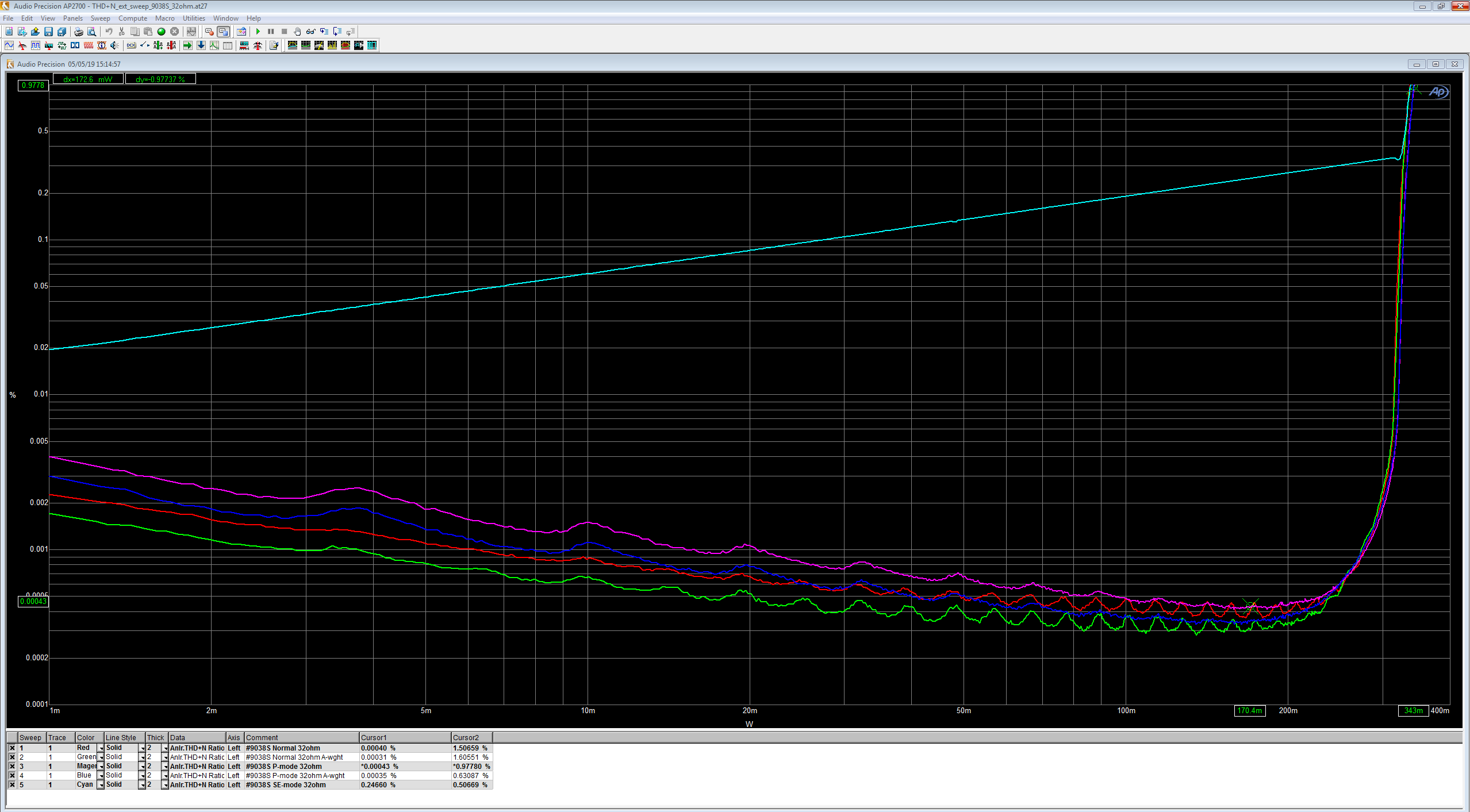

PowerDAC uses direct USB 5VDC rail with extensive filtering by 5000uF organic-polymer caps (just one-two mOhms ESR!) and lots of MLCC. Actually, this is one of the reason why I gonna sell that just for $50.

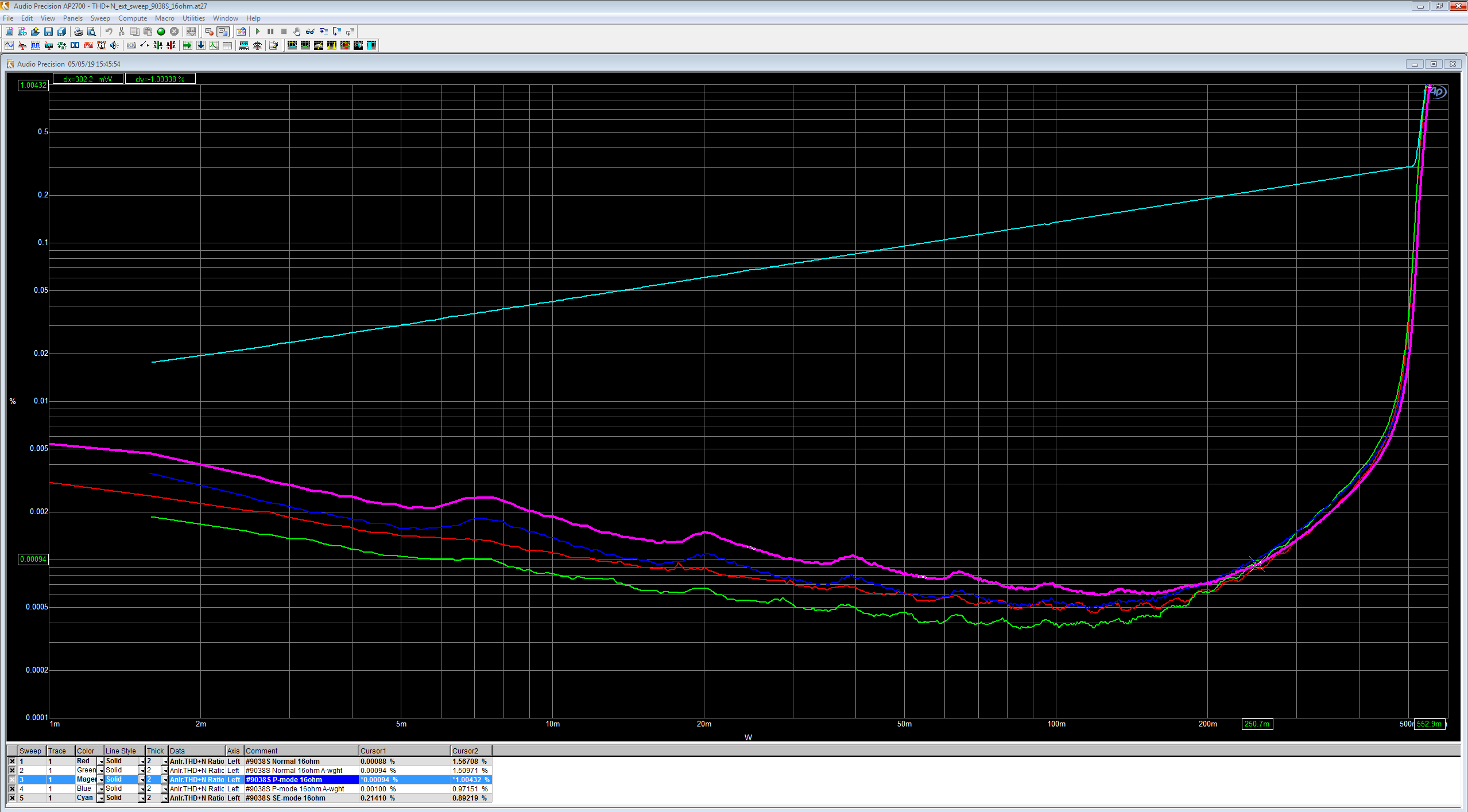

The peak to peak output voltage is 5V ideally i.e. with USB Y-splitter to get stream form the smartphone but power from powerbank or few amps charger and maybe 100ohm load. With normal PC USB2 I didn't see higher than 4.8Vp-p. BTW, some ports are stronger vs others, no idea why, and it is not specified mother-board manual. I believe I showed the normal USB2 1kHz power vs THD sweep here already for 16ohm THD+N=1% at 580mW, 32ohm at 320mW. Pretty much the same result for a tiny one #9038S: 340mW@32ohm i.e. 3.4VRMS=4.8Vp-p, and 550mW at 16ohm.

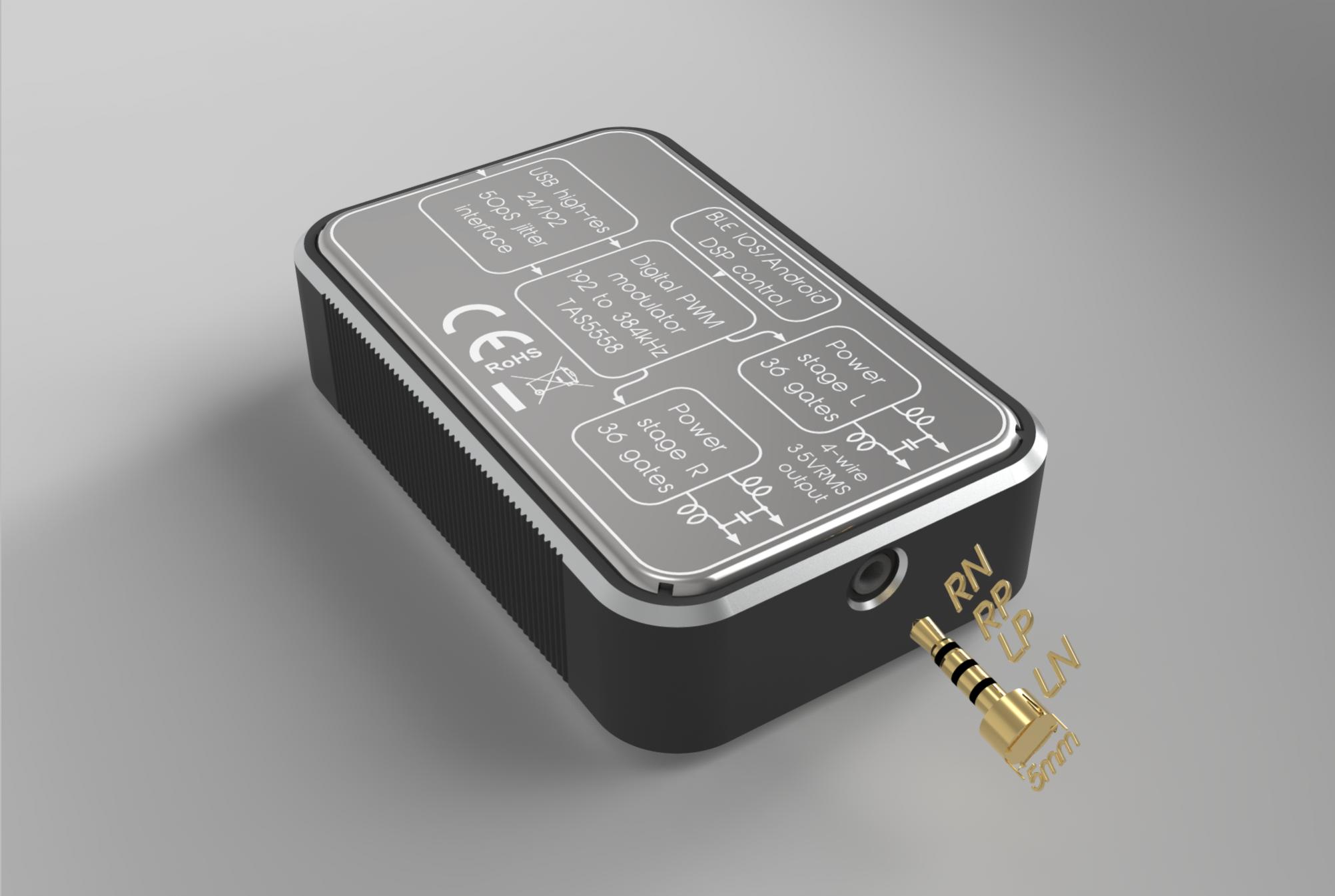

PS: what do you think about my output interface explanation? See attached 😉

I like the little interface explanation. If you sell the toy with that faceplate, that would be awesome. Reminds me of microwave boxes I used to use in the lab- “miniCircuits” I think. Very self explanatory and no instruction manual required.

xrk971, thank you, I'll ask my wife to check Esty. And yes, this render is equal to actual laser print(I posted here pics week ago). BTW, I found the LED which exact match with tube's cathode color temperature 1100K, and PowerDAC V2 running warm too 😉

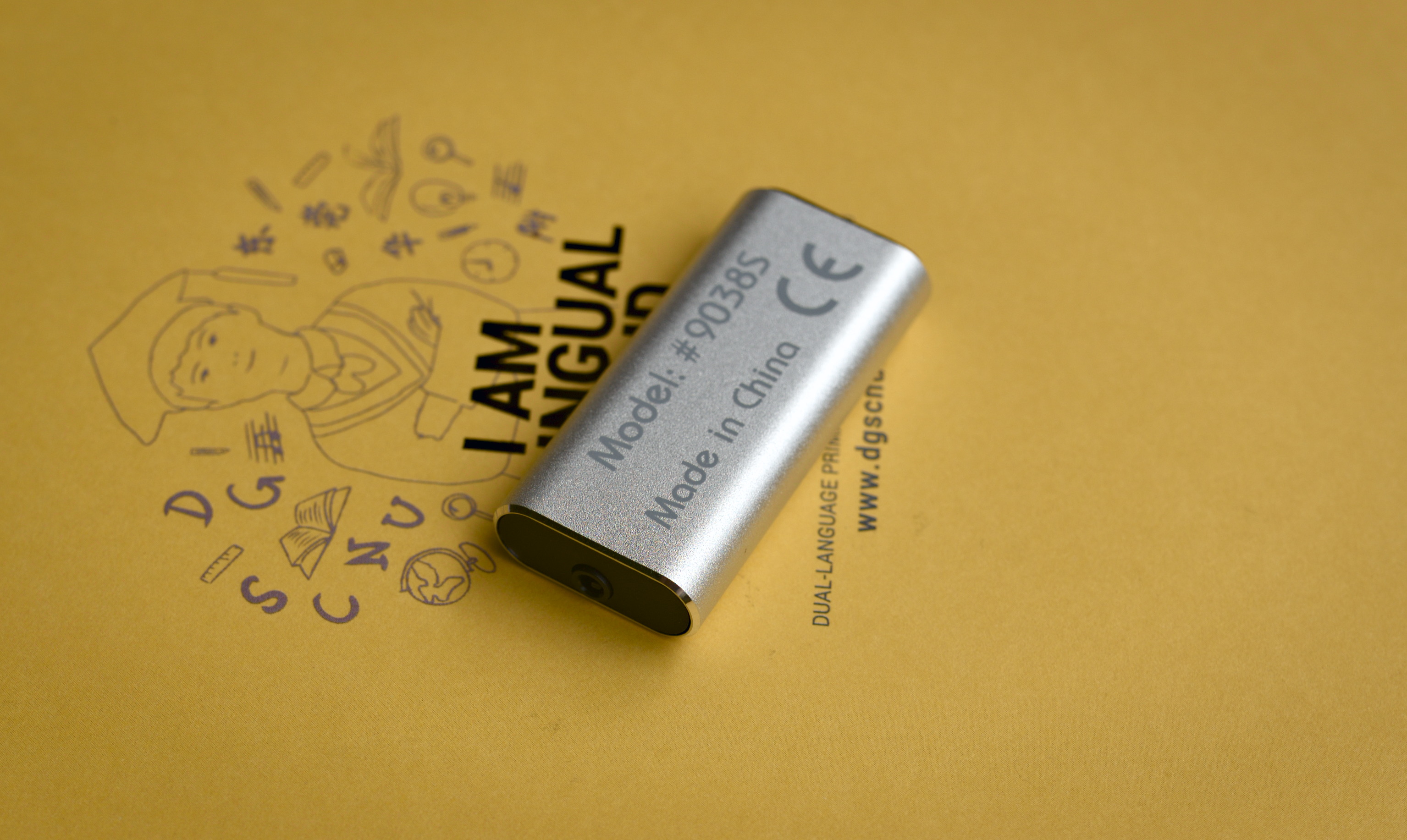

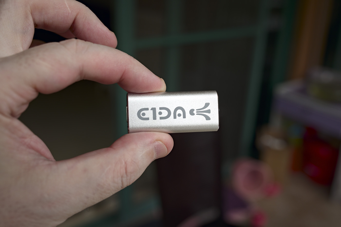

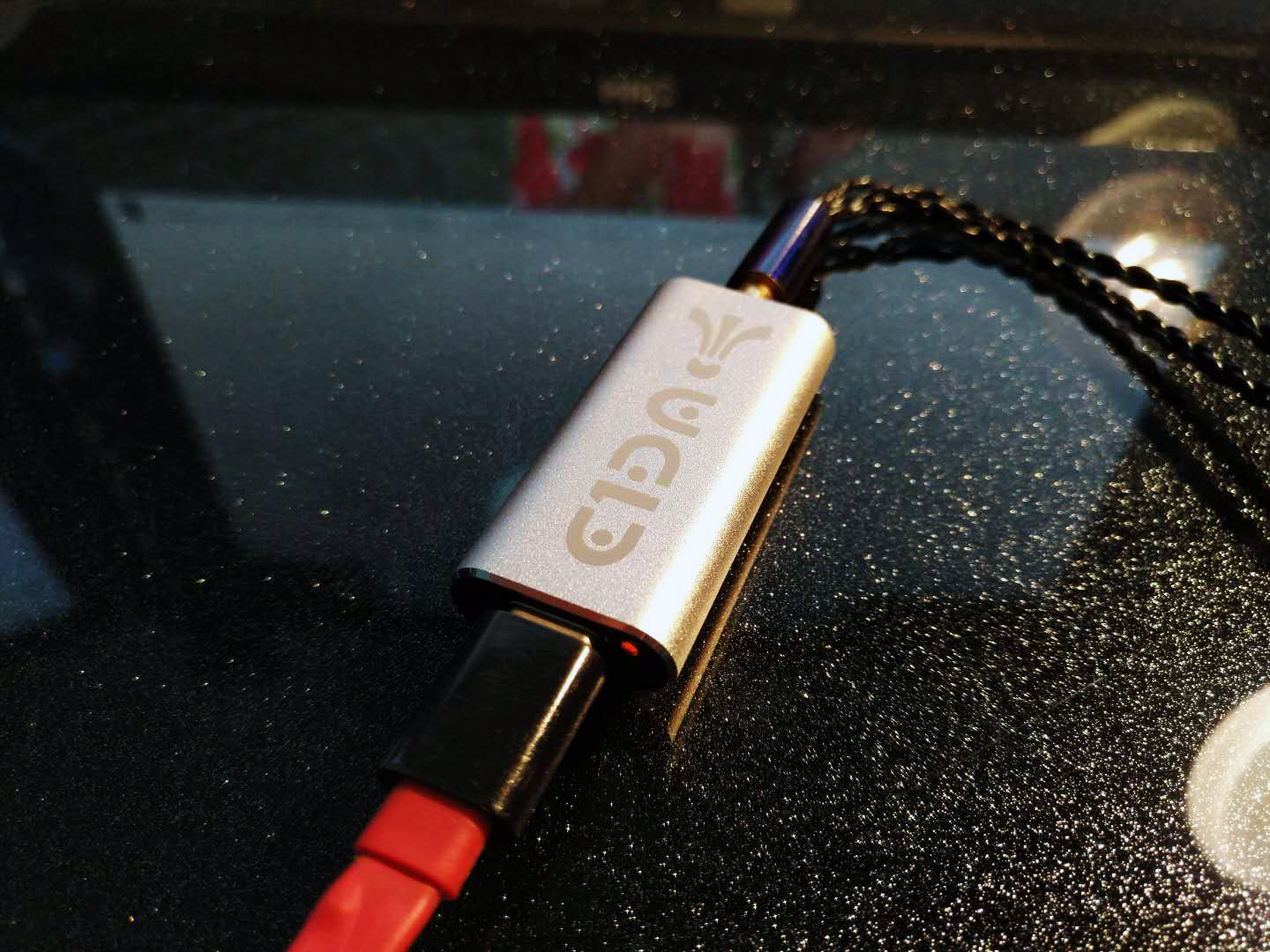

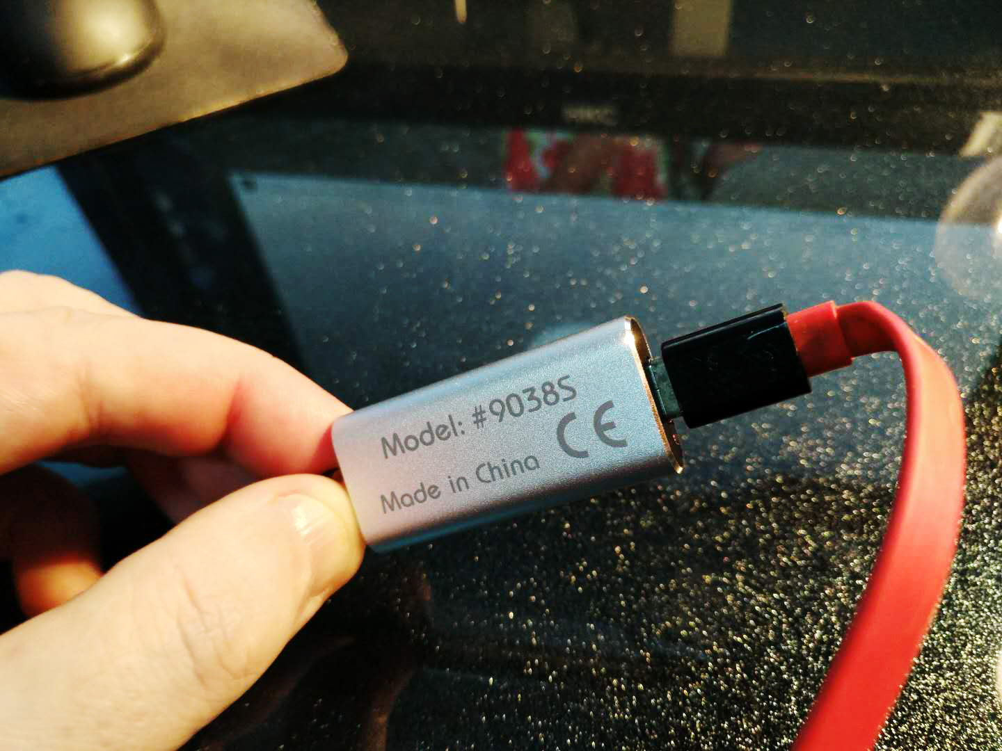

badboygolf16v, thank you for your trust! I will keep a log. Also, I want to tell the story how I deal with chinese suppliers, how I ordering some toolings and so on. Probably it is not really interesting for buyers-diyers but for such true DIY nerds like I'm, it could be spectacular info. The reason is nowadays any DIYer who has a good design project, can order small production bunch to check he's objectively so good or just imaginary. All simulation works today possible to implement on the laptop, whatever electronics, software either mechanics. No need to visit suppliers, all communications could be online etc. The cost of such an experiment is quite ok and comparable with your top DSLR camera which you bought only to ask yourself - why I bought it?? I don't say that it is easy but 1000x times easier than 20-40 years ago when famous today audio brands decided to become pro from their diy start. They had nothing, only pen, paper and passion, we have all and even more, so let's do something that worth our opportunities.

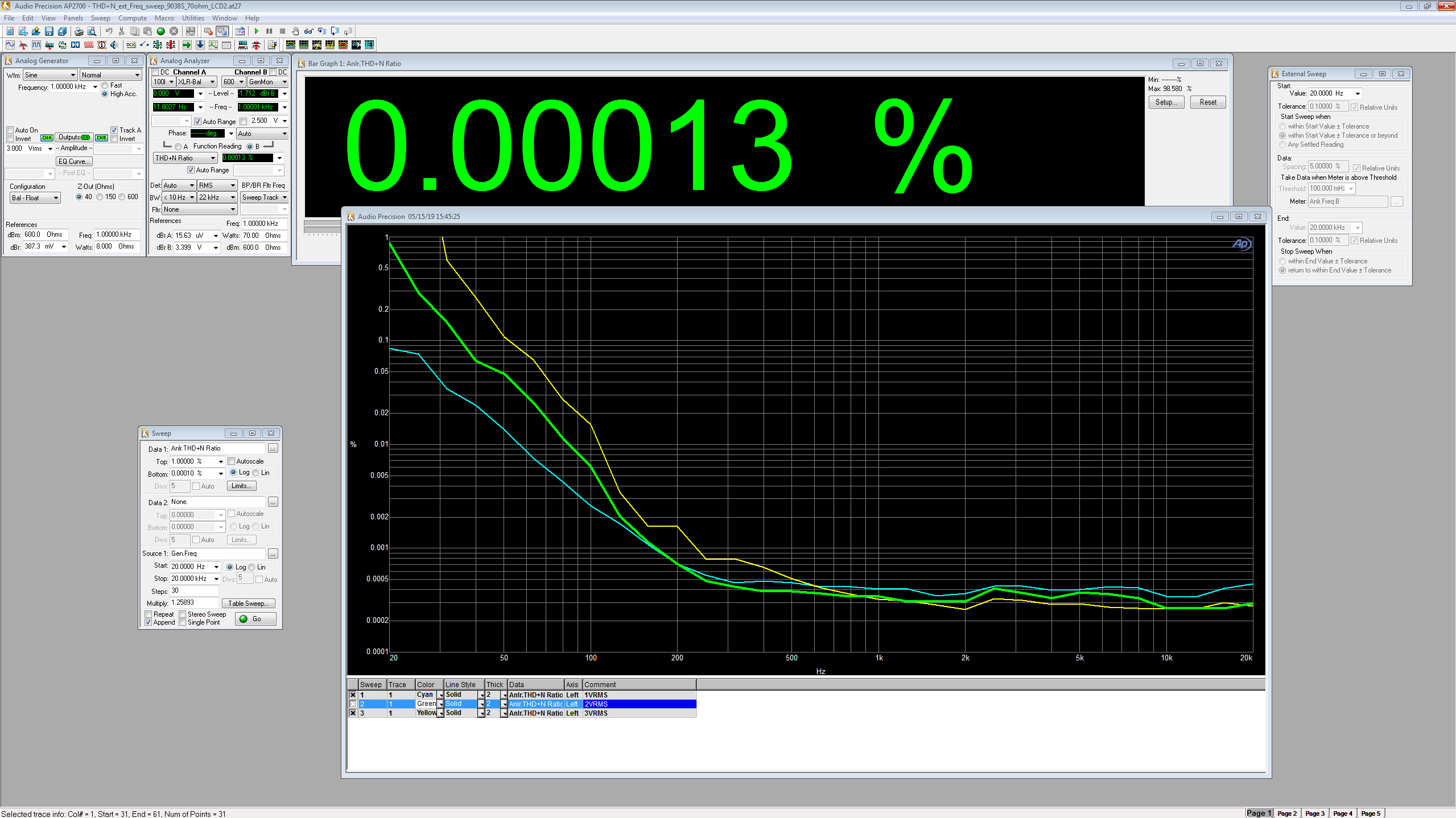

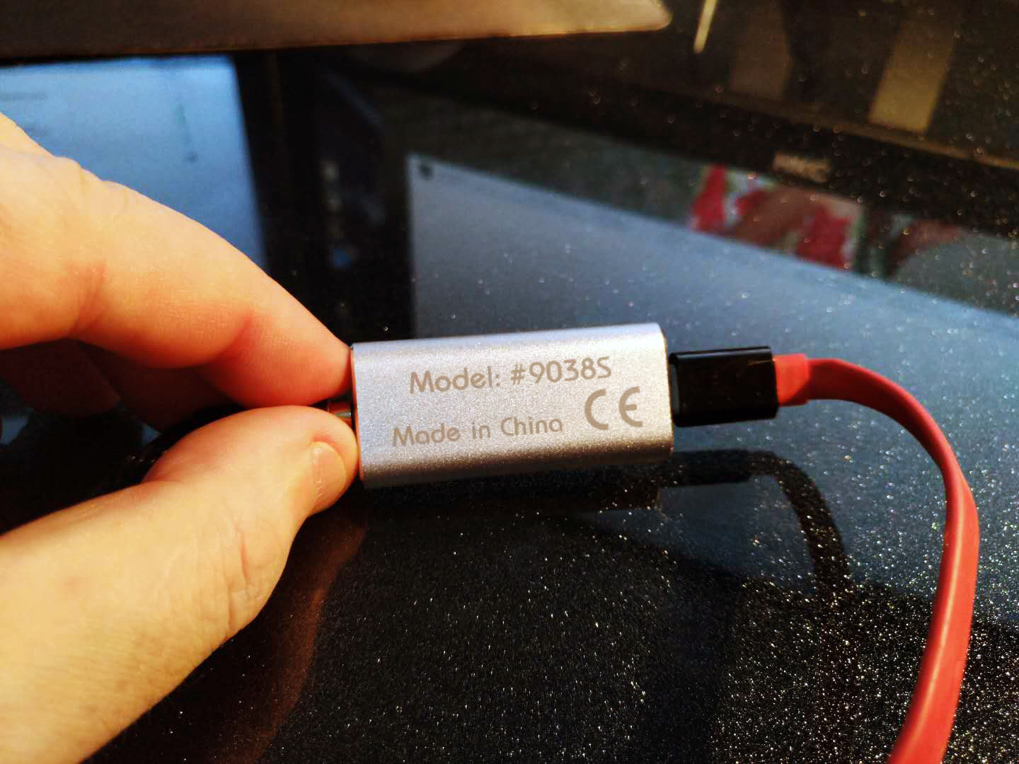

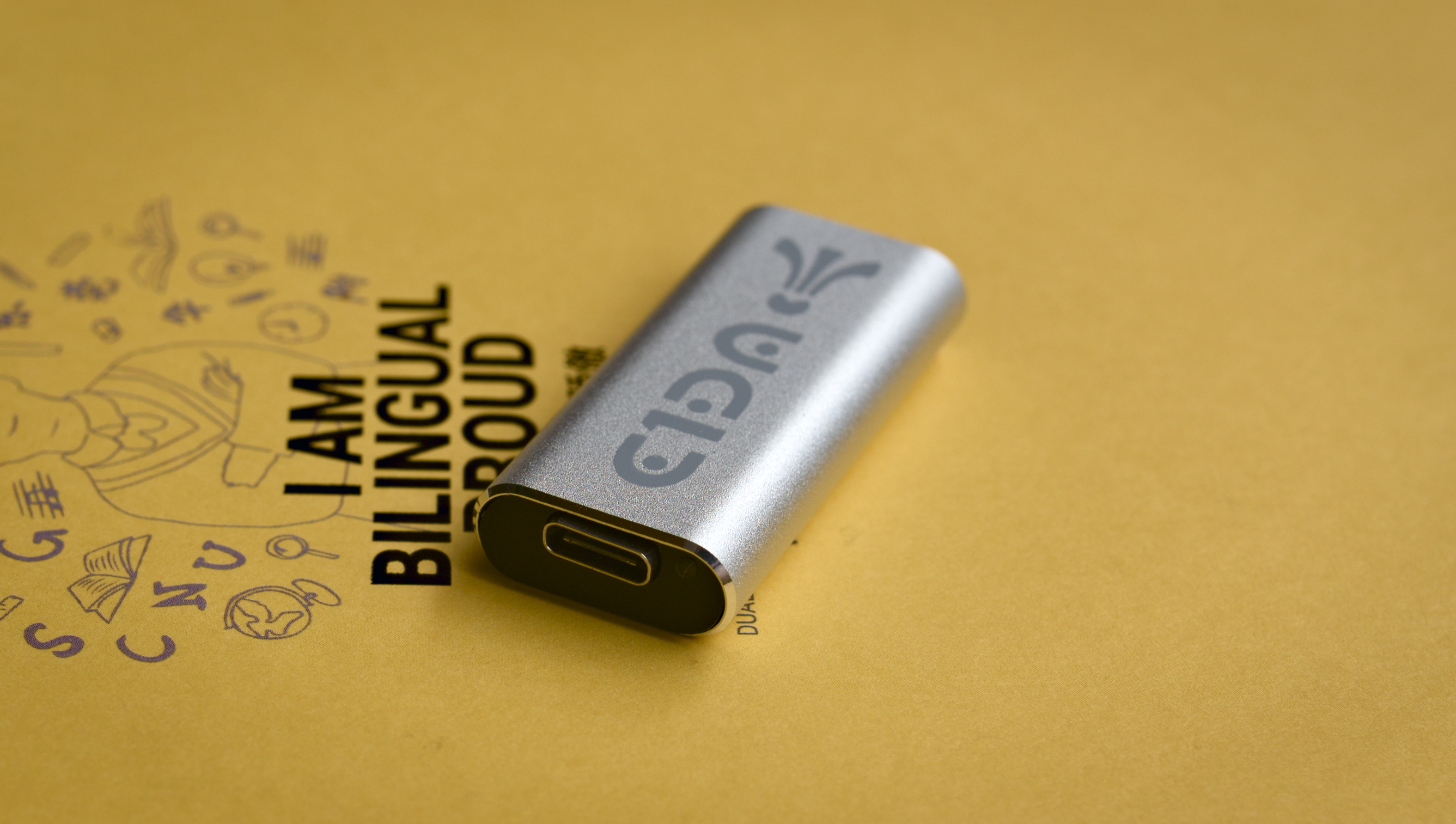

It is USB 24/192 DAC (ES9038Q2M one of the top-rated 32/768 DACs on the market) + HPAmp on the top-rated opamps AD8397. Output power the same as PowerDAC THD+N .0004% at half of the max power and 32ohm load, SNR -122dbA, dynamic range >120db. No one is even close to such performance/size on the market. Yes, it is trivial, I agree 😉
Yeah, why not if to tie the GND to the USB-C with alligator clips, you'll get L+, L-, R+, R- and GND to arrange two standard balanced XLRs. Probably, if your amp is grounded the same as your PC/Mac/IOS/Android source device, and no drilling work in the next room, alligator clips would be redundant. Another way to use isolation trafo 600:600, I bought such permalloy-trafo for $10 on taobao, and quite happy with THD performances.
Does the #9038S have standard TRS jack or dual diff TRRS?
